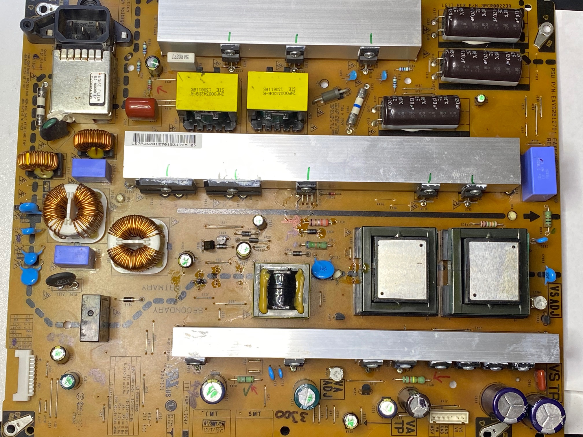

    I just acquired a LG 60PN5700 from a friend who didnt know what was wrong with it. The TV powers up and I see a small flash on screen but then it cycles back off then on. It seems to be on but no video or sound. I traced the 5v and 17v around the boards it seems to be getting around to every board.. I tried to use a heat gun on the main board and rework it, didnt have any effect. What should i focus my attention on?
    PB P/N: EAX64880001
    MAIN P/N: EAX64870004
    ### P813 ###
    M_ON = .61v
    PL_ON = 1.22v
    5.2V = 5.2v
    G
    G
    5.2V = 5.2v
    5.2V = 5.2v
    G
    17.V = 17.1v
    Auto_G = 4.1v
    AC_ON = 5.0v
    17V_DET = 2.357v
    VS_ON = .64v
    G
    VS_DET = 2.7v
    5.2V = 5.2v
    G
    17V = 17.1v
    ### J148 ###
    VS = 203v
    VS = 203v
    GND
    GND
    VA = 55v
    5V = 5.2v

    If you look at the control board you will see two test points labeled EXT_AUTO_GEN, unplug the tv, disconnect the plug going between the main board and the control board, short the two test points on the control board and plug the tv in, You should get test patterns on the screen, If you do, the fault is likely on the main board

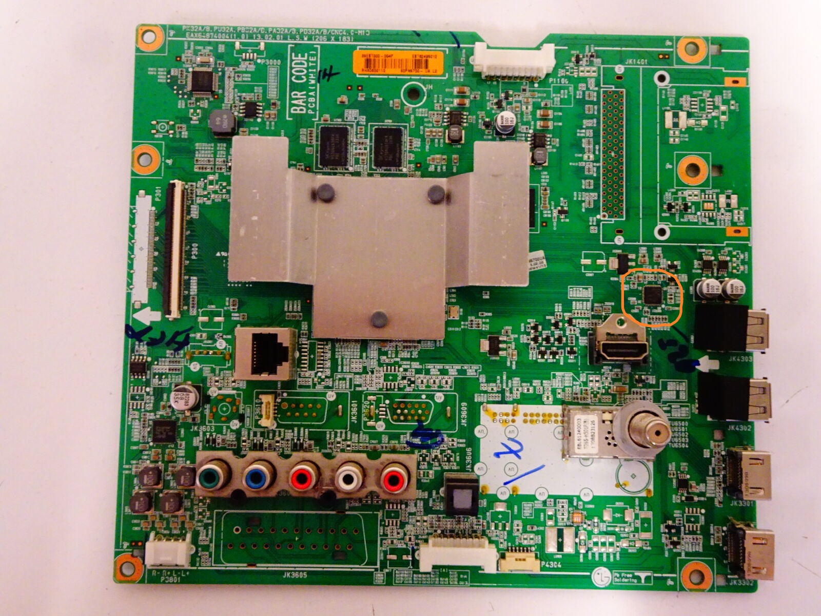

          Re: LG 60PN5700 Powers on, No Video No Picture
          Originally posted by R_J
          Doing this test would not have caused a problem with the main board. Which chip on the main board smoked? maybe the board can be repaired.
          this is not the my actual board but a identical one. this is the chip that was burnt on the top and was smoking

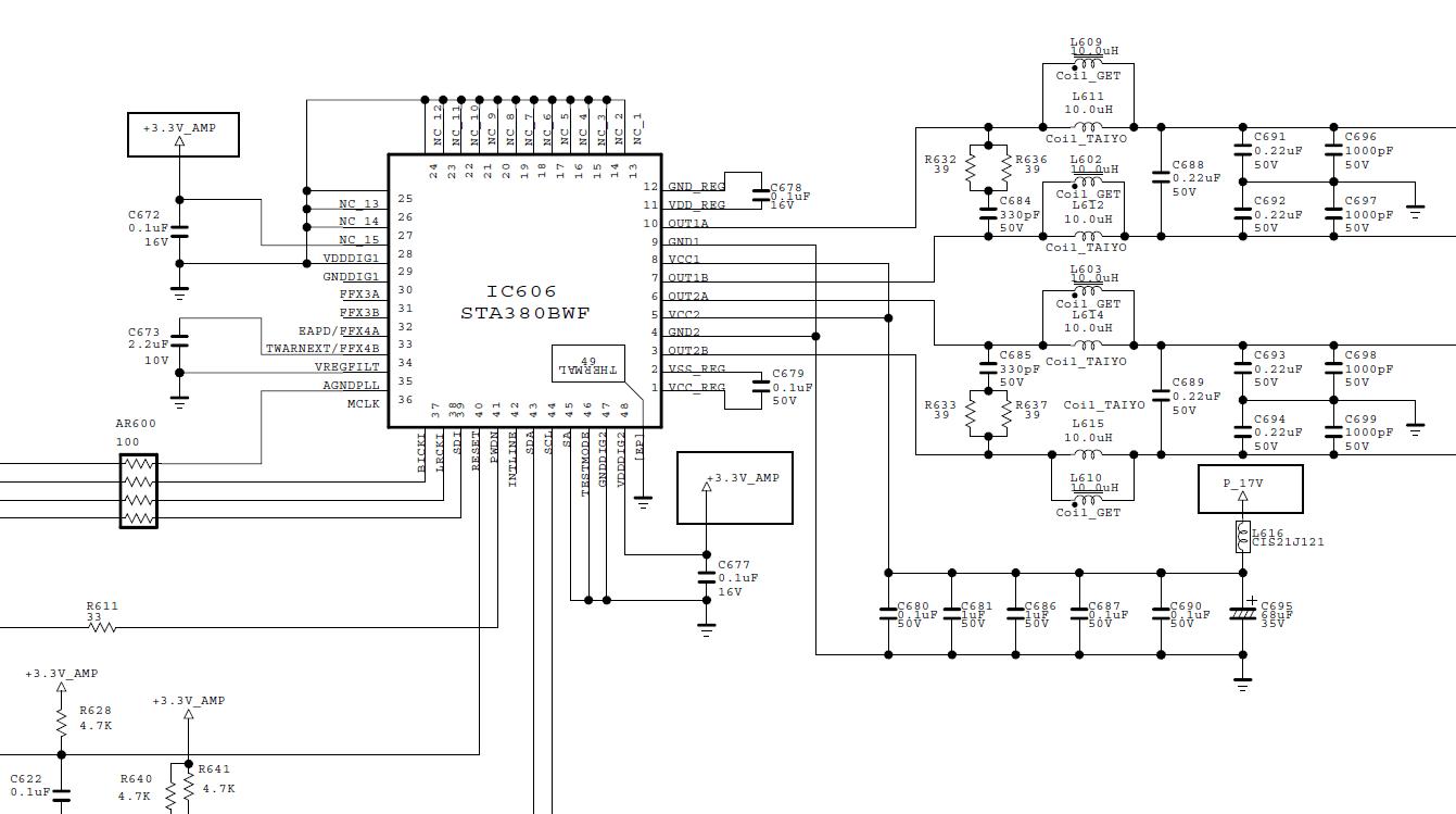

            That would be the audio output ic. (STA380BWF), If it is killing one of the voltages you might be able to disable it and see if the rest of the tv works. If the 3.3 volts is being killed, trace that pin and there should be a small smd coilyou could remove to disable the ic, same goes for the P_17v

              Im sorry, after taking the TV back out of storage and getting the board out, i realized i circled the wrong IC..
              • R_J
                • Jun 2012
                • 9588
                That looks like the hdmi ic, I can't make out the number, look up the number, find the pdf and locate the vcc pin so you can disable the ic in case it is shorting one of the voltages, again the board should work with the ic disabled, just no hdmi.

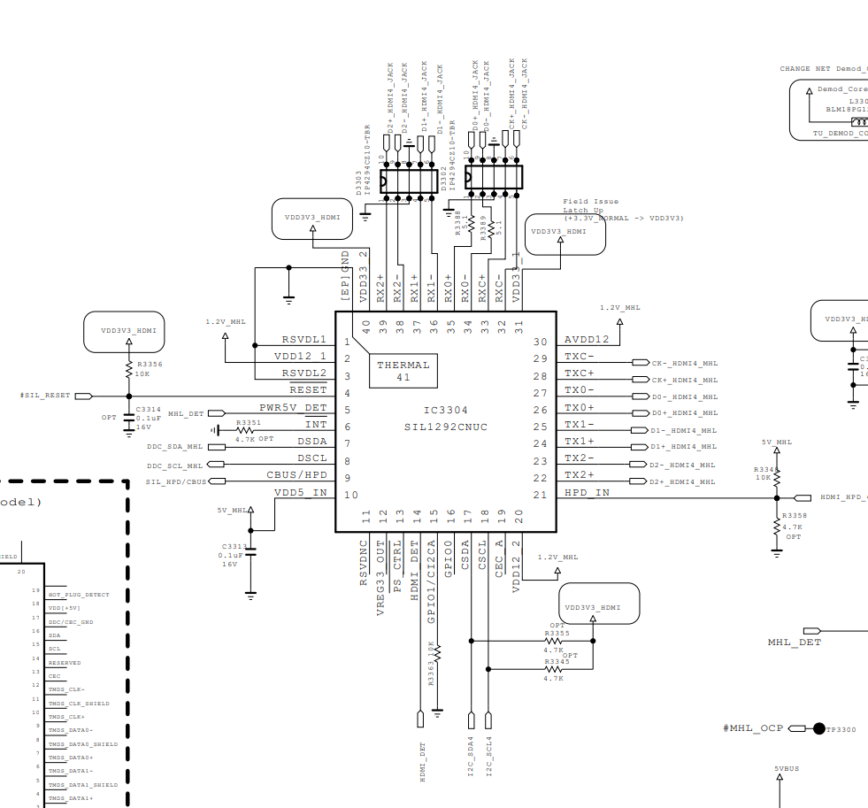

                  Ok will do thanks again.
                  IC3303 is the chip location.
                  i cant make out any numbers on the ic because its burnt
                  Sil1292CNUC
                    Which one would be the vcc pin?
                    • R_J
                      • Jun 2012
                      • 9588
                      In this case it's VDD5, pin10 5v

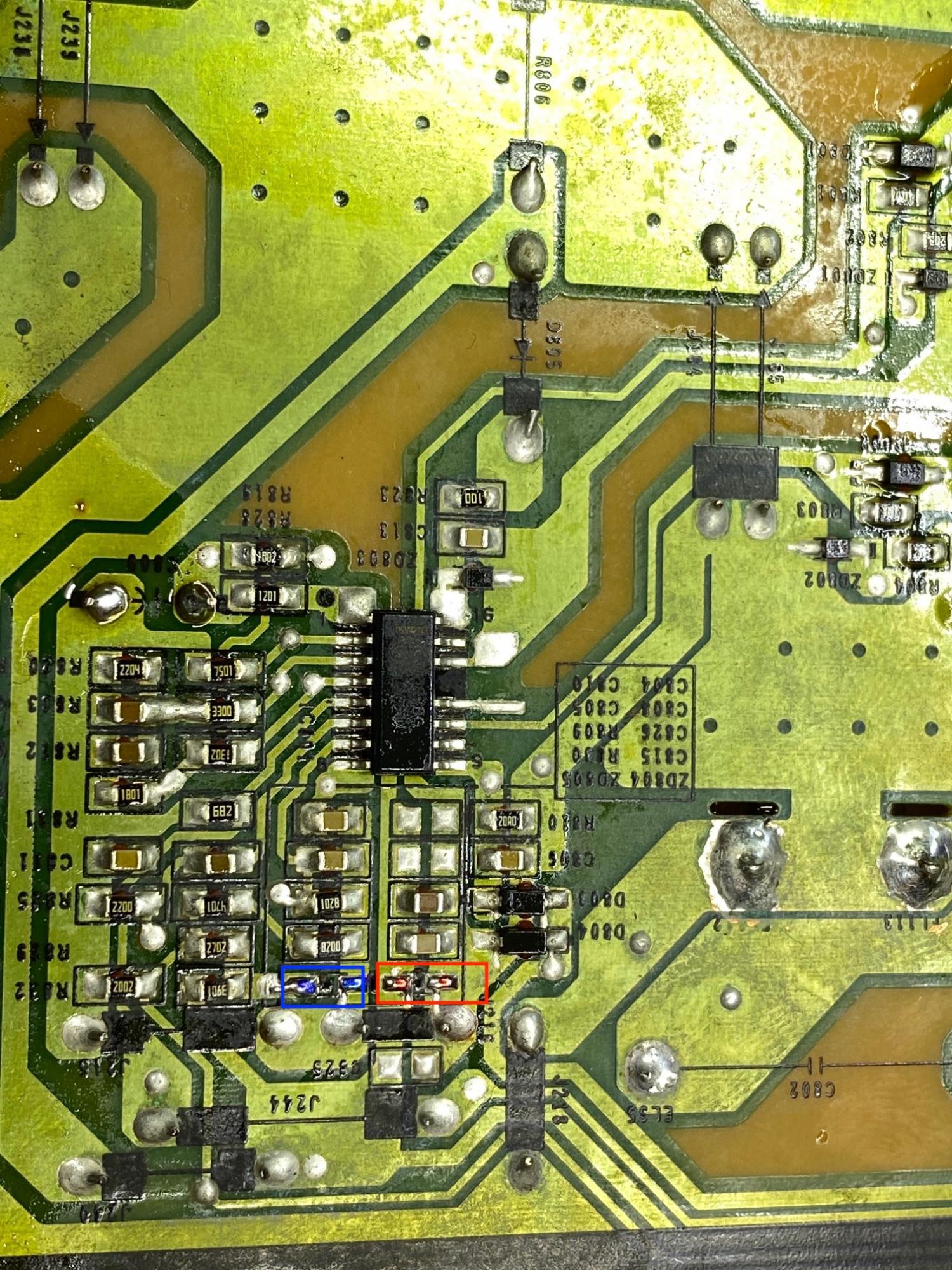

                              Hi, Do you have a schematic for the SMPS power board (EAX64880001) ?
                              During servicing the one I'm trouble shooting, I remove a couple of what appear to be tiny diodes on the back of the board near IC801.
                              The diodes are marked:
                              33
                              BE
                              15
                              BG
                              (no way to read them unless under a microscope).
                              Now I have them pulled off and realise they are different components with different values, I have idea which one goes in which spot, or which way around the diodes should be. A schematic would help out with this.
                              Any chance you can help with either measurements from your board (OHMS value for each, and Diode test so I can identify the values and placement direction?)
                              I've marked the read board view attached image with red box and blue box indication their location on the board.

                                  What is the number on IC801? that might help, I don't think there is a schematic for this board. The two diodes are zener diodes, one is 15v one is 33v, The anode end of each diode likely connects to hot ground.
                                  If it is a L6599a?
                                  I suspect one (ZD804) connects to pin 12 vcc line.
                                  I would think ZD805 (blue) would be the 33v zener and ZD804(red) would be the 12v zener.
