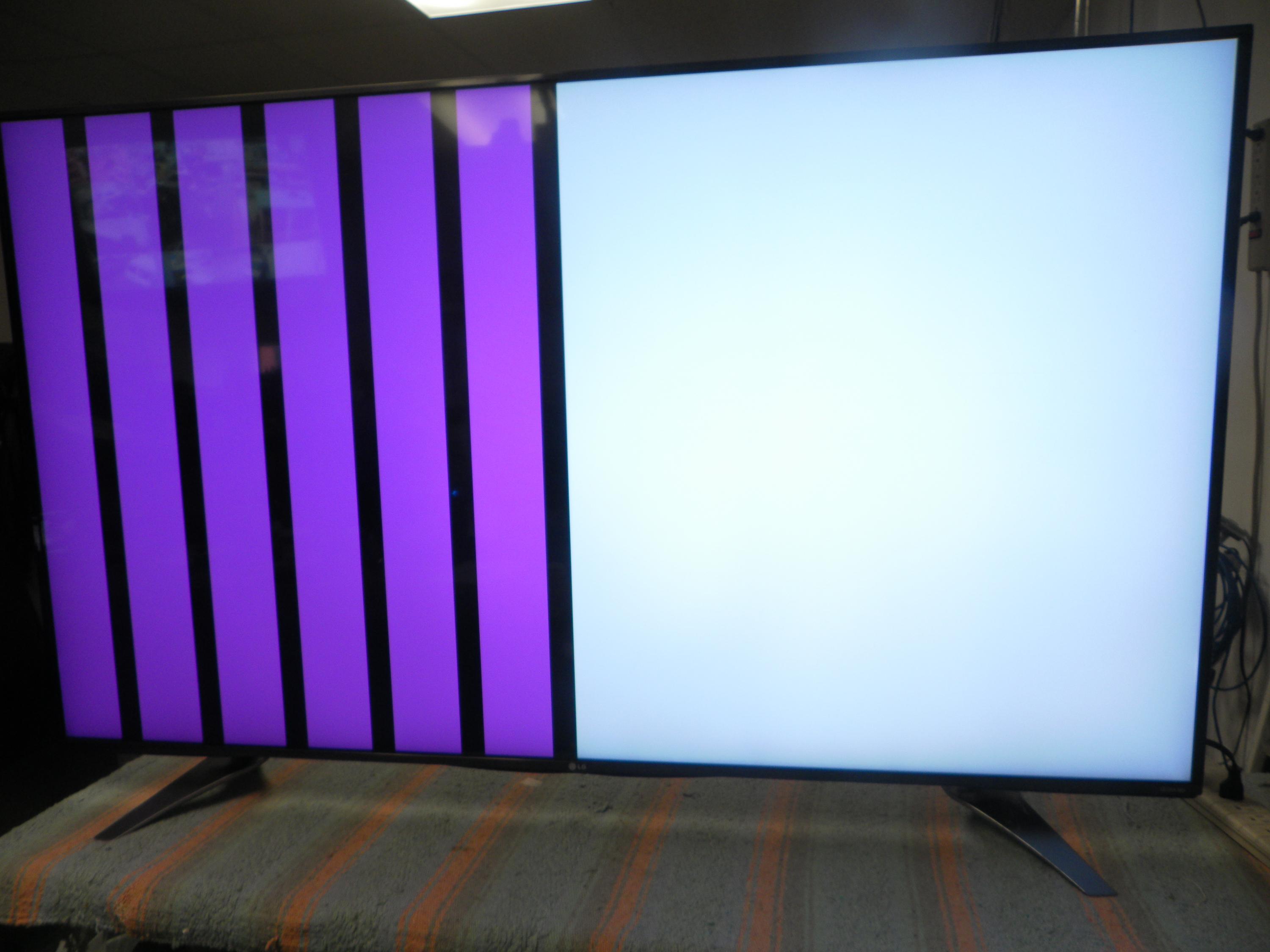

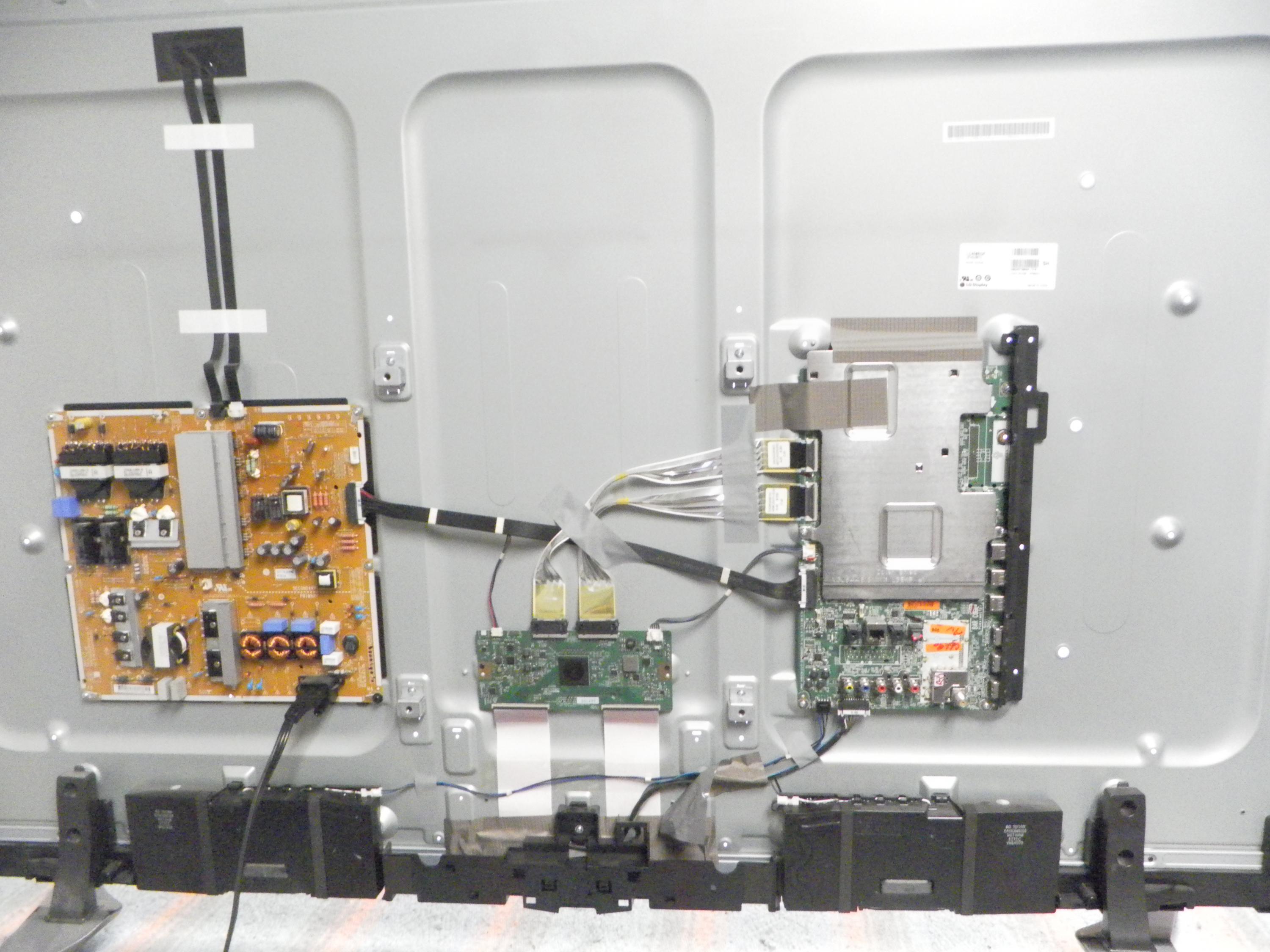

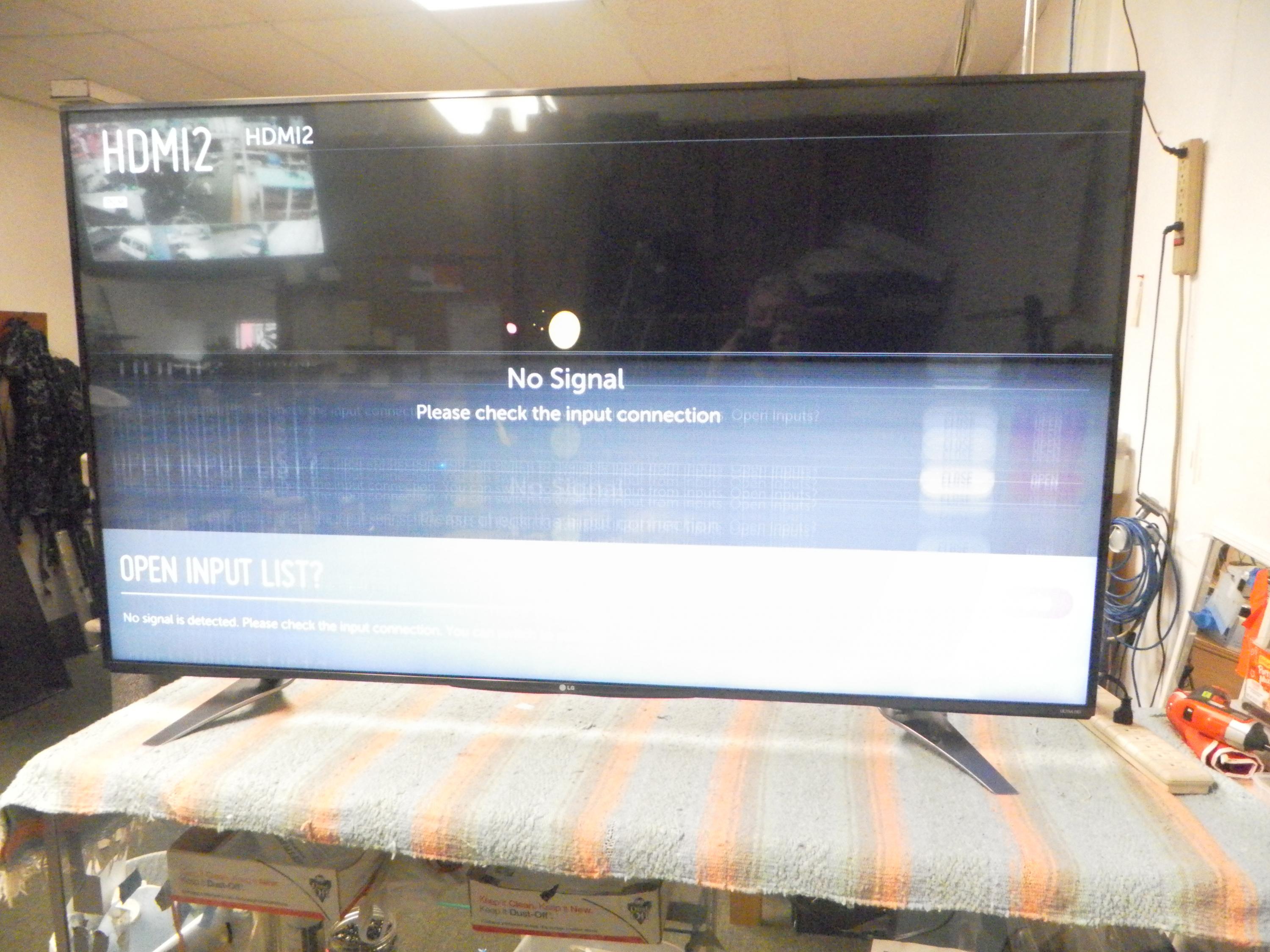

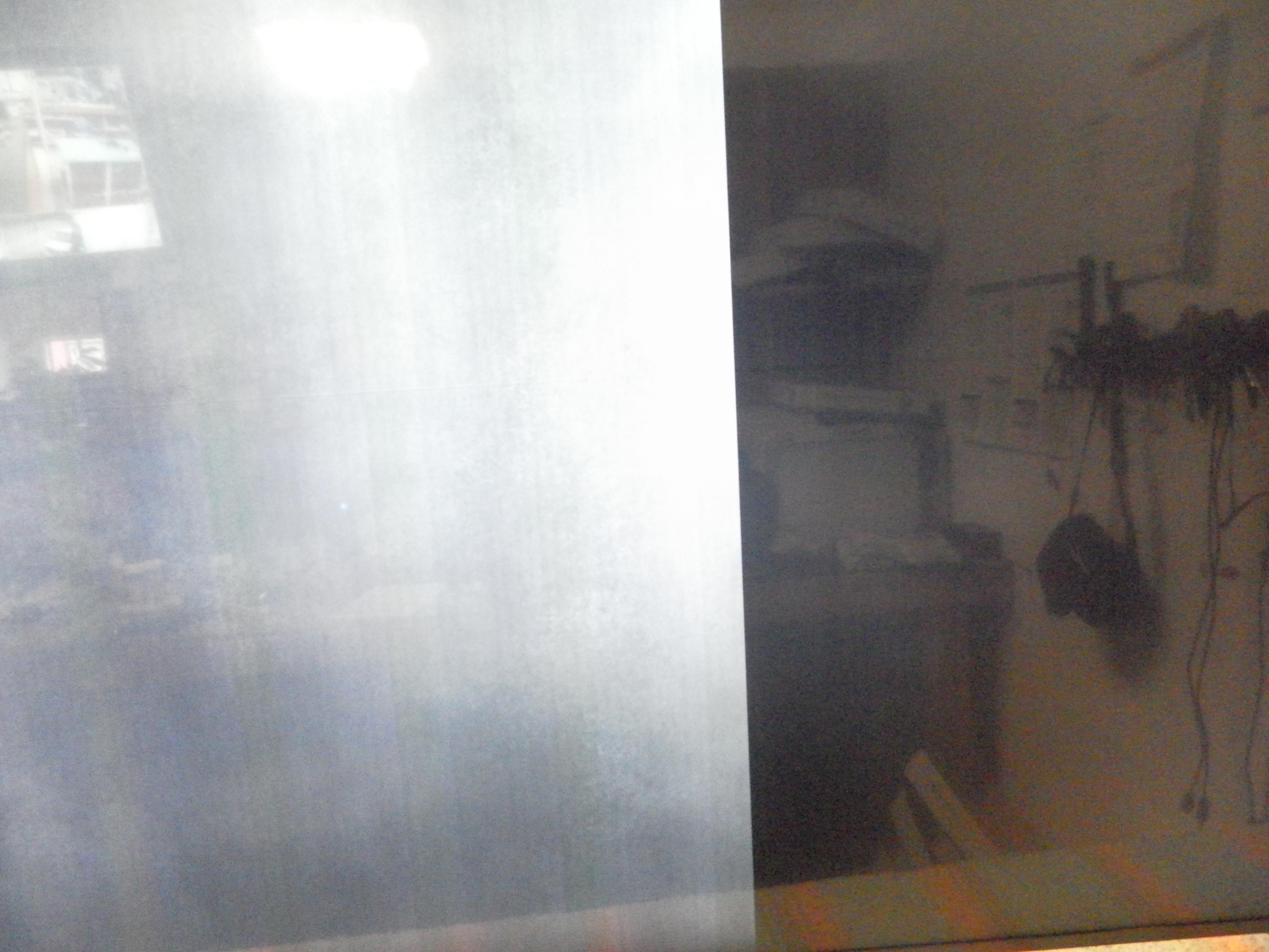

    When both sides of the Tcon are connected the TV picture looks like picture one and according to the person who owns the tv originally the problem was on top. If I disconnect the left cable to the Tcon then it looks like picture two and if I disconnect right side it looks like picture three. Now with either side disconnected the picture that is showing will start to fade. I am pretty sure bad panel but I have not ruled out the Tcon and am asking for advice. There are no side tabs so tab removal is out of the question.
    Re: LG 65uf7690-uh picture problems
    Panel problem, since the tab bonding boards are on the bottom edge of the panel, you should inspect them, also inspect the side tabs (Gate drive) if it has any.
      Looking like panel issue, the cutoff tape method might get you a good image.
          This is the Mainboard, I did one recently.
          Common fault for the UF series.
          Notice the menus are still okay.
          There are revised boards available from LG suppliers.
            The difference is my menu is not ok so that usually is the panel.
              as suggested, try the "tape cutoff" method (placing a bit of tape on the tcon cable to block certain pins) and see if you can get a proper picture.
                  Thanks for the response but still does not fix the tv issue. No mater where I put the tape the video still has lines in it.
                    Cut tape works on a lot of m, try turning down your backlights not brightness if possible, see if the double image clears up any.
                      After playing with the panel I found that the right side connector if pushed on clears up the picture so I am going to play with it to see if maybe it is just some bad solder.
