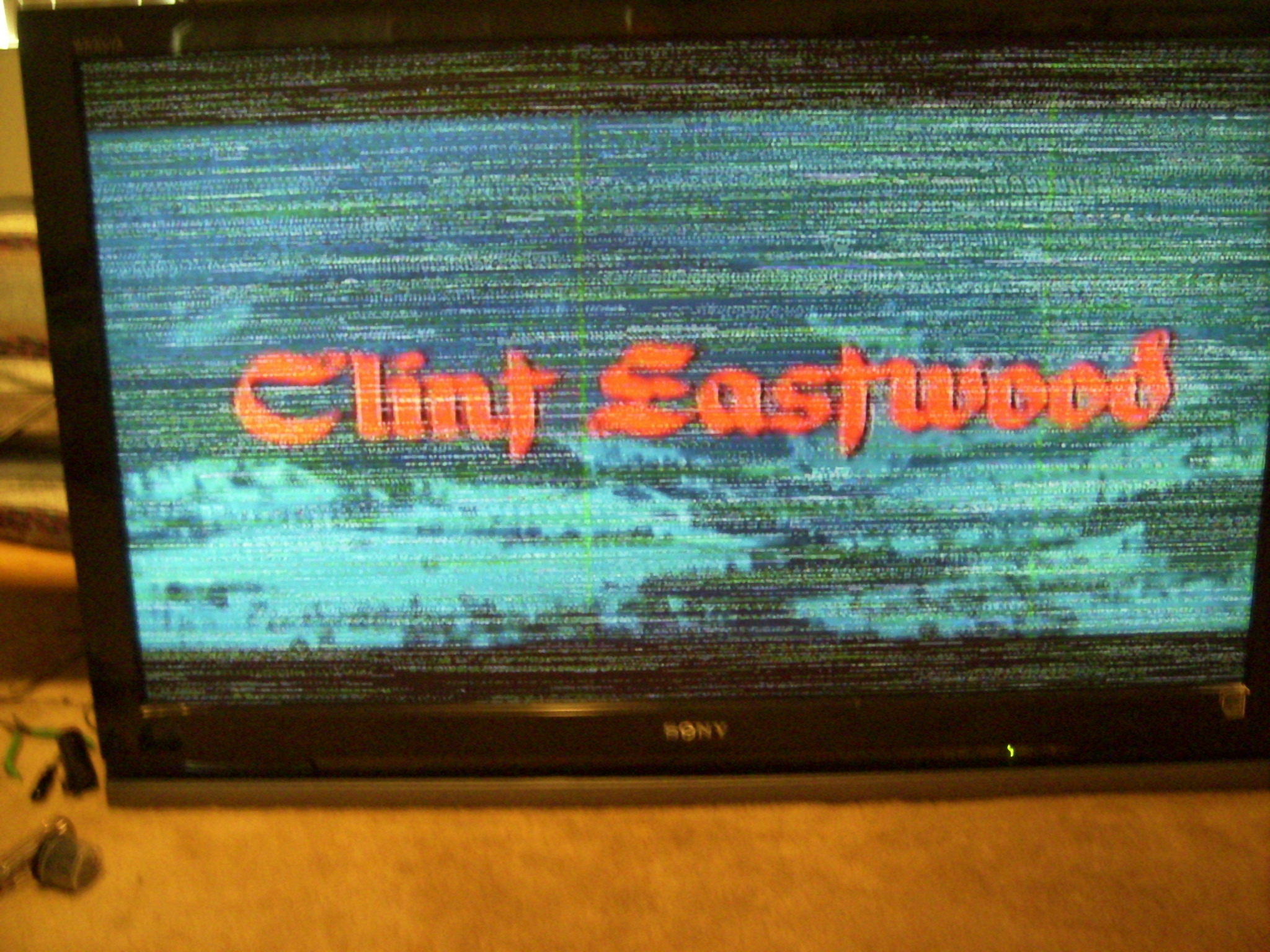

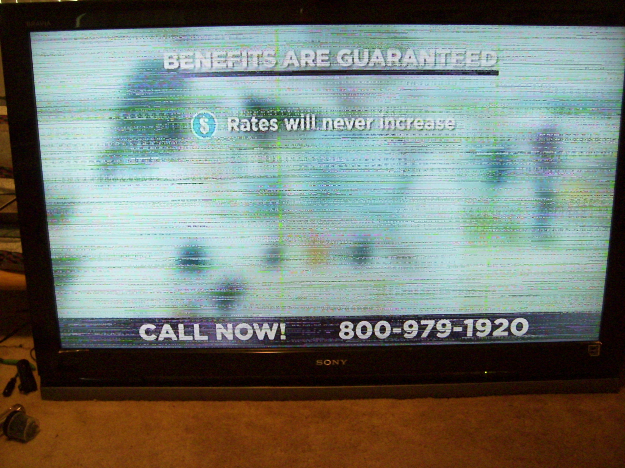

    I have a Sony Bravia curb find with the following picture:
    Network TV with an antenna:
    DVD with HDMI:
    Typical Menu:
    The internal TV Guide:

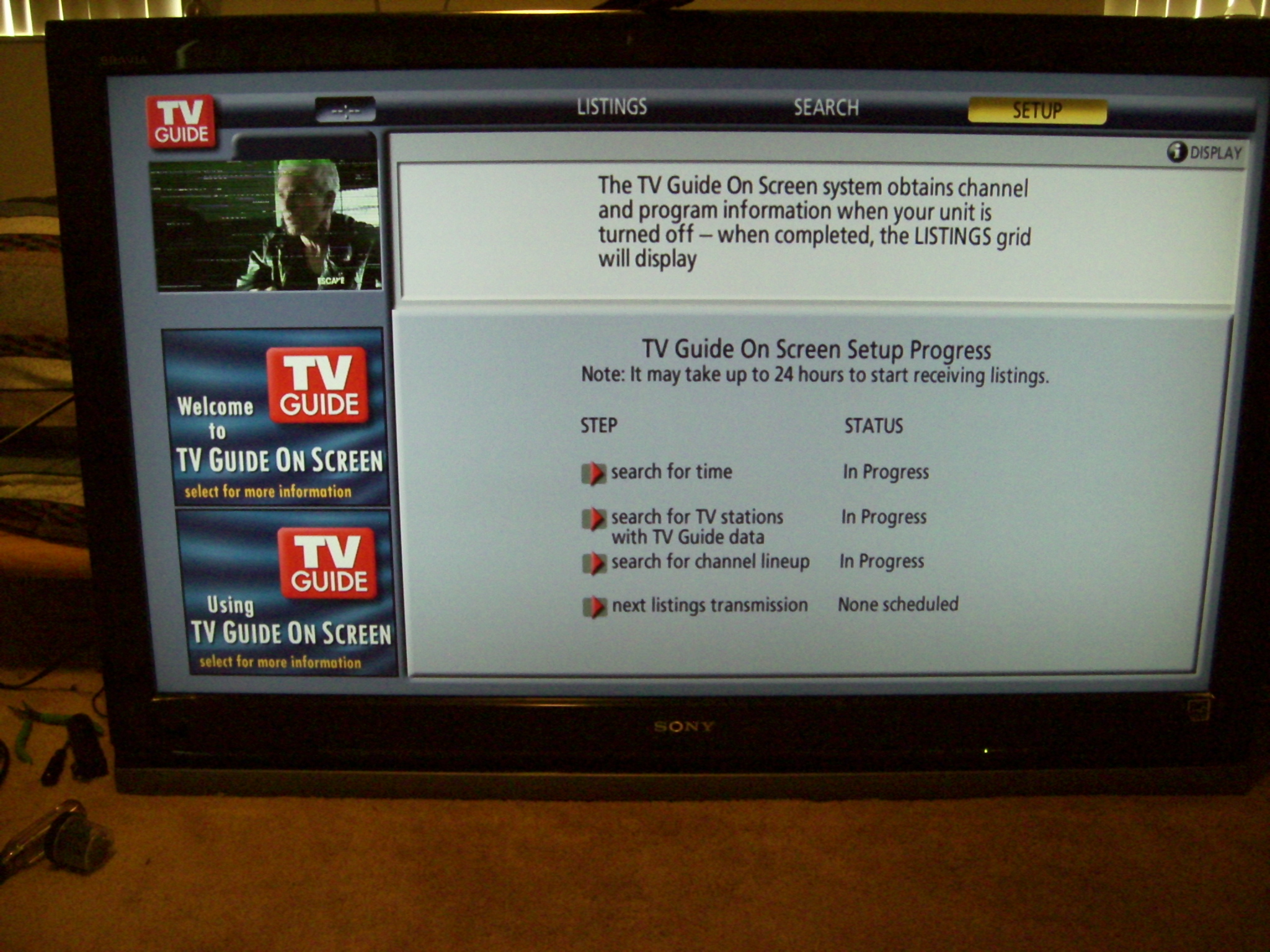

    With just the first two pictures, I would have suspected the T-Con being bad. However, don't the menus and display stuff also go thru the T-Con? Wouldn't that rule out the T-Con?

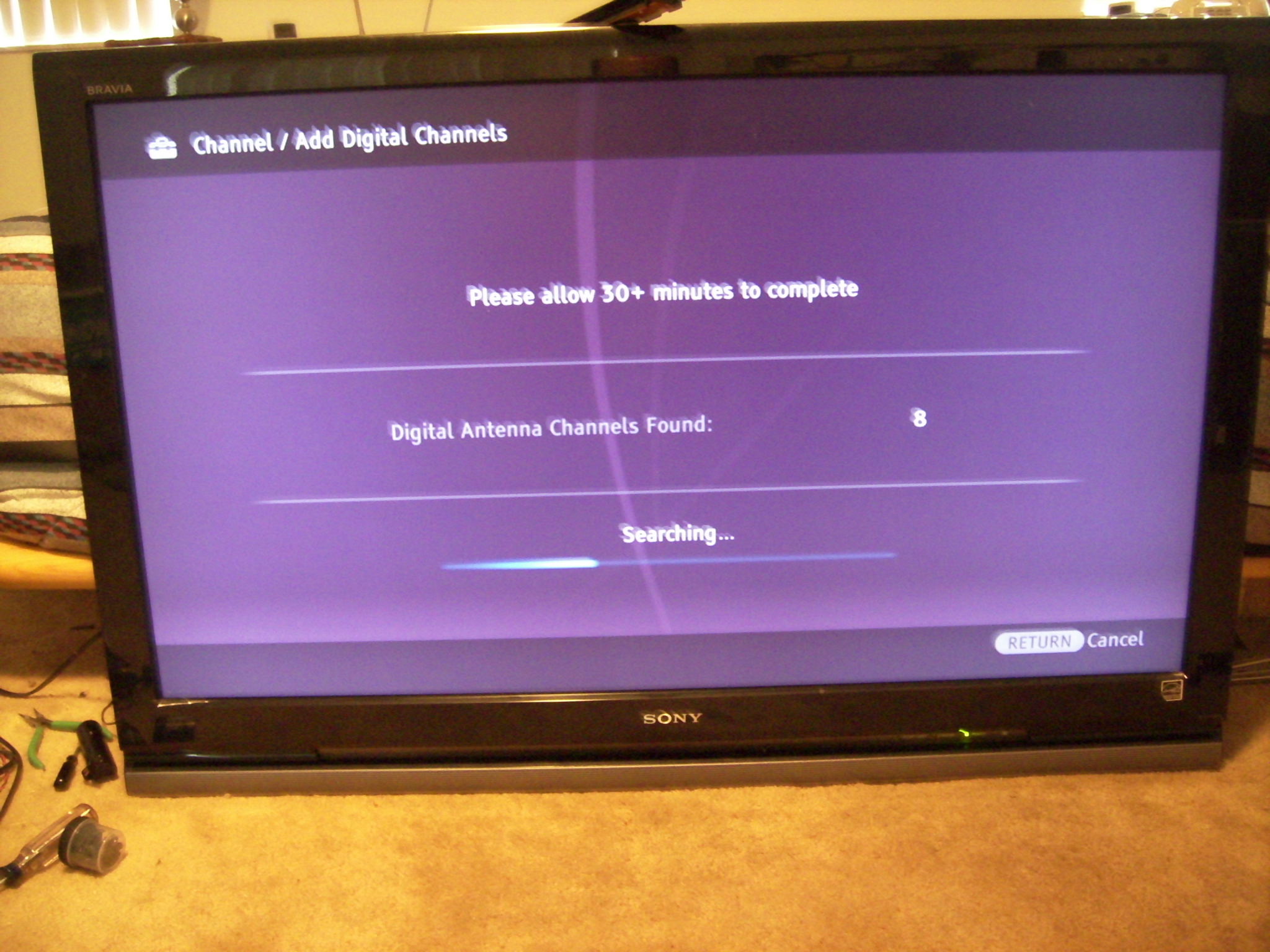

    Another thing that I notice, is that it scans around 20 digital channels, but I can only get four (23,1. 23.2, 23.3, 23.4) to display (I don't have a proper remote, so I am not sure exactly how to get them to display). I am using a simple rudimentry antenna, so the signal level might be low, but normally, if a TV will scan a channel, it will display it. The TV is a pre-2009 switchover model, but it has both analog and digital tuners.

    T-Con

      I would try a couple of the other input types to see if any of the main board inputs work. Also what resolution were you "pumping" in.... of course, probably no control of OTA but on the dvd, you can force a given resolution beside "auto".

        Even with the good display of menus and the TV-Guide? Aren't they also serviced by the T-Con?
        As for the inputs, I tried most of the HDMI and also the composite video inputs. They were all basically the same.
          Re: Sony Bravia KDL-42V4100 Problems
          It looks to be main board problem with video processing. What happen if you try cooling or heating the main board?
          https://www.badcaps.net/forum/attach...7&d=1555444232
          The preview picture looks bad.
          Should try other video sources too.
            Yes, the preview in the window is bad. I just assumed that the preview was just a video overlay.
              you can put JPG format Photos on USB and display them. and you can compare it when you display MP4 film format from USB too at same USB Port and the same USB Pin on the TV.

                  Doesn't look like T-Conn problem to me.
                  Menu and Guide overlay go through T-conn as well and look crystal clear.
                  If it was only the antenna input then I would suspect poor grounding or broken solder connections to grounds in the antenna module.
                  However, the problem is more widespread so I suspect bad surface mount capacitors in video and input sections of mainboard.
                  There are a LOT of surface mount caps on this board and many have probably drifted out of spec with low capacitance or high ESR. I would definitely suspect the 100uF/16V ones and possibly 220uF/16V.
                  Try applying heat to certain capacitors while TV is on to help narrow your search.
                  All capacitors should be checked, and replace faulty ones.
