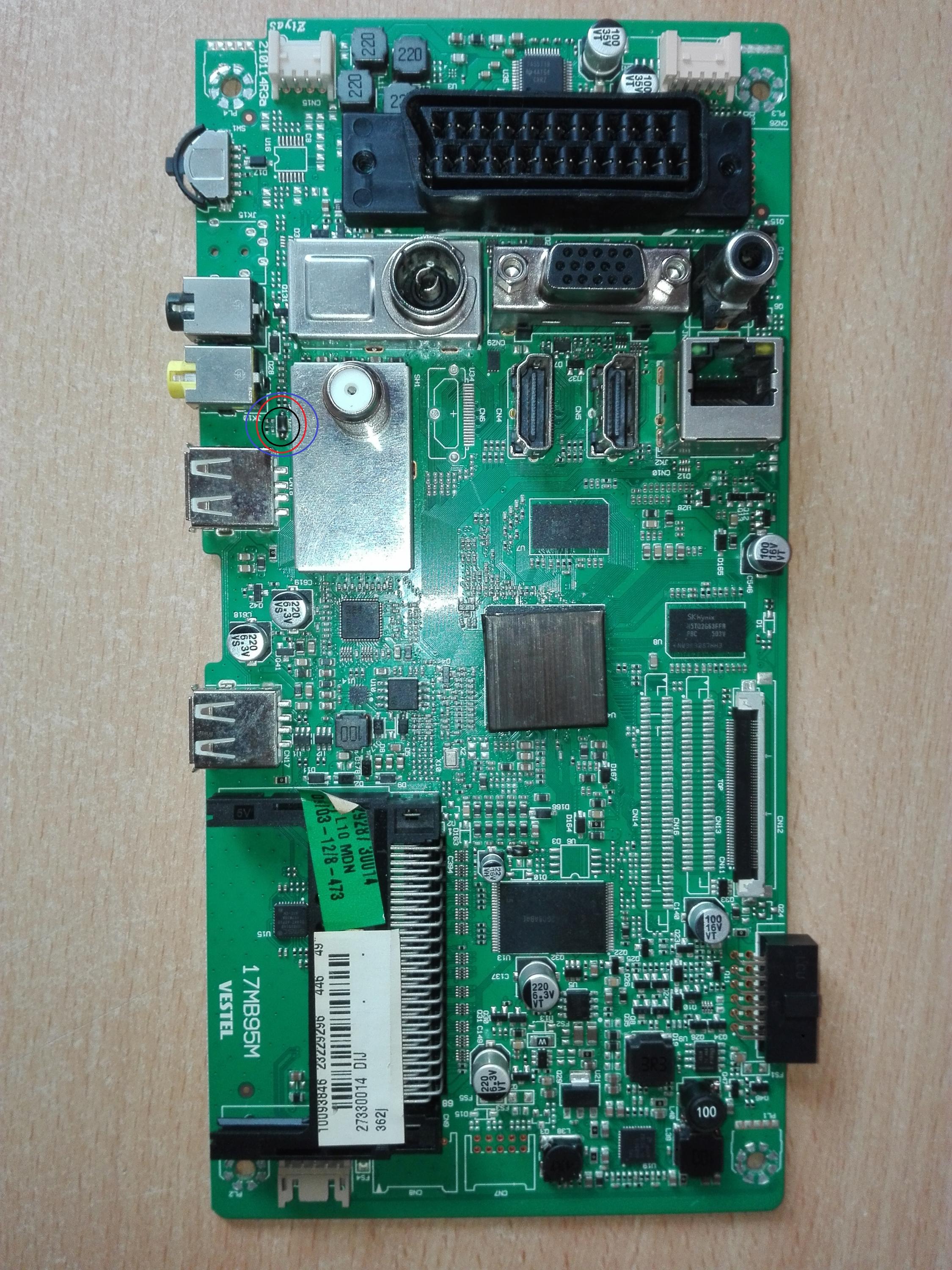

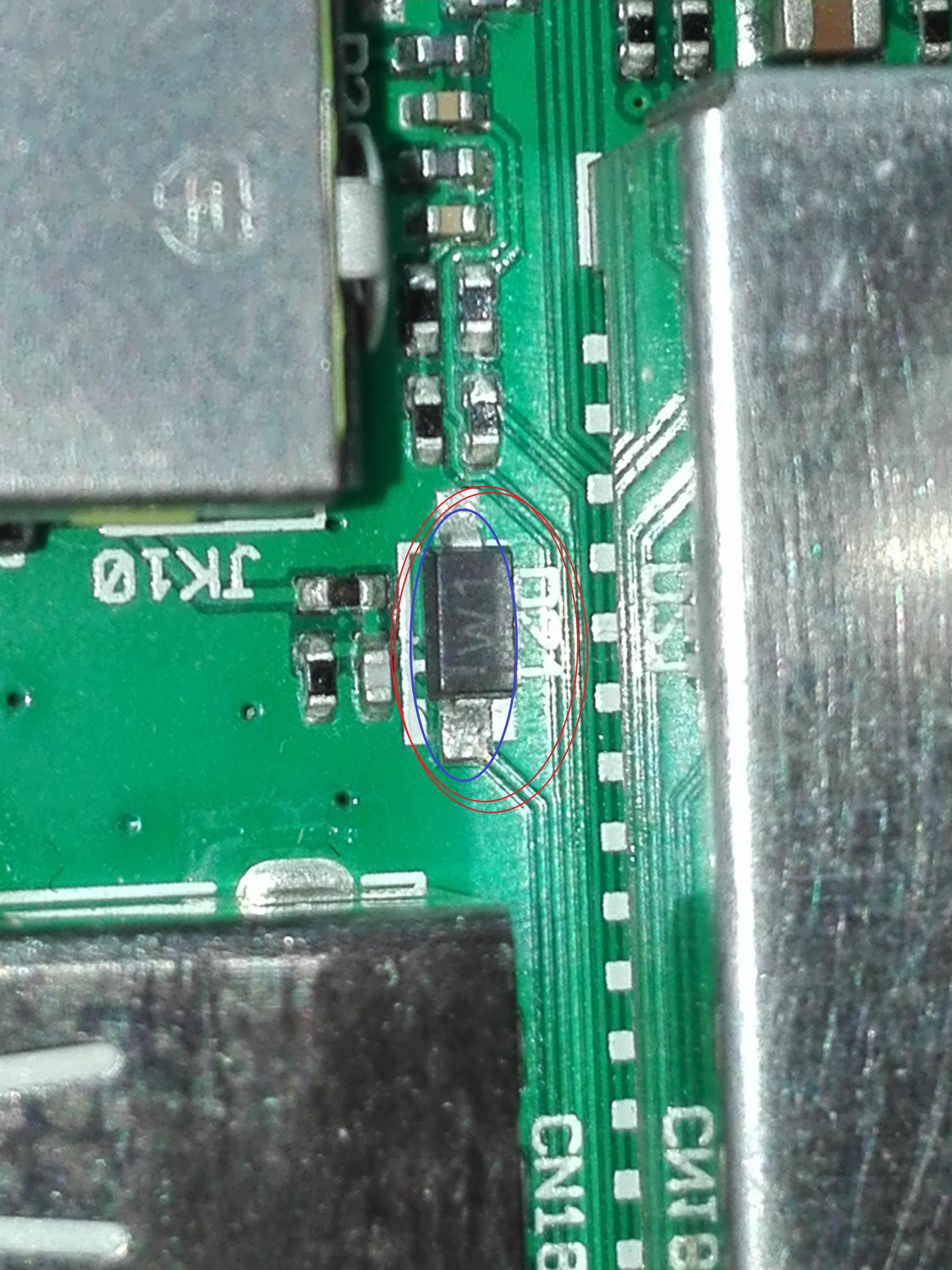

    Hello
    I have here Vestel a mainboard of Telefunken D49F283N3C
    I have a short here with diode W1 D21, I have also desolated but still the short circuit remains, can someone help me?
    many thanks

      Re: Telefunken D49F283N3C AV-Board-17MB95M-210114R3a
      Hello.
      https://yadi.sk/i/ICWwlsNPtBu_cQ schematics. remove jk10 and check again.
        Hello I have the removed and now no short circuit anymore
          Hello I have removed that but did not help me
            Did you replace it?
                Originally posted by samtron123
                No, unfortunately, without replacing, just tested if that works
                I am looking for a dump file
                You have to replace it.
