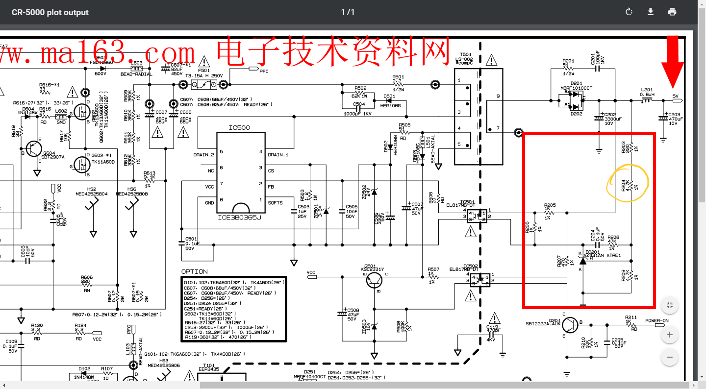

    What resistor(s) do I have to change to reduce the standby voltage from 5V to 3.5V? See attach photo. I have several brand new LGP32-09P that could be dead stock so am trying to use them to replace LGP32-11P. The amps and voltage rating are written on both supply and are the same except for the standby voltage. I also know that the arrangements of the voltages at the connectors are different but I can fix that problem. I just need to get the 5V down to 3.5V on the LGP32-09P in a professional way . Thanks for helping in advance.

    Change R204 to 1.5k resistor in the red rectangle..

      Sorry it only took it down to 4.2V

        1.5k should be the correct value. The resistors used in the schematic are 1% precision resistors. Are you using a 1% resistor? Measure the value of the resistor with your meter to determine it's actual resistance.
          Re: Replacing LG PSU LGP32-11P with LGP32-09P?
          BTW, when you bring down the Voltage from 5V to 3.5V, you need to adjust the value of R205, 206, 207 according otherwise the Opto current transfer will not be correct.

            I did used 1.5k @ 1% and I did test before I install

              I think I can solve the problem if I get a schematic Diagram for EAY60868901 LGP32-10P, EAX61464001 power supply

                You canΒ΄t go below 4,5v with a zener programmable , ic201 , which have a reference voltage of 2,4v .
                Change it with an az431 1,24 v reference voltage.
