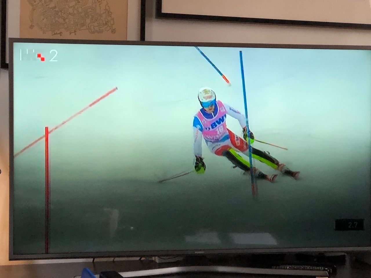

    Hello...

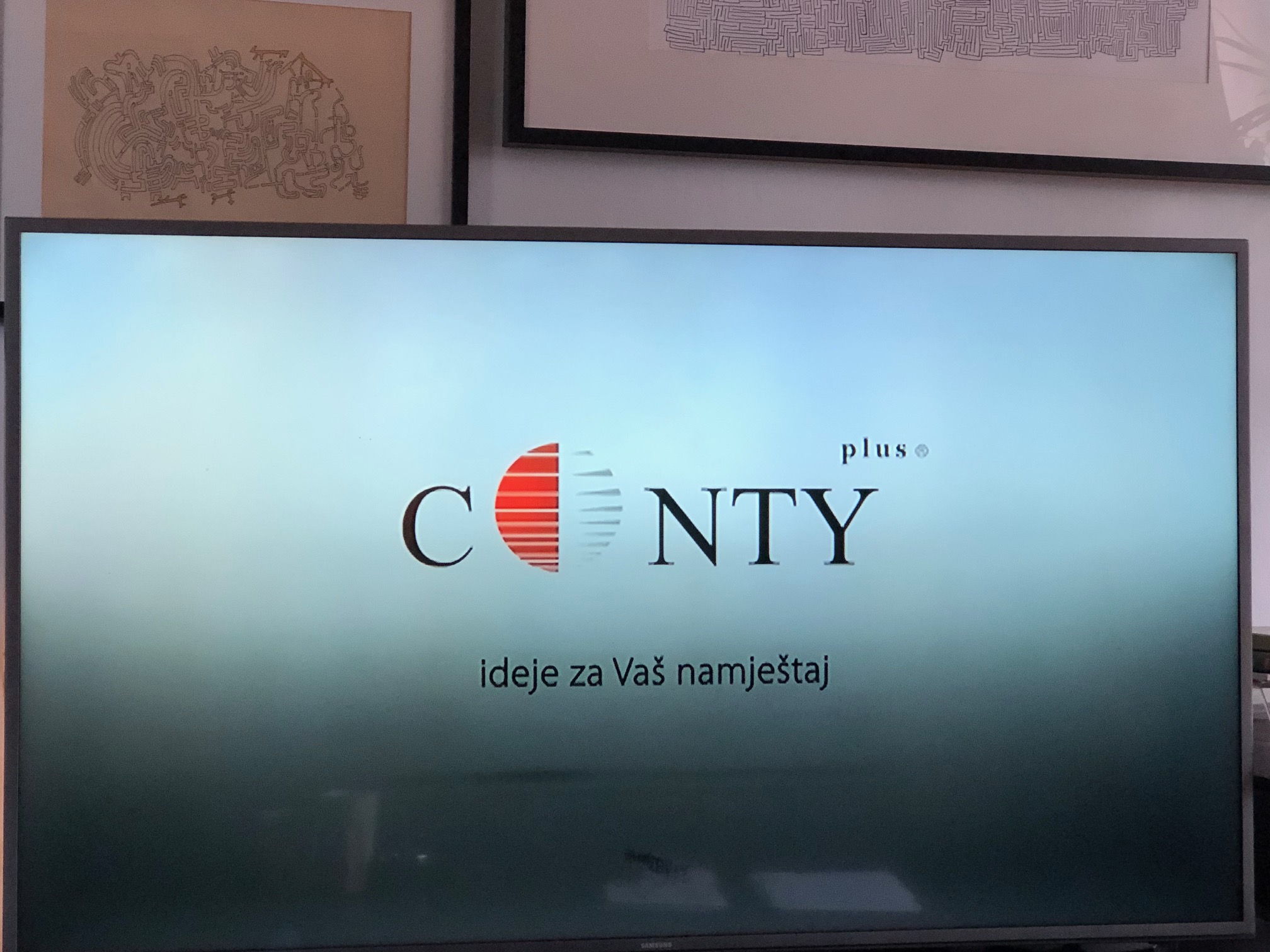

    I have a problem with Samsung UE55JU6872UXXH.
    Lower third of the screen is darker than the upper two thirds.
    Is this a LED problem or LCD panel problem?
    Two photos attached.

    to me its hard to say the reason, unless if you show us clear photo of your PSU and the LED back light socket. also some reading on it with DM

      measure the voltages on each LED string.

          My guess would be bad led's (shopjimmy is out of them) Looking at the power supply board, there are two seperate strings for the backlights and there are LED Test points marked on the board near the CNL802 connector
          the voltages are different for each line. [2D] CH1 227v @500ma CH2 182v @500ma [3D] CH1 267v @1amp & CH2 250v @1amp

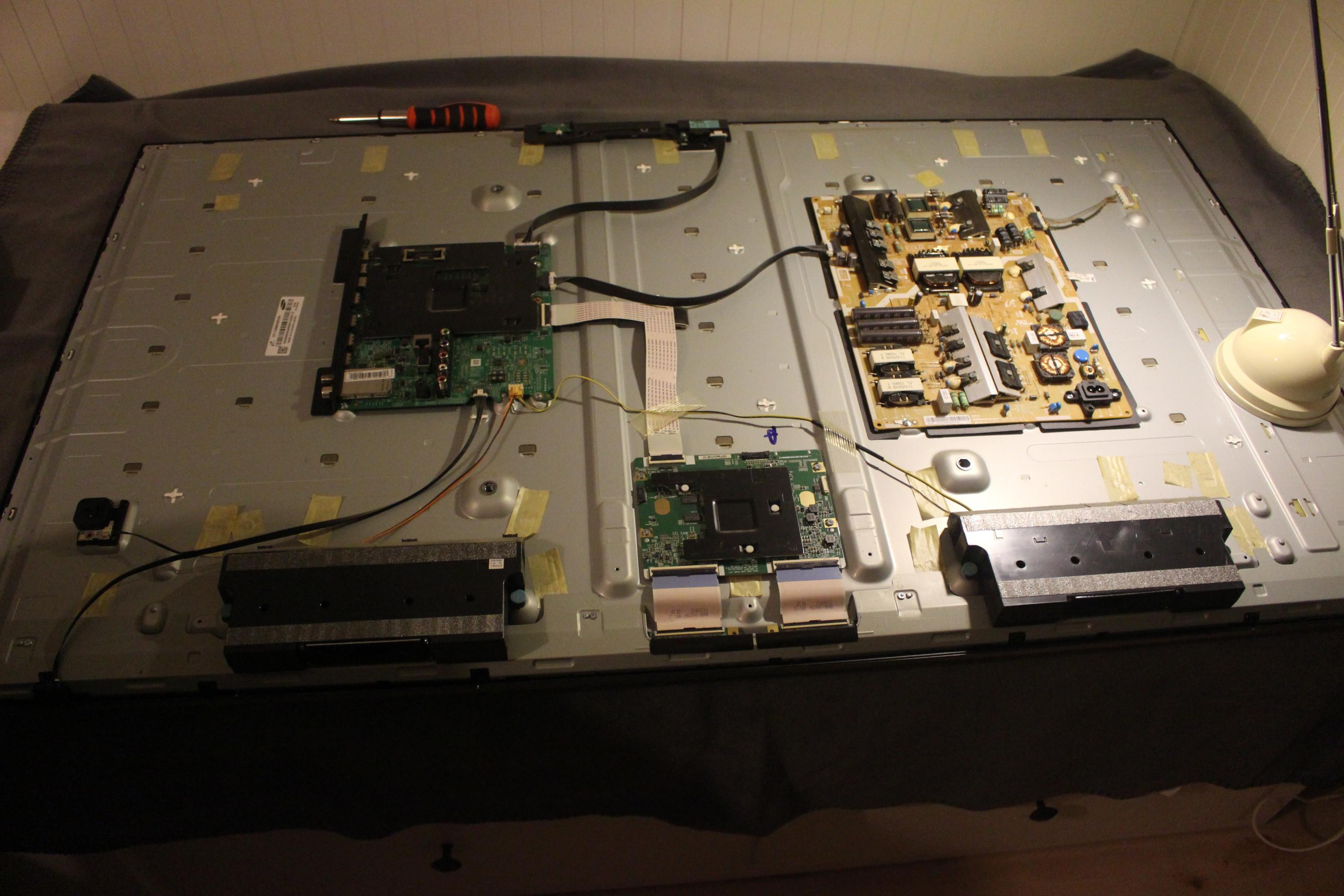

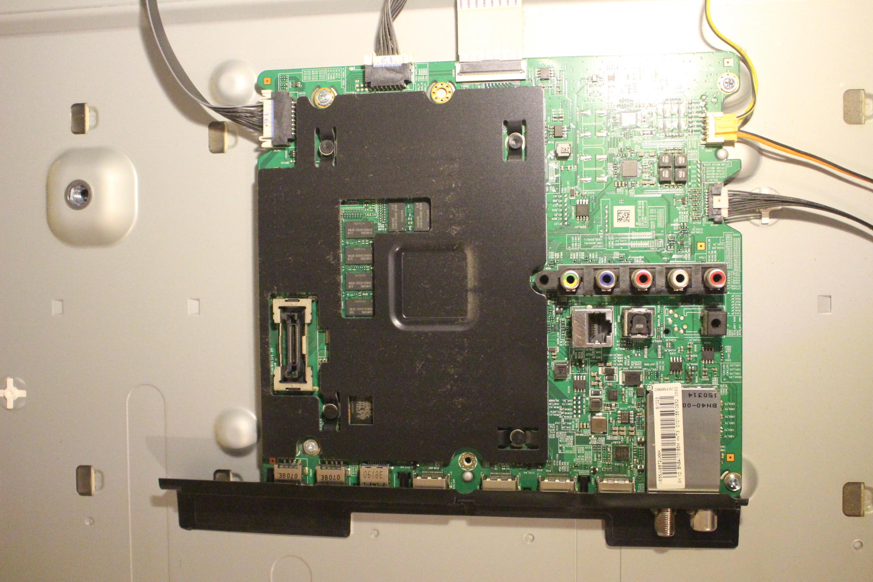

              Also need to provide good clear pictures of the whole backside of the TV showing all the boards.

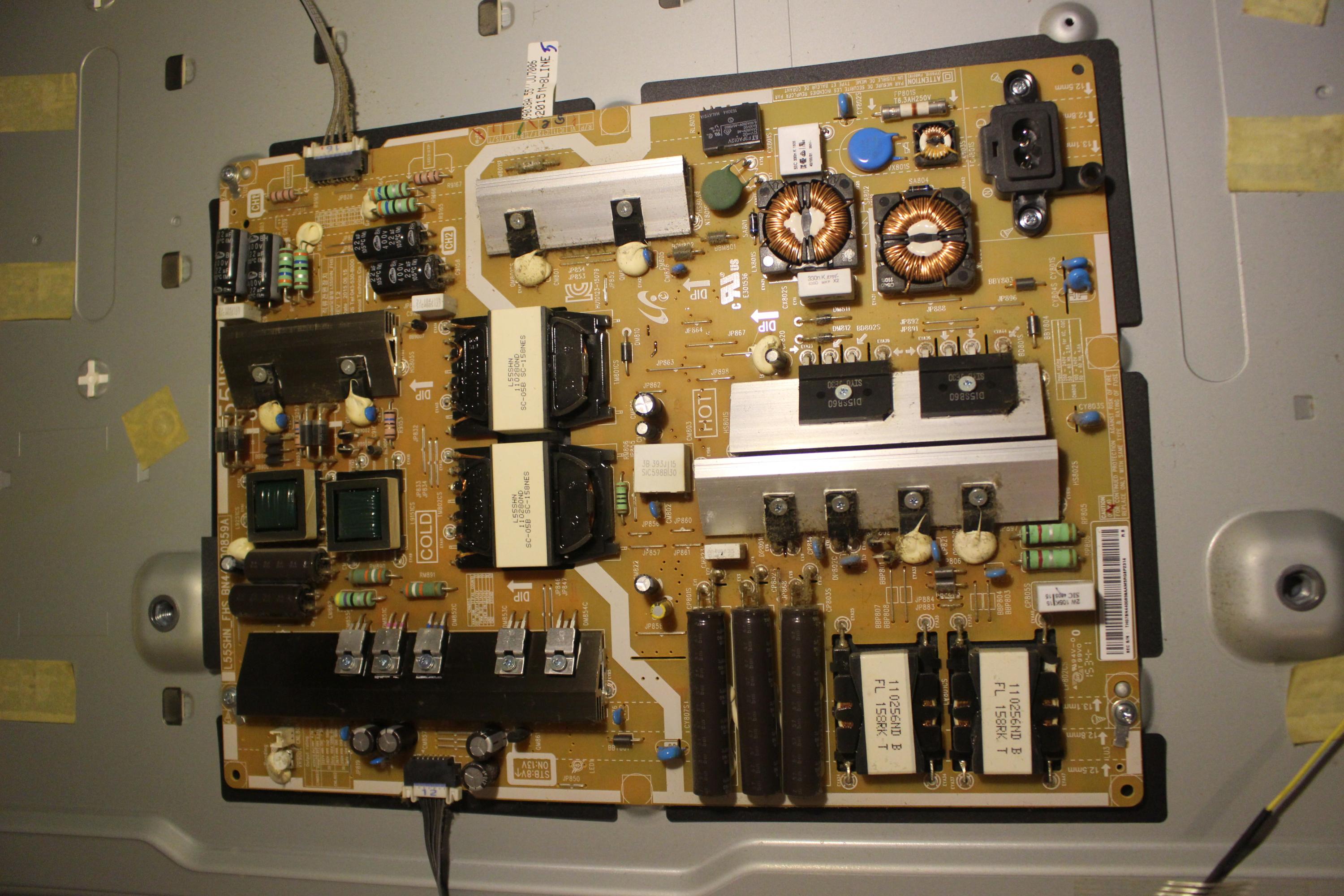

                Ok... I've managed to make photos.
                Power supply has alot of dust on capacitors and wires.

                  Re: Samsung UE55JU6872UXXH - Lower third darker
                  So blow off the dust and report the voltages as suggested.

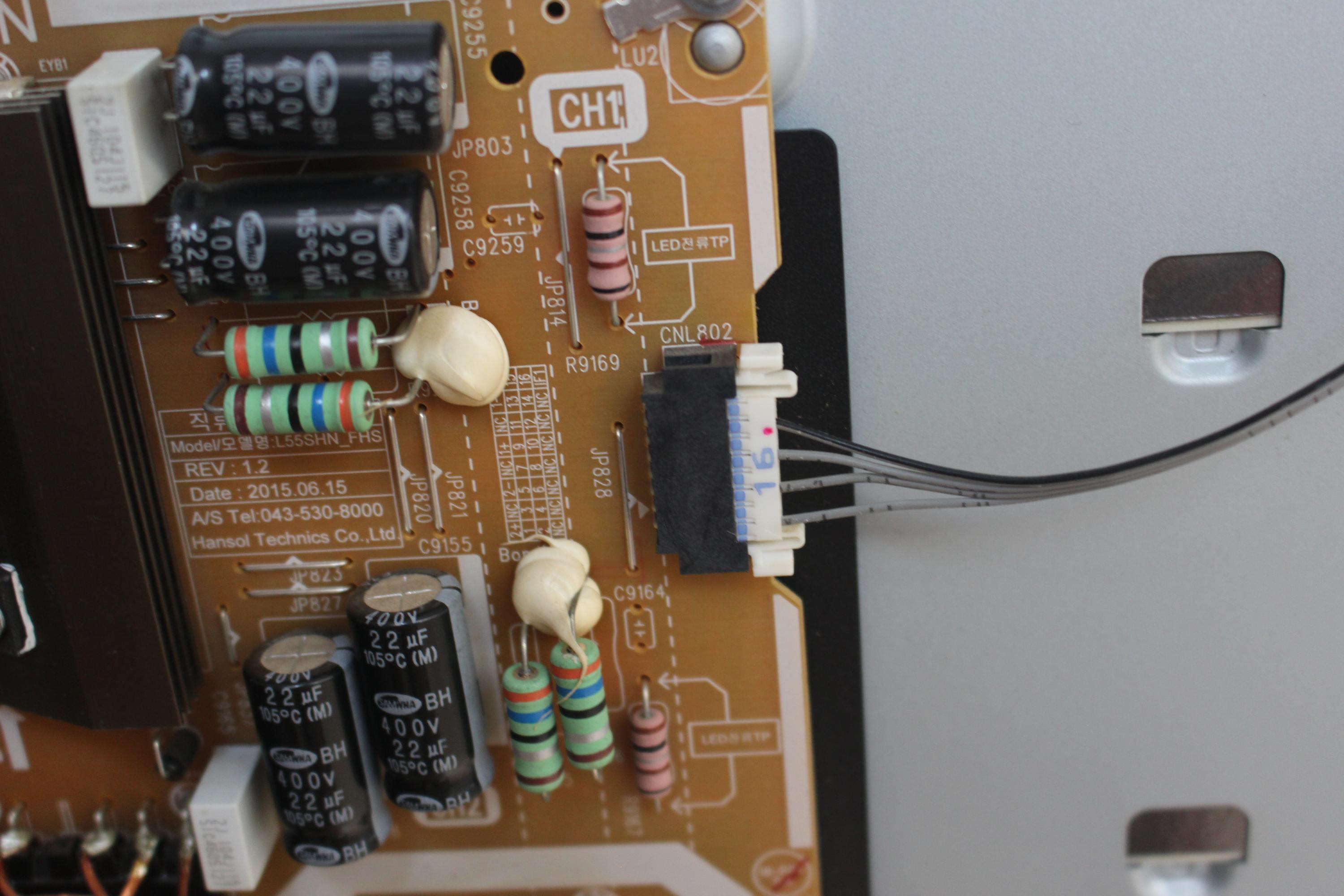

                    Near CHL802 are two resistors marked with LED TP, but when I measure voltage on these resistors I get 0V. I've measured by putting probes on ends indicated by arrows.
                    Should I try to measure voltage on the connector? It has 4 wires, one marked with black and three gray ones.

                      Power supply has this on it:
                      L55SHN_FHS BN44-00859A
                        I've measured voltages against chasis on both resistors.
                        Upper resistor has 160-190V.
                        Lower resistor has 40-60V.
                        Voltages varry on colour.

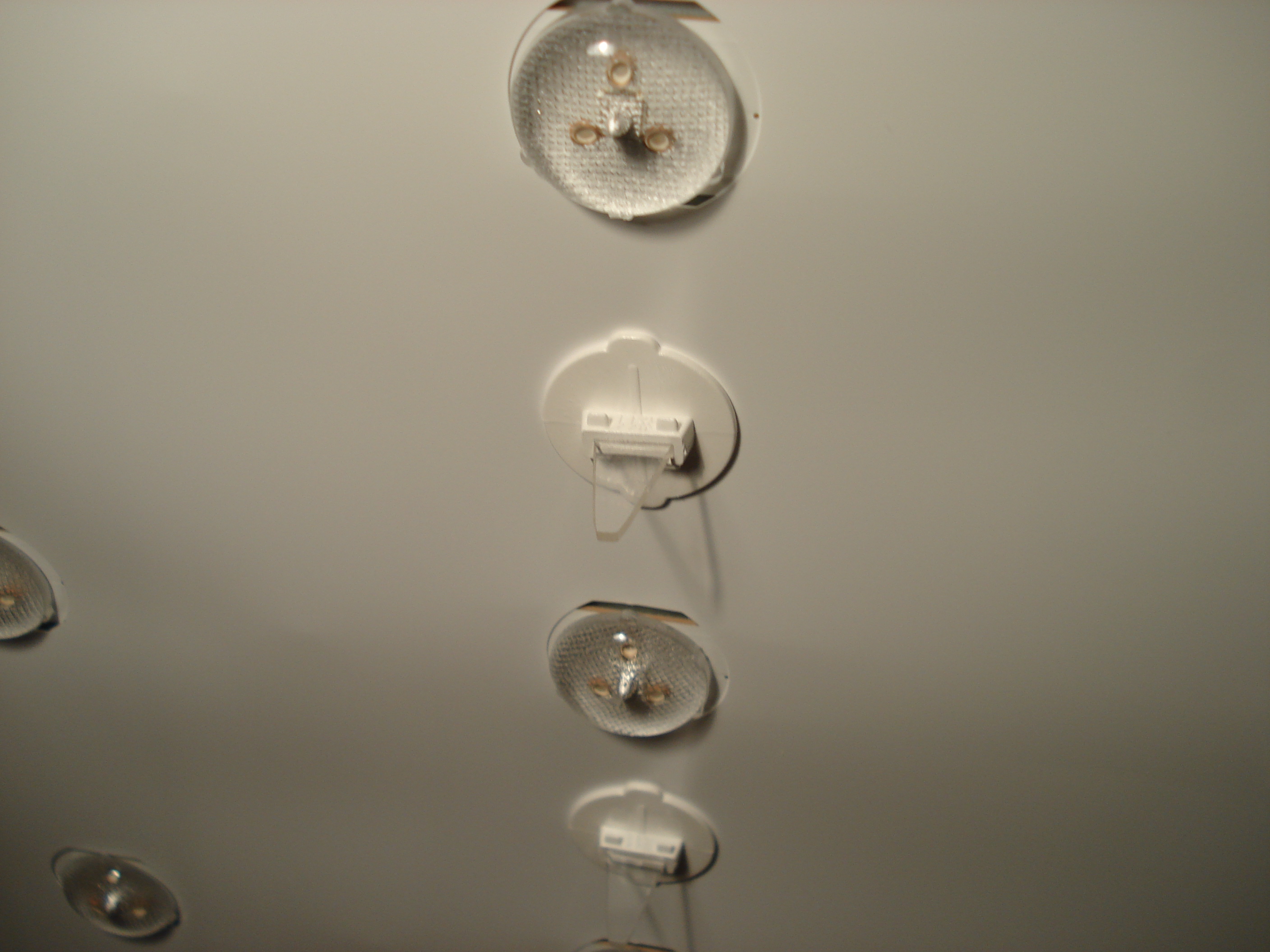

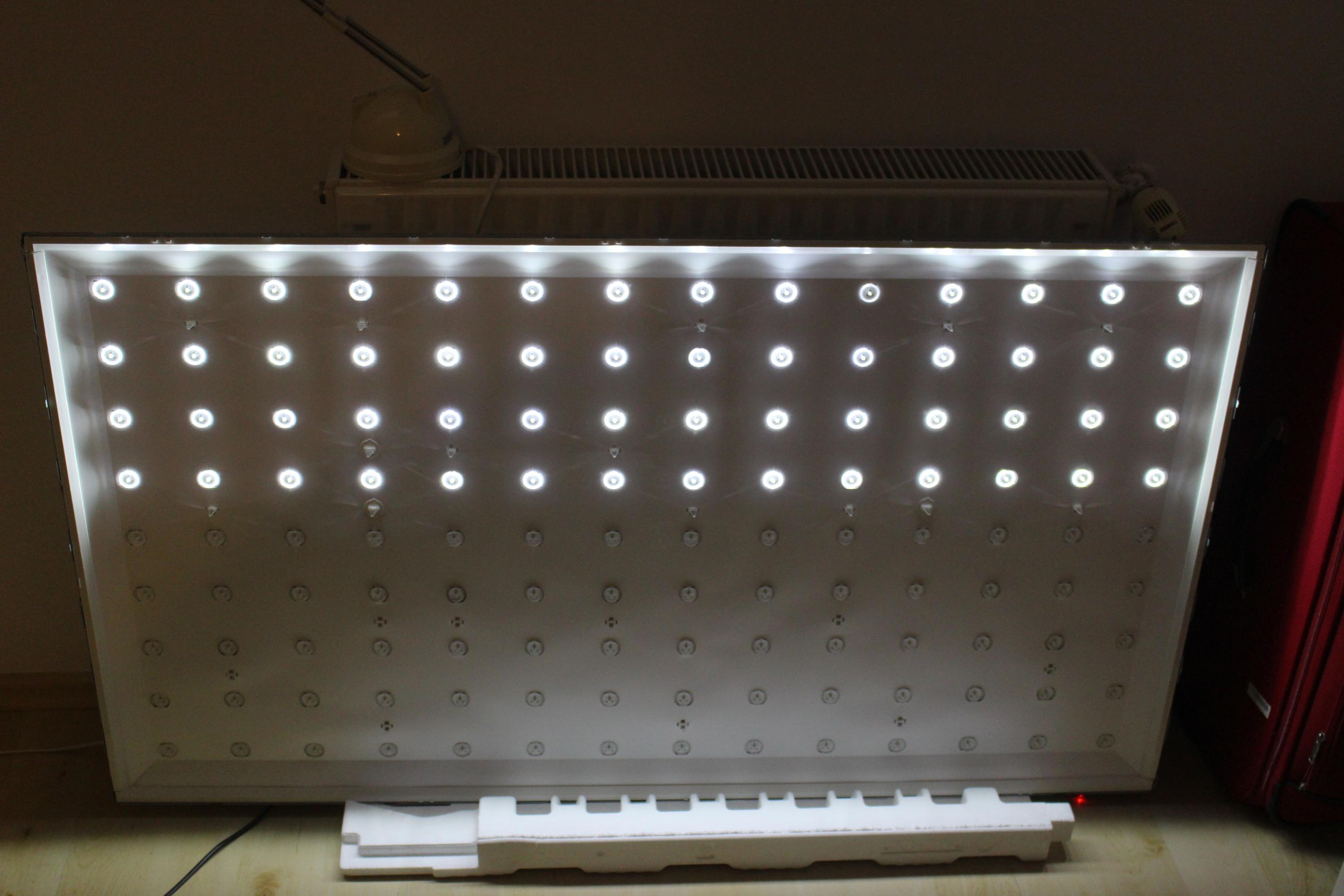

                            I got to the back lights... and this is how LEDs look like.
                            Now I have to remove the white plastic and test LED strips.

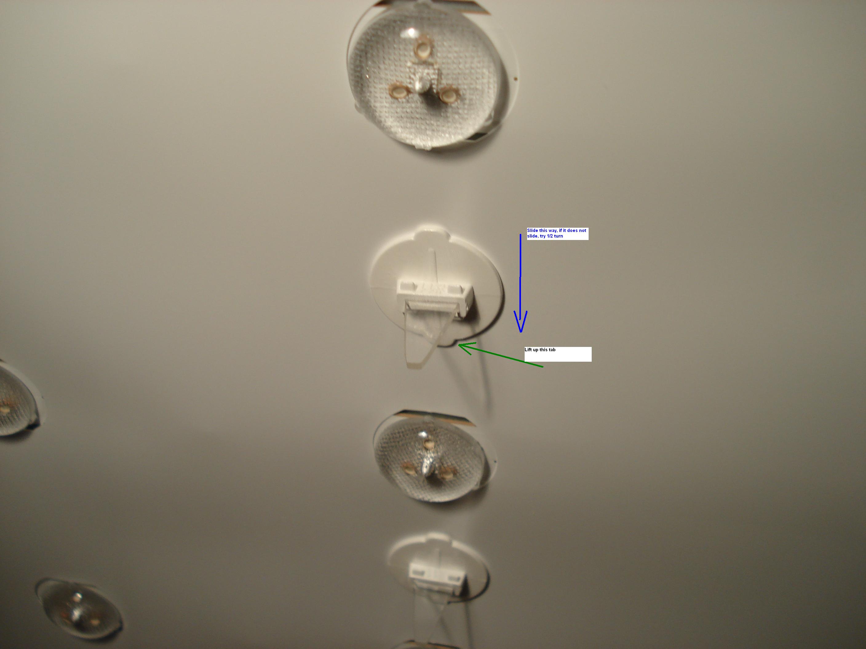

                              How to remove this white spacer? It holds reflective sheet... and back part is behind power board and other one is behind main board.
                                Look at the back of the panel where they stick through, but I believe you give them a half turn and the pull out oR you lift the bottom edge (pin) and they slide down

                                    There are spacers all over the panel. can't you see any of them from the rear? It is possible there are clips that need to be compressed from the rear to remove them but I'm sure I have removed them from the front before without a problem.

                                      This kind is special.
                                      Other ones have the cros cut around them and I do not think I have to pull them out. Only these few that are white.
                                      And I can see others at the back... and I think that they cannot be removed.
                                      I'll make some photos.
                                        Those standoff I turn it 90 degree and pull out.
