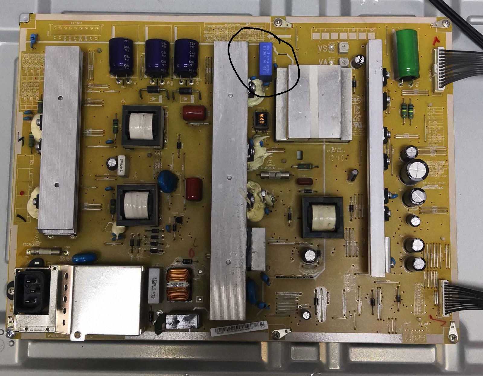

    Hi guys
    I got this TV from a friend. He complains about the TV switching on and off intermittently. I read all the threads on Badcaps about this issue. I also found a damaged Filter capacitor on the Power Supply (circled in black). It is a 68nF Cap, and I replaced it with a new one. I also checked for bad soldering joints, especially around heatsinks, also on the Y-Main Board and the Z-sub board.
    The TV now stays on, but suddenly it's got grainy picture. I cleaned all the ends on the LDV and FCC cables, but with no avail.
    Can the problem still lie on the Power Supply, or should I check for something else. The voltages on the connectors on the Power Supply when switched on is exactly as on the silk diagram on the board.
    Thank you

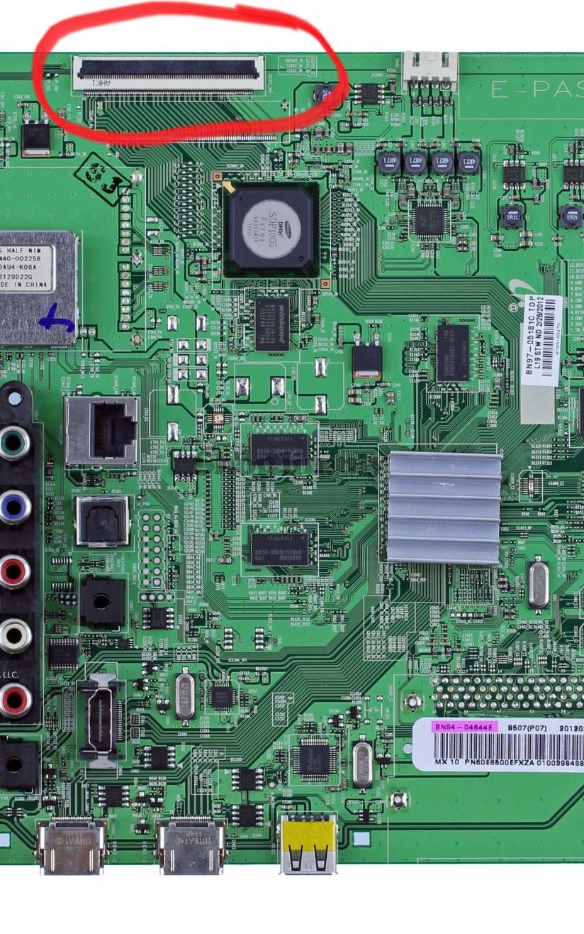

              Hi tvtimmy
              Can you please elaboratate on which LDVS cable to remove. Is it the one from the Mainboard to the Logic Board?

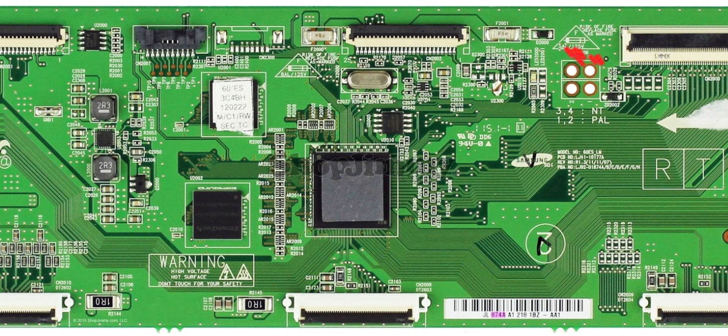

              • tvtimmy
                • Mar 2015
                • 1160
                • usa
                Re: Samsung PN60E6500EF - Bad/grainy Picture
                Here is the ldvs cable circled in red and holes 3 and 4 on the logic board.

                  • henryvrensburg
                    • Oct 2018
                    • 104
                    Hi guys
                    I connected pins 3 and 4 on the logic board, removing the LDVS cable as suggested by TVTIMMY.
                    I can hear the TV try to switch on, but it switch off immediately, and the standby light goes to 5 double flashes.
                    So far I've replaced almost everything in this TV. Only the Mainboard and Logic Board left. Can it be the Main Board
