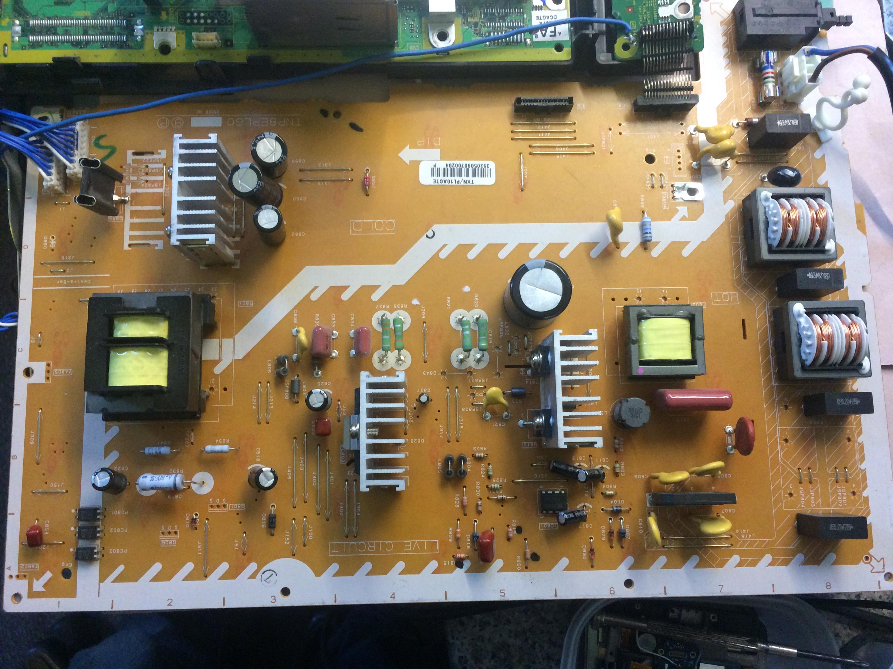

    Hi everyone,
    When plugging in it powers on for around a minute or 2 depending how it feels, everything is working during that time, picture looks good. Then powers off with green led continuously flashing fast.
    I have replaced the 3 filter caps on the PSU and the 2 filter caps on each Inverter board to no avail.
    I was thinking could be tired backlight CFL's? But unplugging the signal cable to the Inverter and the backlight will stay on fine (I had to jump the MOSFET that turns on power to the inverter on the PSU as the set will not turn it on with the signal cable removed from inverter.
    Any thoughts? I have schematic for the PSU, I think this is working since all it does is output 24V.
    When plugged in the 24v for the main boards is always on, the inverter power turns back off when the set turns off but I jumpered the MOSfet so is always on to inverter, makes no difference.

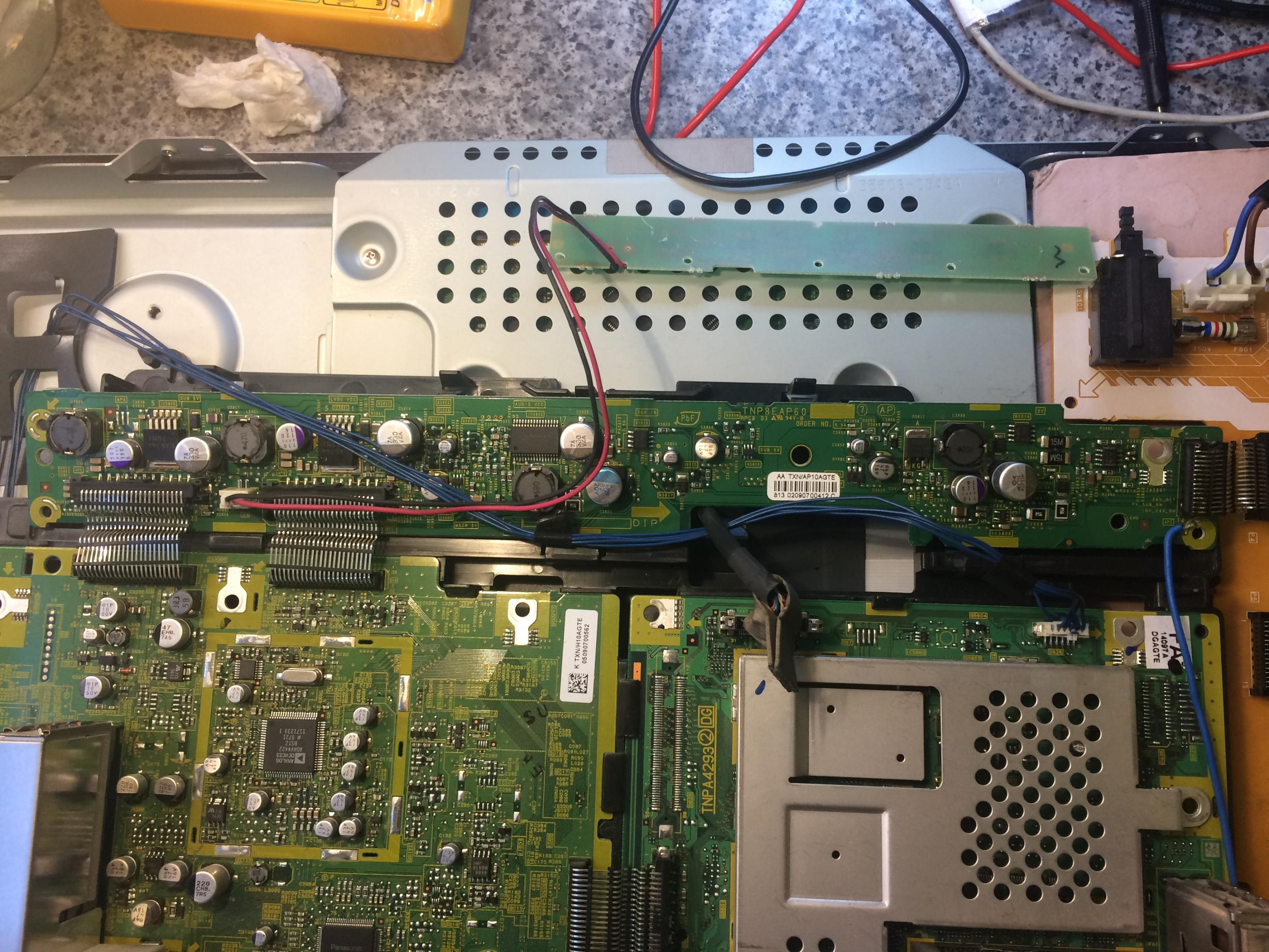

    On the PSu to next small power board along the top (see pic), there is 3 wires apart from 24v:
    GND,
    24V,
    24v Det - 2.96v when on leads to missing components on PSU (missing from factory).
    Sub_on - 3.22v when on then pulses on/off when set switchs off but strangly the PSU keeps the 24v on unless I remove the whole connector.
    Inv_On - 3.22v is on when set is on and off after it goes off.
    I have schematic for the PSU board, I have schematic for another chassis that contains the MAIN 2 boards called DG board but not service manual for whole TV and not include second Power board along the top.

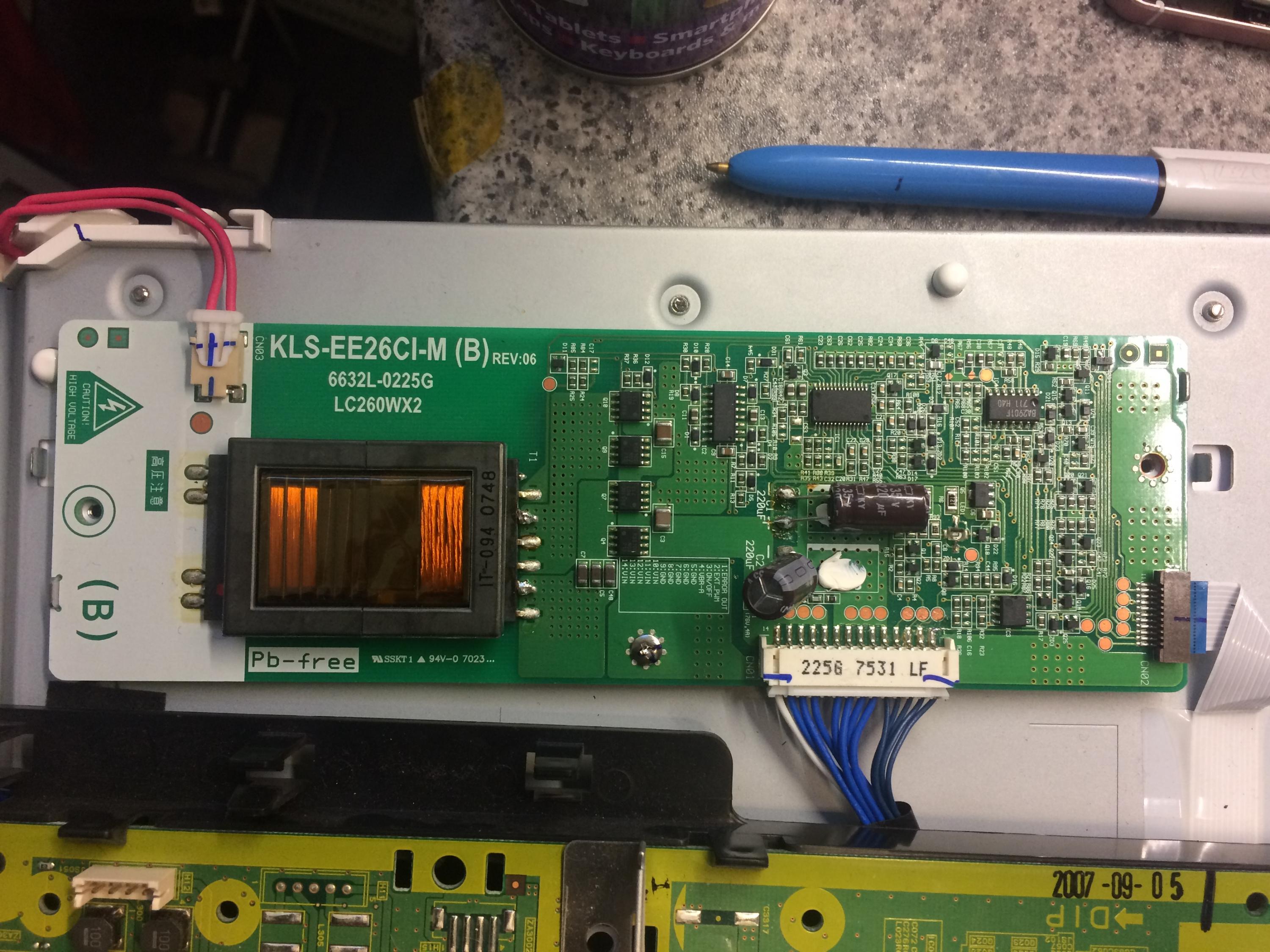

    The inverter has following data lines:
    Err out on - I dont understand it - 3.15v when on, is generated from Main board, dis-connecting and backlight does not come on, does it mean error???
    ext_pwm - 3.13v, what is this?
    on/off - 3.24v - I assume from mainboard to turn on inverter but disconnecting whole cable and inverter is on all the time!
    VBR-a - 3.14v - is it variable brightness?

      to me it sounds like you have a problem with the inverter board. You can try to turn down the backlights as far as they go and see if your TV stays on longer.
      Also the problem could be with one of the transformers that go bad, bad solder joints or bad HV cap (blue) on the inverter board.
      You can try to compare the output winding of each transformer with your DMM in Ohm setting. They have to be within 3%.
      A bad transformer will run hotter than good one. Watch for discolouring of the PCB underneath the transformers.

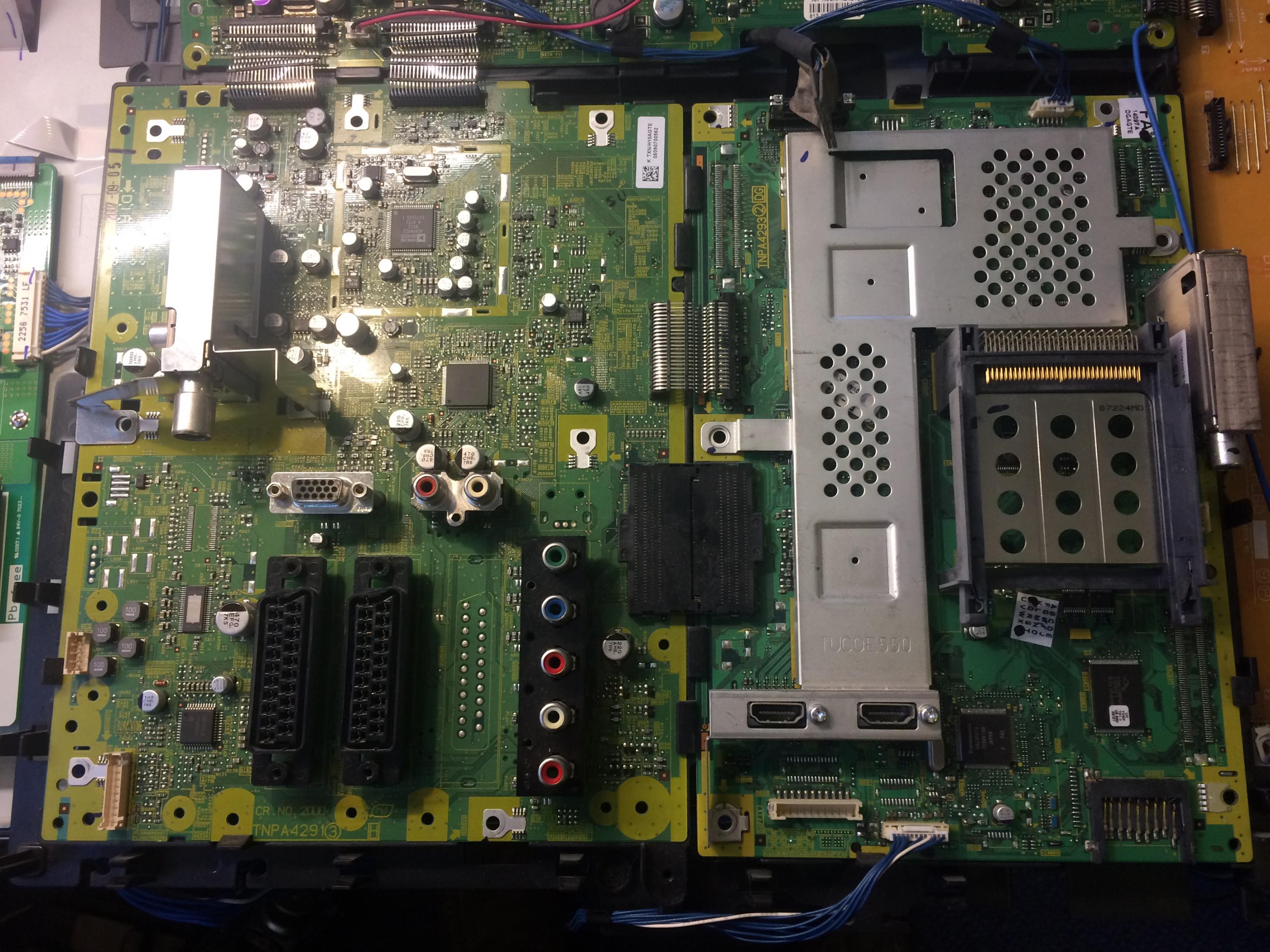

          sounds like you are losing the BLon from the main board. PSon and BLon are generated on the main board.

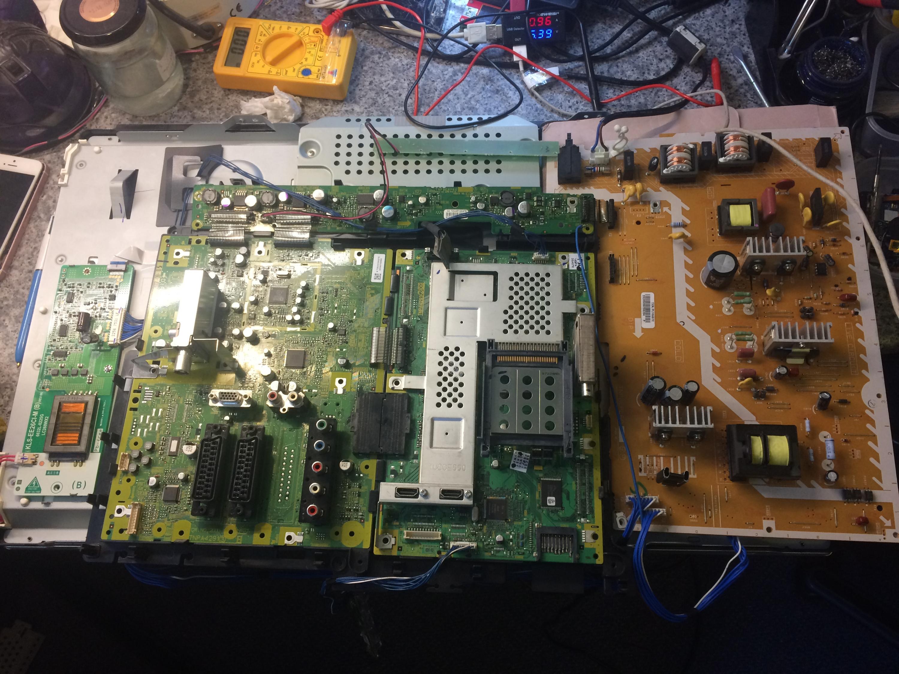

            Hello again, after a year I decided to look at this again now we all have infinite time available..
            After some more testing I have found that if I disconnect the power to the left inverter (Main one connected to mainboard) then the set boots up all be it without a backlight but no SOS 1 Blink REd any more.
            I checked the ohm readings across the transformers as a previous suggested, both boards read 0.4 ohms on the input and output windings. I do not know if this is correct.
            If I disconnect one tube from one board then it will stay on for a few seconds and vice versa with left side. If they are both connected they just flash for a second.
            I can get them to stay as mentioned earlier in the thread but not with the TV booting.
            I cannot understand the signals. Anyone suggest if I can dupe the tv to staying on? It will only boot without power to the inverter so no backlight or I can have backlight by dis-connecting the data wires to the TV but then the TV errors out.
            I have tried alll combinations of the data lines. I thought maybe I can do something with the ERR out line, but what signal does it expect?
                  I would think that Error_Out is a signal to the mainboard signaling an error with the inverter which then switches off the inverters.
                  When you power up with everything connected and the backlights on, what is the voltage at Error_Out and also when it fails and the backlight go off?
                  Also what happens to the voltage at ON/Off when you initially switch on and the backlights come on and then when the backlights switch off
