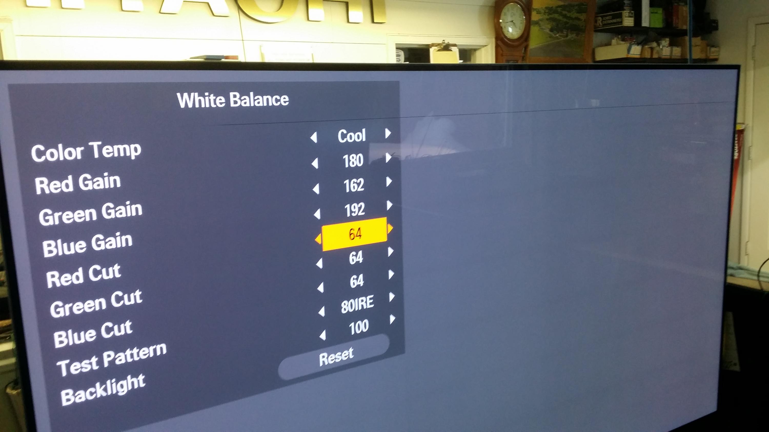

LG OLED65B7P-U thin horizontal black line
  • dibsrepair
    • Apr 2018
    • 26
    I unlocked the tv with a service remote. I can see a thin black line(see attached picture)
    i can keep the tv on from 20 sec to 4 min, depending on how much image is being displayed.
    high rez images make the tv shut of instantly.
    i can play a dvd for a min
    that line is on top every image, osd, dvd, menus, factory menus
    the line starts on the left side, 8 inches in and ends about 1 inch from the right side
    it is not locking up after 5 shut offs
    all voltages are good till it turns off
    i can turn it on again with a normal remote
    can i run a test (pattern) to determine where my problem comes from?
    is the osd generated in the main board or tcon?
    My question is: is this a bad tcon or main board?
    or a bad panel?
    cheers dan

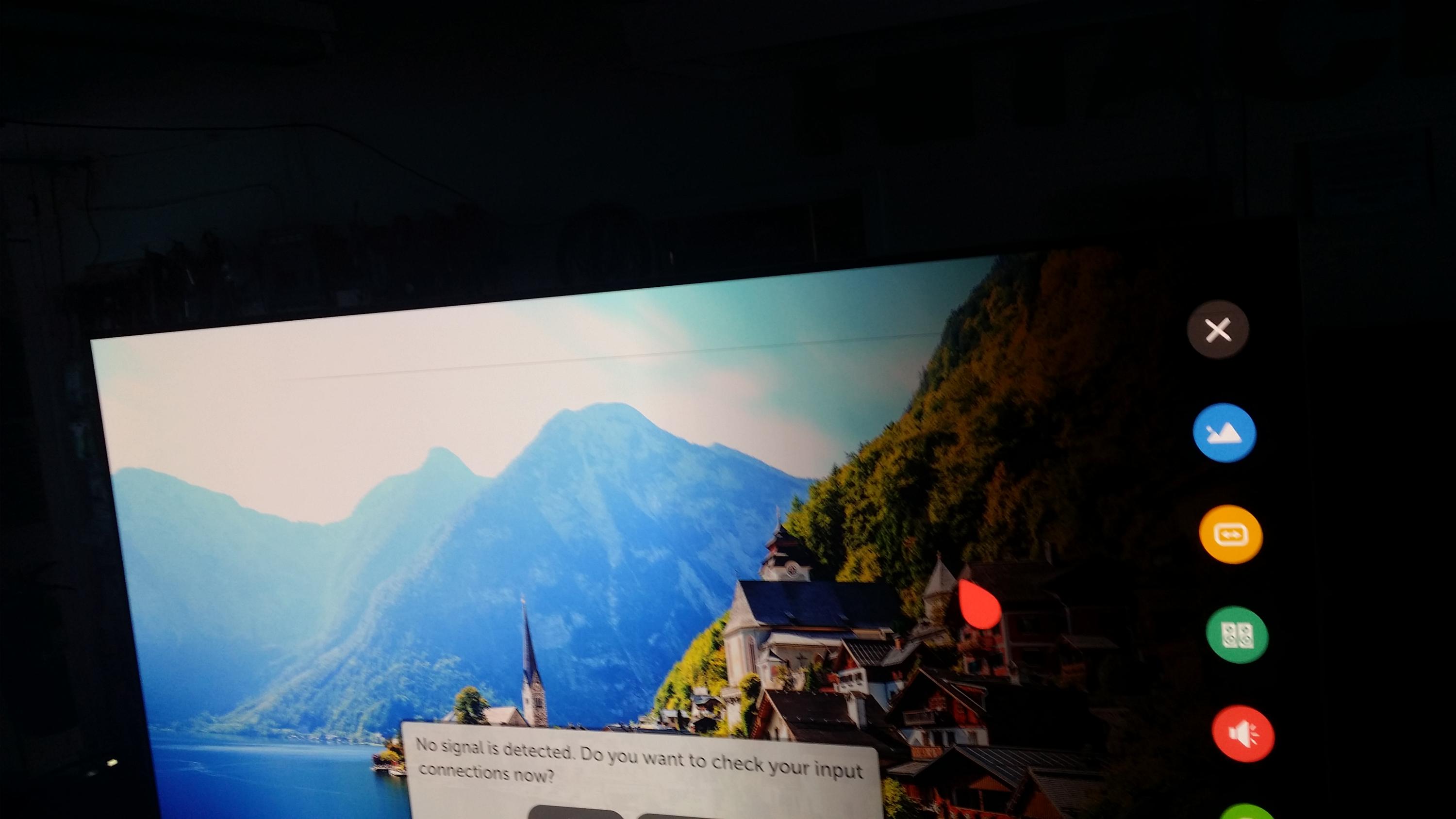

                Re: LG OLED65B7P-U thin horizontal black line
                Originally posted by Diah
                if with service remote. IN-STOP didn't help then its much driver-T-CON which its lag with handling high resolution. this why the horizontal line not complete from side to side.
                In this low light picture, you can see the line. It is there in normal mode too. So you say, it is a (not completed signal or not strong enough signal), that gives this TV an unfinished line.
                That sounds better then a COF or banding issue.
                Could it also be, that the main board sends an incomplete signal? instead of the t con?
                Danke
                  Danke
                  i stooped at yours OP ( I unlocked the tv with a service remote.) what did you mean with it.?
                  MB had nothings to do with this line. but you said it turn off after few of time when you feed it with high resolution video signal. the most sickness at LG OLED the screen driver didn't load correctly or blocked some time some how. IN STOP to make the TV back to factory condition solve this problem. but now you have this line, which its generated by the driver self which located on T-CON board together. you need to take out the metal cover of the driver T-CON board and load here photo to see which version its.
                  important. if you want to to reset the ribbon cable between T-CON and panel. don't switch them at its places. ( they should be at same order as before.

                          no i did not do such tests. The line is there before anything gets hot, right of the start. I use freeze spray to find components shorting to ground and if a devices's performance deteriorates over time as it is operating.
                          • dibsrepair
                            • Apr 2018
                            • 26
                            new t con did not fix the horizontal line. Bad panel it is. The TV is going to scrap. Anyone want to buy boards?
