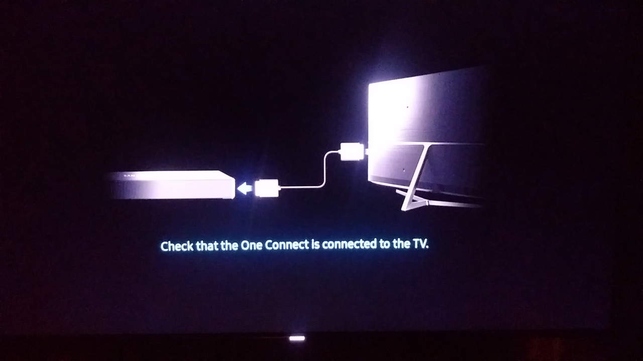

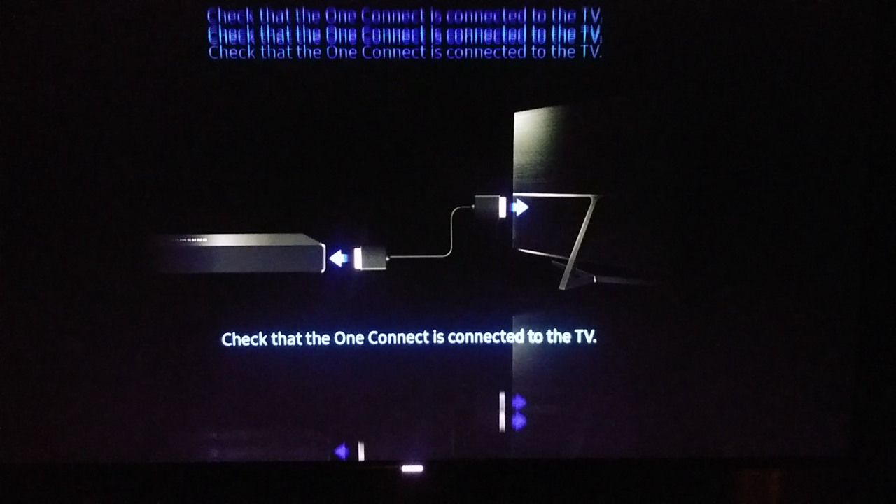

      I purchased a whole new board that I've never cut any jumpers on, it's a duplicate of the board that was inside the TV so it's the correct board. I have that board in the TV now and still get the same issue.
      I've attached four pictures, both before and after the issue occurs (which is continuously as the TV is on, it's non stop).
      The TV has the OneConnect and one set of pics is with the OneConnect unplugged so it's not that external component.

        I've attached the pics, I'm also trying to attach a short video. Thank you for your suggestions. It's late here so I can't check voltage asst the moment.

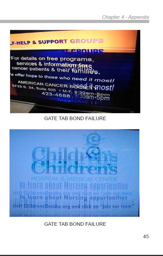

          Re: Flickering on Samsung UN55KS800DFXZA
          I have seen similar problems with tv flickering or rolling and this points to a faulty panel. The other Techs speak of cutting the traces marked CKV1, CKV2 CKVB and this might be a unique Samsung panel issue. Other people would take sellotape and blank off some of the pins withing the flat ribbon connector randomly until the issue resolved but these are normally when the TV is rolling or flickering constantly not like your with a intermittent issue. Maybe someone else in this forum has different advice?
            check out the following link, https://www.scribd.com/document/3558...el-repair-v1-7
                        https://www.badcaps.net/forum/attach...2&d=1549870842
                        That is Gate drive issue (look for side tab driver COF), it is panel problem, not backlights issue. taped off method may work.

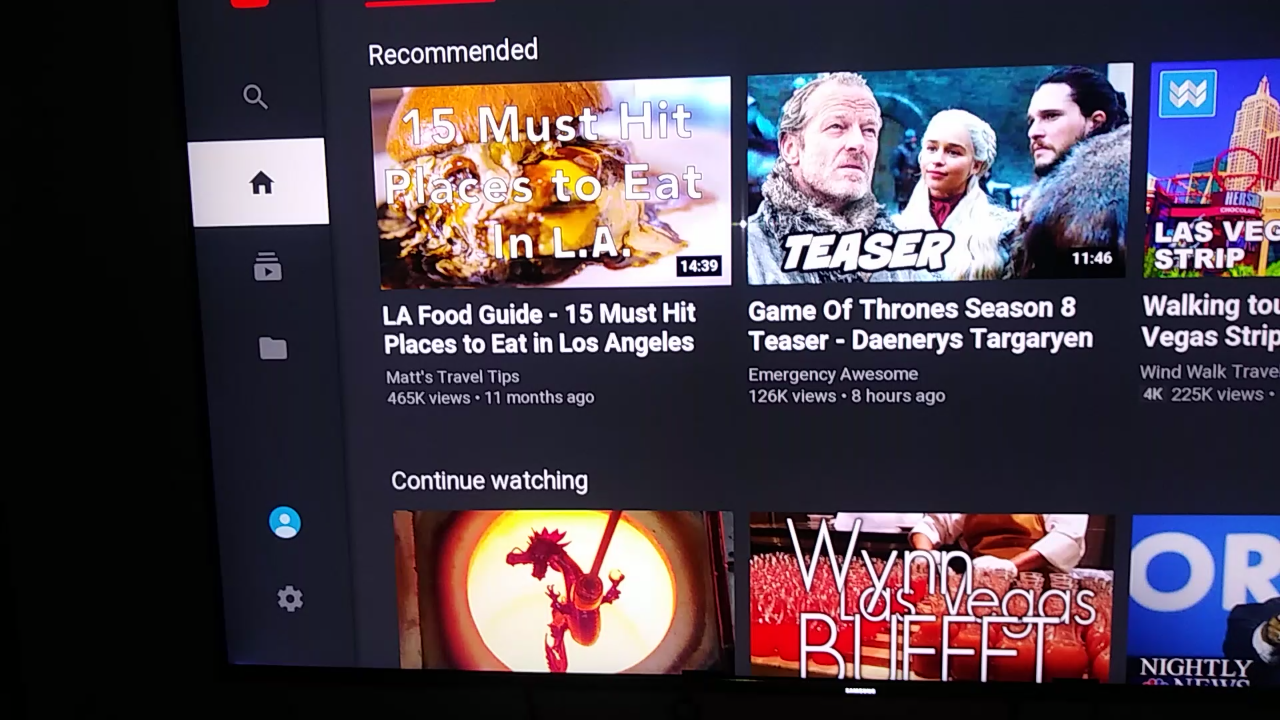

                          Try turning the backlights level down NOT brightness, see if theres any change.
                          Turning down the backlight seem to keep it from flickering in a rolling for longer than it's been in a while, going to keep the TV on and see how long it lasts. Thank you.
                            Hmmm, you may have more than one issue, pretty sure your double image text is a panel fault, as mentioned, try the "cut tape" method, see if you can get that cleared up first.
                              Turned down the back-light to 5 as I mentioned earlier and the TV has stayed without a problem since I turned it on this morning and made those changes.
                                  I'm really surprised that your double image is gone tho.
                                    I'm surprised too but this is how good the picture ha been since I turned it on at 6am. There's been a little jump here and there, but it's barely noticeable.
