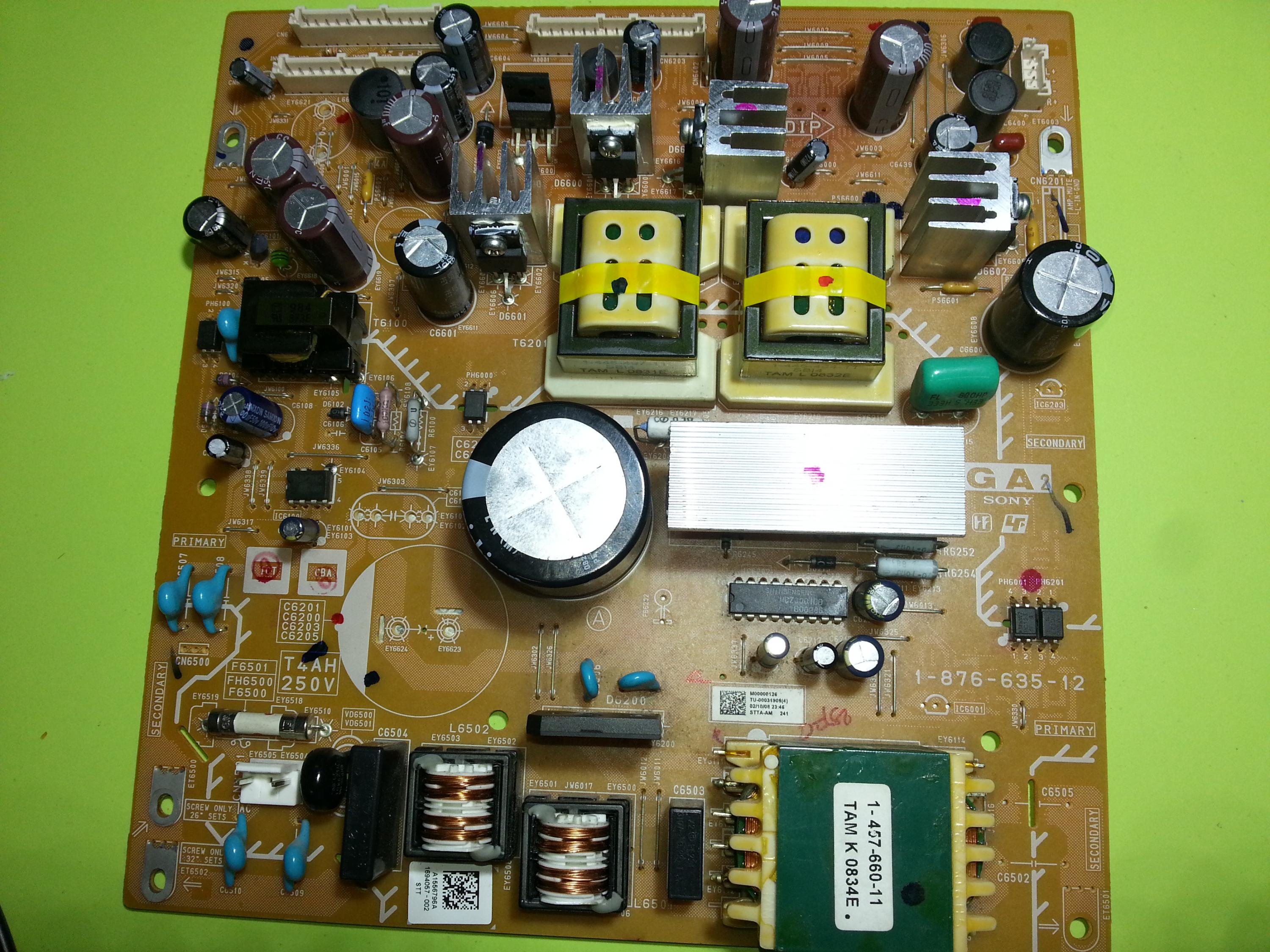

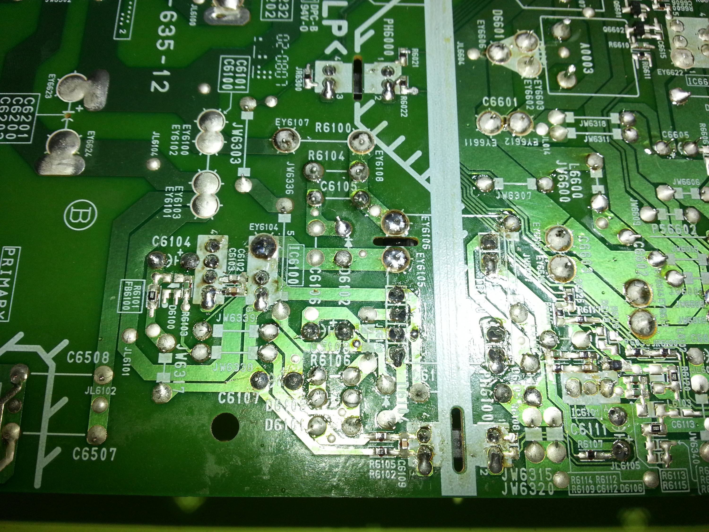

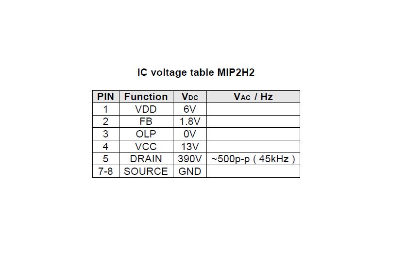

    Good day folks. I'd like some thoughts on this Sony bastard which doesn't turn on. Actually, it's totally dead: no standby at all. I added the schematic for the supply. Problem is, where it says 3.3v on the right, at CN6200, I get a jumbled mess of an output: jumps around between 4-5v and dies whenever the main board is connected. I traced back the standby supply to IC6100 MIP2h2, but couldn't find too much about this IC, other than a pinout which indicates pin 4 to be VCC but offers no other info to see what voltage should be expected there. Funnily enough, you can just about see a 1 on the right side of the pin just where the image is cut off - what a troll , so I'm expecting around 15v knowing how most of these standby ICs operate. I'm not getting anything close to this on pin 4: all I get is a messy 4-5v just like on the output, so I traced back even further and I believe VCC is supposed to come through D6103 and R6106, from pin 3 of transformer T6100 - "AUX winding" as we usually call this. The diode appears to test fine in diode mode and the diode reads 2.6ohms which is a bit higher than the 2.2 the schematic indicates, but should be good enough.

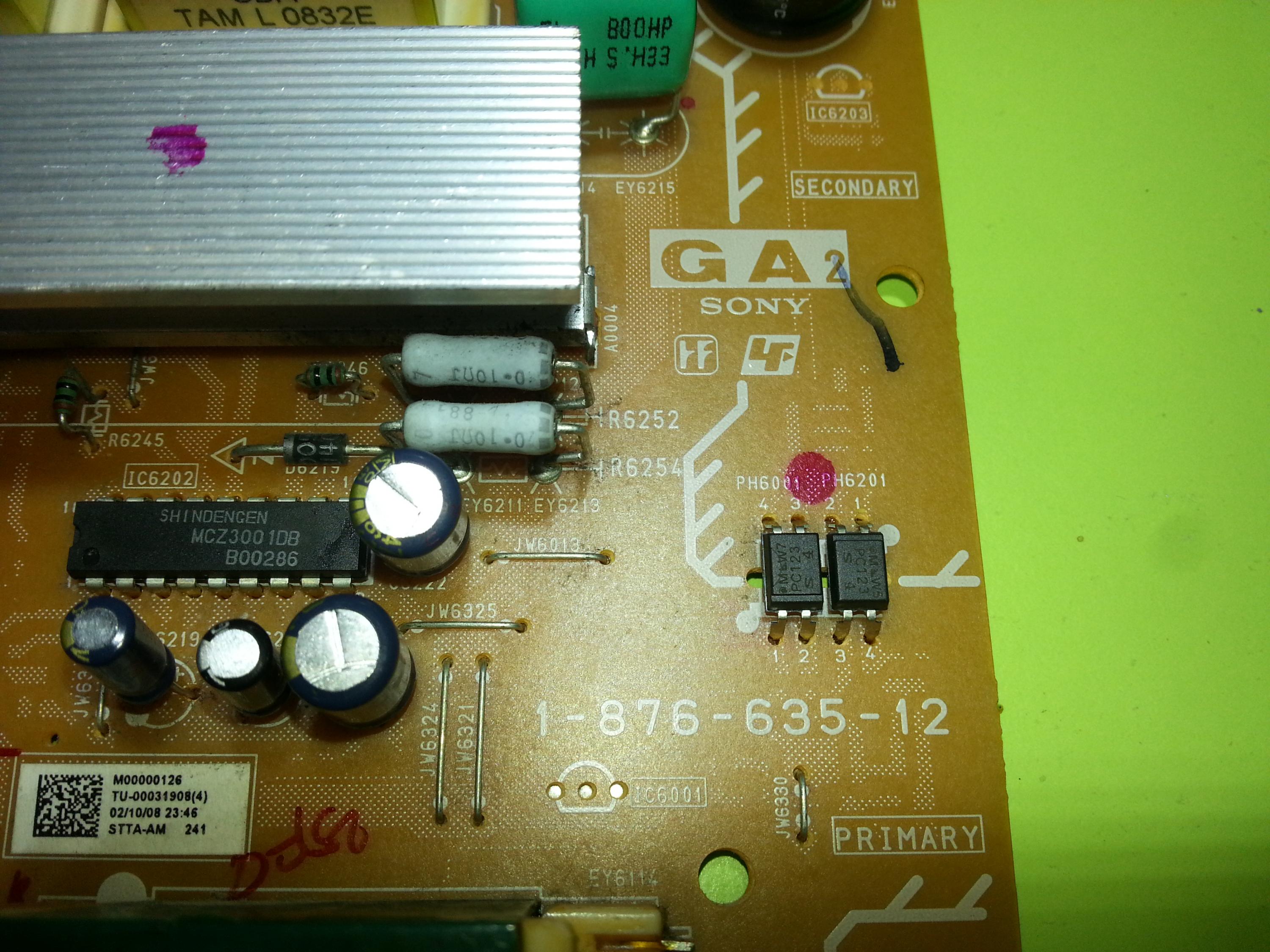

    Another colleague before me had already replaced and reflown many of the components there, as you can see in the close-up, including all the caps and even the IC itself - it still doesn't work. My colleague suggested the large IC at the top (IC6202 MCZ3001), is faulty, which I can accept to a degree, except I presently don't get any standby, which should come BEFORE that IC is even operational. NorCal on YT did an excellent video on MCZ3001, which I don't dismiss as being faulty at this point, but I must first get the standby circuit up and running so we get stable 3.3v on that output...any ideas ? The problem lies in the primary I believe, the giveaway being the unstable input I get on pin 4 of IC6100.
    EDIT: also yes, I am aware there's two different ground points of sorts - I'm not measuring on chassis ground, I'm measuring the 3.3v output relative to pin 3/4/9 of CN6200, which are NOT chassis GND !

      So as usual, are C6104, C6107, C6108 OK? Since you are getting Voltage on the cold side, it means the IC is at least switching otherwise you will not have any output on the cold side at all.
      MIP2H2 SMPS IC
      Pin 1 - VDD
      Pin 2 - FB
      Pin 3 - OLP
      Pin 4 - VCC
      Pin 5 - D
      Pin 6 - not present
      Pin 7 - S
      Pin 8 - S

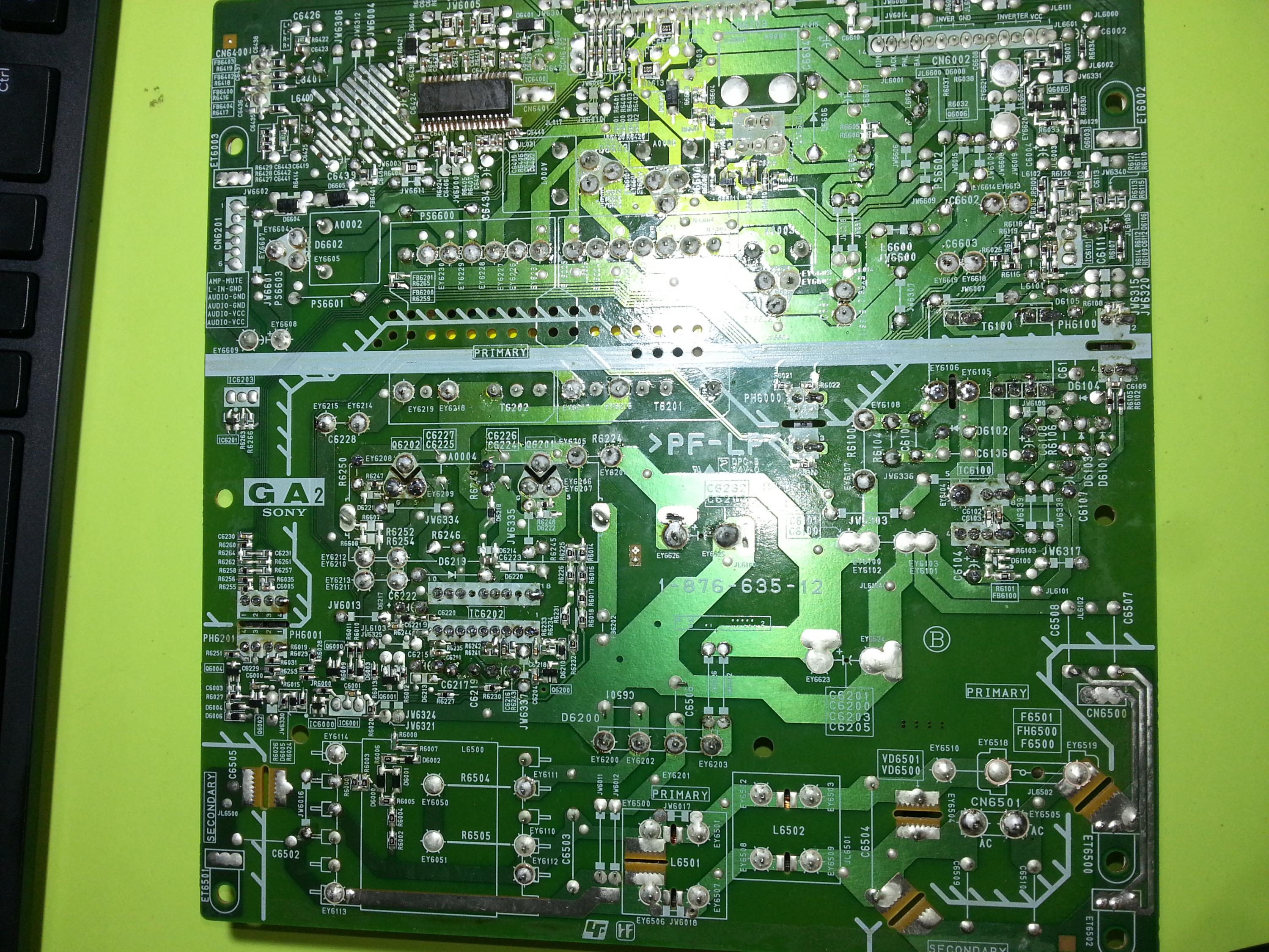

          About grounds: this is a weird one, because putting one probe of my meter on one of the lugs used to attach the board to the chassis and the other probe on pins 3,4 or 9, I get nothing - no continuity at all. This is kind-of indicated in the manual, because notice how the GND symbol after R6121 (which is fine BTW) is different than the symbols for GND used, say, higher up, at GND_1. These other GNDs DO connect to the chassis. It doesn't matter, because I had a look through the whole schematic and located the connector where the loom from the supply plugs into the main board, and there the two GNDs come together, so I did the same for now and just added a wire between "STBY GND" let's call it (pin 3,4,9) and "chassis GND" on one of the lugs, which is a real stupid way to describe them, but that's how it is.

          Now on the primary, I salvaged a diode from another similar Sony board to try and also replace D6103 just in case. I'm not liking the looks of the values I get on pin 4 though - only an unstable 4v...
