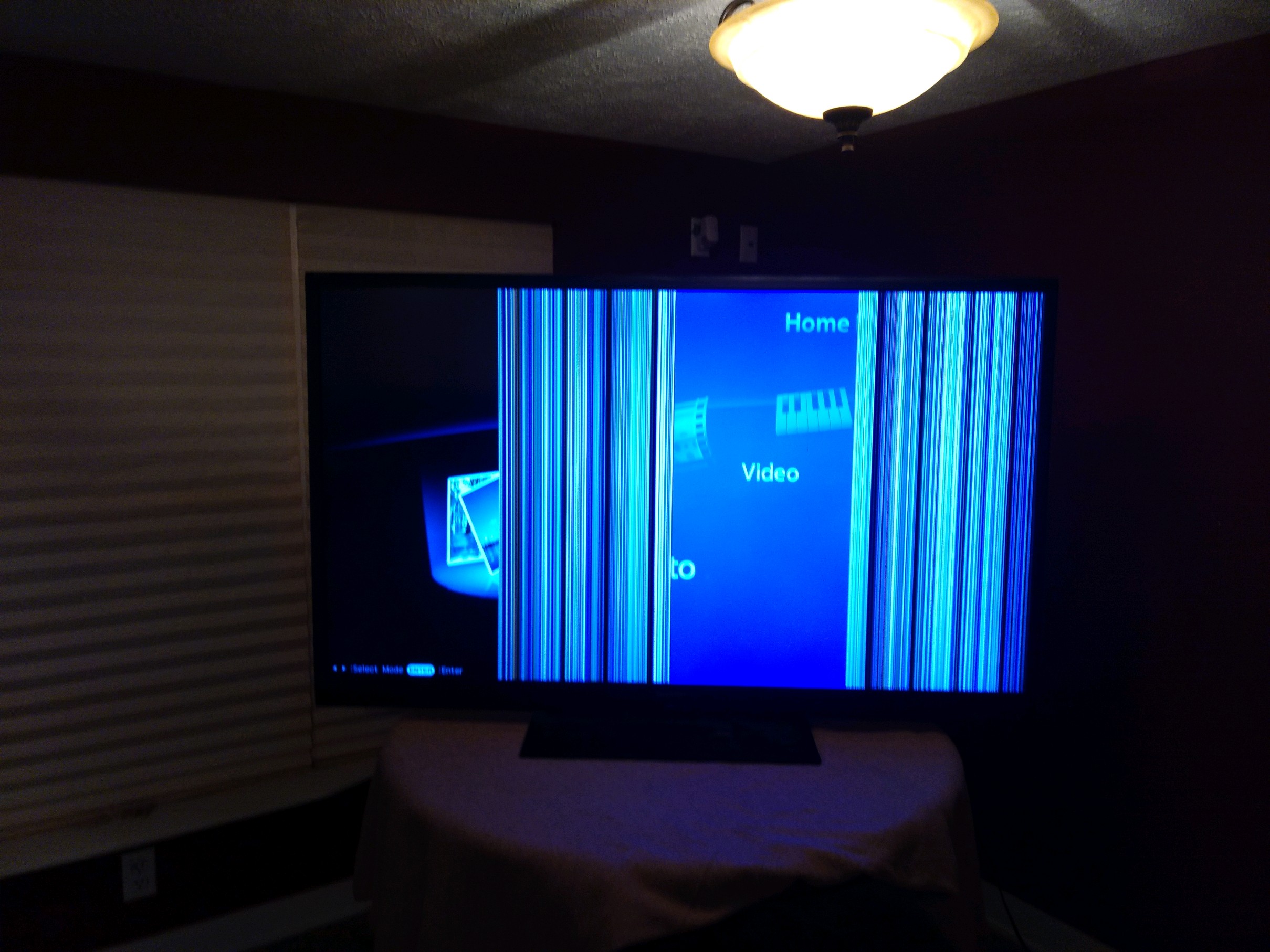

                Re: Sharp LC-60LE600U tries to turn on, faults, DIAGNOSTIC DONE BY THE NUMBERS!
                So with no opinion given in here on panel compatibility I installed the 600's panel in the 640 after visually comparing the source driver boards which in appearance and board number were identical. I went over it component by component and the same appearing components were found in the same location across all 4 boards.
                End result....for at least a bit the left half of the panel was visible. The left quarter of the screen was normal, the next quarter to the right looked like an LVDS cable problem, the next quarter to the right was discolored but closer to normal and the right quarter of the screen was and always has been vertical lines. The left quarter of the screen is still normal but the problems spread and the final result is pictured.
                The vertical lines on the right side of the screen were present from the instant the panel got power. Ordinarily I'd say bad panel just on that alone but since the panel numbers are different there may not be any telling. At least in this thread anyways.
                So does anyone think this is fixable?
                Oh well, you win some and you lose some!
