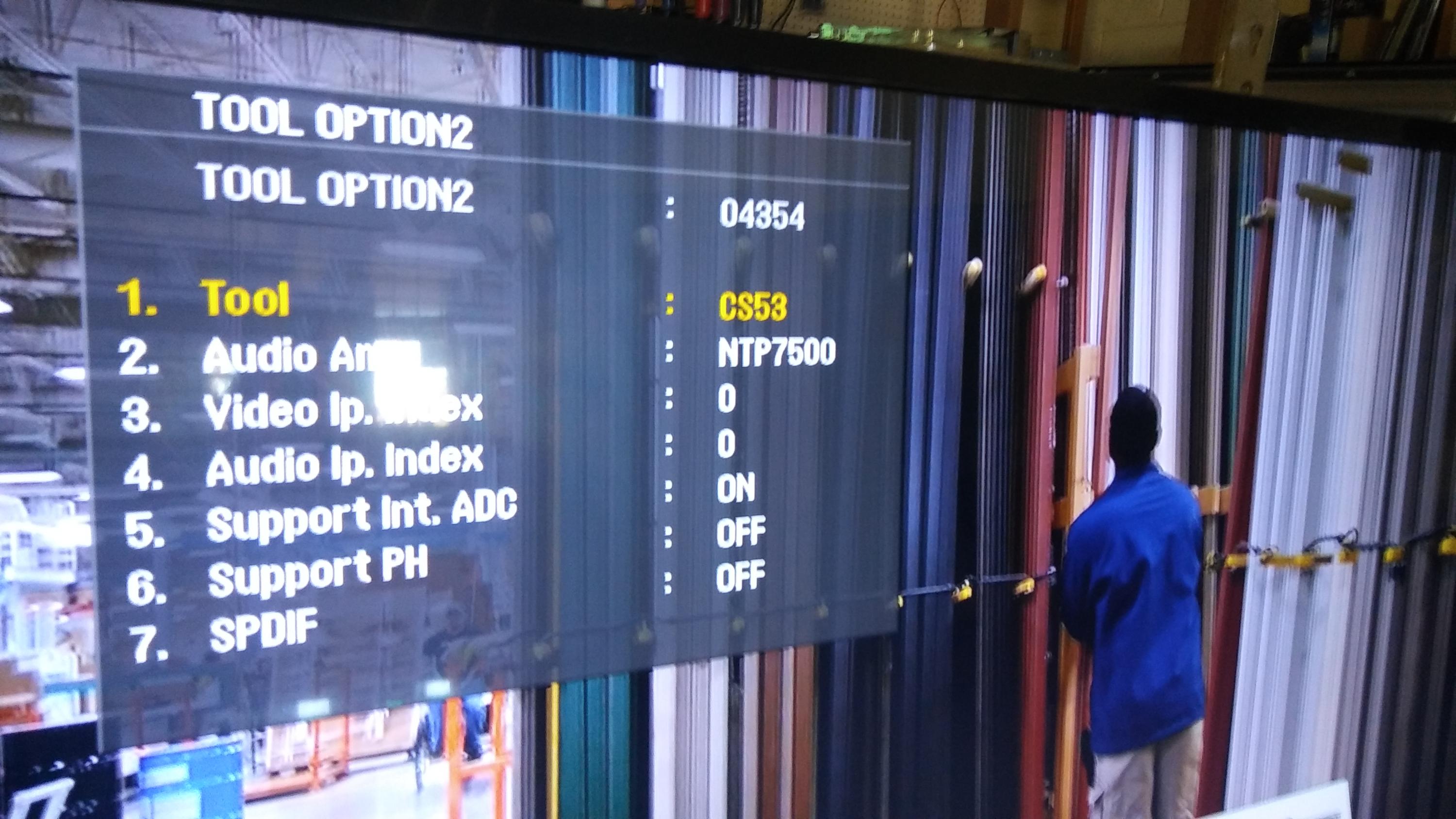

              update. Thanks everyone’s help

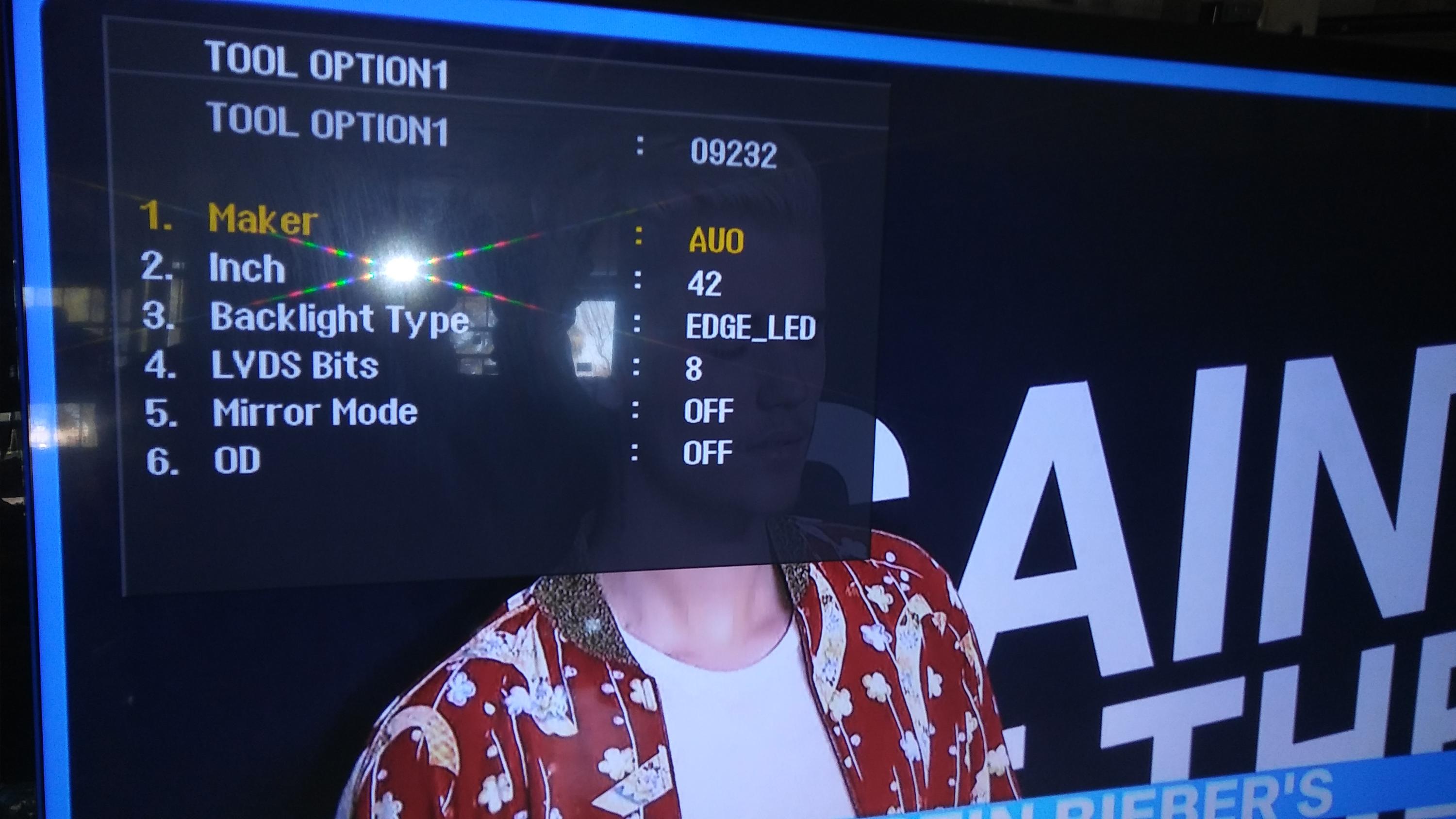

              (pic1) came today. I found problem was at LVDS bits from 10 bits changed to 8 bits .....tv picture went back to normal ....but ......WHY???
              I tried to change display type from AUO to LG nothing changed.
                Re: 47ls4500 screen has rainbow color.
                Glad to hear that it is fixed, so now you know that bad Gamma can be due to bad Gamma Voltage reference IC or mismatch LCD setting.

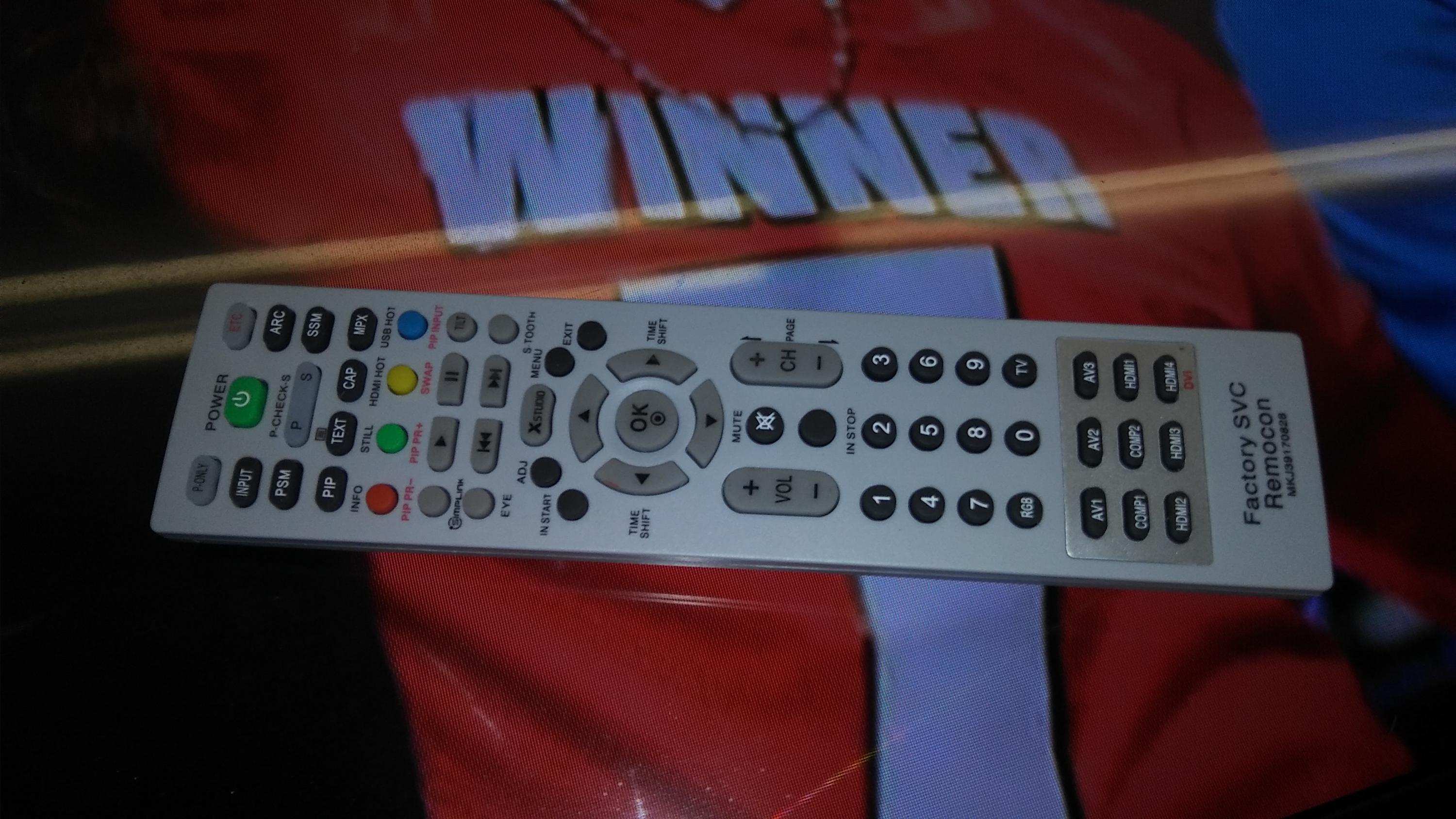

                  I highly recommend this clone Factory service remote to everyone.
                  Now I'm going to go inside all LG TV service manu. see what's inside.

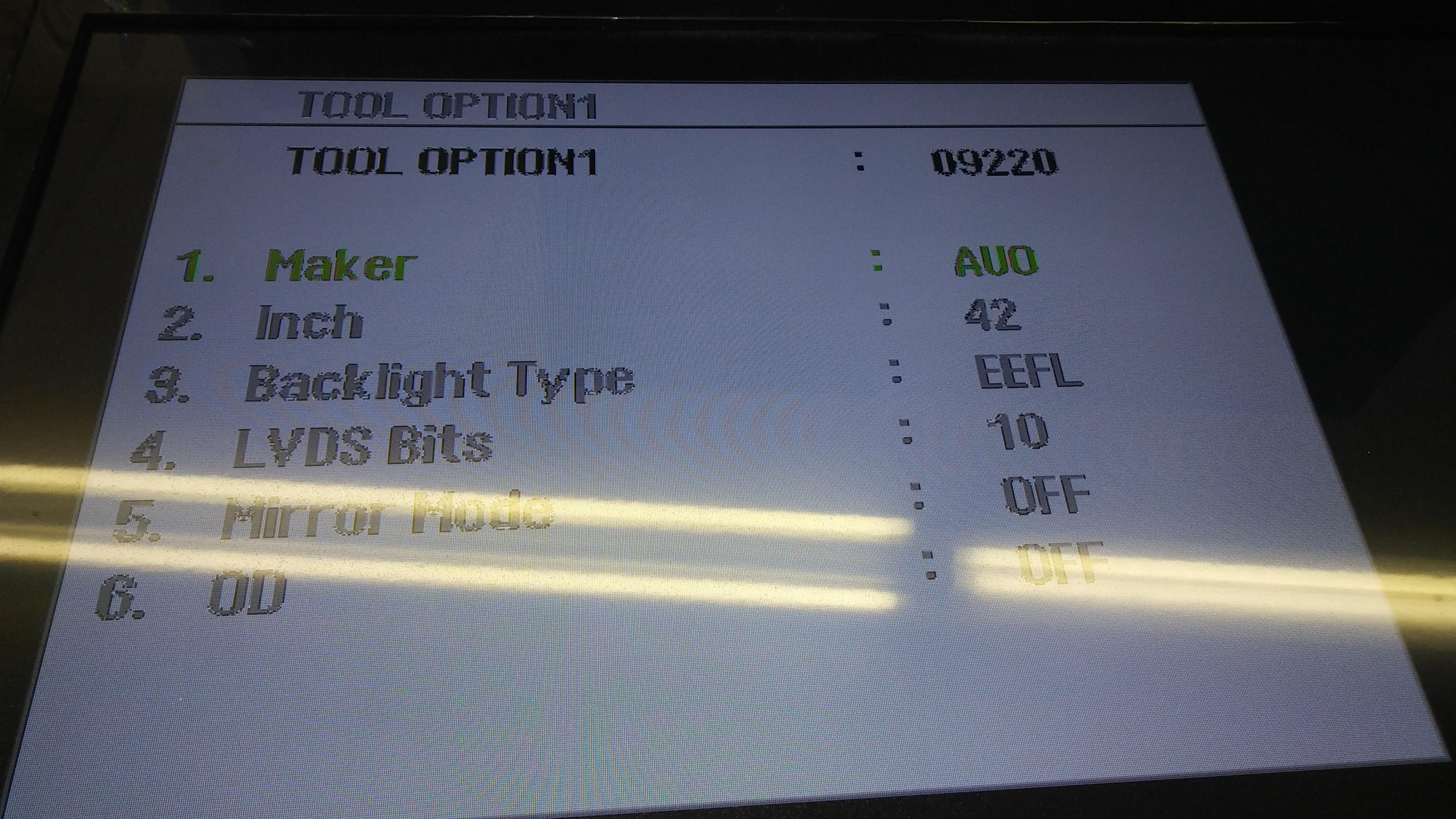

                  I did change EEFL TO EDGE_LED (THIS TV IS EDGE TV) but nothing happened. I've changed LVDS form 10 bits to 8 bits I always thought pictures may be down grade.

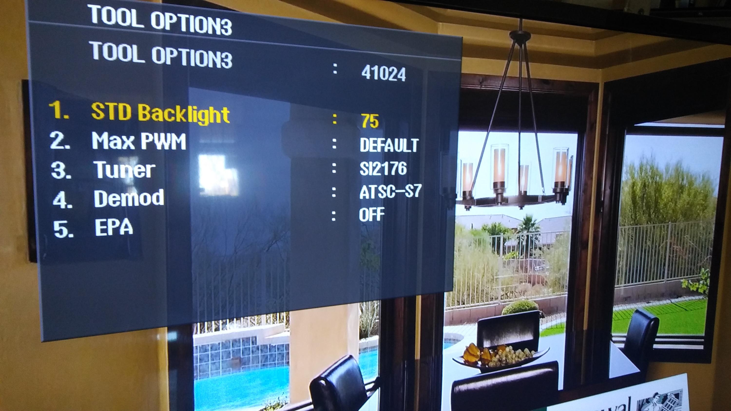

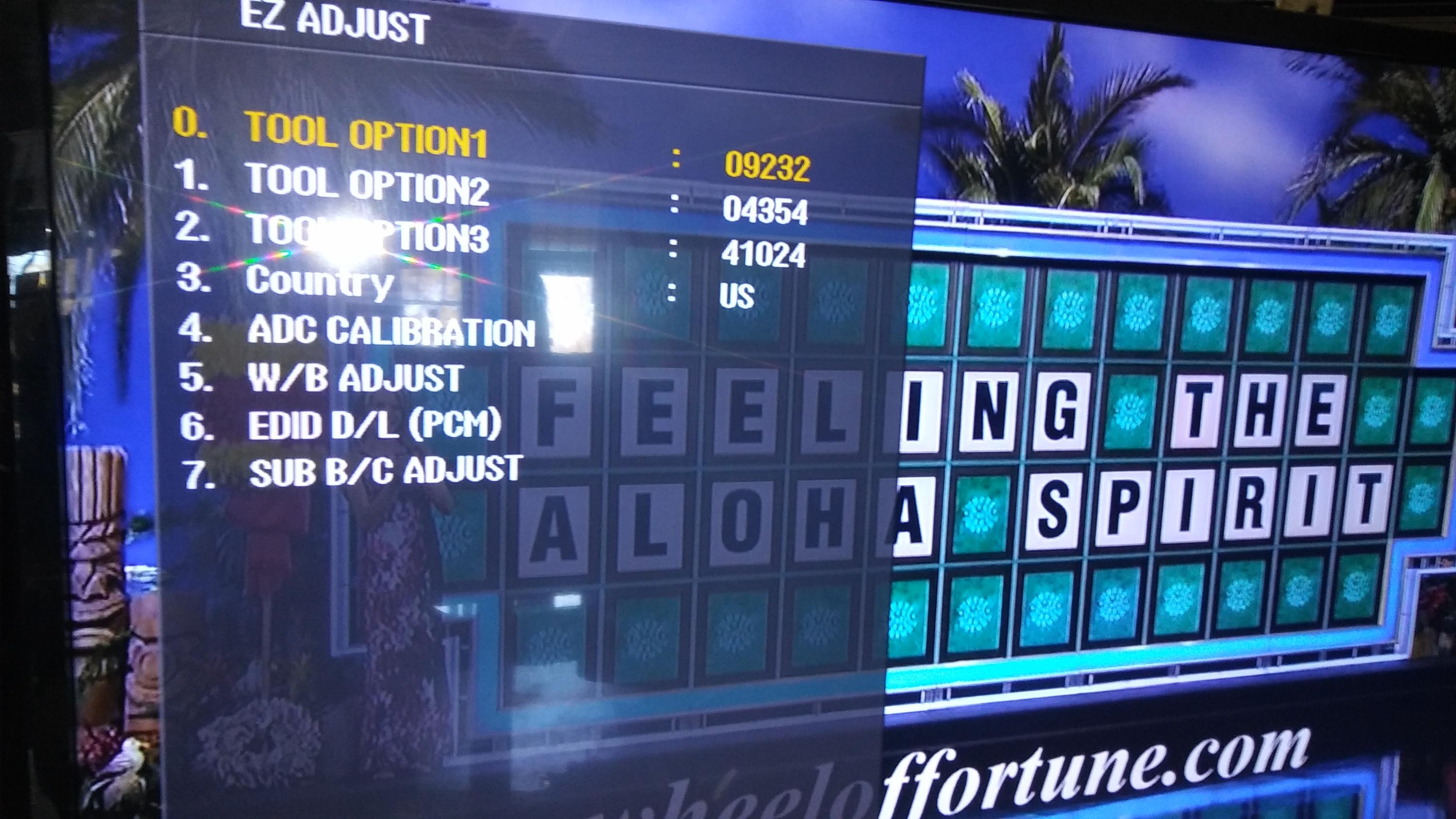

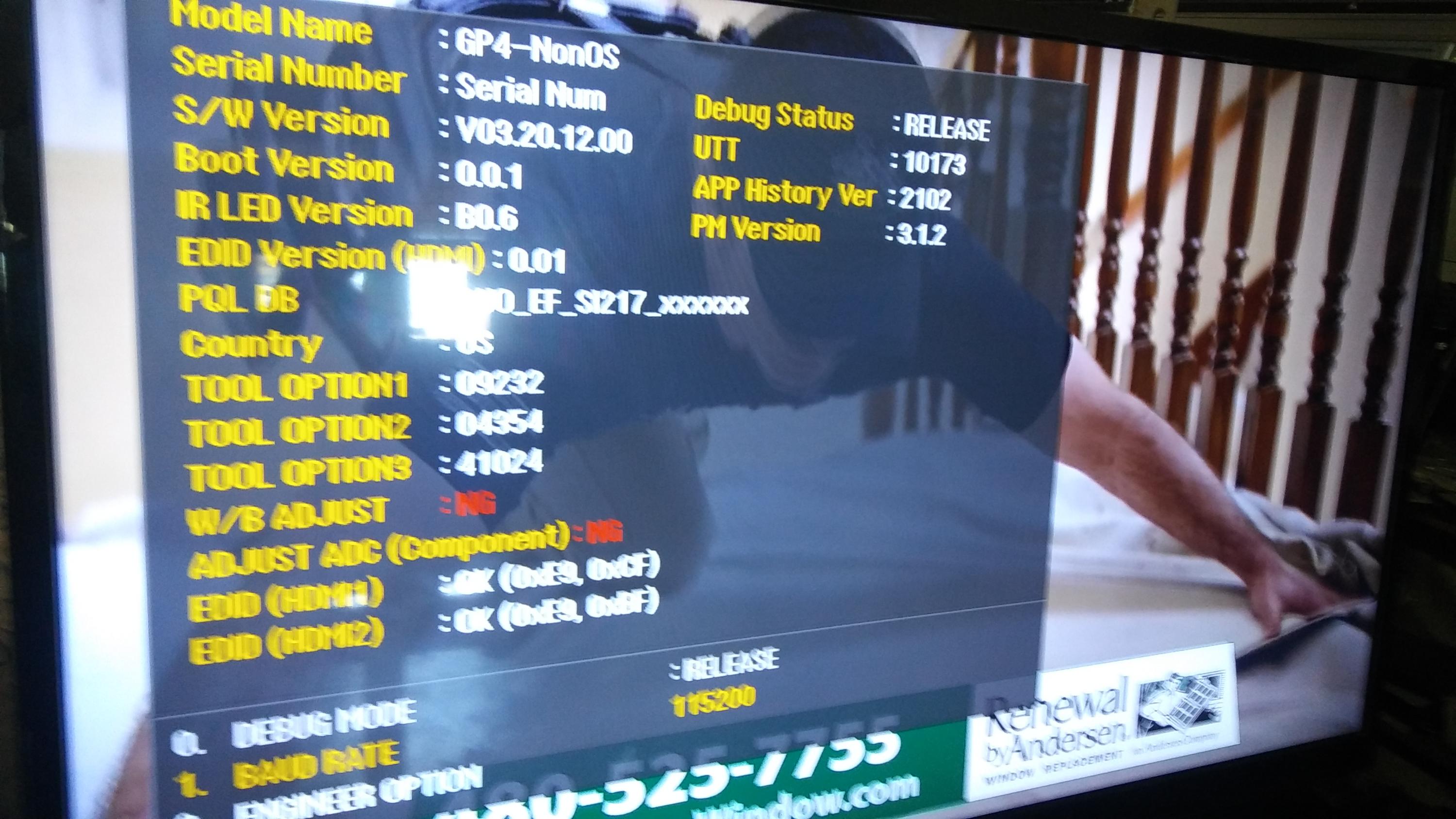

                  Pic1 is IN START MANU
                  PIC2 IS EZ ADJ MANU
                  PIC3 IS EZ ADJ TOOL OPTION 1
                  PIC4 IS EZ ADJ TOOL OPTION 2
                  PIC5 IS EZ ADJ TOOL OPTION 3

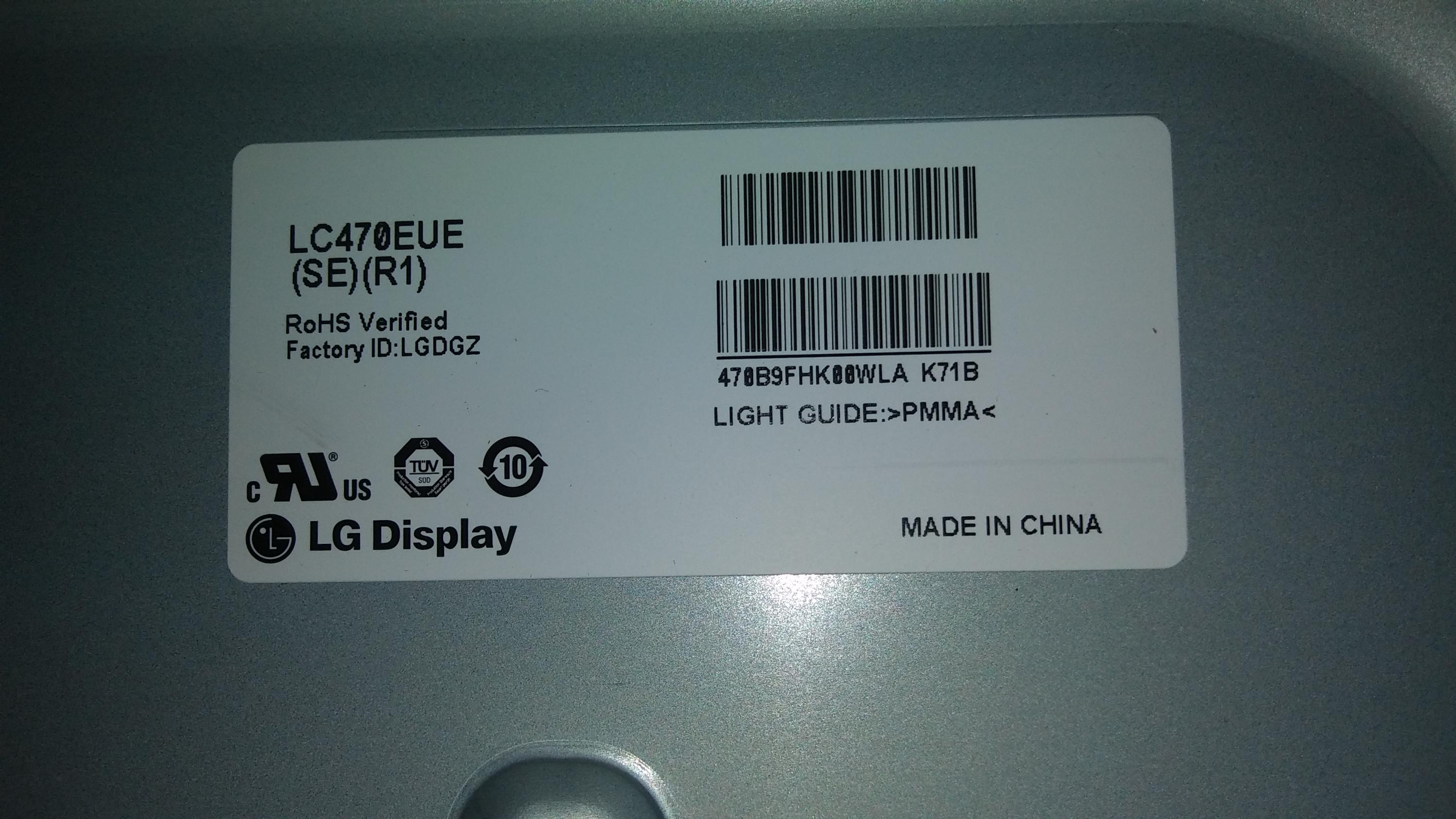

                    10-bit /8-bit panel.
                    https://www.walts.com/blog/samsung-s...bit-lcd-panels.
                    Your panel lc470eue(ser1) is only 8-bit.
                    http://www.lcdsolar.com/products/Pro...1#.XFy9KGkrJhE

                      This is very precious information. so this TV portion of parameters in memory are corrupted?

                          first i took pictures of the service menu then changed each parameter until I found the correct combination, trial and error, it's kinda stupid but very effective method only took me less than 10 minutes.
