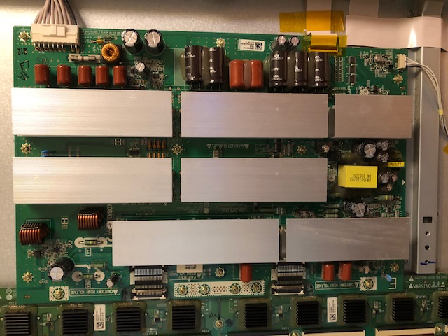

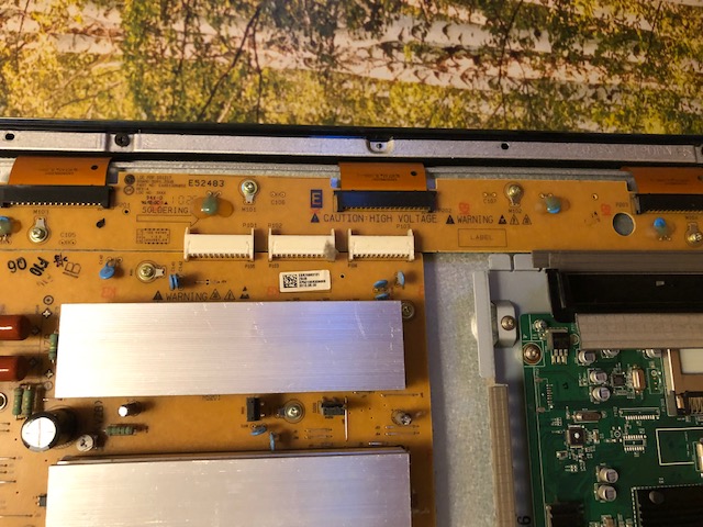

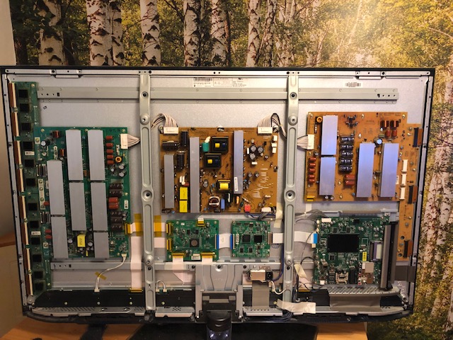

    I have an intermittent 50 inch PX990 plasma TV which I think has electronics based on the 50PK990.
    Recently it's started turning itself off after being on for 10-15 minutes and gets to the point where it will only stay on for a few minutes before turning off.
    When it turns off and you try to turn it on you can hear the relays clicking in but it clicks off immediately. Leaving it for a few minutes (perhaps to cool or discharge) allows the TV to be powered up for a little while.
    I've repaired quite a few LCDs previously but the back of a plasma is a different kettle of fish. I had a look at the guides from the links but none of them seemed to be for an intermittent fault as mine is.
    I've tried to take clear pics but if you need closeups of anything please let me know.
    Thanks in advance

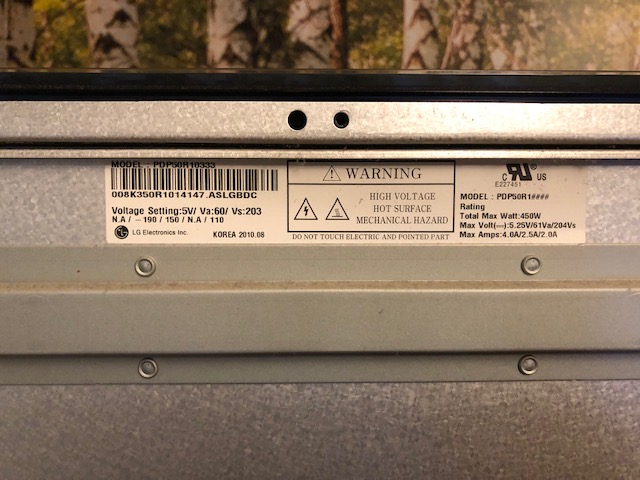

    I managed to find the supply voltages sticker in the chassis so I'll have a look tonight to see what they look like compared to the PSU output.
    There seems to be a wealth of spare boards if required on e-bay but I'd prefer to not have the board in a skip.

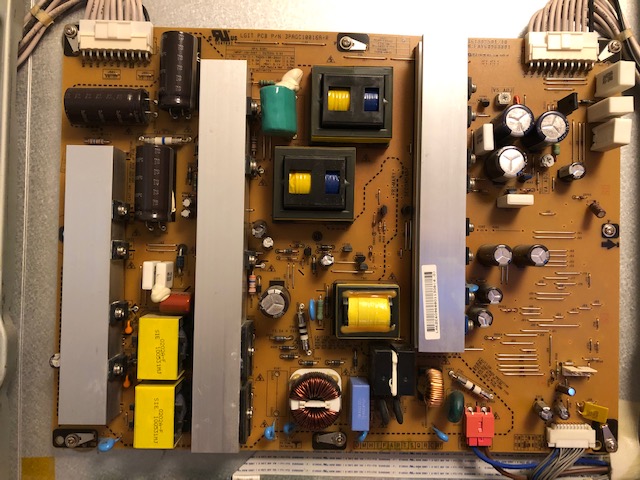

        Check for cold solder on back of power supply. Common on these power supply boards & with these symptoms.

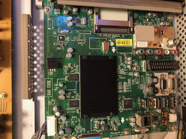

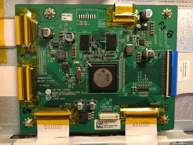

            Apologies, Is it the board with the FPGA I'd replace or the board with the XD processing chip on it (the BGA with the two memory IC's next to it)
            One appears to be the control board (50R1X_CTRL) the other (the one with the FPGA) is I assume is for OSD and test signal generation?
              Re: LG 50PX990 Plasma Powering itself off
              I would be having a look at the back of the power supply first, only take you a few minutes to unscrew it & have a look for cold solder joints, then hit them with a soldering iron.
                The Mainboard is the one with the large black heatsink, Inputs, HDMI etc.

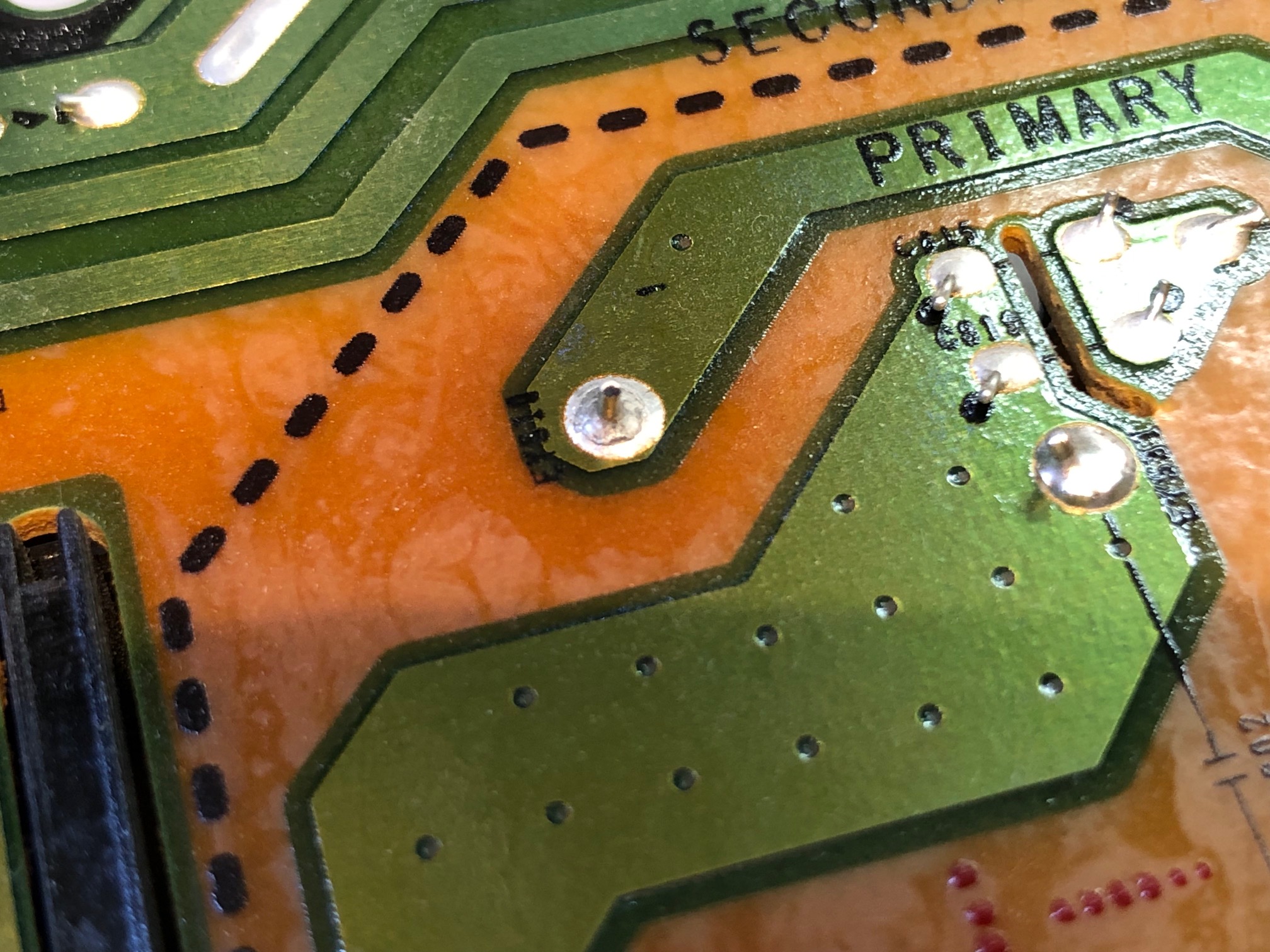

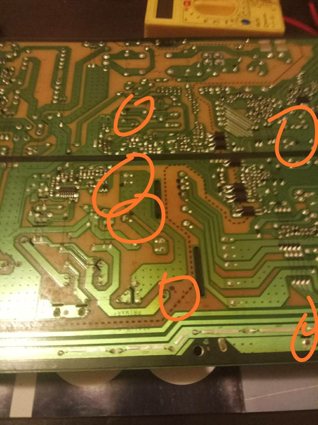

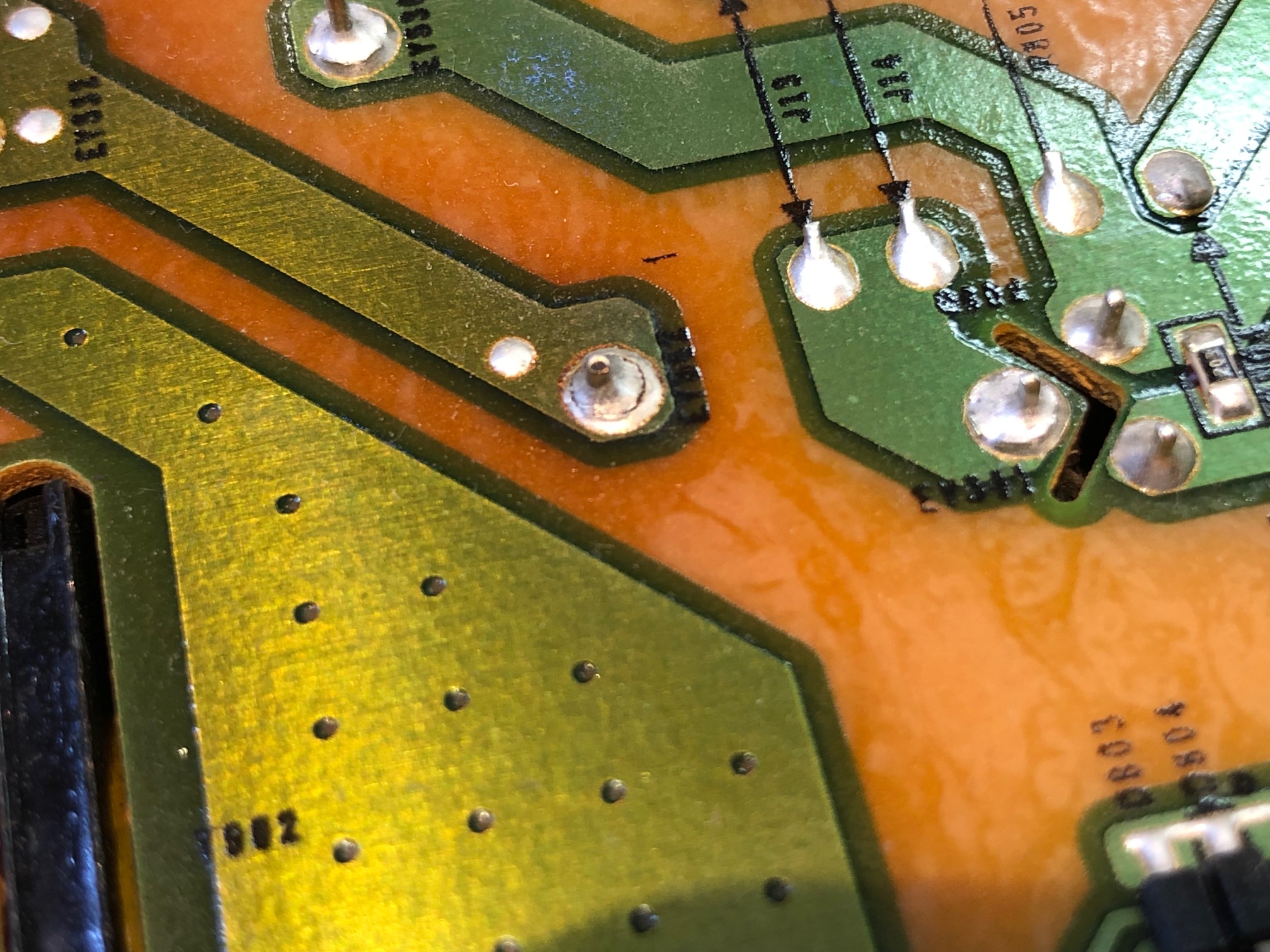

                  Only just managed to do some investigation today. Surely enough on the back of the PSU board there's a few cold joints around the transformers. I'll refit the board tonight and test it. If this ends up being the culprit I'll post pics so others can see where the problem was. Definitely cracking around the transformer pin so likely as not to cause a power loss under thermal stress.
                  I was quite surprised to see how the board has discoloured around the transformer. Do the boards discolour a lot on their own or are the components really running that hot?
                    Just heat stress mate, you can imagine how long & many times that board has heated up & cooled over it's lifetime.
                    Have done a few of these now, nice simple fix.
                      Seemingly sorted. Wish all repairs were as straight forward as this.
                      I've attached a couple of photos in case people don't know what they're looking for with a dry joint, cold joint, stressed joint.
                      These pins were the main culprits for me although I reflowed the whole set of pins on the board.
                      Thanks again for the help
