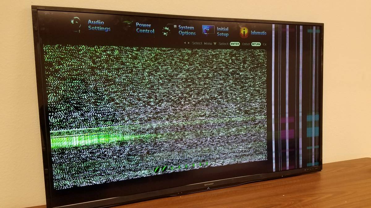

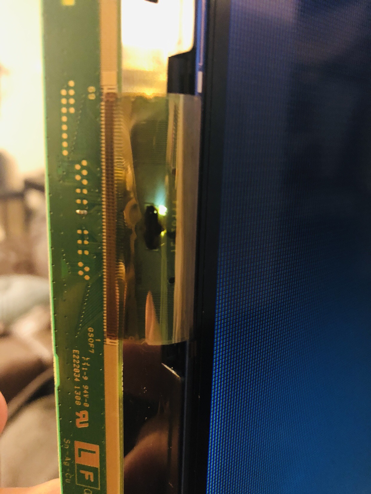

    This is what I have board or connection issue
    Re: Sharp LC-70LE650U
    Looks like bad panel to me.
    • RJARRRPCGP
      • Jul 2004
      • 6304
      Sharp=99.9 percent a faulty panel!

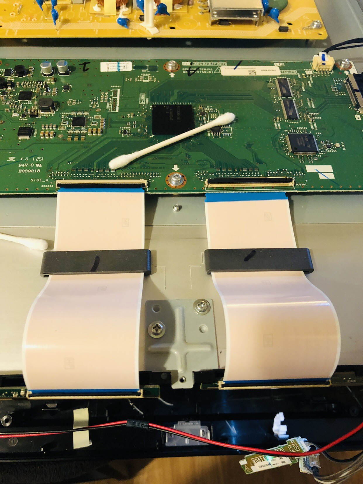

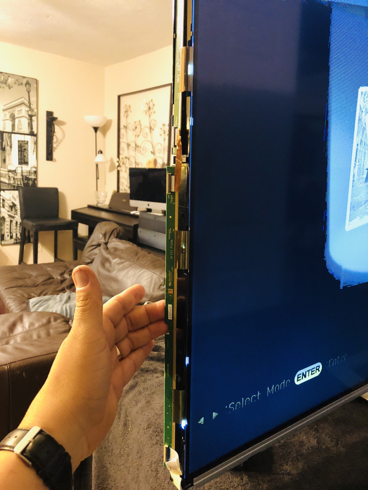

        This is was I got after removing connectors from t-con bird one at a time. Last image is from usb.
        • DXseekerMO
          • Feb 2018
          • 1119
          • US
          Panel is bad. I've had a Sharp or two go by way of the axe from a bad panel.

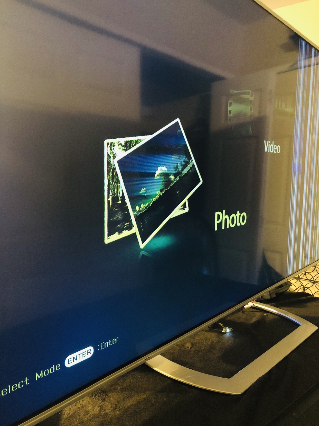

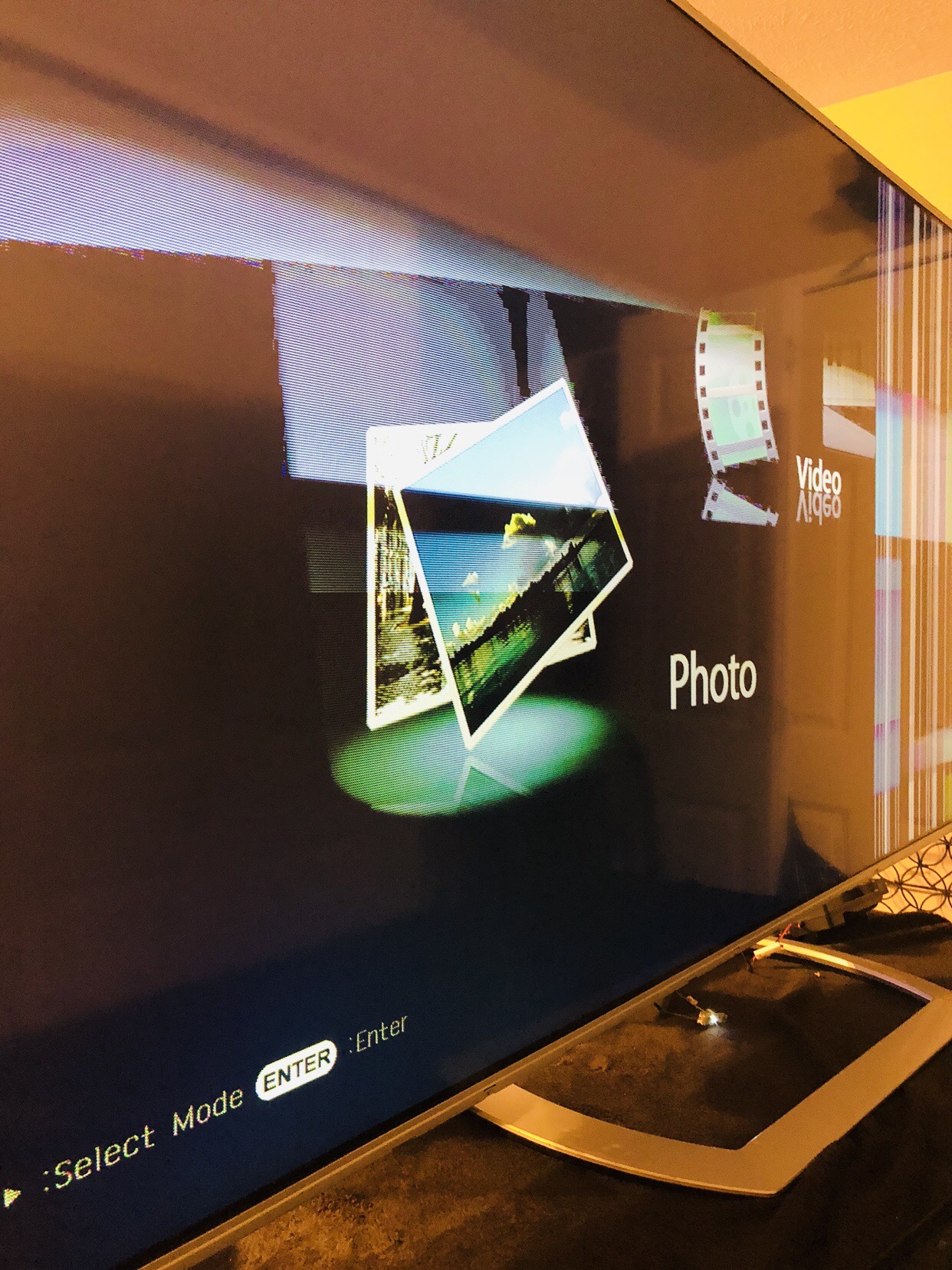

            More pics after messing with driver tab
            • mmartell
              • Oct 2013
              • 3189
              That tab driver is burnt up. Only thing you can try is to remove all the tabs on that side. There are plenty of threads here describing how to do it.
              • charlie555
                • Feb 2018
                • 76
                • usa

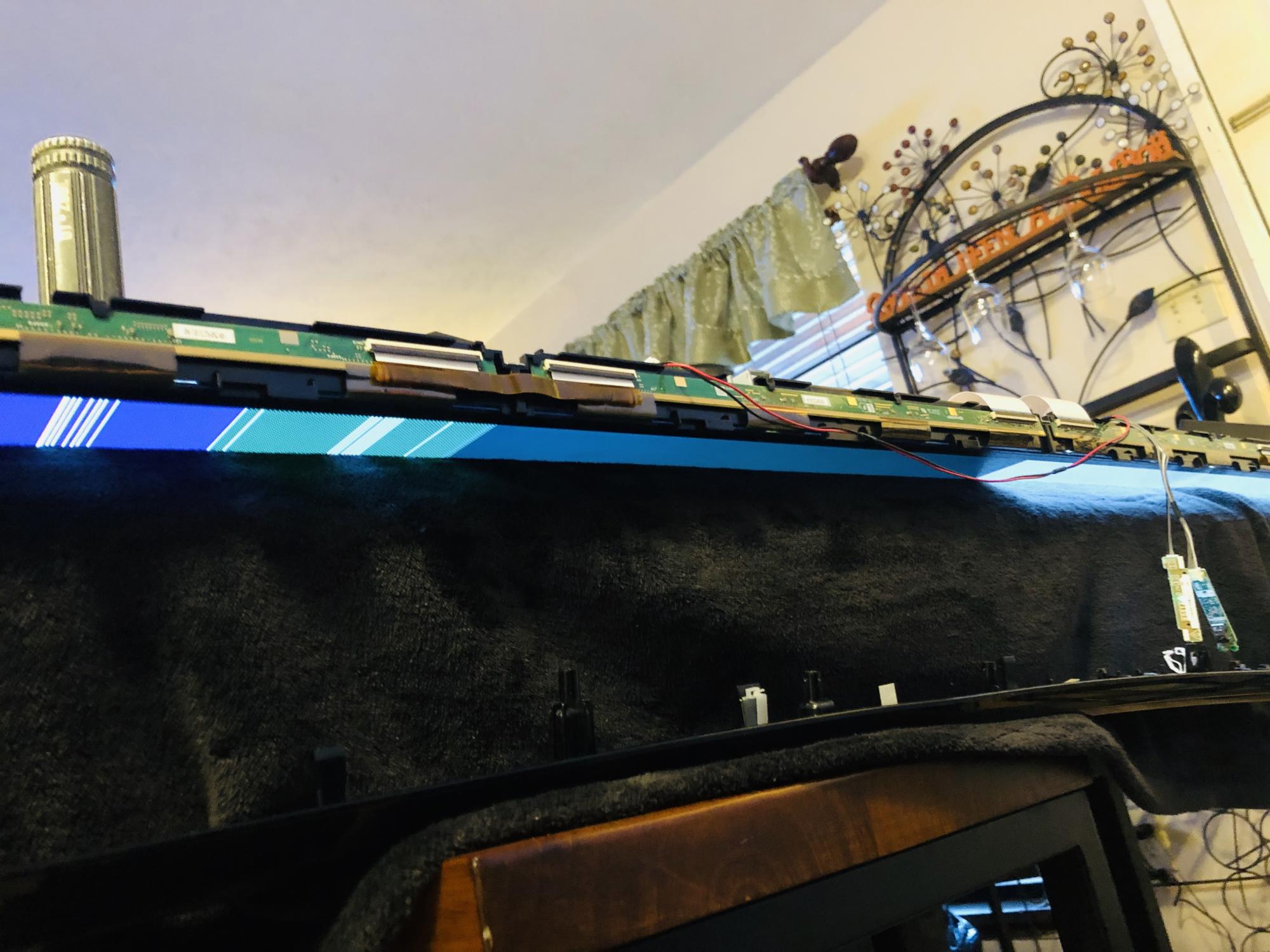

                Yes, I agree with you, so the thing left is the other lines on the far right must be a loose connection on the bottom tab
                • budwich
                  • Jul 2015
                  • 3097
                  the vertical lines could be caused by the side tabs depending on the fault. Before doing any kind of "one way removal", you need to disconnect the small corner cable on the bottom of the set that interconnects the bottom edge boards to the side edge boards. If the vertical lines go away there after, then the problem is with the side tabs / side edge boards BUT if the vertical lines are still there, then the problem is with the bottom tabs / board on that side and is likely not repairable / saveable.

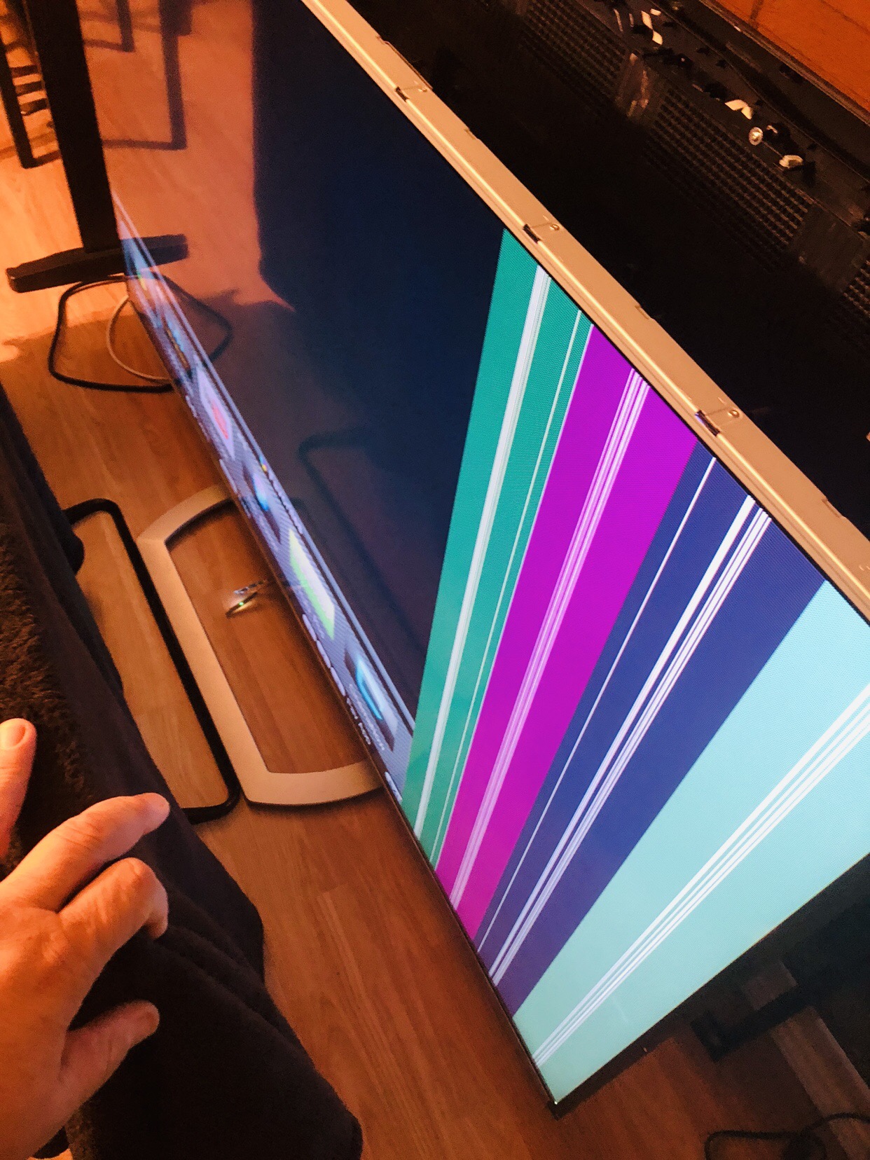

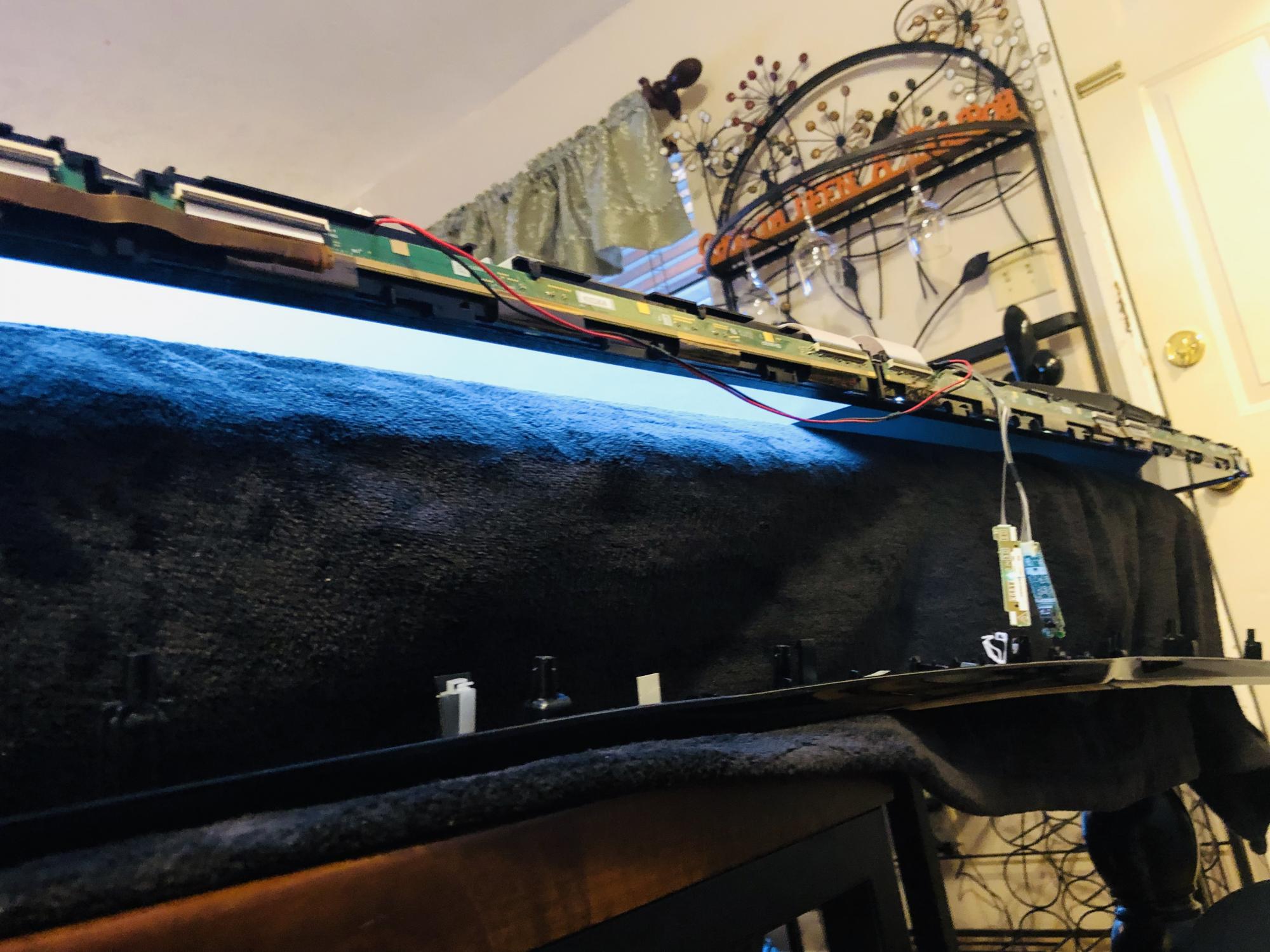

                      So this is all I have to deal with. Could not get menus to show up but now I do. Almost done.
                      • Davi.p
                        Hobbist Tech
                        • Sep 2009
                        • 4286
                        • Italy - Milan
                        BAD SOURCE DRIVERS, if the pressure on them doesn't improve then there's no way of fixing it..
                          I tapped on the driver tabs closest to the tcon board and it went from 4 bands to 2 bands. Another thing is the ic chip on the T’Con is running hot
