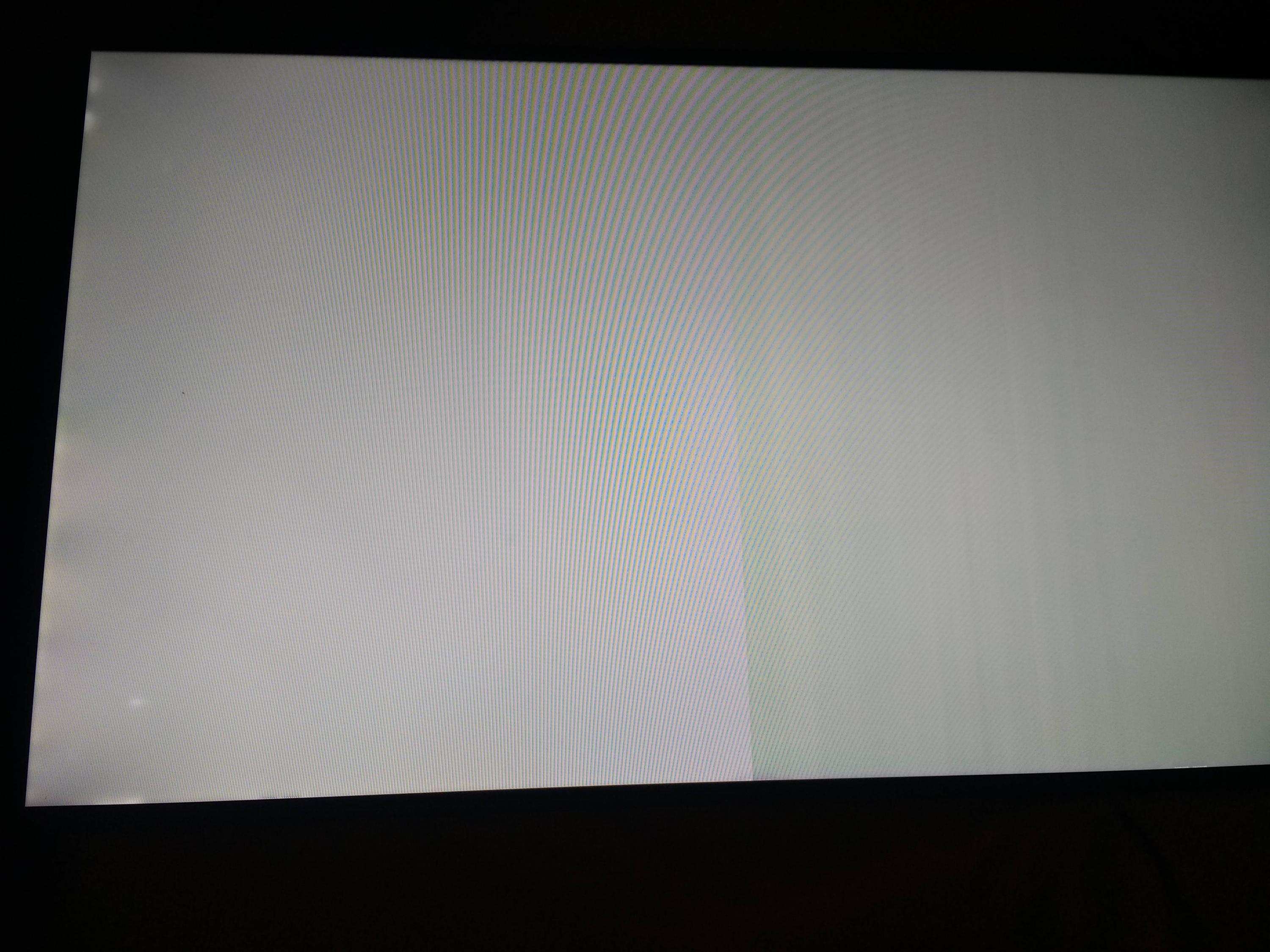

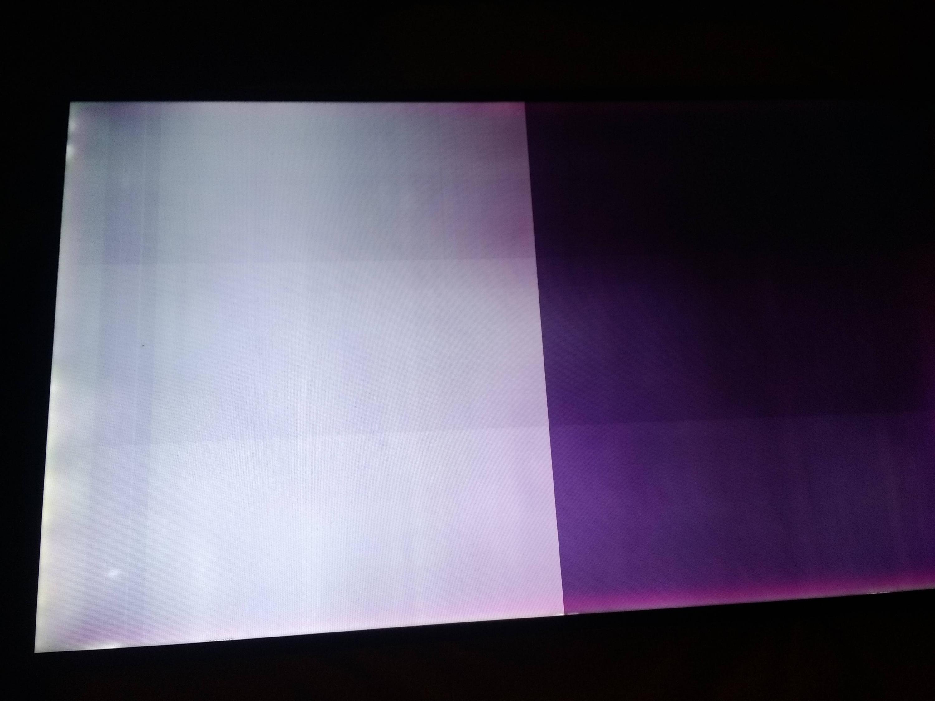

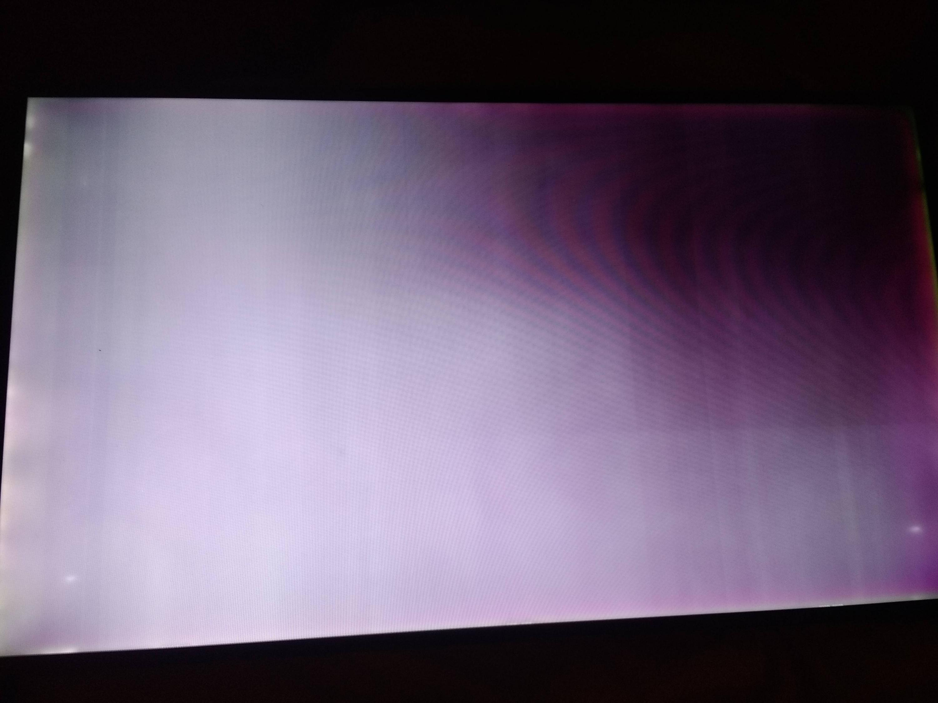

                    Here are pics:
                    To explain, the tabs were removed from the right side facing the screen. I named the pictures with an explanation for their name.
                    I measured voltages on the 2nd t-con board like I did on the one, and they all check out the same as the 1st one that was in the unit while the IC went bad.
                    Lastly, thinking about the current results... first when a tcon to panel cable is disconnected, "normally" that side / half of the display shows a white screen while the other half still connected shows something or black depending on the problems with the set. So from this you see that a "no connection" to the panel results in white while a "some sort of connection" results in black / something / picture.
                    In your case, you are seeing the white but you are seeing "blue"... that maybe just back lighting maybe. Can you post pictures of the display so we can see what you are seeing?
                    The other thing that is unusual but maybe not is that when you have the tcon to panel cable connected for the side that has no side tabs is white while the other half that has side tabs but no tcon to panel cable connected has a white screen... if I understand you correctly for that particular test. This goes against what I previously described as "normally" for the "disconnect test". To me, this seems to indicate problems either with the tcon or possibly with the bottom edge board on the connected half.
                    Tomorrow I'm going to examine the connections on the bottom of the panel to see if there are any issues there that I can see.

                      Re: Samsung UN46ES6003FXZA panel question
                      :-( not sure I still understand whats happening....
                      but here is my take.
                      Second picture is somewhat expected as basically there is connection at all to the right side of the screen with both the right side tcon disconnected and the tabs are also removed.
                      The first picture appears to show an issue with horizontal lines on right side even though there are no tabs attached there... this should normally not happen if the tabs have been cleanly removed unless there is an issue right at the panel, The darkness in the top corner appears to indicate that the driving circuits that remain on the right hand side (probably bottom / corner) still have some impacts / connection to the panel in some form (capacitor / tracking) that holds some voltage for a bit and then eventually disappears... possibly. This might be related to how the bottom corner tab connects and delivers signal / voltage to the side tabs thru the panel tracking. Looking closer at left side, It appears that there is some vertical "bands" on the left... this could be issues with the drive circuits on that side... further of course, there should be a "display" there instead of blank... this means that there is likely no connection / less than good connection on the left side.... although some voltage is present to cause the panel to display white.
                      The third picture looks some what "correct" in some form. As mentioned, when a tcon to panel cable is disconnected, one may expect that side to go "good white"... meaning clean / uniform. This is your case when compared to the right which has "lining"... it would appear that the backlights have issues though. Since the right side has "white" but with some vertical lining, it is maybe trying to make something happen but most likely the connection between it and tcon is less than good. NOTE: when I indicate "poor connection", it could also mean the "end circuits, either at the tcon or edge board. Since both tests kind of show the same thing, my guess would be at the tcon.... but just a guess.
                      Ultimately, it is possible that samsungs don't take to the tab removal method as another poster here indicated a similar result (although its not clear what set is being referred to). The "tape cutoff method" or "track cut method" (discussed in some other recent threads) might be the appropriate method. In your case, without "obvious damage" to a tab, I am not sure whether they would have worked because the damage probably needed to be removed as opposed to "worked around".
                      The horizontal lines that remain even though one set of side tabs has been removed doesn't give one a good feeling... :-( .... BUT they do appear to "correlate" with "three sections" which seem to coincide with "three side tabs". This could be as a result of "poor driving" from the connections from the bottom edge board... which the vertical band on that side kind of shows.... or could be a poor tcon ("broken") that just isn't providing proper signals.
                      You would probably need a scope to track signals going into the tcon and then thru the tcon to confirm... or a known good / working tcon (which could be taken out again if the "panel" still has issues).
                      With the amount of "disturbing" that has taken place on the panel, I am not sure it is worthwhile at this point.... but maybe if time is "free". :-)

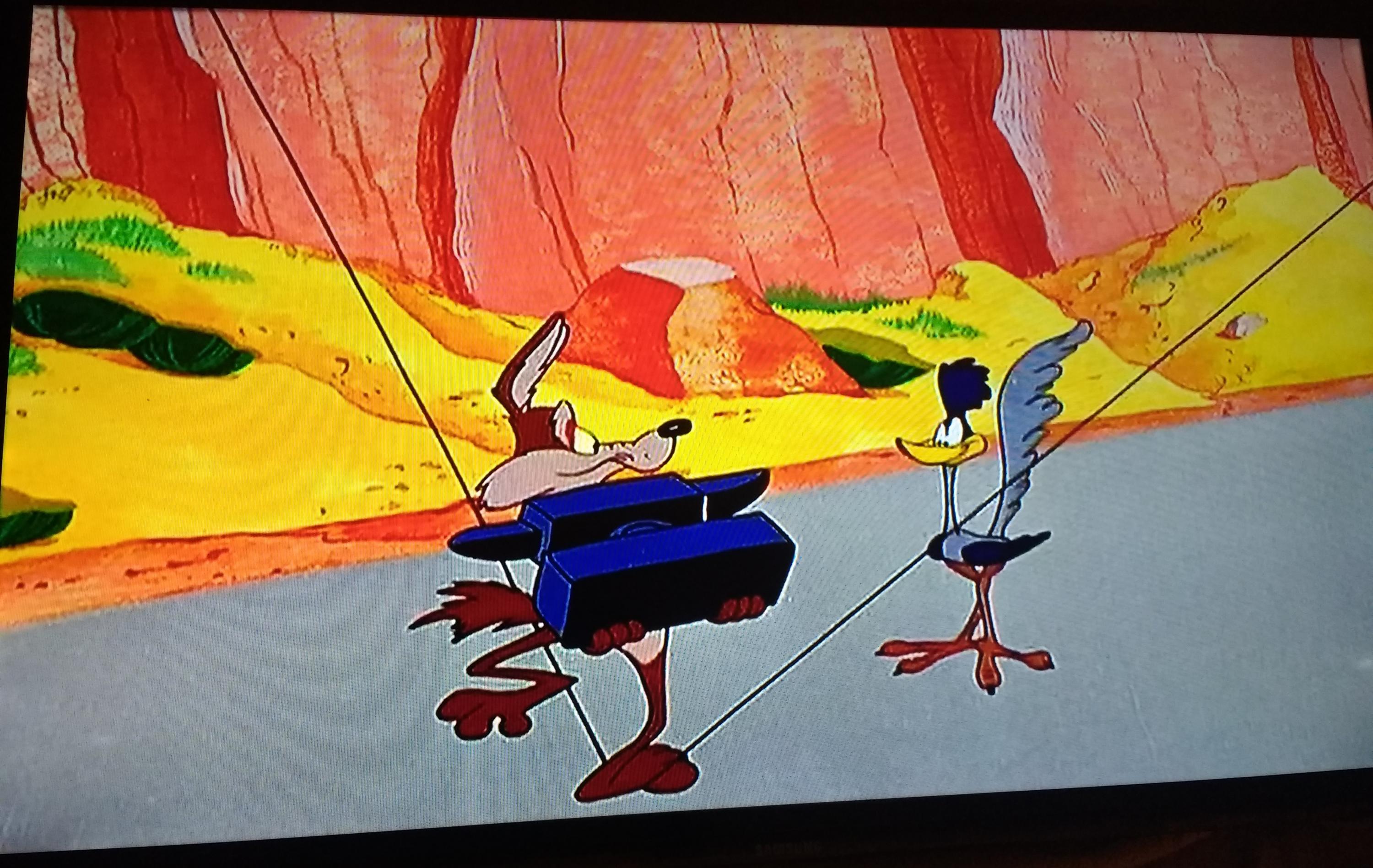

                          I decided to look into something this morning on the remaining tabs on the bottom of the screen, but also the side ones that I didn't take off. I powered up the unit with the tabs exposed so I could hand touch each one and see if there was a problem. Lo and behold, I touched a tab on the lower left side (from the back), and the screen came to life! It turns out I probably disturbed the tab working on the leds, and caused the loose connection. I am going to remedy this situation and put it back together and see what it looks like, and see if it's only a temporary fix.
                          Moral to the story, as Yogi Berra said it, "It ain't over till it's over!" Thanks Budwich for your insights and encouragements to keep looking.

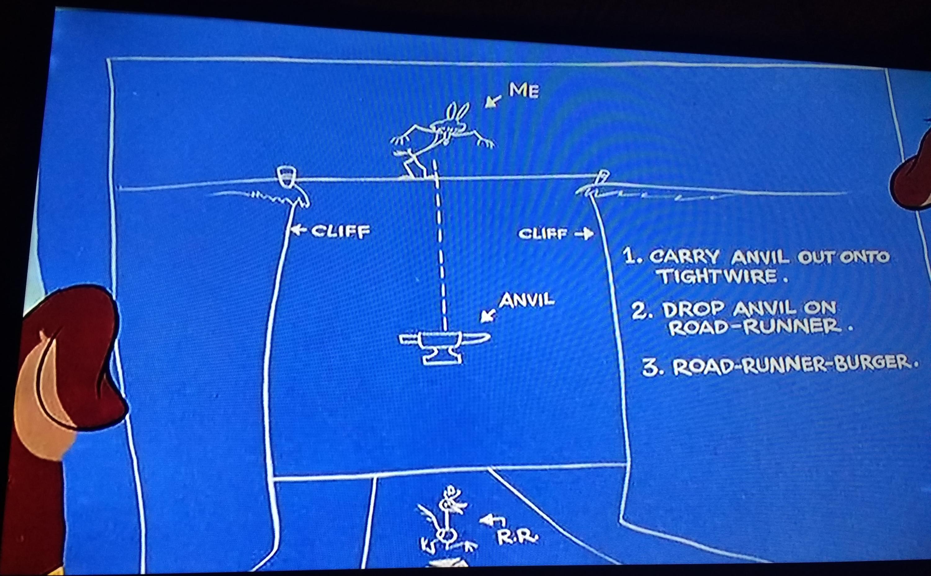

                                Here's the results, I chose some cartoons for the graphic colors involved and to gauge picture quality.
