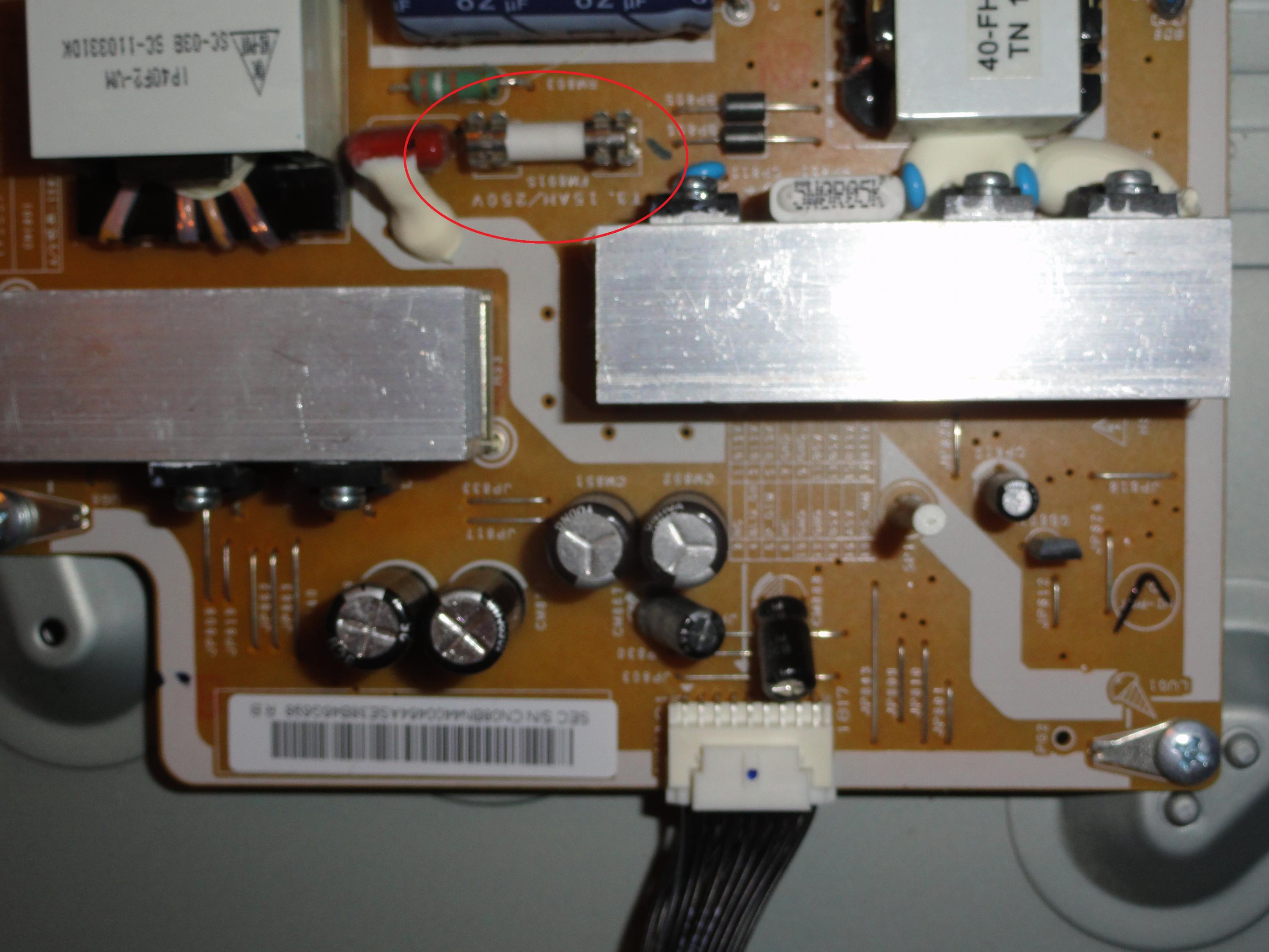

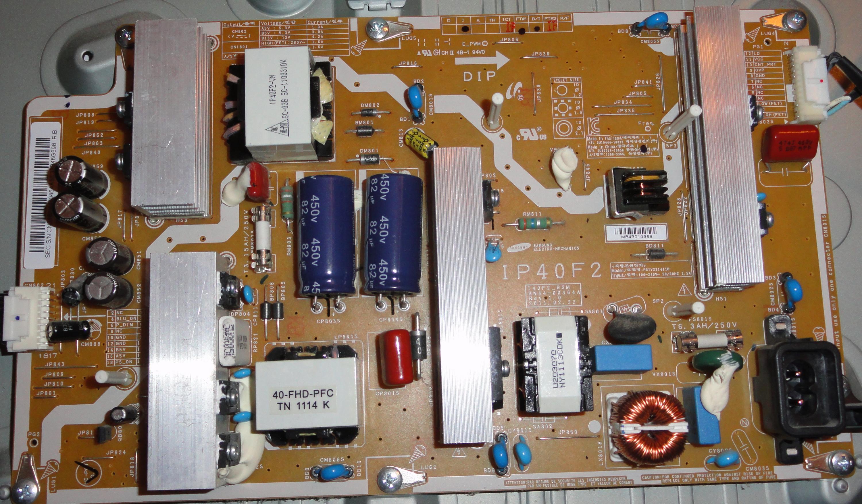

    Hi Folks,
    This might be a board replacement project, but wondering if other have had experience with this.
    Picked up a Samsung 40D630 TV, no power. No Standby or other voltages on the PS board. The large caps are not reading any DC, and AC is showing 1.5 V

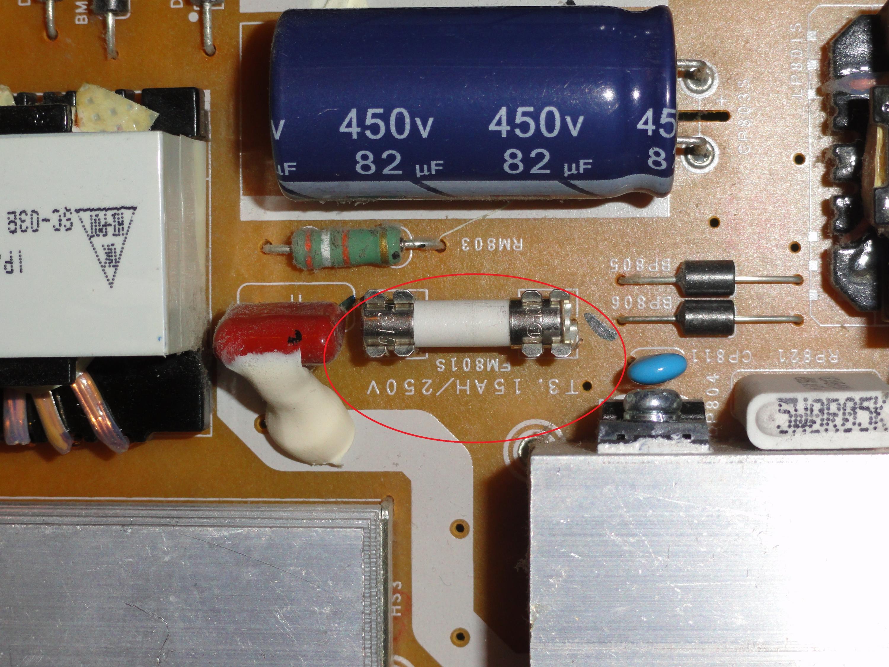

    I found FM801S (cold side) fuse to be open. I replaced it, but no improvement, and the new Fuse is not blowing up.
    PS board replacement, or is it worth troubleshooting the board (ideally, I'd love to, but I never had one with no voltage on the large caps before)
    Thank you

      Incidentally, the Power Supply board is BN44-00464A - Can't seem to find schematic for it.

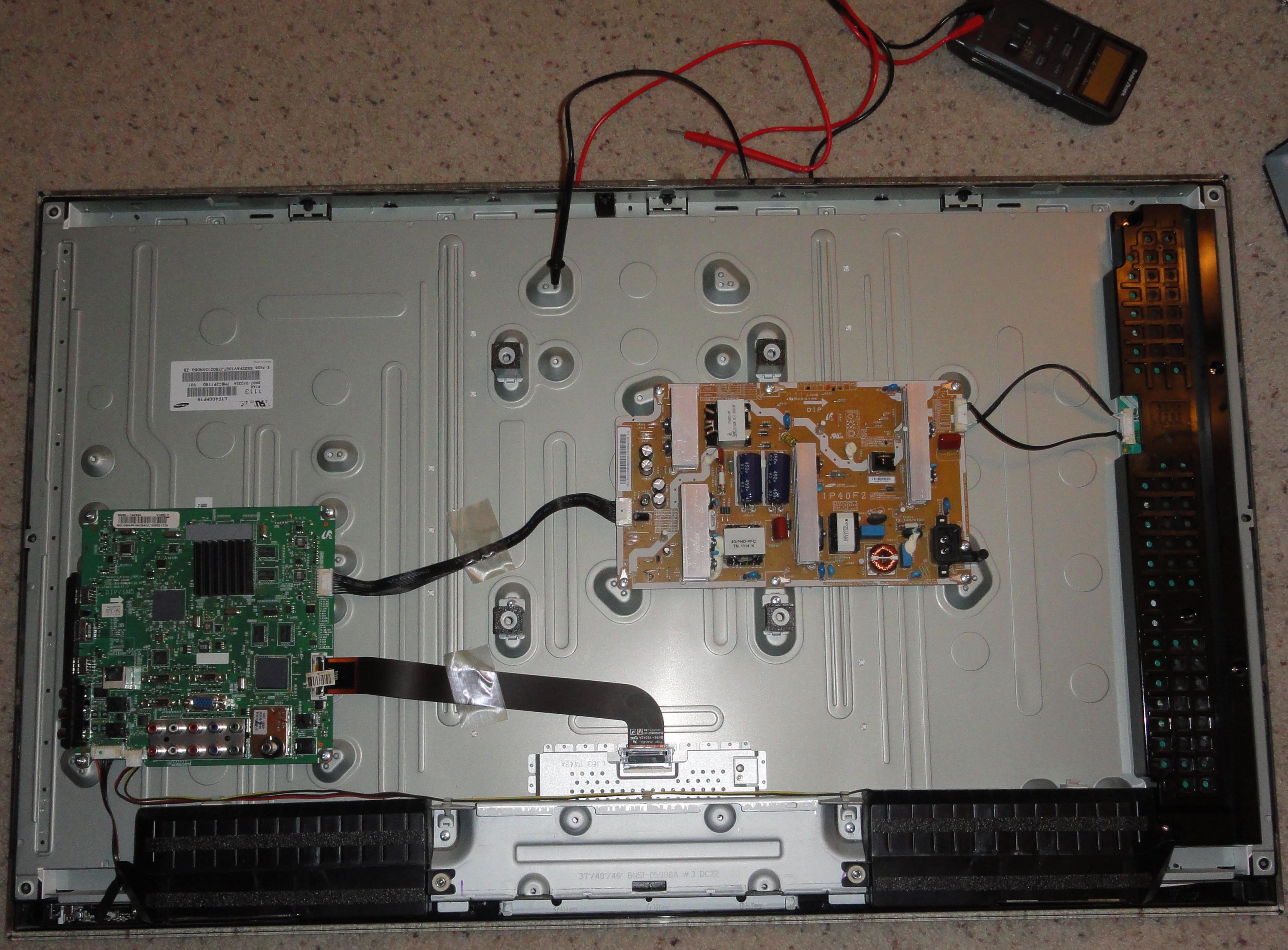

          Solder looks ok. They must have some non-conductive coating on the heatsinks. Differential reading on the large caps, shows 162 VDC.. sorry about that.
          Verified again that no voltages are present on the connector to the main board including the 5V standby. So main board is not getting any voltages.
          Diodes on PS boards check out (at least that they're diodes ), no shorted FETs or Diodes that I could find. ESR checks out (low mOhm) on caps around the connector going to Main board.
          Thoughts??

            SMPS IC UM801S OK?, RM811 OK?
            Fuse FM801S is in the HOT side not cold side, is for supplying the Voltage to run the SMPS IC and the inverter transformer driver circuit.
            Are you 100% sure that FM801S is not blown again? It should have 160VDC with ref to the negative leg of the main filter cap in the cold side.

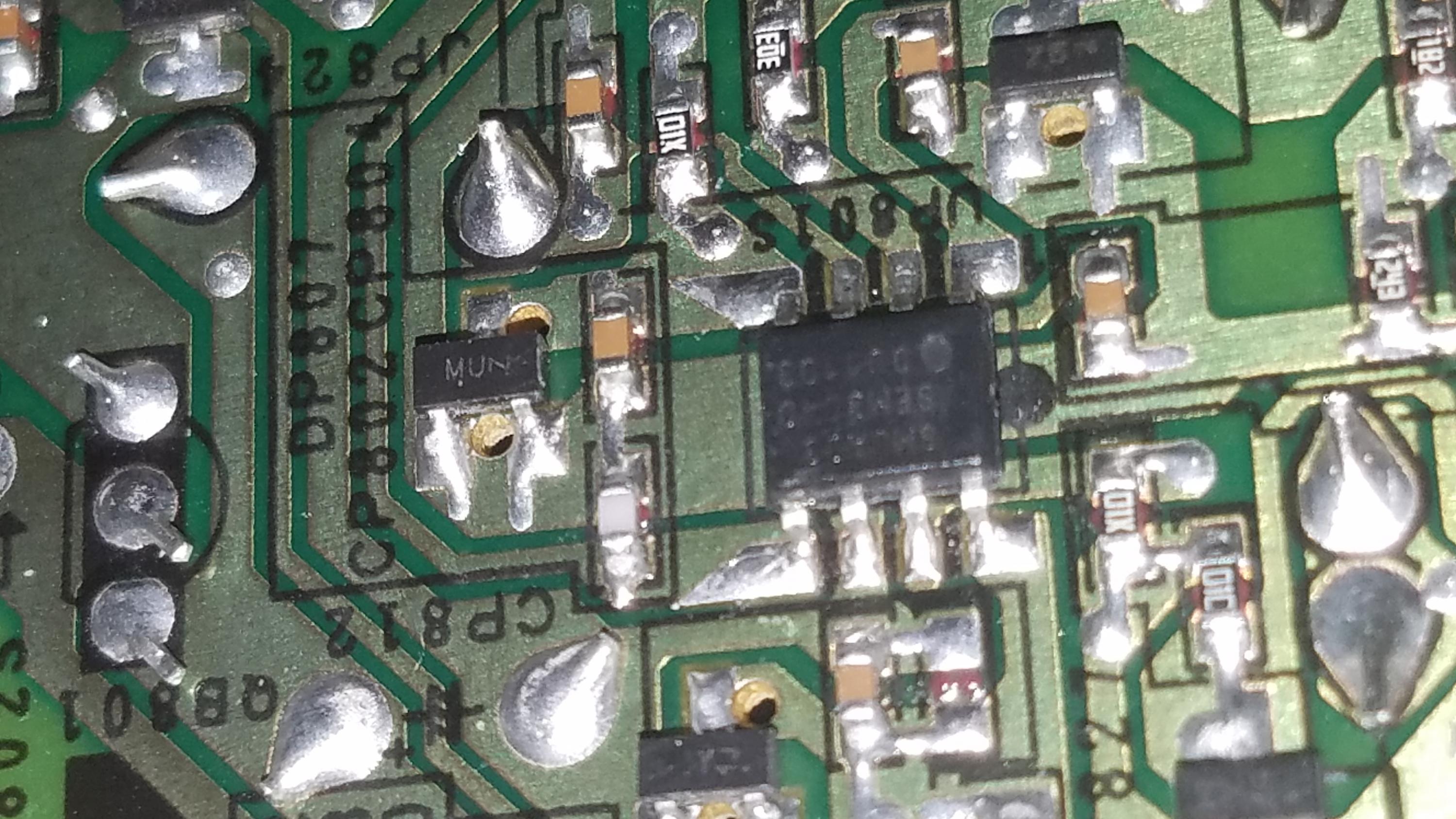

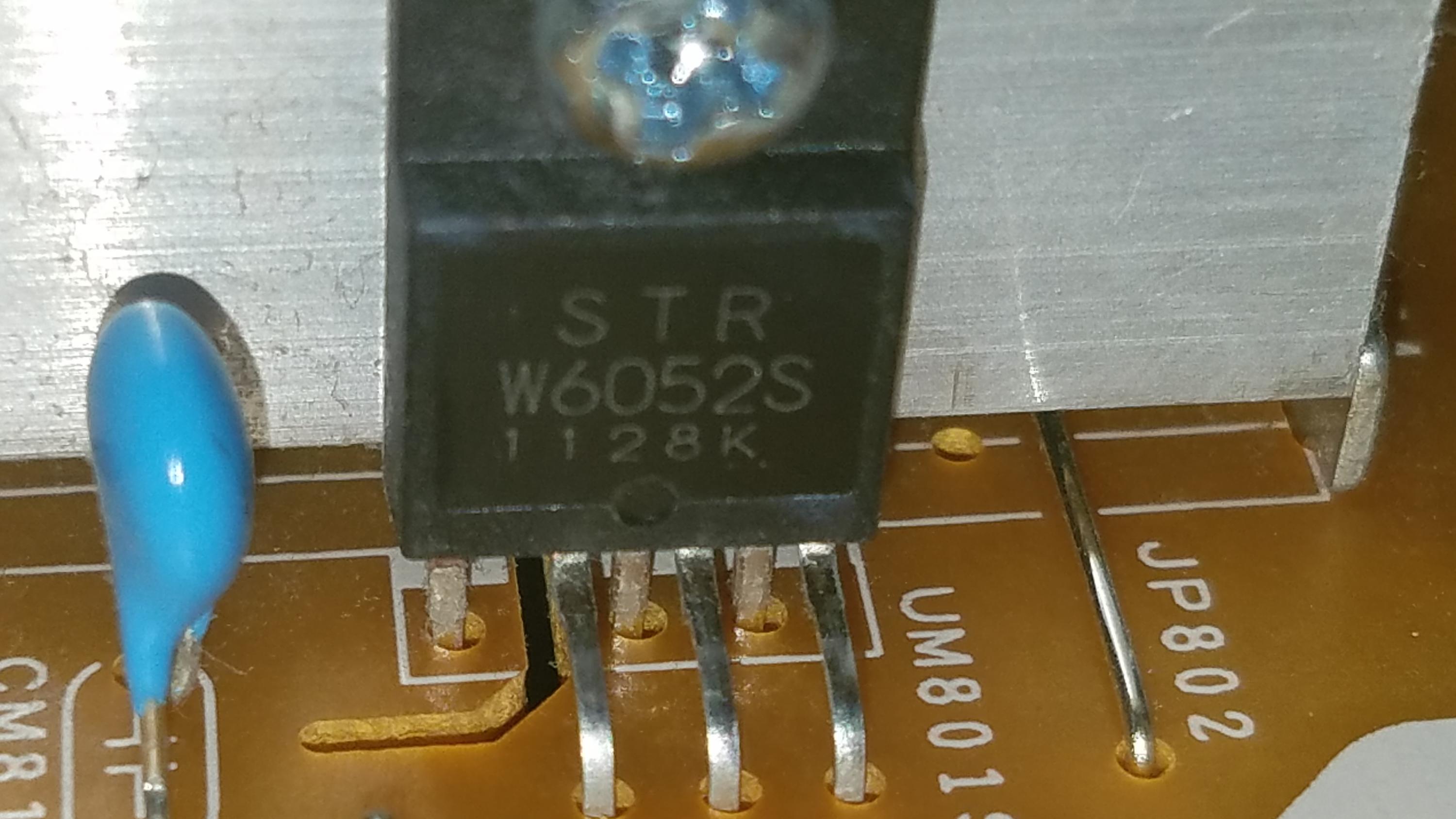

                Not sure how to test UM801s, as i can't read the part number. Chip is in good physical shape and no shorts across pins. RM811 reads ~0.5 OHM. FM801S is definitely not open. Pin 16 definitely does not have any voltage. No short on pin 16.
                I stumbled across some shorts that i don't think are right: DP807 AND CP804 are shorted in-circuit. Thanks

                  Does this IC on your last picture get power?

                    No, pin 8 referenced to pin 6 (GND) or chassis, does not show any DC voltage (or AC) IC is SEM3040, and according to datasheet, pin 8 is vcc, correct?

                      You look at the wrong IC, the one you need to check is UM801S mounted on the heatsink. UP801S is for PFC.

                            Thanks budm.. is there a datsheet for this UM801S? which pin is power I guess . Part number is not legible on the IC
                            You cannot read anything printing on it at all? there must be something legible on it.

                              Ok, got the better scope, and the part number is STR W6052S
                              Looks like datasheet is:
                              https://cdn.badcaps-static.com/pdfs/...d55e88614f.pdf
                              I am not getting any voltages on any of the pins. No VCC voltage
                                Re: Samsung LN 40D630 TV - No Power

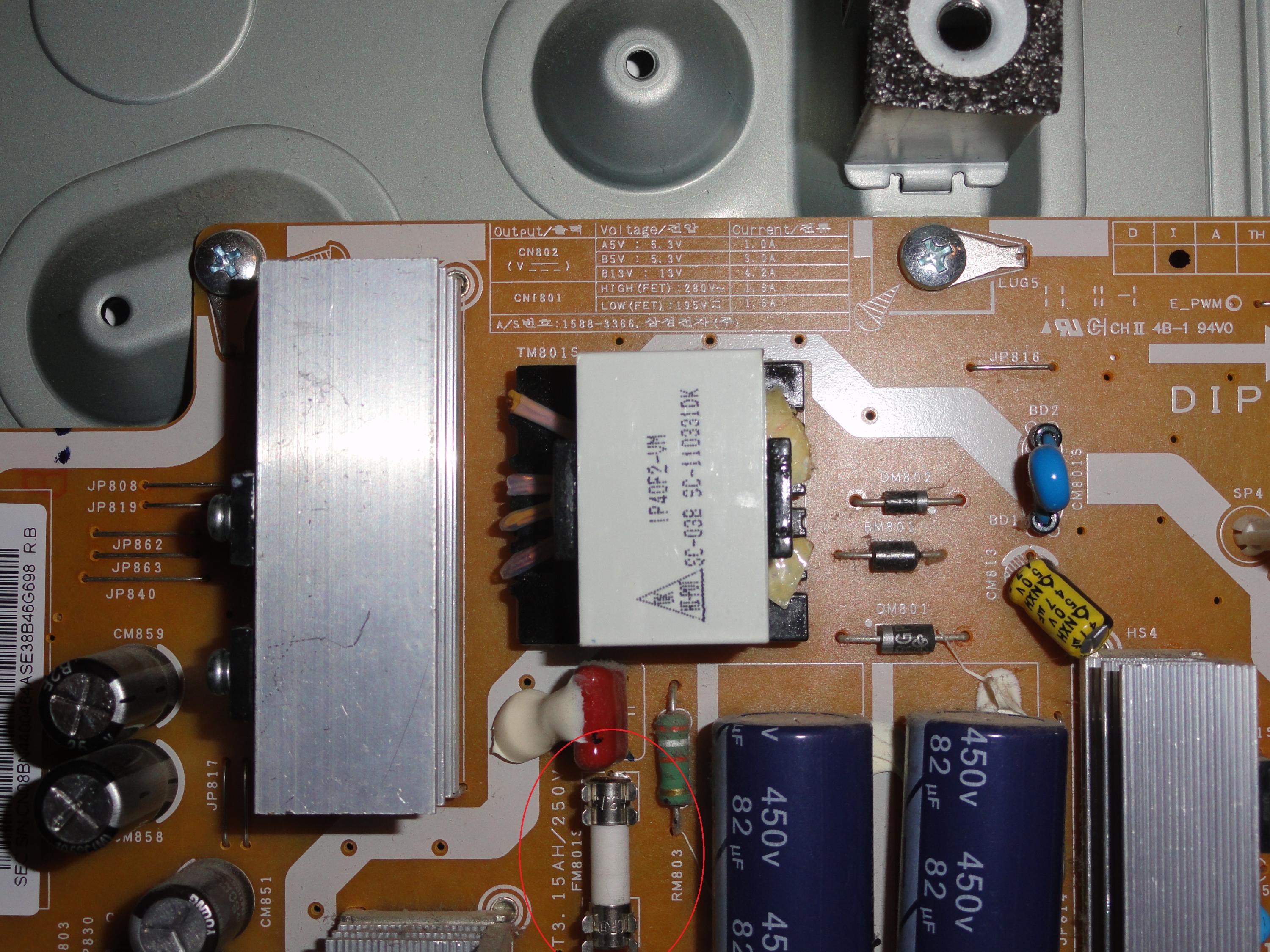

                                Pin 1 D/ST pin should have about 162VDC (if the IC is not switching) through the primary transformer winding which is fed the fuse that was blown earlier.

                                  0 dc on pin 1. AC is jumping around 3 to 44 to 2.4 to 0...is it the IC that's bad or transformer replacement you think?

                                    Naturally the new power supply board fixed the problem and the TV is working.. But would love to troubleshoot the Power Supply if at all possible.. if anyone has any ideas, or can share schematic.. I'd be appreciative.
                                    Thank you
                                      Well, you have good board and bad board for doing the resistance comparison readings.
                                      Check that pin 1 of the SMPS IC again, it should have continuity all the way to that blown fuse.

                                        It does.. after taking the measurements yesterday, I guess the fuse did blow again. I also see that pin 1, 3, 5 and 7 of that IC are shorted.
