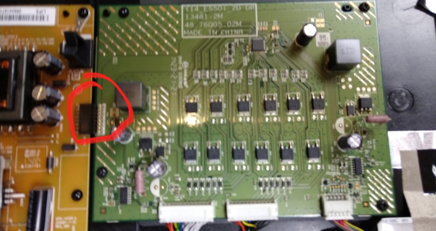

    I've been given this set, the left front corner where the IR sensor board should be was broken and that board was missing. Replaced that board today and the LED light on the board lights with the remote, and remains lit. No picture or sound. If the Visio logo is supposed to light, it does not.
    Haven't had a chance to pull the back yet--but can some suggest what I should be looking for?

    probably an eeprom or a voltage regulator on the main board.

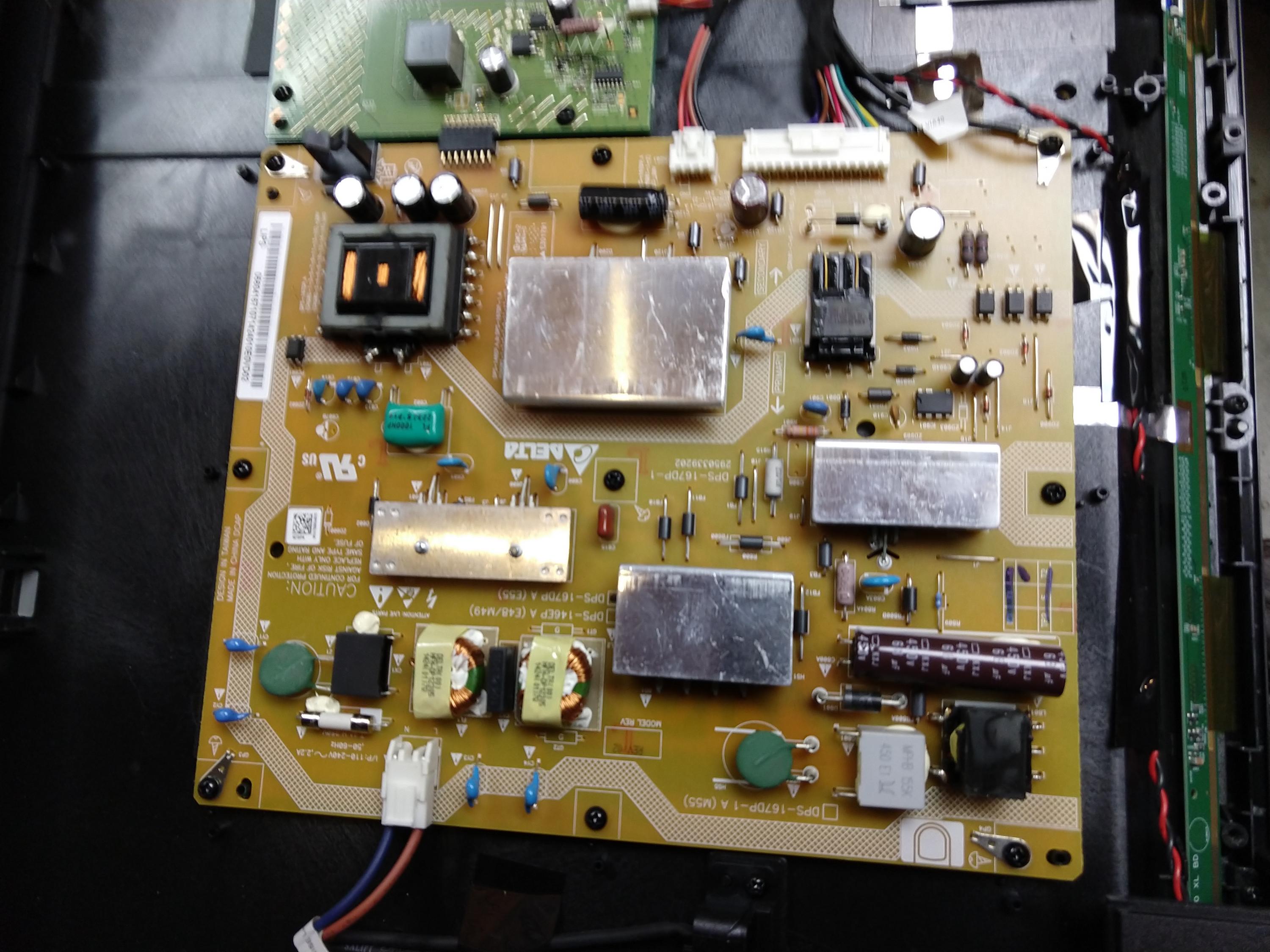

      You're a lucky man. It is the Vizio 056.04167.1071 Power Supply Board Cn202 connector has very bad solder joints. Resodler the cn202. Tv 99% will works. I've repaired 8 of them.

            Remove the lead free solder and re-solder with leaded solder and it willbe good as new.

              I want to be sure--we are talking about the power supply or main board? Thanks

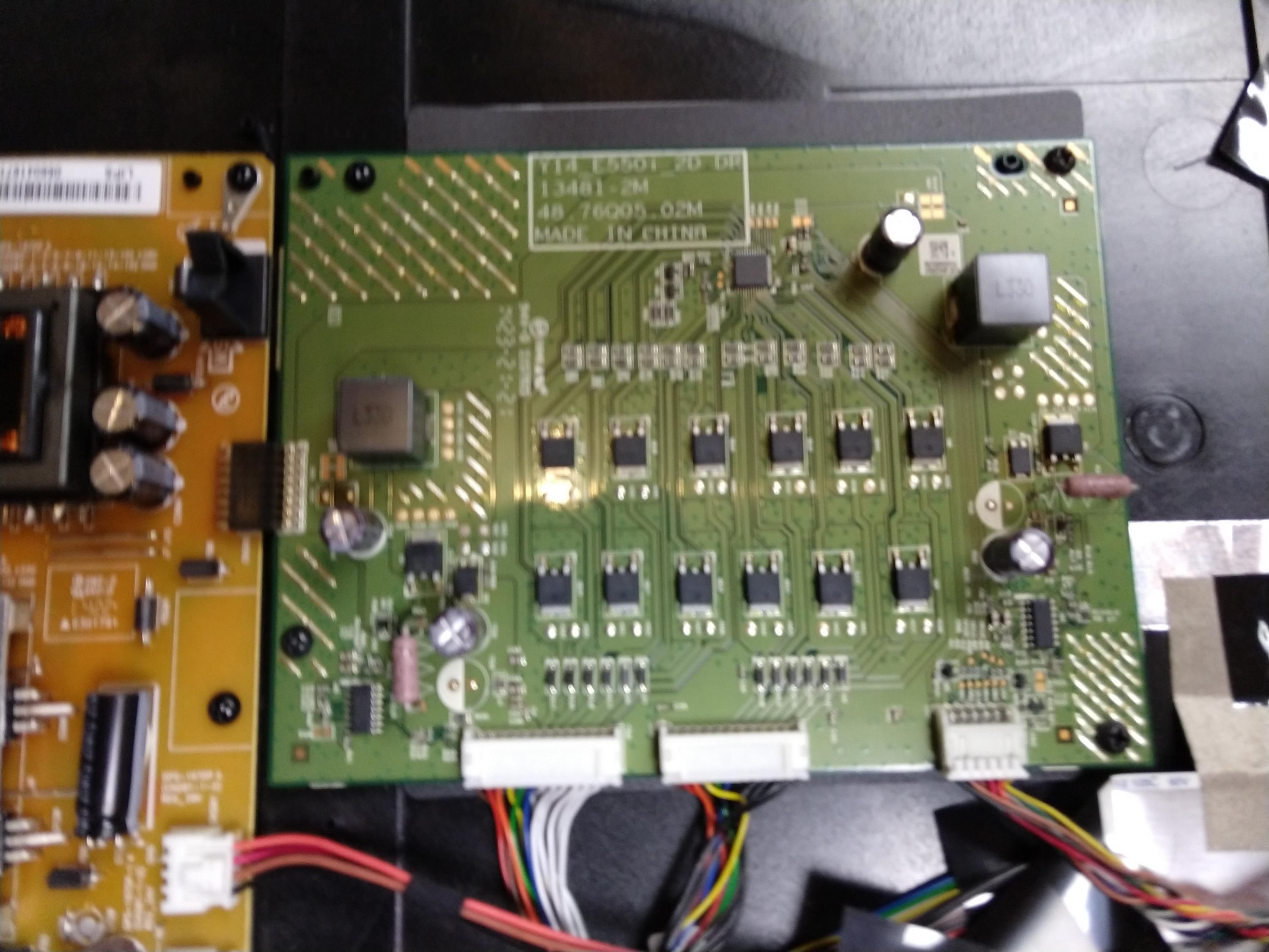

                  Its the connection between the power board and the led driver board. You can wiggle it and see it move.

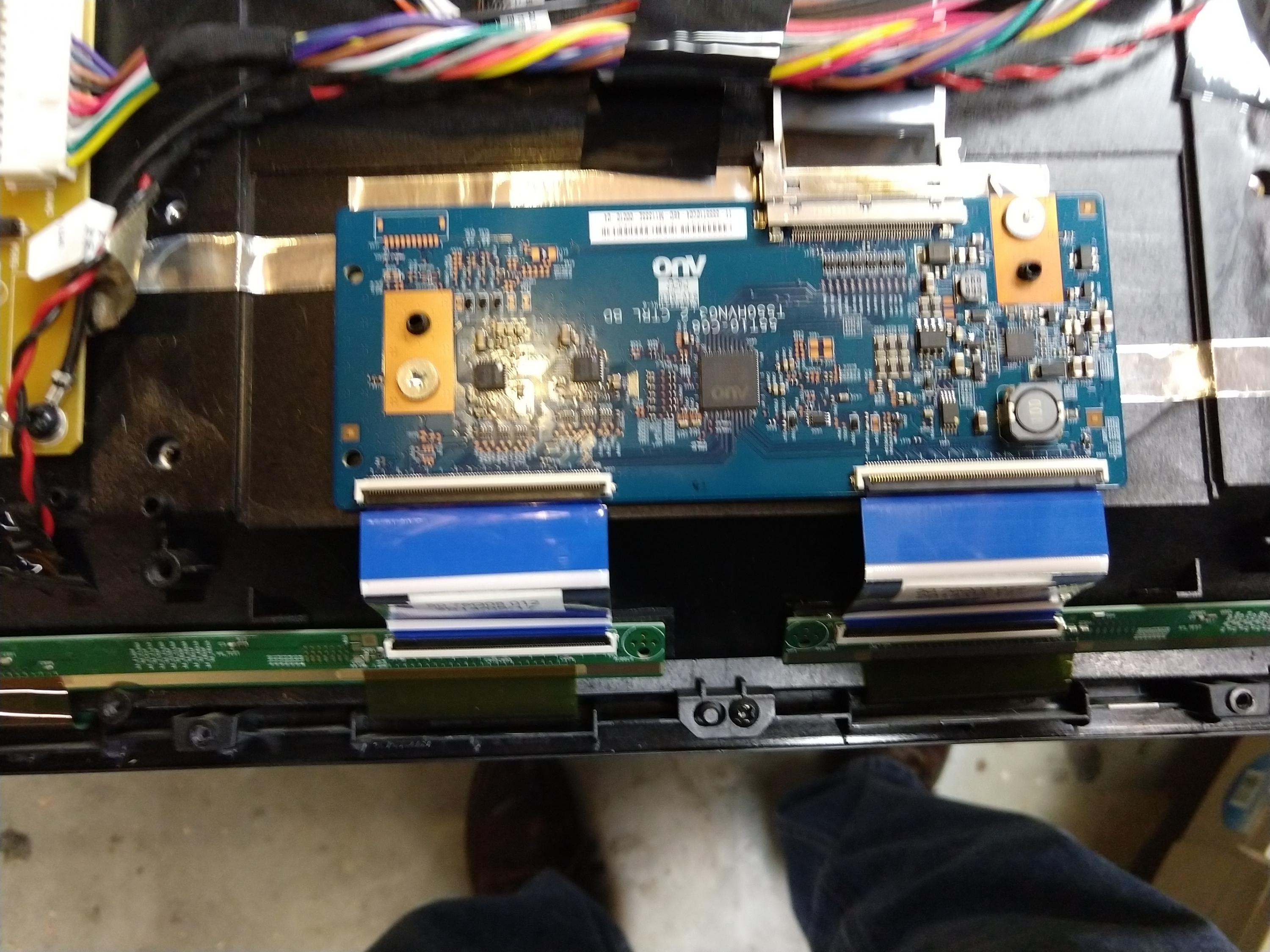

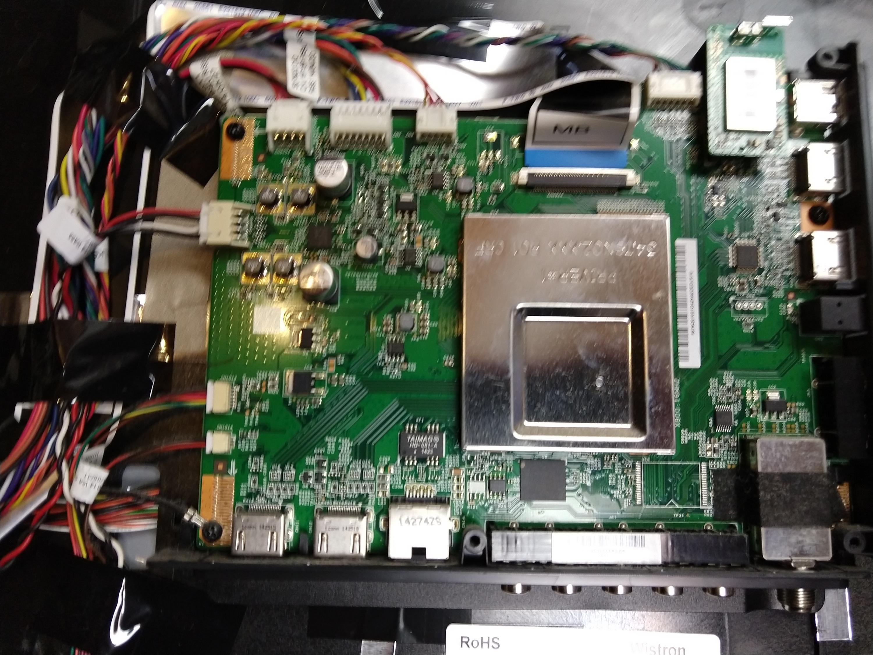

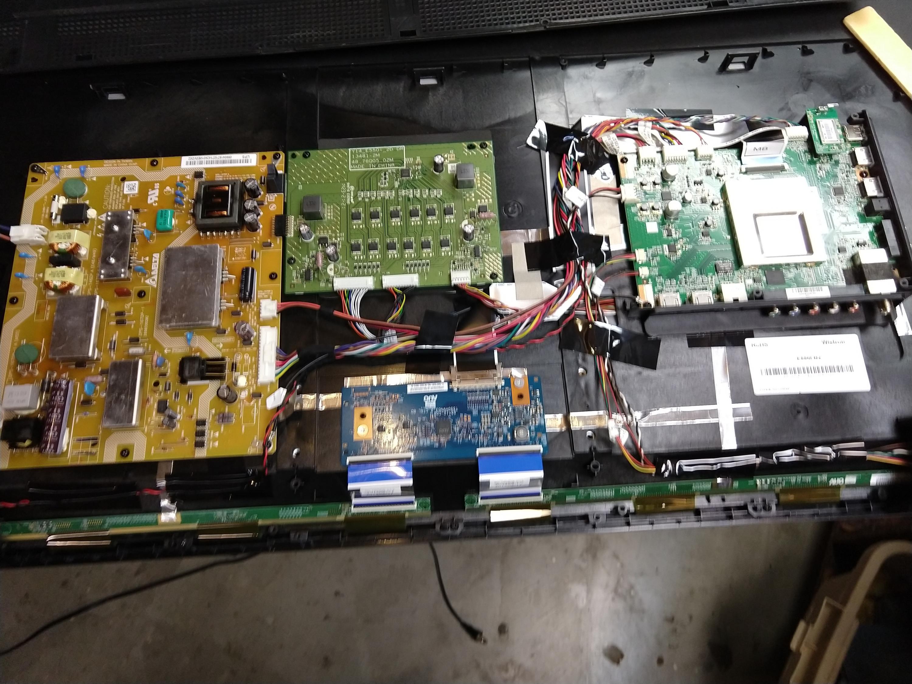

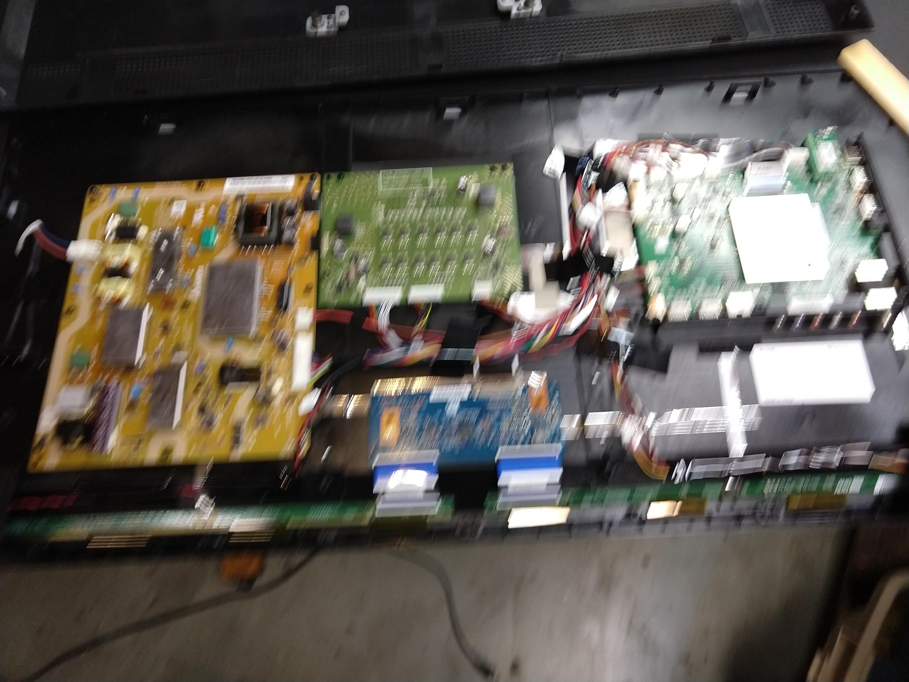

                      Attached are pictures of the internals. Don't see a connector with soldered ends.
                        Re: Visio E5501-B2 no picture or sound
                        Did you read post 8 and go to the link?

                          Do I understand correctly that bridge connector between the two boards was replaced by the wires shown?
                          • CapLeaker
                            Leaking Member
                            • Dec 2014
                            • 8327
                            well... check em for cracked or cold solder joints on both boards. Just resolder them for now with fresh solder.
                                The connection is on the back of this area.

                                  Resoldered those connections and it now works great. Thanks, gentlemen!
