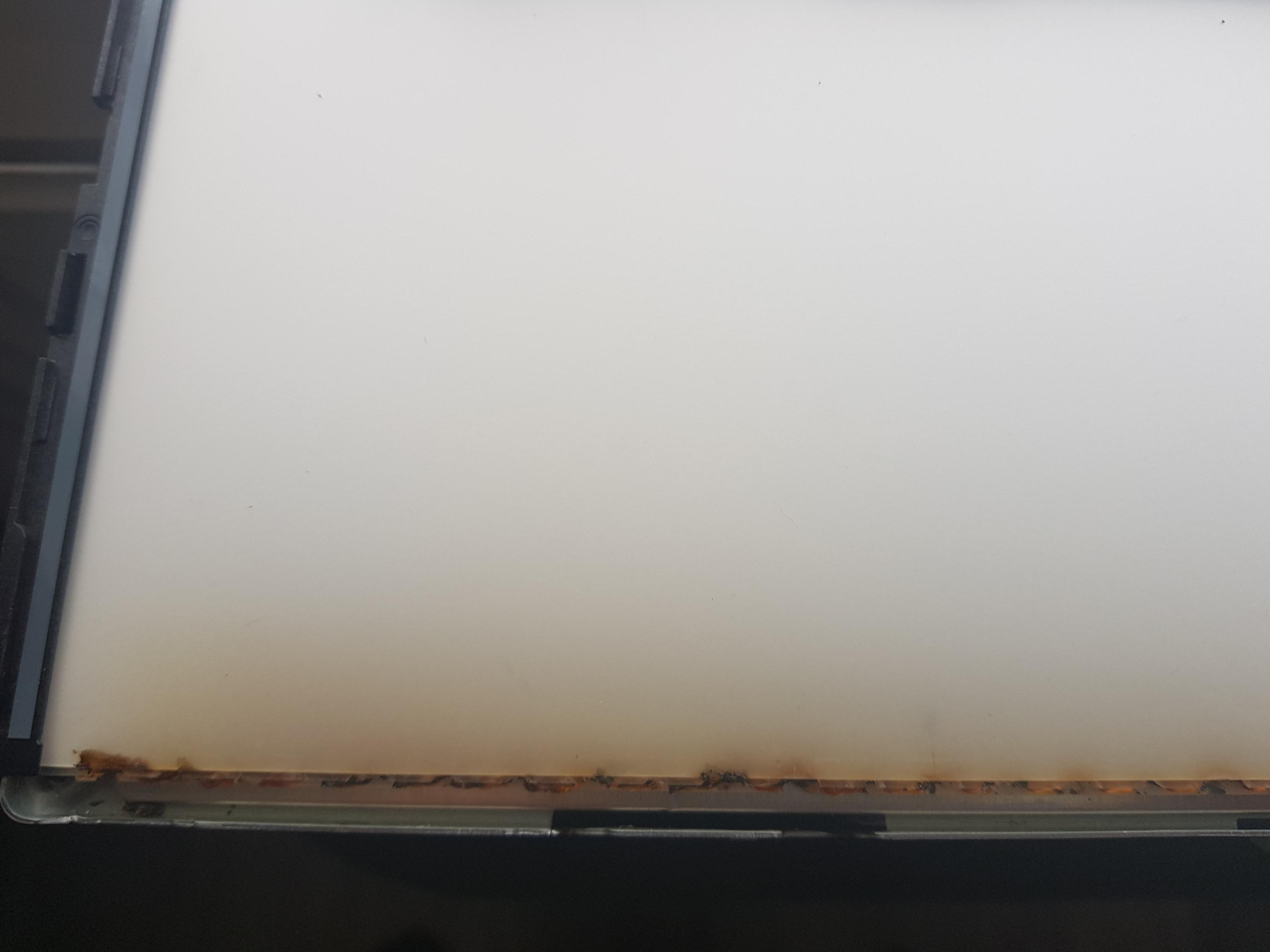

        Just a update for anyone having issues with no backlight and led voltages are reading 365v dc samsung ue49ku6470 same backlight as the model number in this post and when I stripped the screen the left side strip totally burnt out possibly water corrosion
