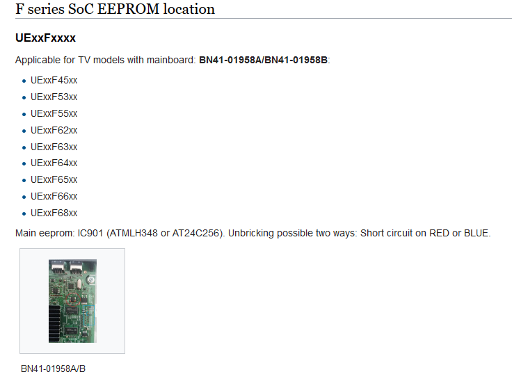

                                    un bricking ic1901
                                    https://wiki.samygo.tv/index.php/UnB...M_.28EEPROM.29
                                    • finntricky
                                      • Jan 2014
                                      • 449
                                      • uk
                                      Re: SAMSUNG UE46D5520 rebooting
                                      tryed that as well Vinceroger69
