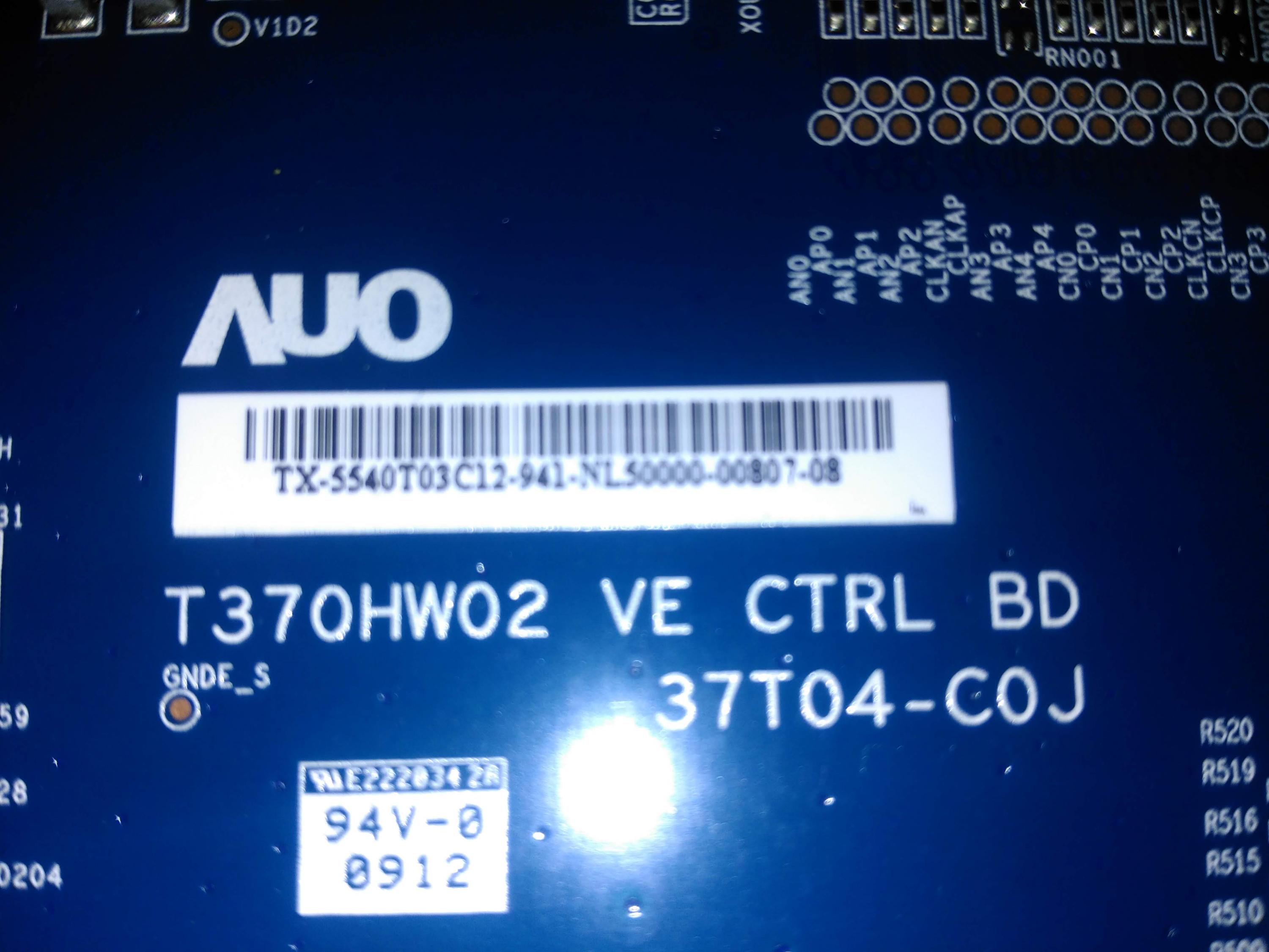

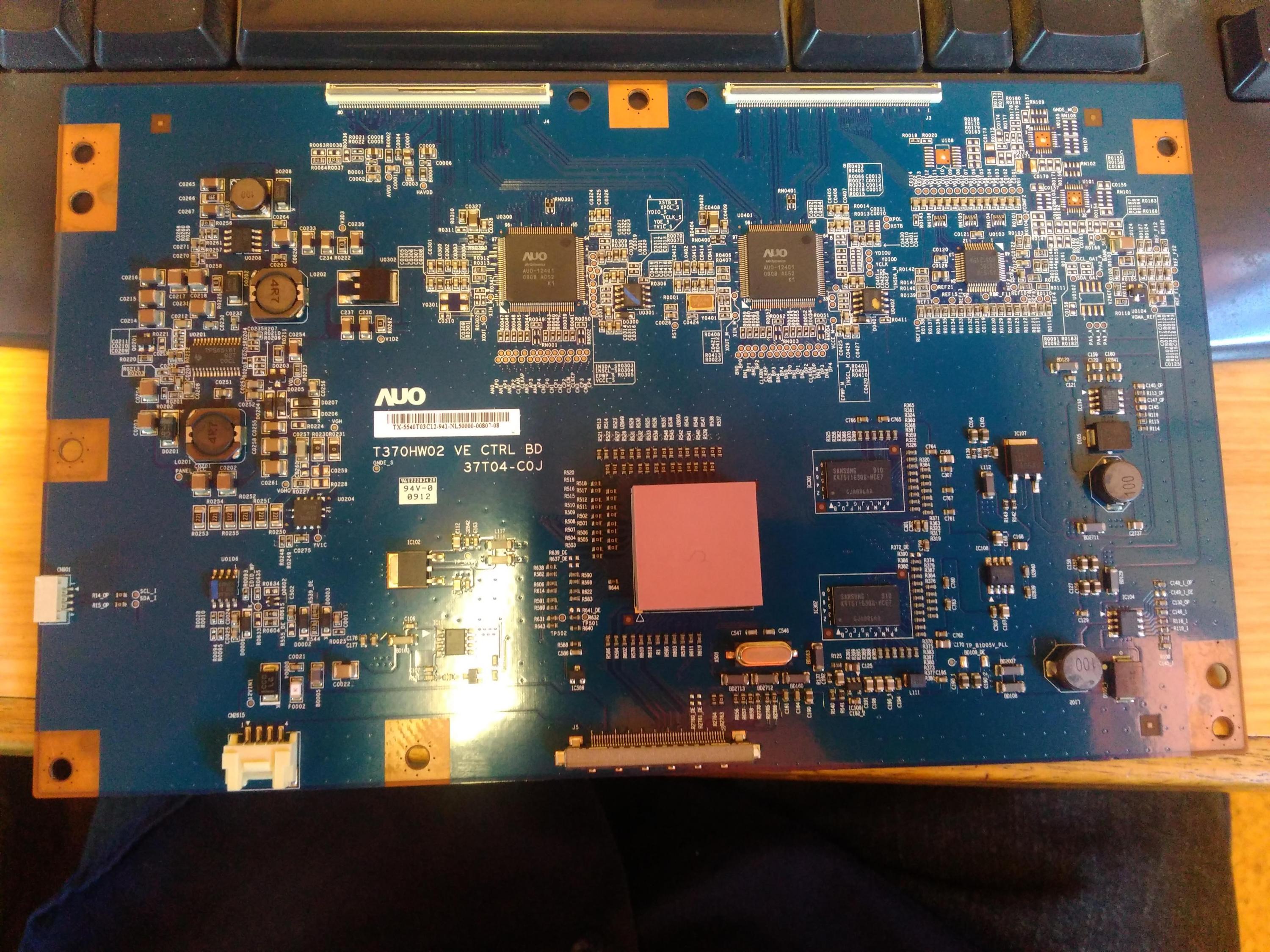

    I have the classic failed AS15 chip problem on the T-Con board. I want to fast track this repair and purchase a replacement board. But I'm seeing the same board type number for screen sizes from 37" through 46". And Sellers' website asking you to specify the screen size you want. I'm looking at one particular seller who says "Only for 46" screen" and TV in question is 40". Looking at image of the board on the website it appears physically identical.
    Any experts want to advise whether I can risk the purchase or whether there is perhaps a firmware difference that prevents it from being interchangeable across different screen sizes?
    Re: T-con: T370hw02 ve (37t04-c0j)t-con: T370hw02 ve (37t04-c0j)
    The white silkscreen printed on the PCB is for the Blank PCB P/N which can be stuffed to make many different PCB Assemblies, you need the PCB assembly P/N which should be on the sticker.
    Show us good clear pictures of the board.
      Here is a view of the T-Con Board, and the type numbers.
      The one I've been looking at has the following on the sticker (blurred at magnification level, but pretty sure it reads: TX-5546T03C11 etc
      I think that answers the question. Mine says: TX-5540T03C12
      The code obviously refers to screen size.
      Thanks. I almost made an expensive purchase decision.

        I do not know if you can get access to shopjimmy website or not.
        https://www.shopjimmy.com/auo-55-40t...-con-board.htm
        Samsung 55.40T03.C12 (T370HW02) T-Con Board for LE40B650T2WXXU
        Part Number: 55.40T03.C12
        MFR Part Number 1: AUO 55.40T03.C12
        Board Number(s): T370HW02
        Panel Sticker Number: T400HW02 V.5
        Panel Manufacturer: AU Optronics

          Thanks Budm. I've found the right one too coming out of China that I can pay expedited shipping on to get it here fast. Ends up being a rather expensive board, but it is new as opposed to refurbished exchange, which was my only local option here in Oz.

              Just to close the thread, I replaced with a new T-Con out of China, specifically for the 40 inch screen, and all is good!
