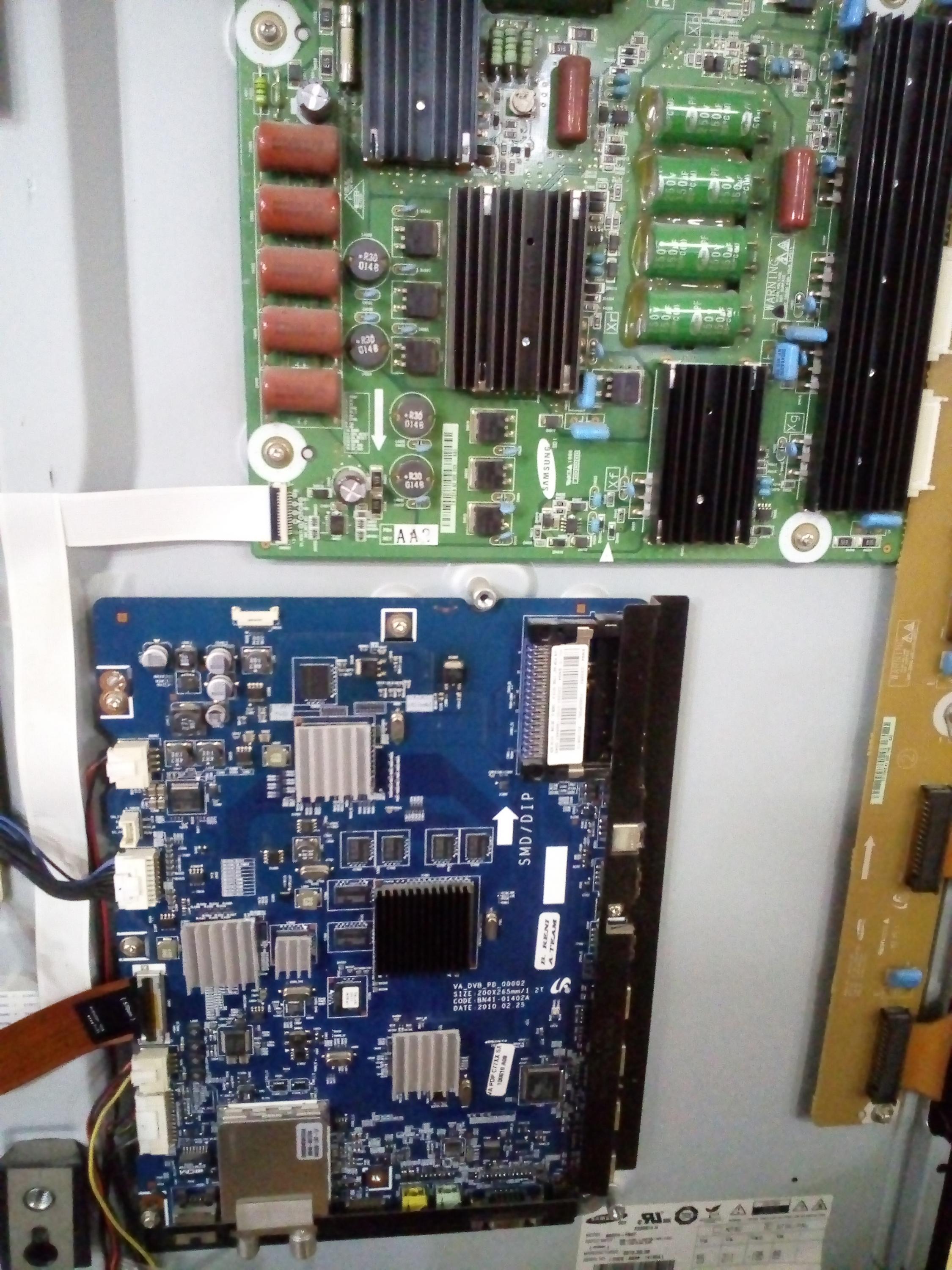

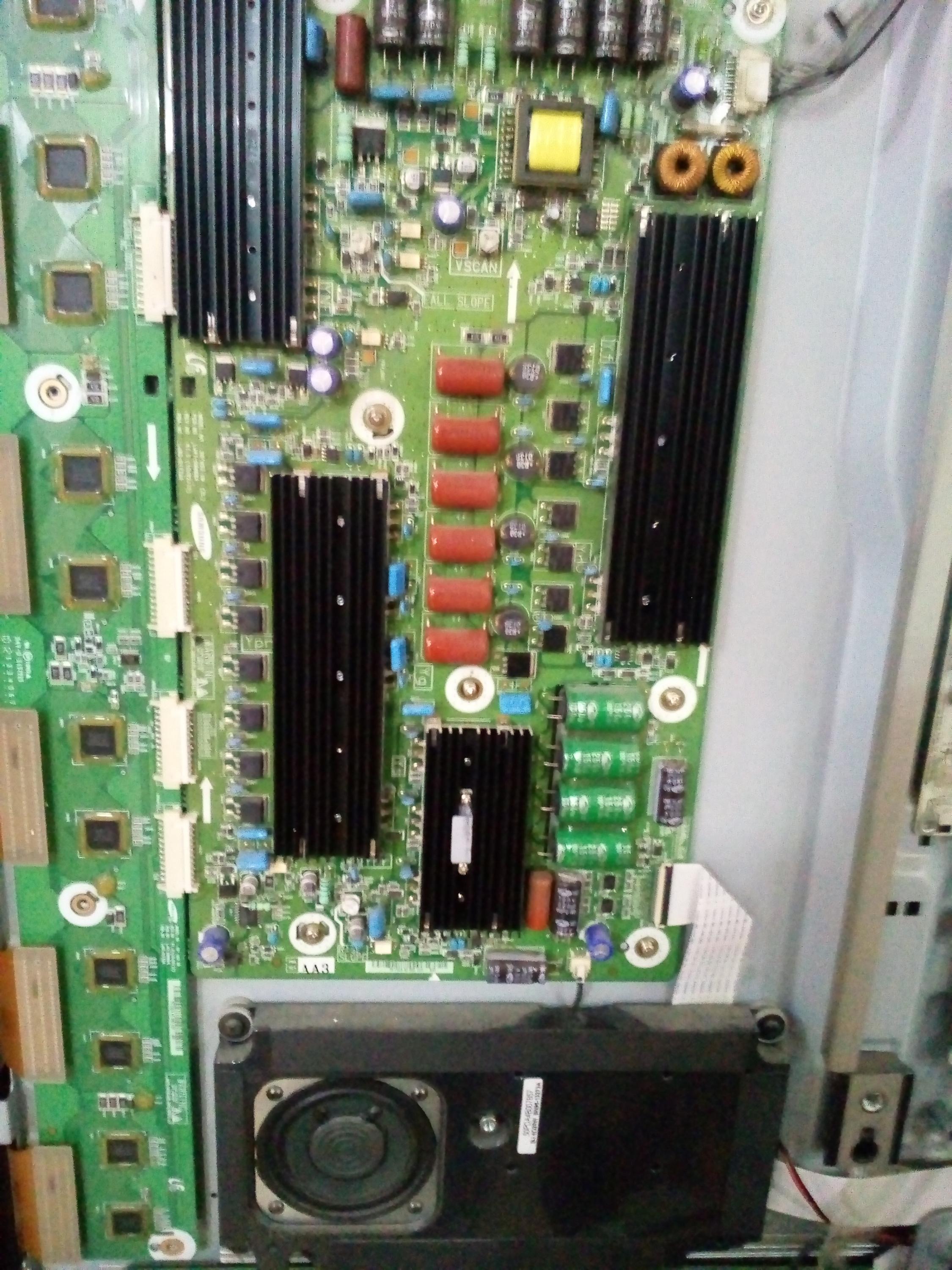

    I have Tv with some strange problem
    Samsung
    Model:PS50C7705YS
    Model Code:PS50C7705YSXXE

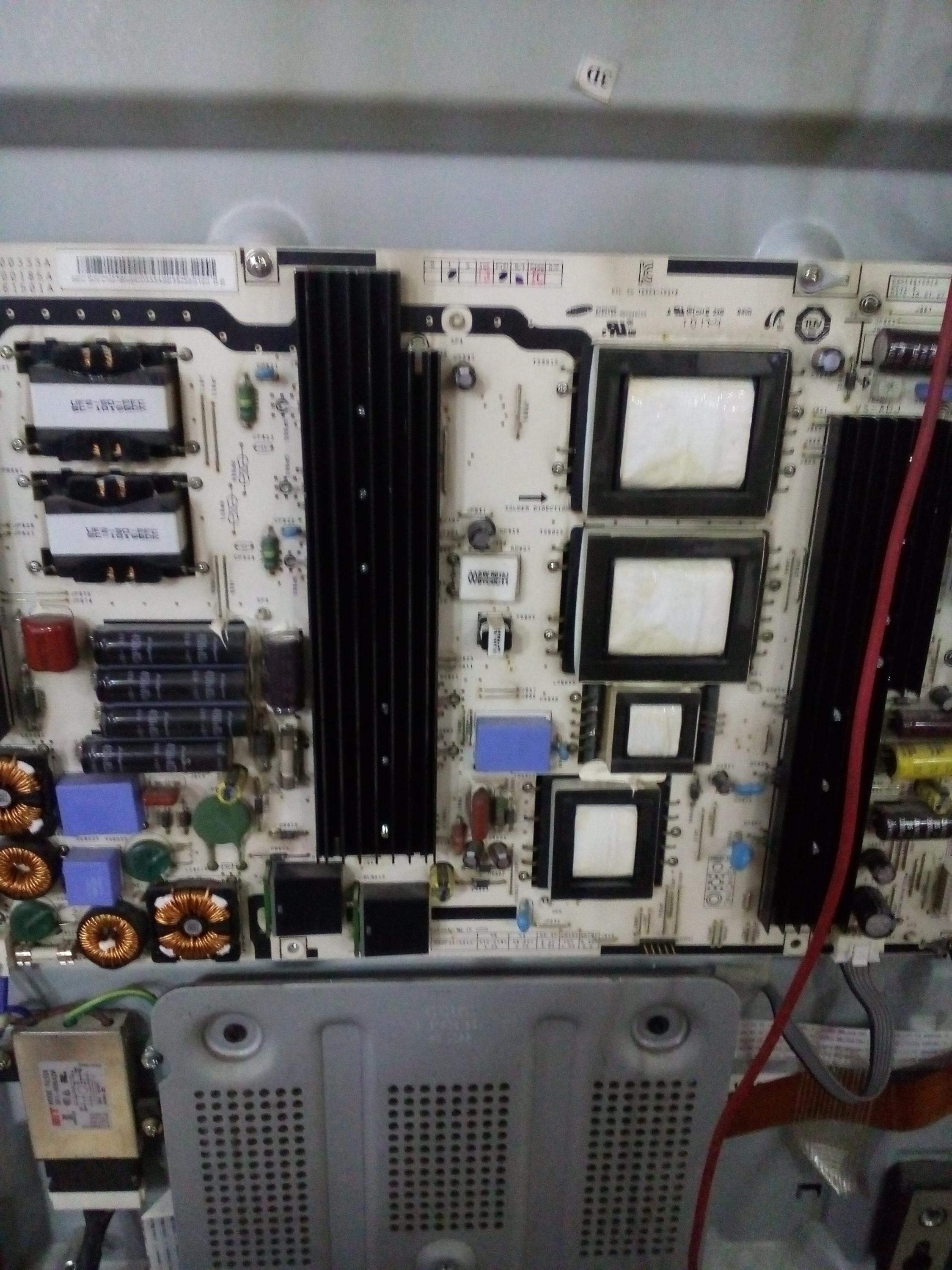

    Problem:When everything is connected power drop fast(from 211v to 0v) with quick flash on screen.When i disconnect ribbon cable(YSUS) from T-CON,Vs stay normal (211v).
    Any suggestion?

    Disconnect the connector with the Vs voltage going to the Y-sus and Z-sus Bds. Connect a 230V or two 120V household bulb/s across Vs and GND. Apply the ac. If the PSU is good the bulb/s will light up bright and remain ON. Problem is on another board. If this does not happen PSU is bad.
    • Munem2x
      • Dec 2018
      • 7
      • Serbia
      Re: SAMSUNG PS50C7705YS loss power
      Bulb works normally....
      Any other suggestion?

        Look like T-Con board can be problem.... When i disconnect cable from t-con board TV have normal voltages
        • Munem2x
          • Dec 2018
          • 7
          • Serbia
          after few test and youtube videos,problem is Y buffer board,shorted chip
