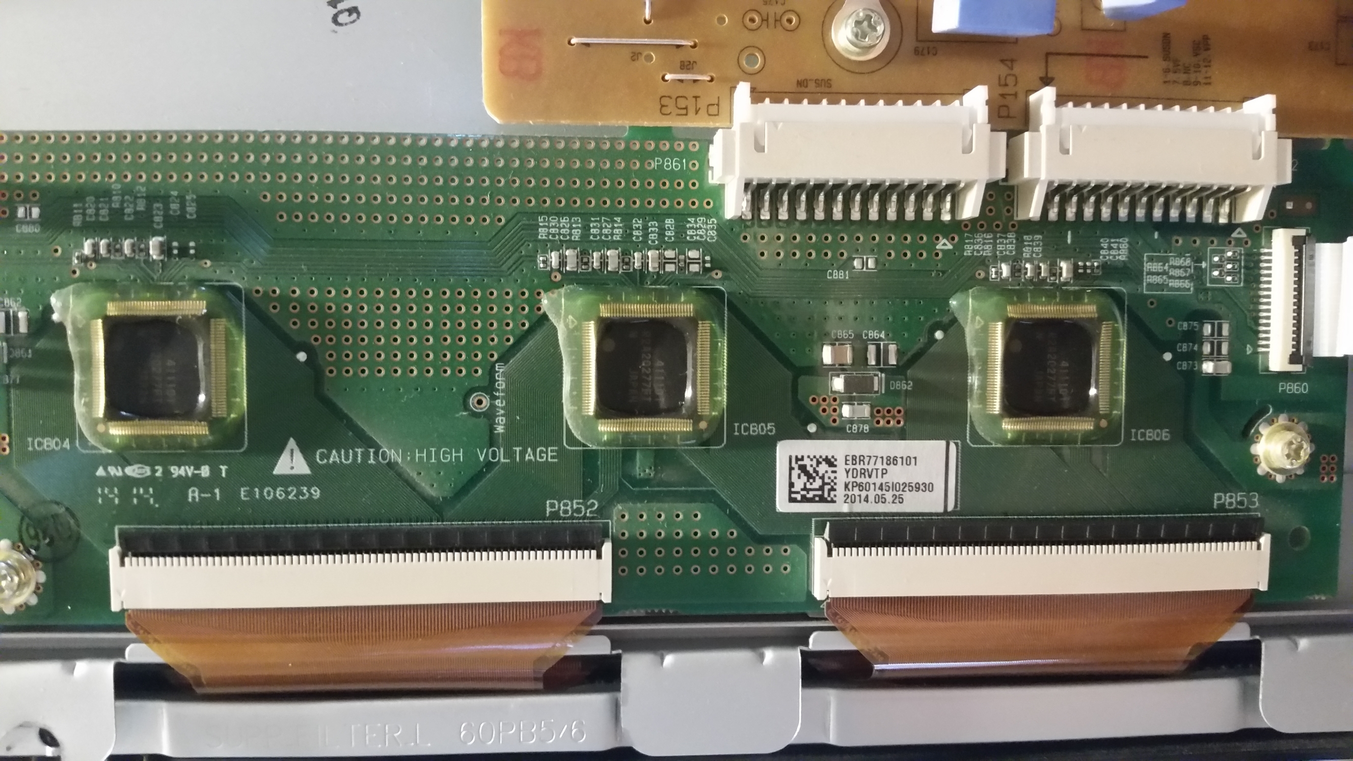

          You've not given -VY
          Pictures would help.

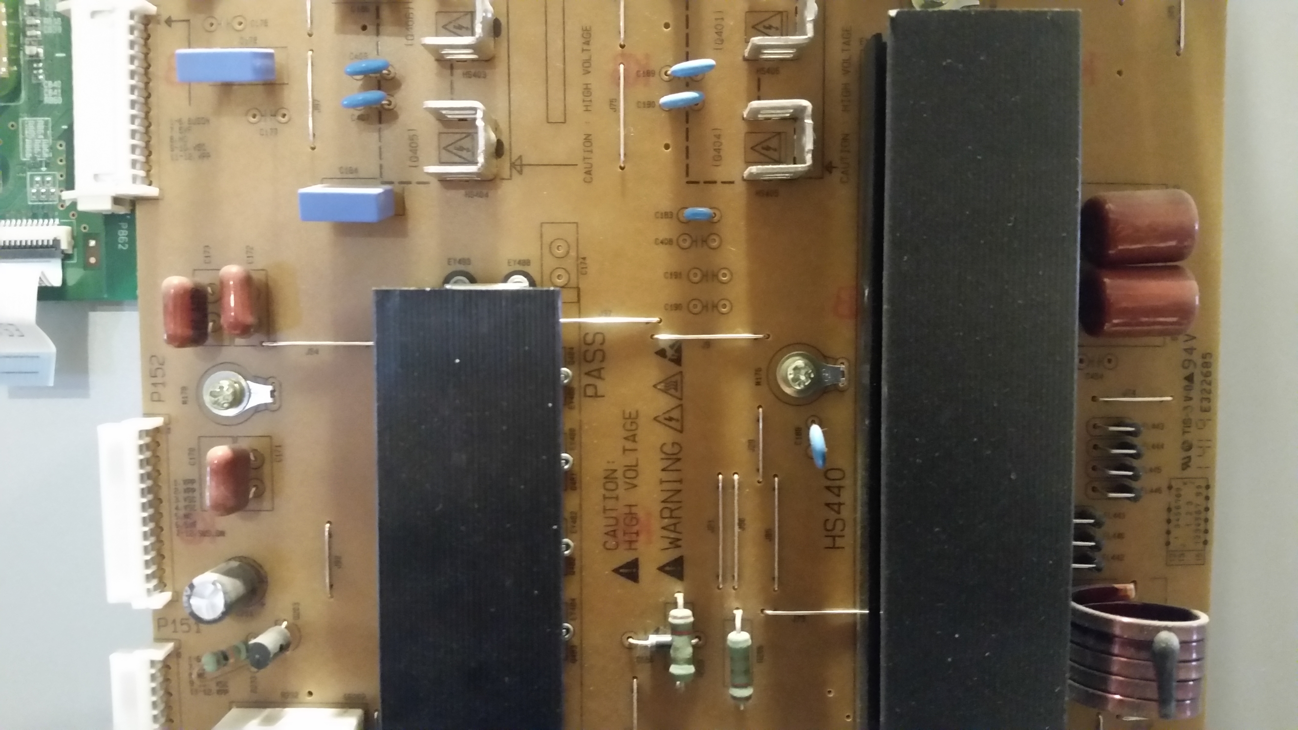

              Re: LG 60PB5600 Sound but no Picture
              Upload a picture of the y-sustain and buffers.

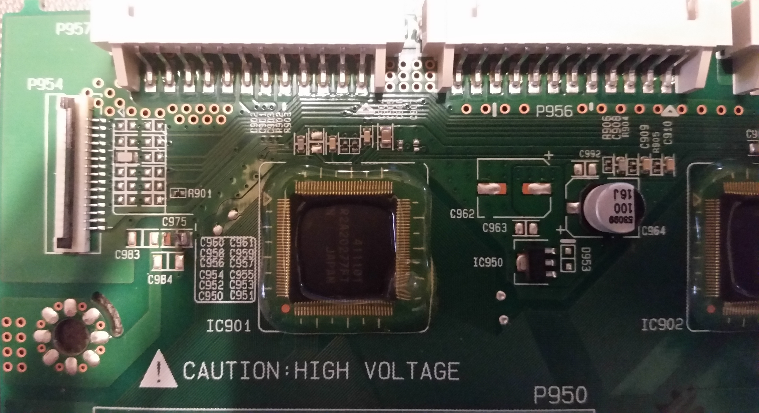

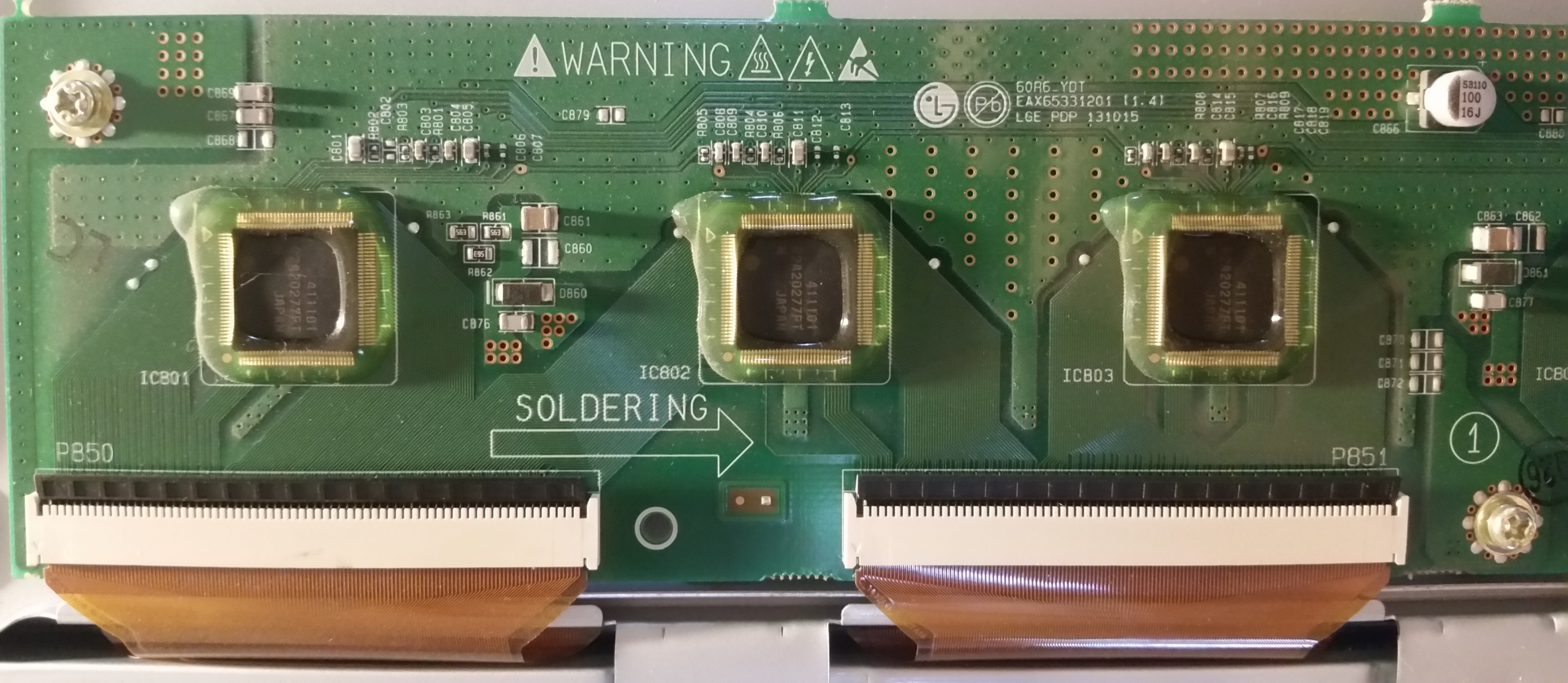

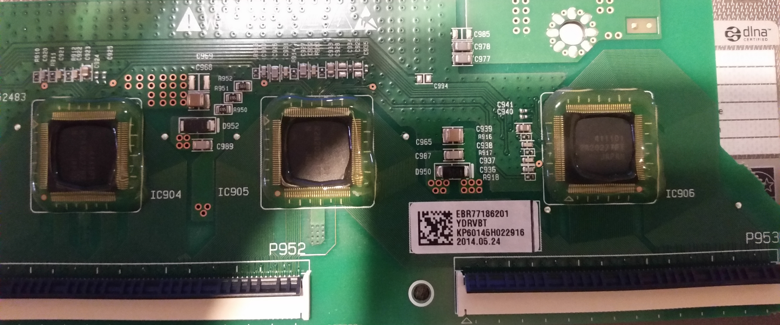

                I see Vy test points, but not sure if i can get a accurate reading now that i pulled the lower buffer board due to an exploded component at C975
                I attached 2 pictures of the Buffer board 1 of the missing component and 1 of the service tag identification.
                • subwagon
                  • Dec 2018
                  • 35

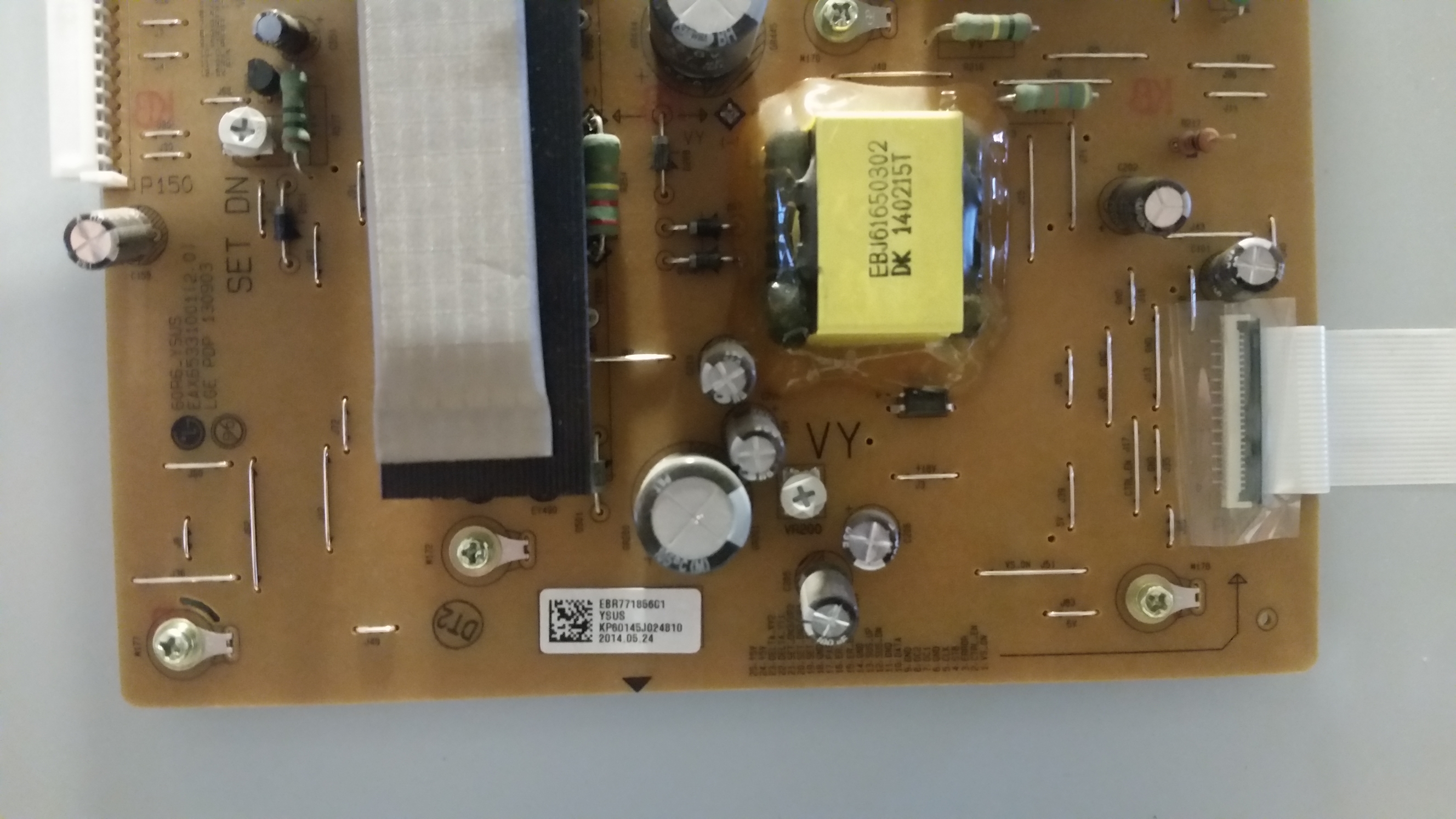

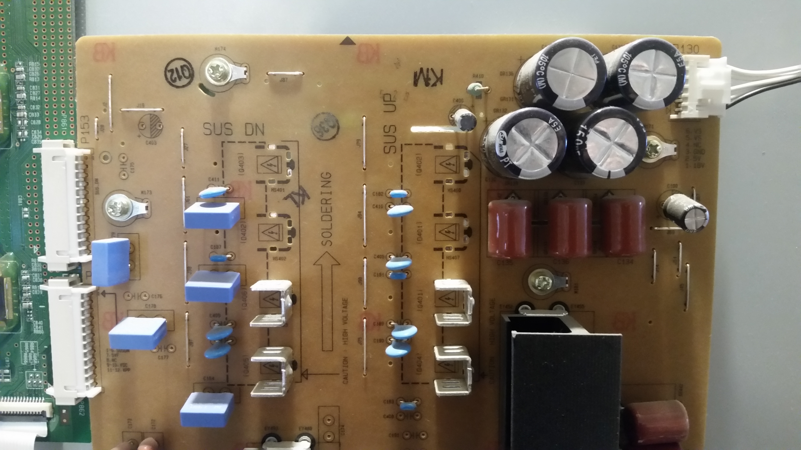

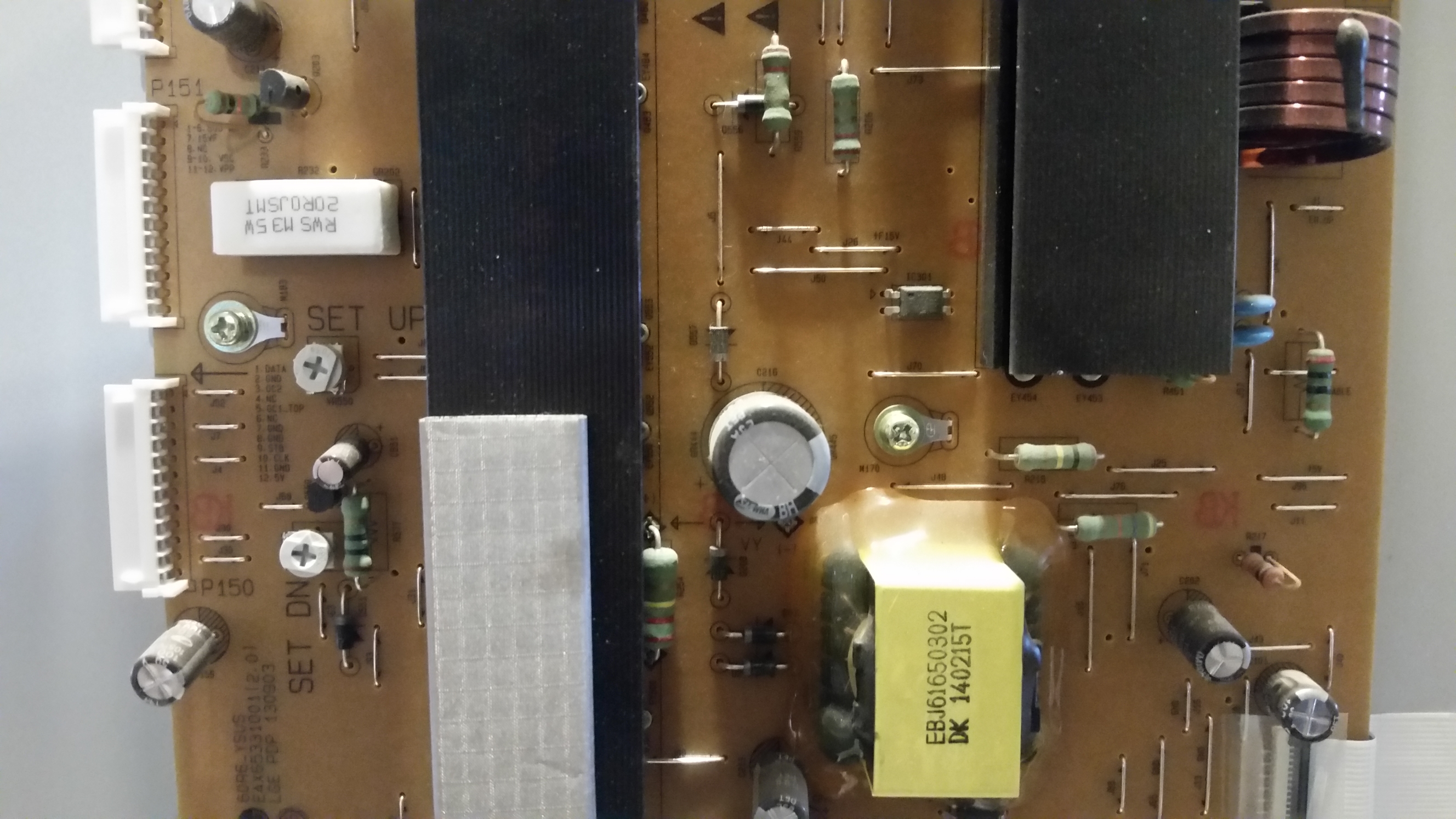

                  Here are Close up photos of the Upper Buffer ((2))
                  And photos of the Y-Sus board ((4))
                  • Hamie
                    • Apr 2014
                    • 1383
                    If you're lucky replacing the cap should bring it back.
                    They are 4nf from memory.

                      OK i put in 2 2000pf in parallel at C975, with no change still get the prime then nothing.
                      With the lower buffer removed the screen is gray on the top with just a hint of color on for about 3 seconds then back to black.

                        On y-Sus Board
                        I also removed R206 and R559 from circuit, they should read 2.2 ohms 5% but I measure 2.4 and 3.6 ohms. Ill have to go grab my notebook to remember how to test some of these other components like Q507,Q552, and Q553.
                            I don't think Va means -VY. Usually Va=55V found on the PSU and Vy=-155V found on the Y-sus Bd. Thase are approximate values and not actual values for your Bd.
