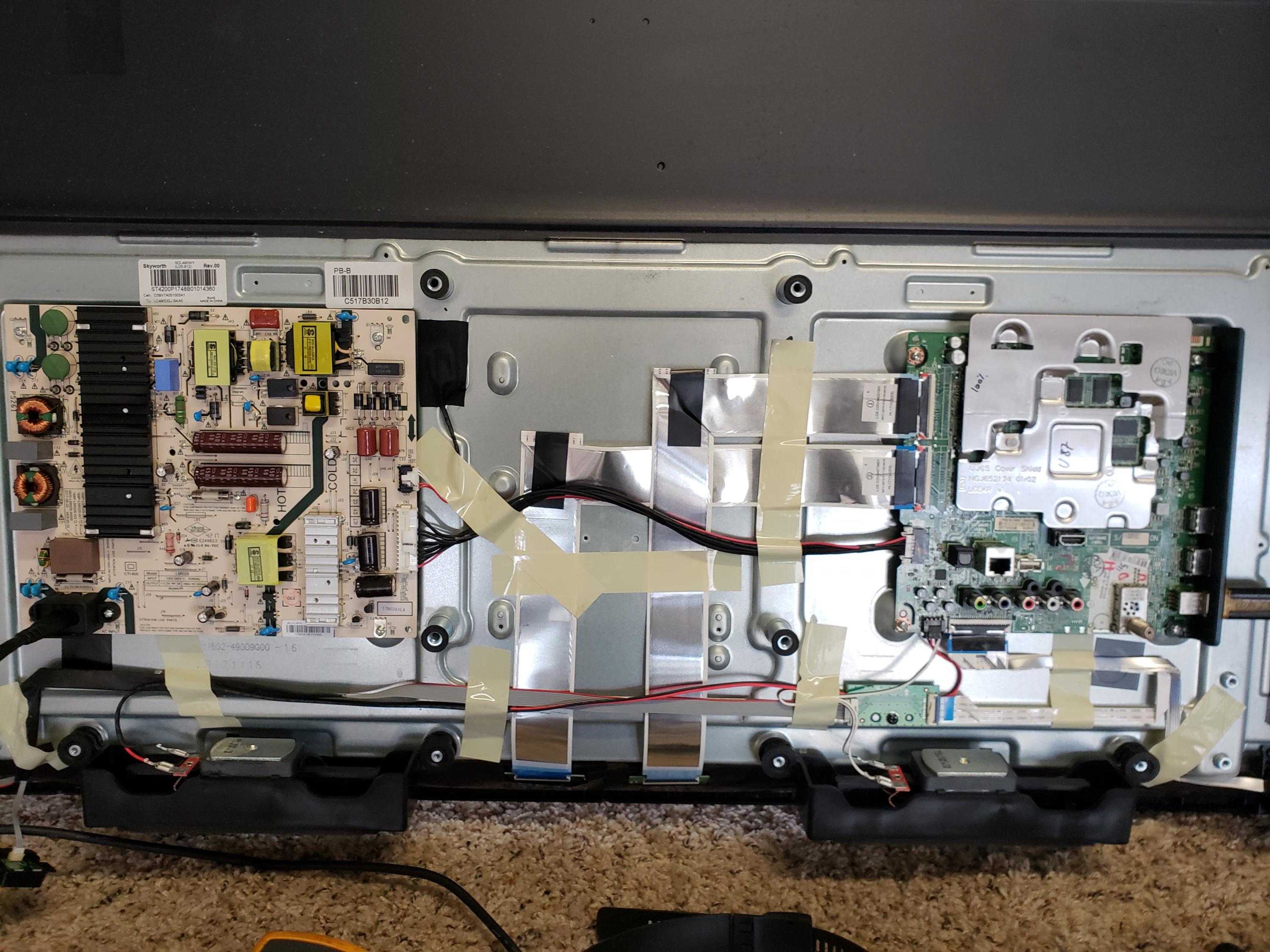

    This set will fire up, complete initial setup screen info, language, country, time zone. when select OK at end of setup goes to blank screen. Upon power up standby LED blinks three times. No response to remote. will not take software update through USB port. I noticed that with set off, all 13.2 volt pins show 12.0 volts. Once fired up shows 13.2 volts on same pins. Electrolytic caps close to the plug all show 12.0 volts in standby. LED Outputs are both 64.75 steady instead of 66 volts. Two main boards exhibit same behavior. A third main board would sometimes go into menu and even display PIP video and sound in menu on input selection screen. When input selected (HDMI) only audio came through, no display on full screen, this board took software update.
    Could low voltage on SMPS be causing this behavior? I am stumped. PSON is 0 volts in standby, 1.84 volts when on. label on panel says Skyworth?
    TIA

          I have no 5 volt standby voltage, but I have 12 volts. Standby LED is illuminated in off mode. PSON is at 1.84 volts when set is on. Backlights come up and main LG splash screen and setup function works. But only to set language, country, time zone. Once all are selected and I select OK, no video generated full screen. I get a flash of video like it starts to process then goes to blank screen. Sure acts like a CPU/EPROM issue to me. Anyone know what the three blinks upon power up means?

            Replaced three main electrolytics (1000uf x 25 V) on smps and resoldered every main power passing device I could find. No difference.

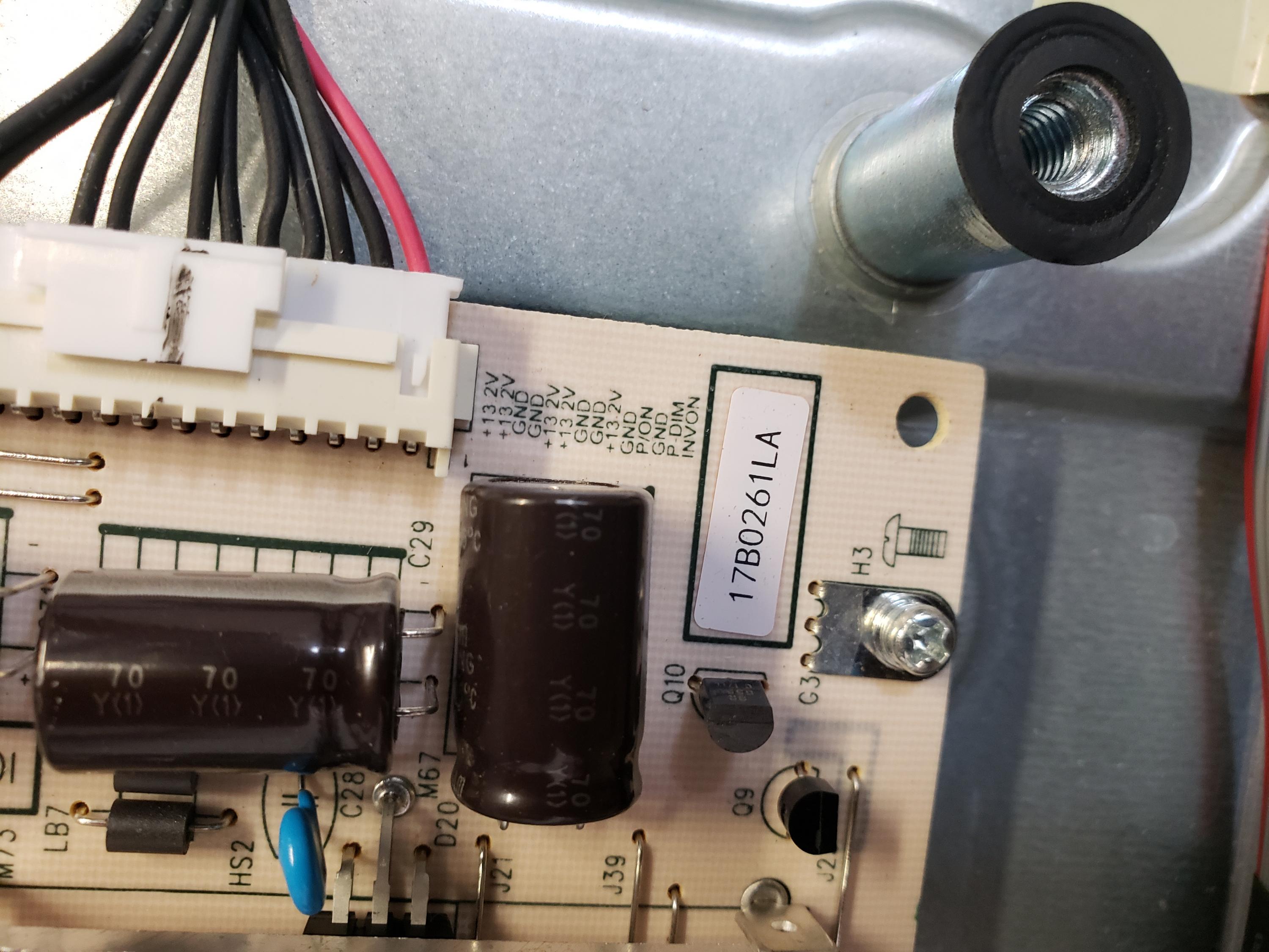

                I can't see your board too well, what is the standby voltage reading on cn2? see the map/legend right beside it, it might show the expected voltages?

                      The fourth picture from the left shows the legend for CN2. INVON is pin 1. I will check voltage in off state on that pin. I know PSON is 1.84 volts when on, 0v when off.

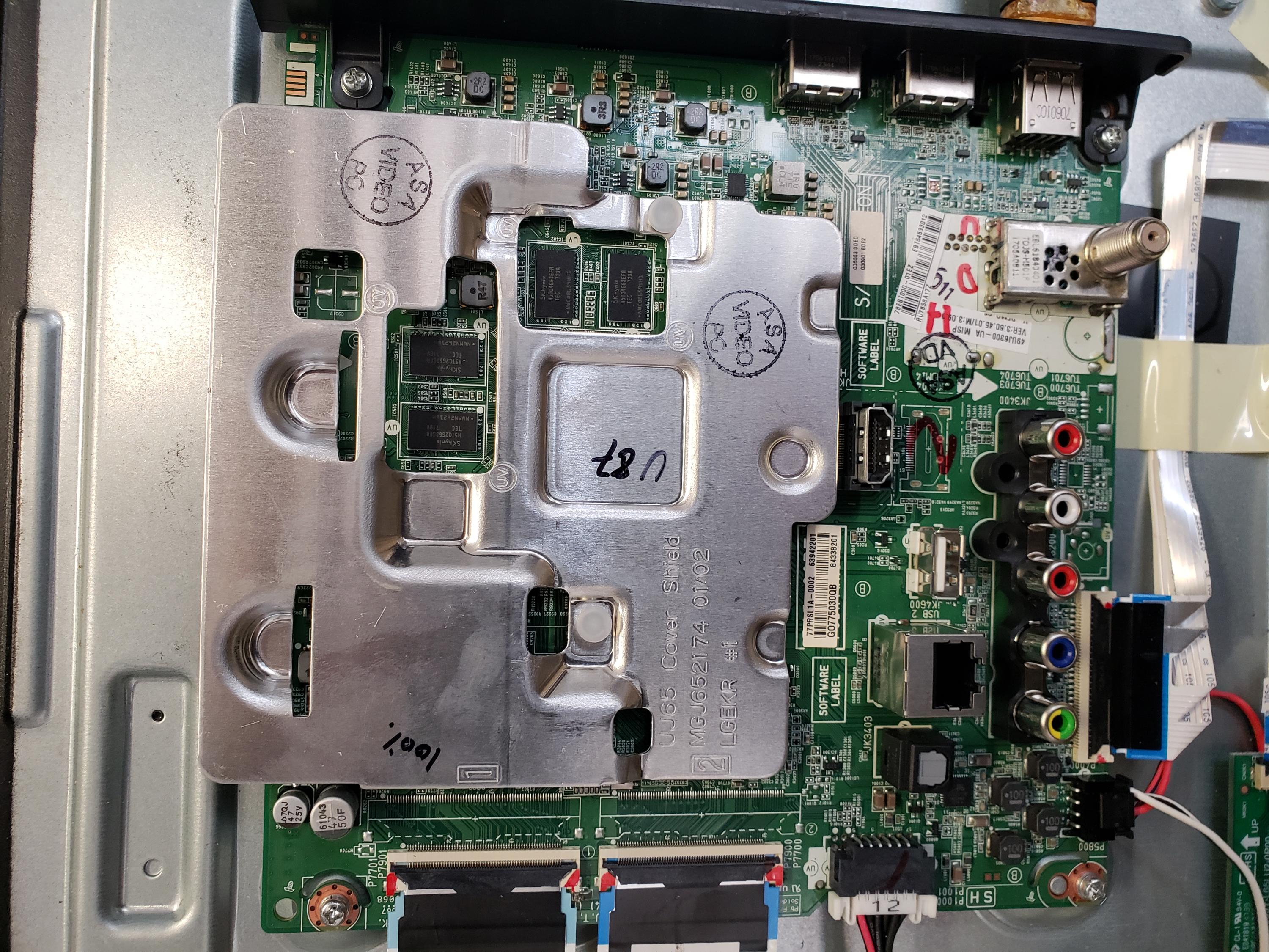

                        Ok, I don't see a standby marked on that legend, yes your ps-on seems low, looking like a problem with mainboard.

                                  --------- Stdby --- On
                                  13.2V -- 12.03 --- 13.25
                                  Gnd -- 0.00 --- 0.00
                                  Gnd -- 0.00--- 0.00
                                  Gnd --- 0.00 --- 0.00
                                  13.2V --- 12.03 --- 13.25
                                  P/ON --- 0.00--- 3.45
                                  Gnd --- 0.00--- 0.00
                                  PDIM --- 0.00--- 3.23
                                  INVON ---- 0.00--- 1.84
                                  PFC Main Caps On are 381V. Stdby they bleed down to 0V but it takes 10 minutes. Crappy Table but readable!

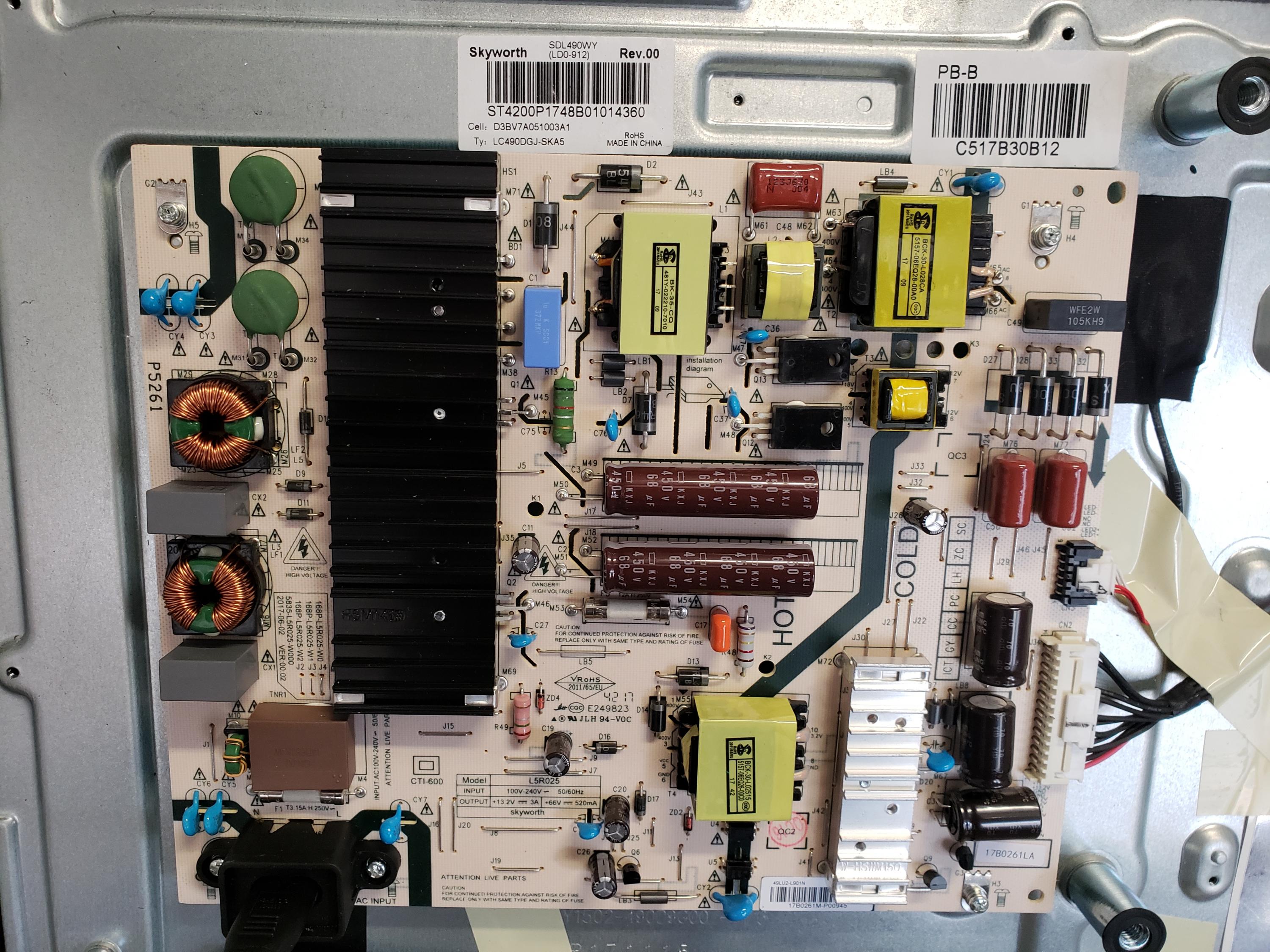

                                      Please up load good clear straight shot of the whole bottom side of the power supply board.

                                        They only bleed down to 0 volts with AC disconnected. I will measure what they bleed down to with AC on but I seem to remember it was 165 volts last time I checked it. I will remove smps and get you good clear pics of both sides of the board. Yes, Nomoresonys, backlight comes on with no issues at 64.75 volts for both LED1 and LED2.
