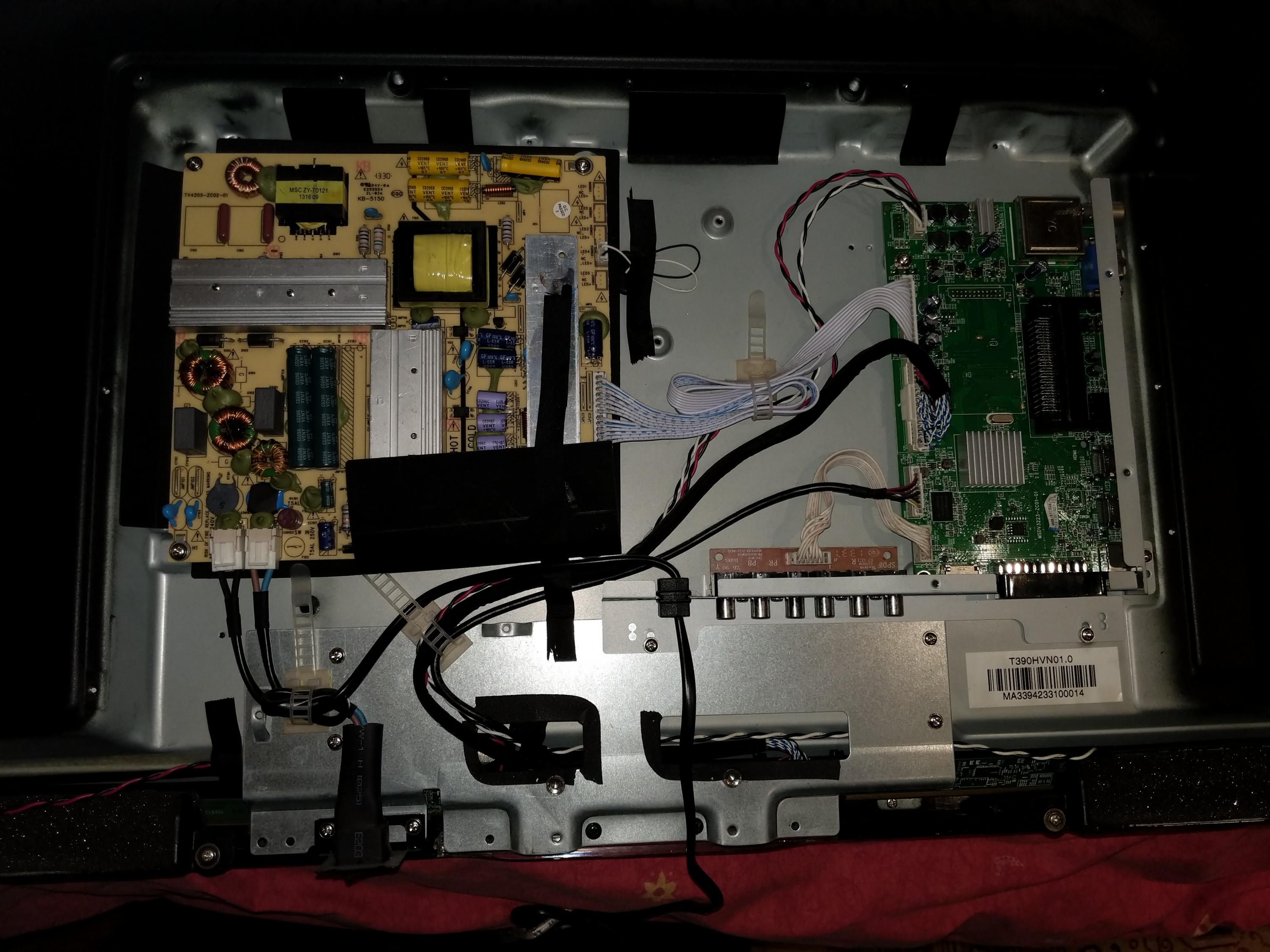

    Inside back cover chassis label T390HVN01.0 /MA3394233100014

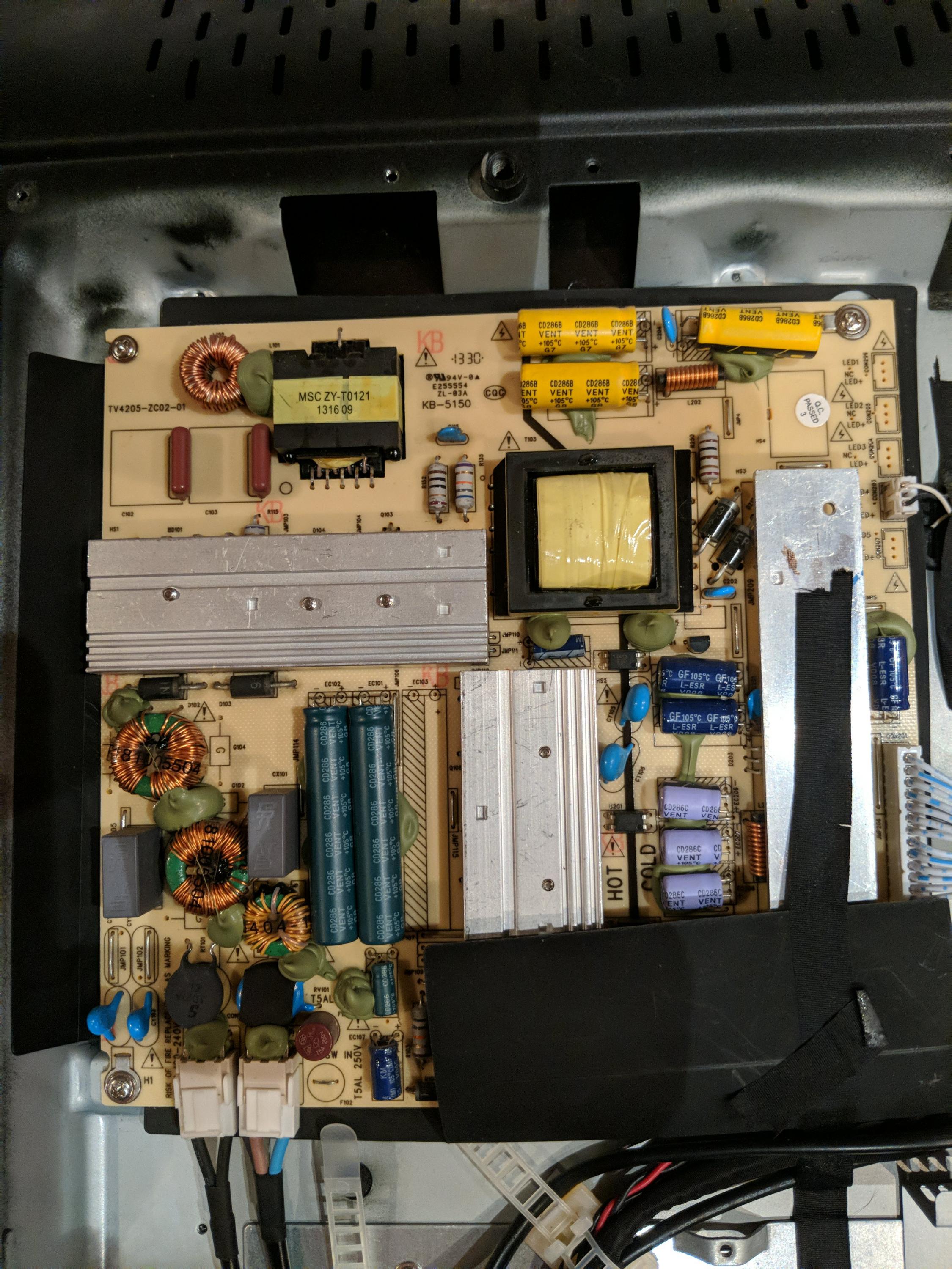

    Power supply board TV4205-ZC02-01 / KB-5150 / M16/G42332/02
    Main/Av board MSDV3223-ZC01-01

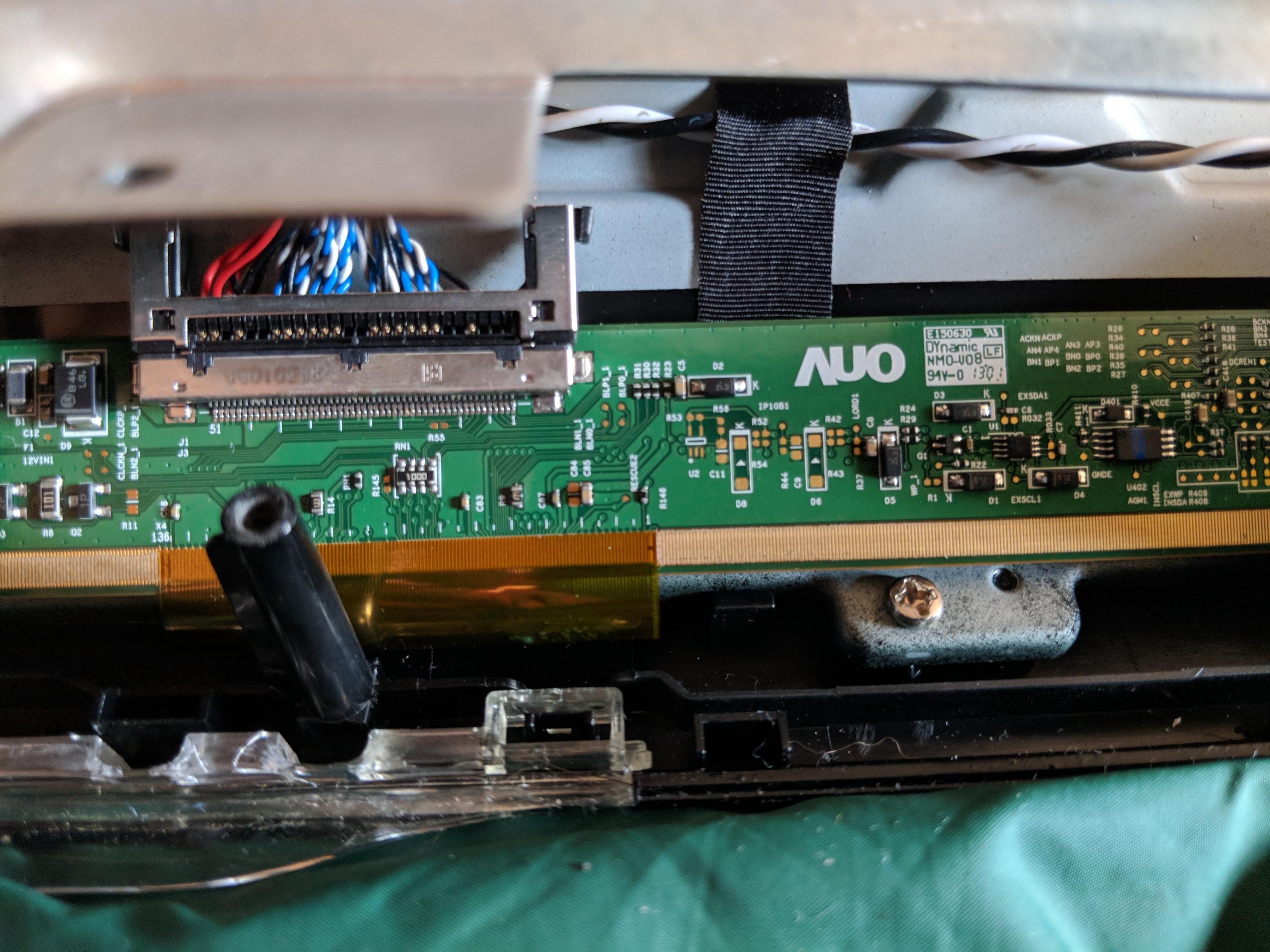

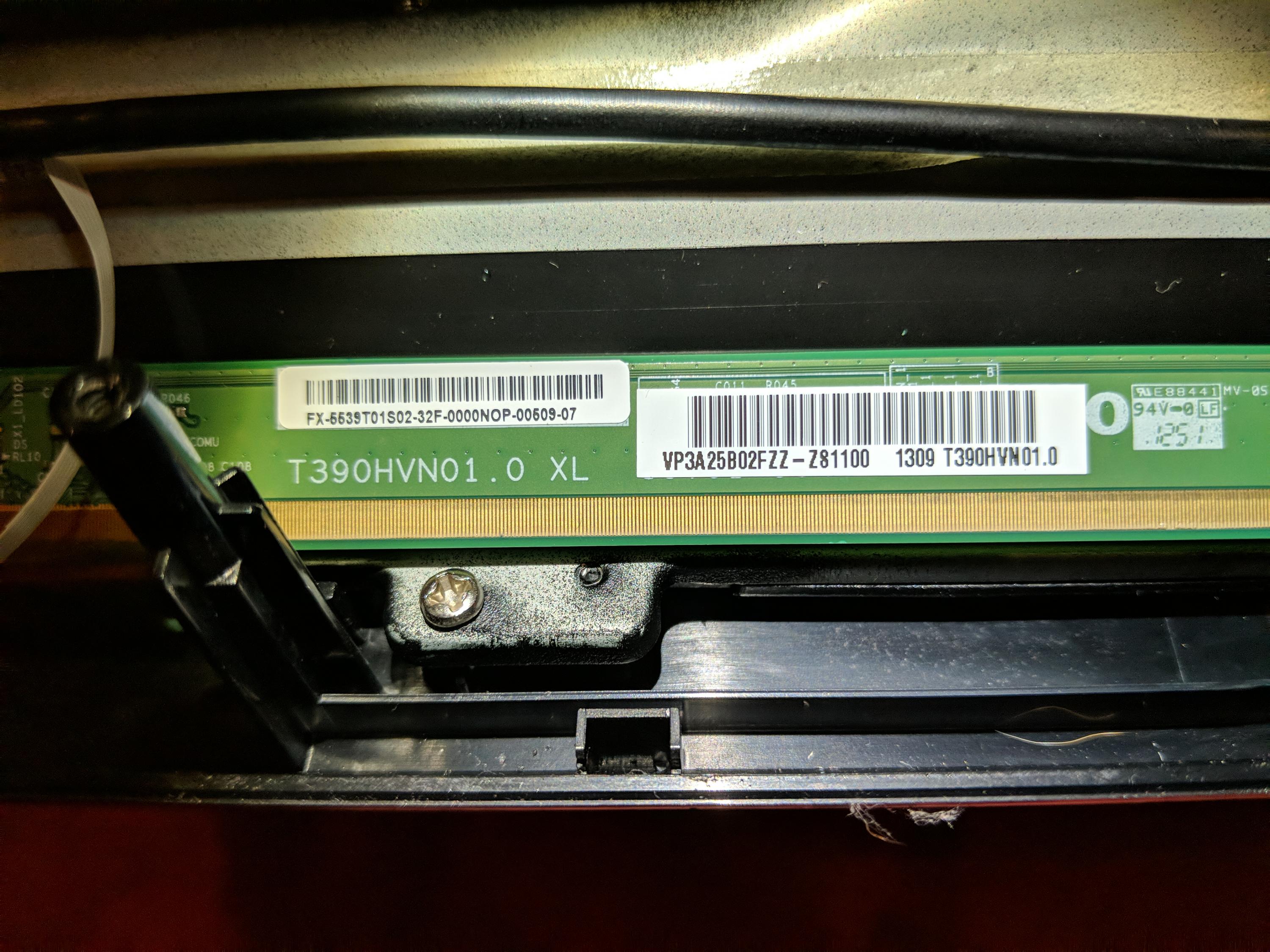

    Bottom buffer boards VP3A25B02FZZ-281100 1309 T390HVN01.0 / T390HVN01.0 XL / FX-5539T01S02-32F-0000N0P-00509-07

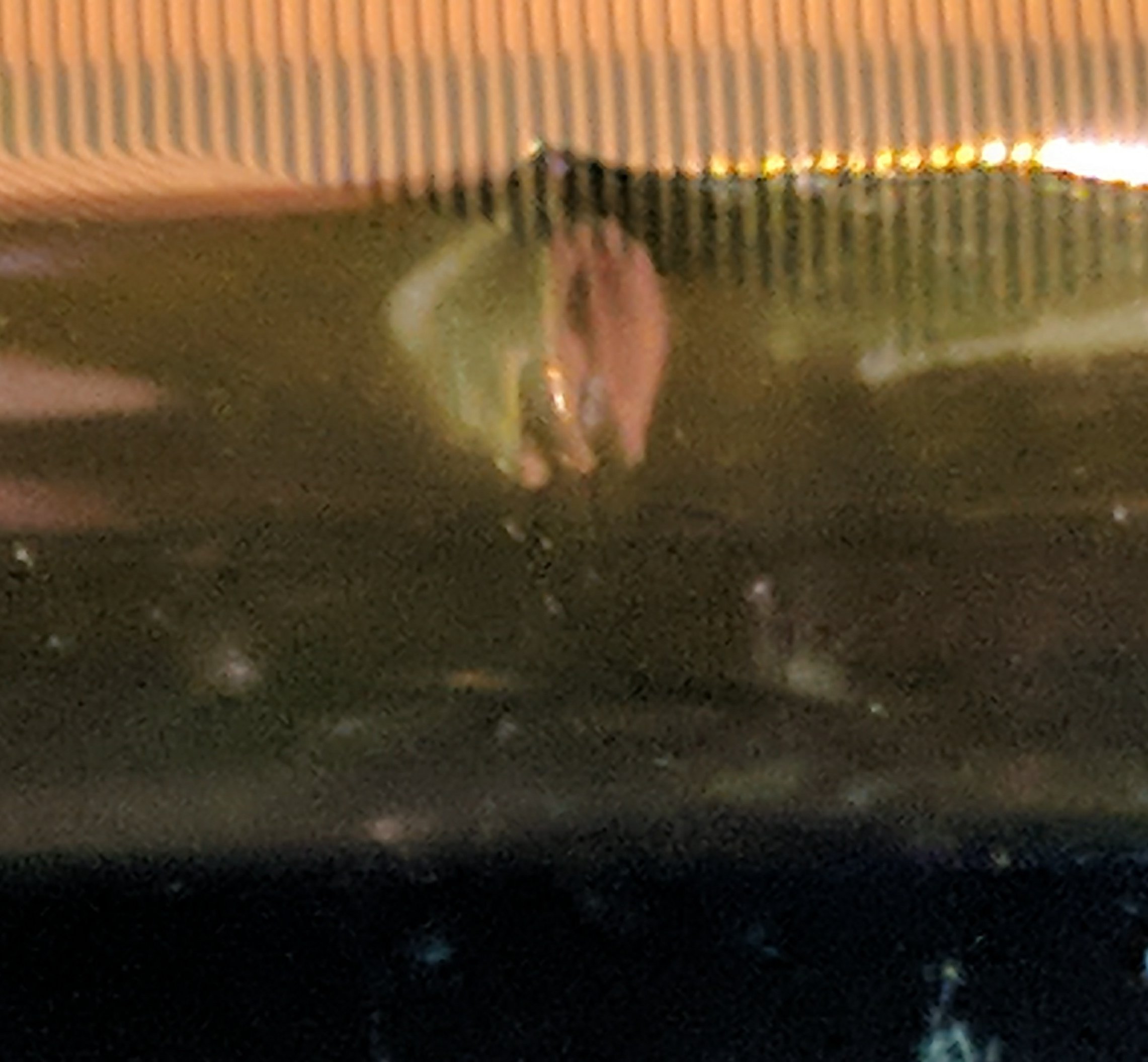

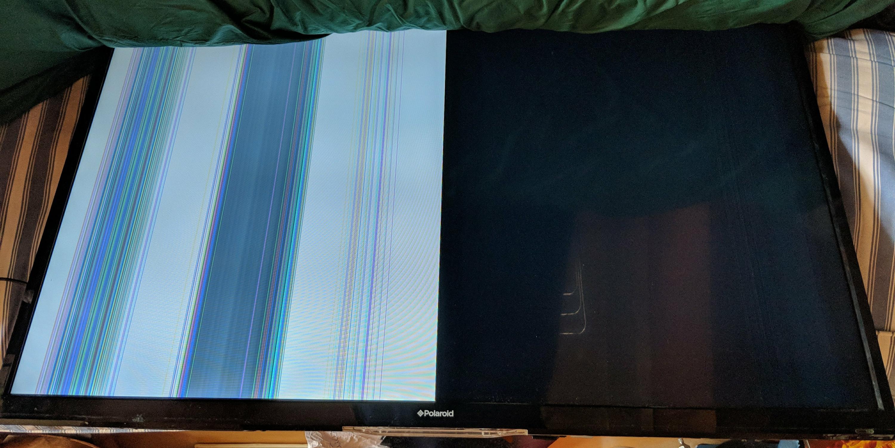

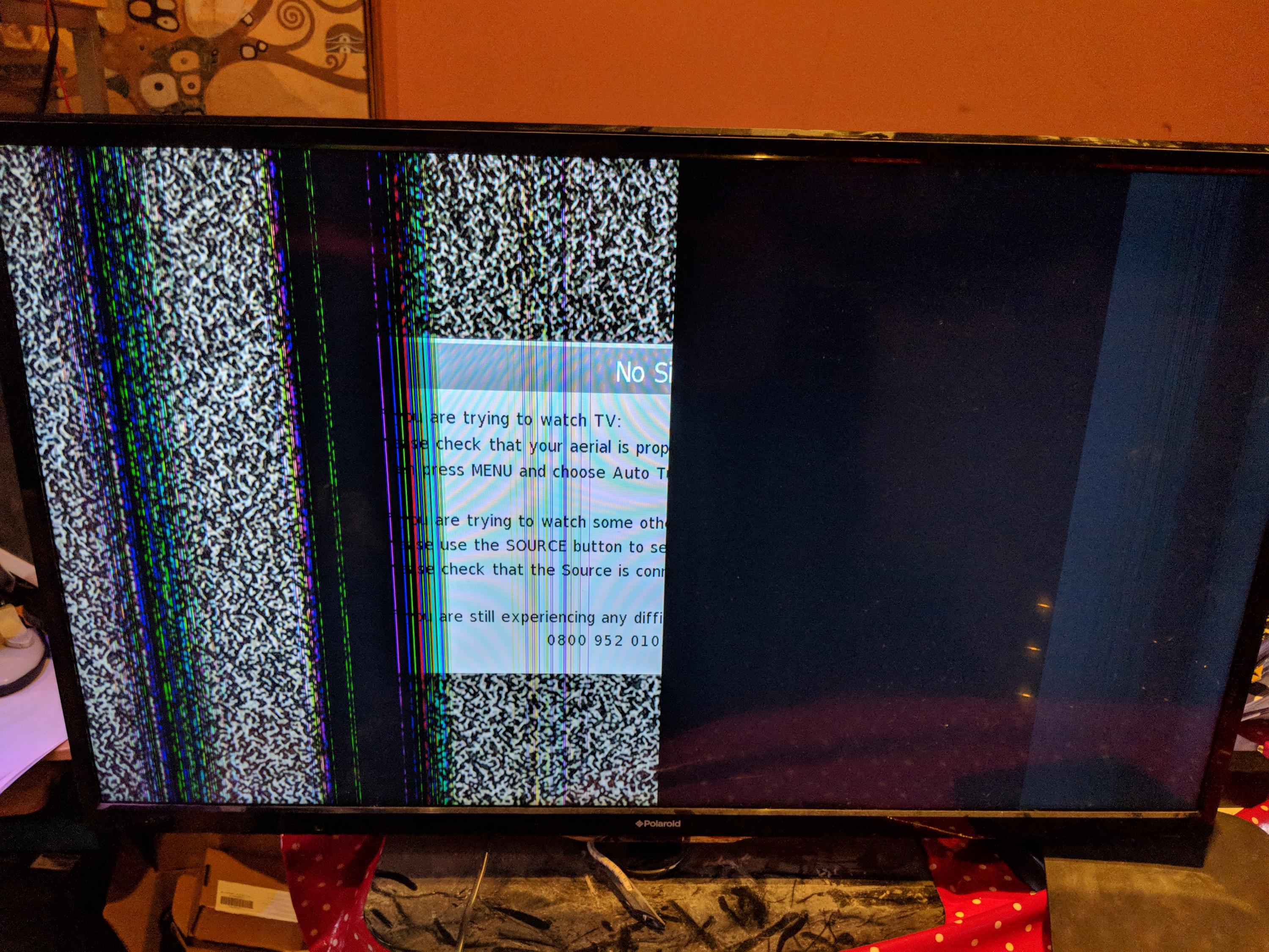

    Problem as can be seen in first photo is that the right side of the screen, when looking at it appears black/ no picture but backlight is showing but no image.
    Left hand side of screen shows menu image with vertical lines present.This is all whilst no signal connected to the tv.
    All I have done so far is disconnect ldvs cable from main /av board to lower buffer board. This gave me 2 seconds to black across the screen.
    I then disconnected the left hand side connector to the bottom buffer(brown flexible cable ? Lvds?)
    This gave a whiter screen, with less noise in it but still with some vertical lines present.(see photo)

    Does it appear that this screen is ok/or possible tab problems?(guessing this from vertical lines?)
    Is there a t-con board hiding somewhere or is it built into bottom buffer boards? I guess this from following the cable from main /av board? am I correct?
    Looking at the many pathways on the av/main board, pcb under the heatsink to the lvds cable to the bottom buffers , I guess I need to test that
    (a) the signal & power is being generated on this board &
    (b) it is then going from the bottom right buffer (where there is a splitter cable) to the bottom left hand side buffer board.
    I see many test points on the bottom buffers boards, VGA8/VGA9/SDA_GM/FLP1/Ycomu etc. but I am lost as what voltages and what I am looking for and which to test etc, can anyone help me gain more knowledge. I do have a cheap mm and smart smd tester, plus peak atlas esr tester & scr tester and also a hot air station, but still very much a beginner in all of this apart from fixing a few blown caps etc.

    The panel is bad.

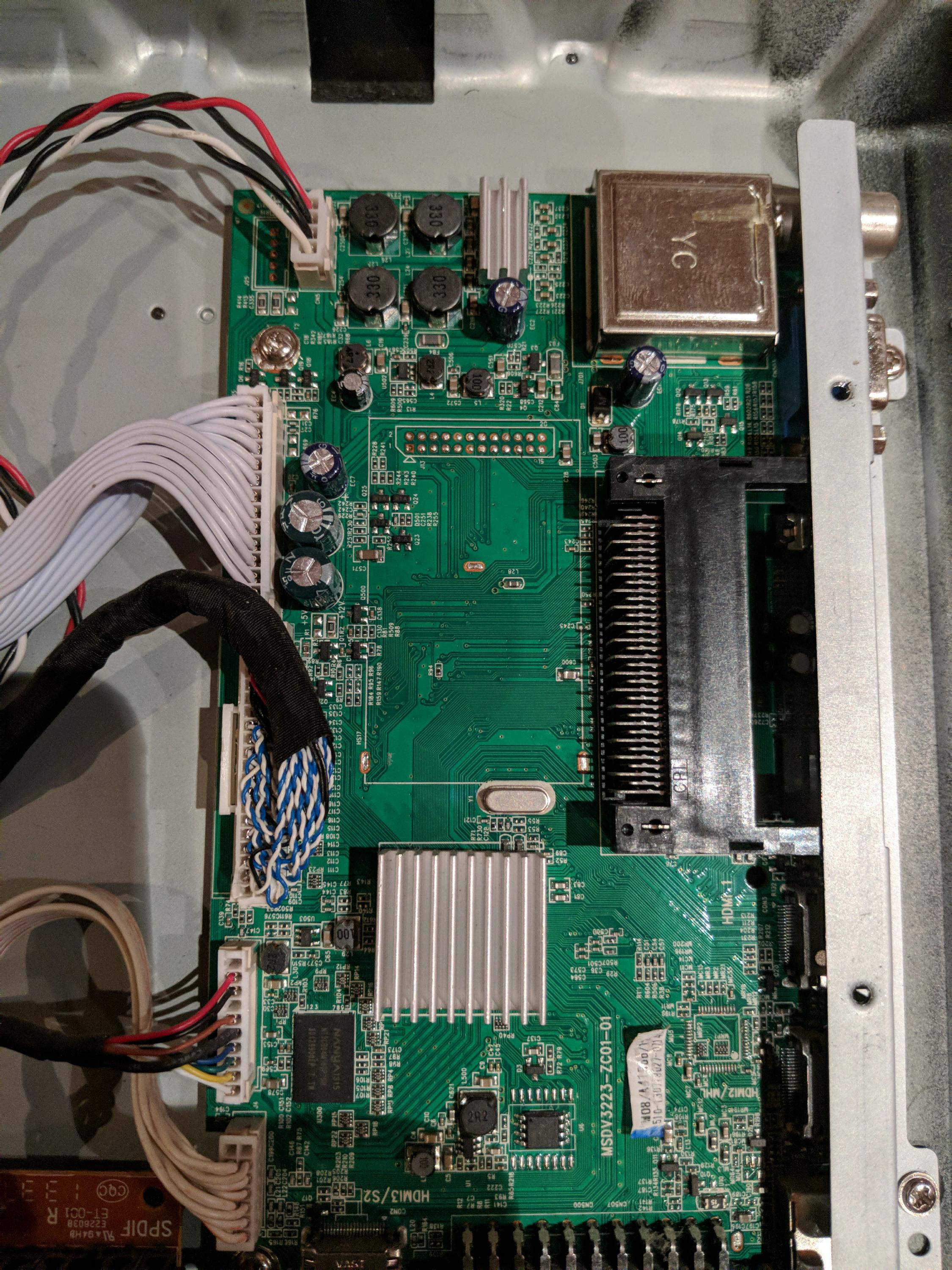

                  Many thanks, well I am stuck on where the t-con & power signal is generated from? If you look at my av board photo, you will see a big heatsink & I guess chip underneath, leading to the left,the ldvs cable to the bottom buffer boards. I am thinking I need to start testing here, I think it shows C111 to C 136 on the connector/pcb traces. Anyone like to guide me here?
                  Have seen Budm's guide on t-con boards so know I shoulds be having some different voltage reading etc. Will have to remove av/board to see if legend underneath?
                  Its the first tv I have opened that doesn't have a visible t-con board and no schematic. I think they are just a cheaper re-badged tv. Can anyone identify from the chassis id or say if the JVC/panasonic schematics are similar?

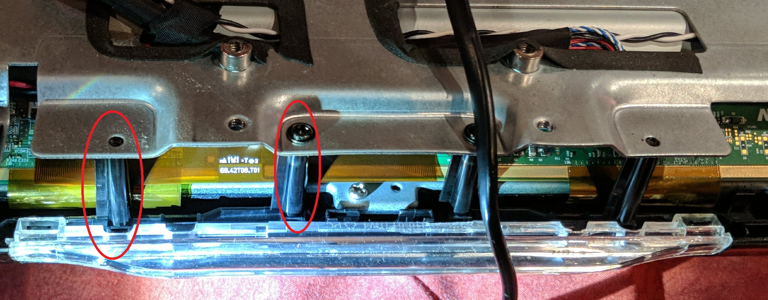

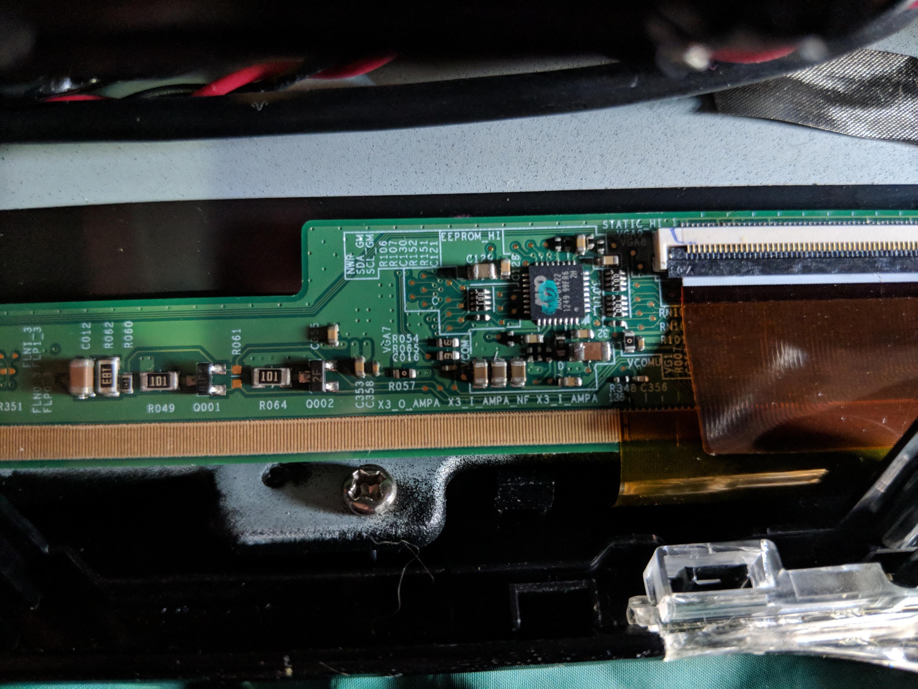

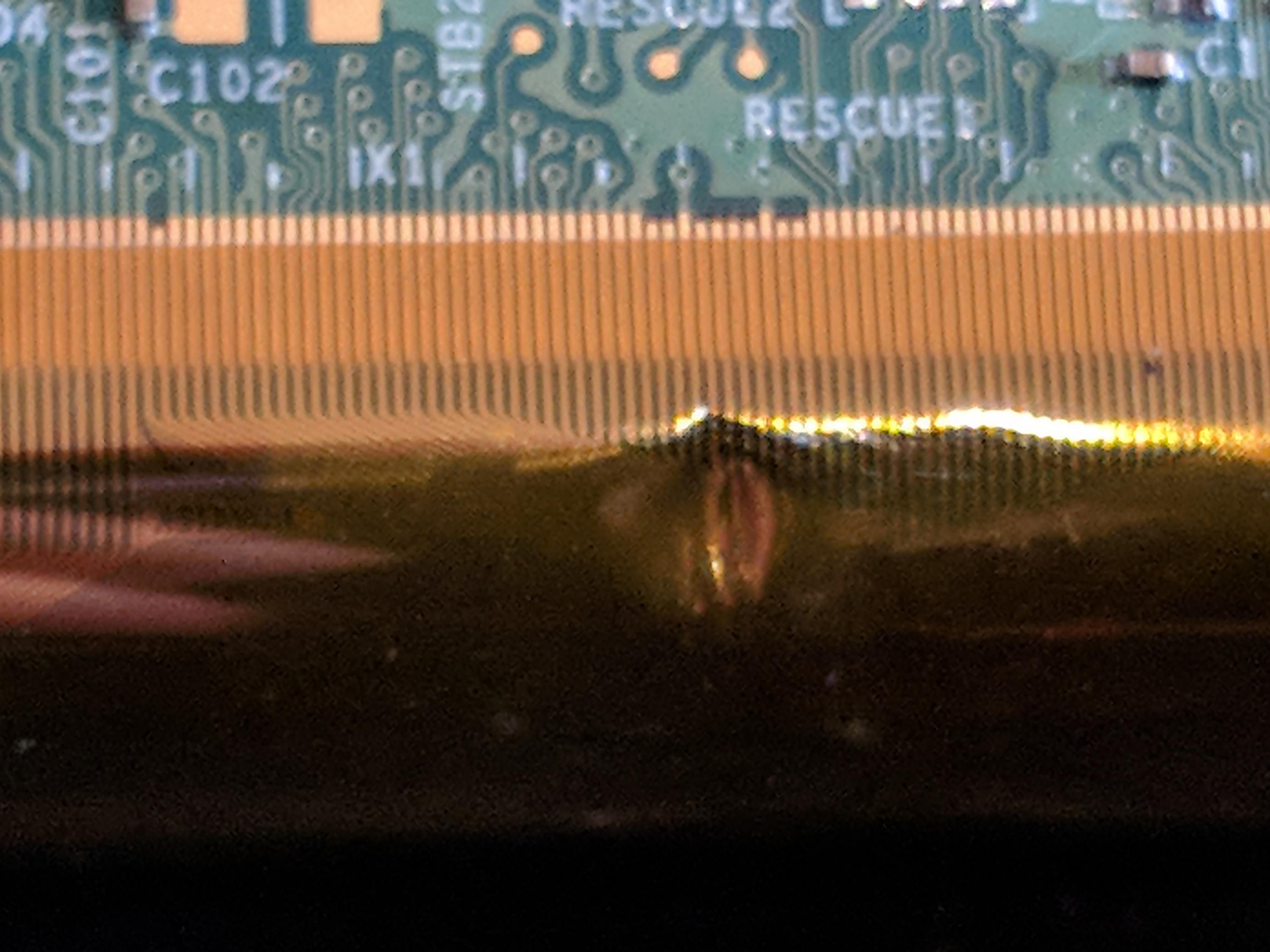

                    Just a quick update to all the techs that new what was going on here. Yesterday I had an hour to spare so I thought I would go and test voltages from main to bottom buffers, having found some AUo pdfs for the lvds outputs etc. I thought I would also take a closer look at the cof/ tabs as thats where I was directed to by most people. So on taking a closer look , I could see what appeared to be damage to the cof/tabs. Zooming in on my phone and then later with a hand scope I could see damaged & broken tracks?
                    If you look at my photo's, I believe this was caused by the broken screw mounts to the back panel, when I first took this tv apart I noticed it had been opened before and a few of the screw mounts were missing ? so I guess someone tried to tighten them and snapped the plastic inside the tv, which rotated on the screw and crushed the novatek cof/tabs?
                    But thats not all,so I obviously disturbed the cof's/tabs and so on switching the tv on to check the 4 12 volt signals on the ldvs from main to bottom buffers. I smelt burning and quickly shutdown, but not before I had blown fuse F1 on the bottom buffer & I think a few other smd's lol
