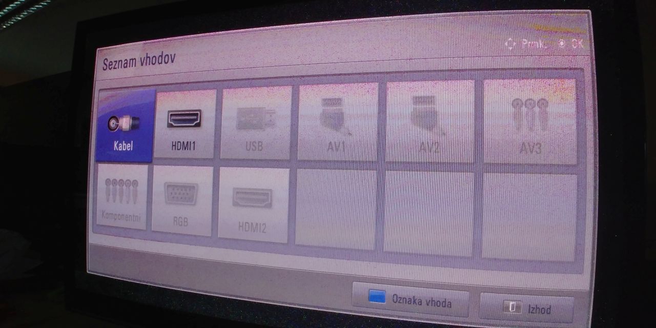

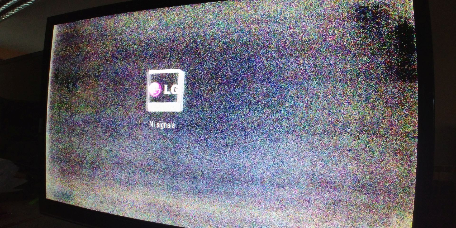

    Please for some help.
    My plasma suddenly have grainy picture. Which board should I look first?

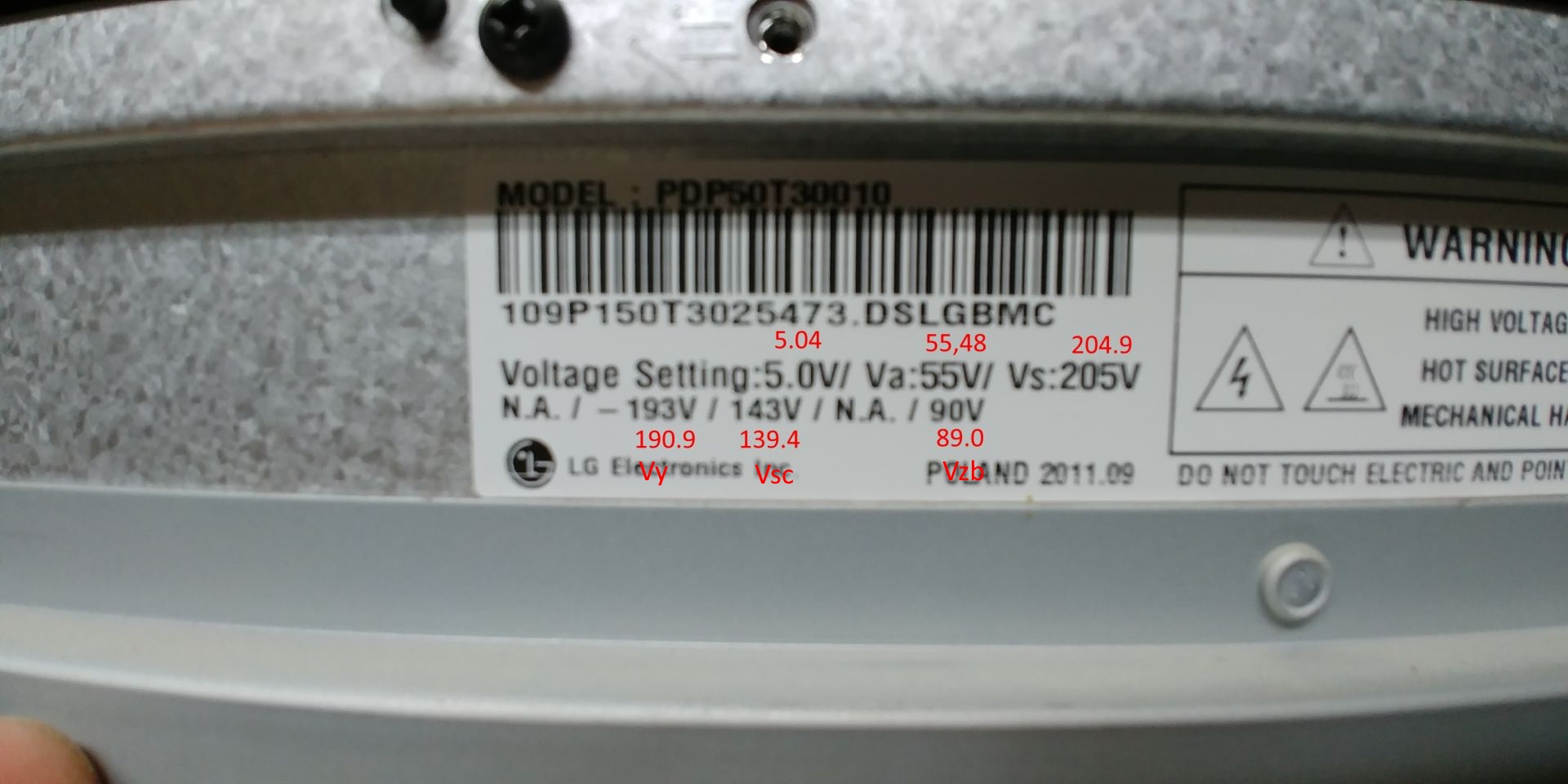

    Are all your voltages Vs, Va, Vy, Vsc, Z-bias on the label correct? This looks like a bad Z-sus Bd.

      Andrew F. Ali, yes the voltages are correct. I changed with another working PSU, and measured with Fluke, all OK. I will buy ZSUS and we will see.

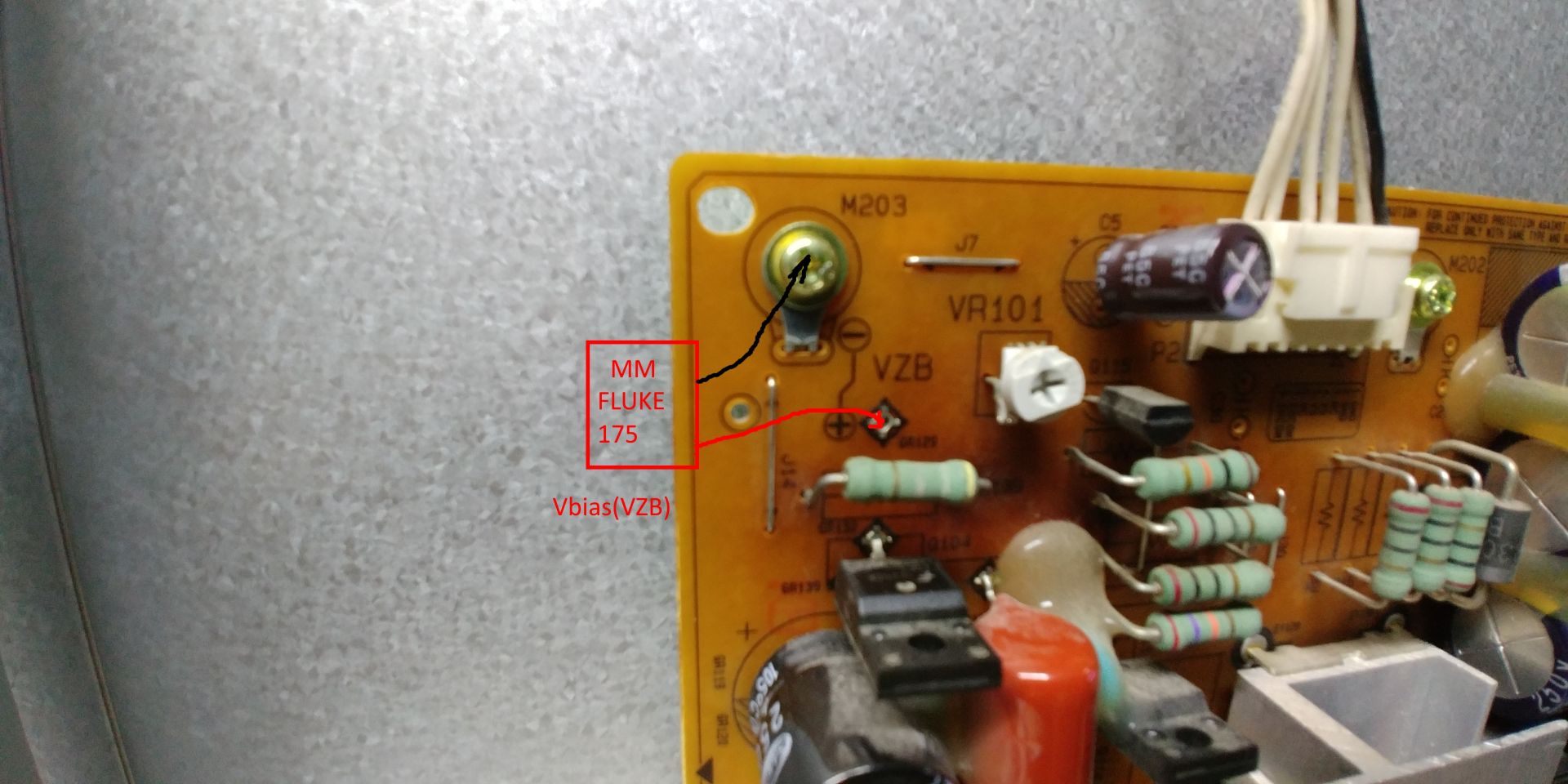

        Before you buy Z-sustain how did you check Vzbias voltage??

          Tom66, please look at the attachments. Is this correct VBias measurements?
          What are you suggesting me? Thanx for your help.

            Yes that is the Vzb 9Z-bias) test point.

              Should I adjust a little Vy,Vsc and Vzb?
                Re: Plasma LG 50PT353 picture grainy
                Were they within about 3 volts of the values on the sticker? If so, there is no need to adjust.
