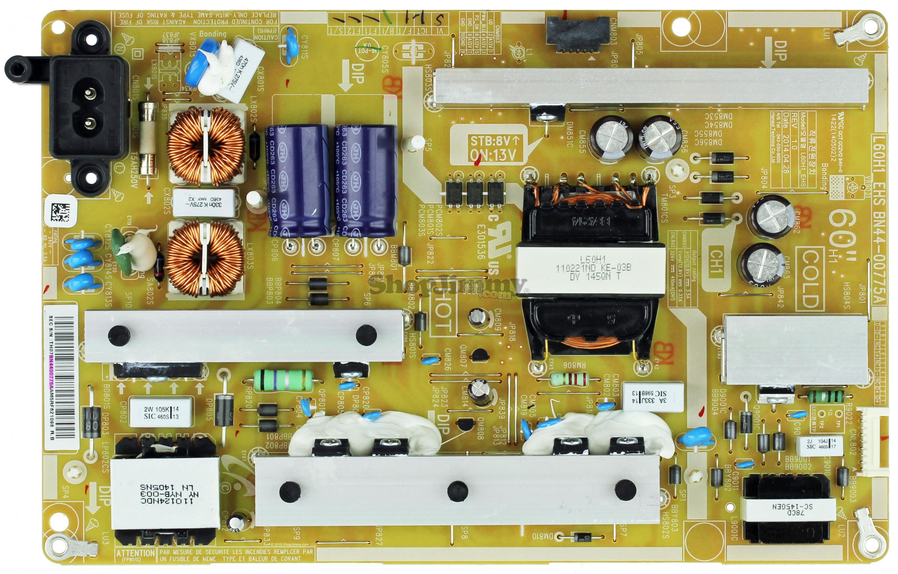

    Was watching tv 3 weeks ago and screen went black, but sound continued to work. Called Square trade and they walked me through some test steps. They concluded that it was the power board(BN44-00775A) and came out and replaced it. Tv worked fine for19 days until one night I turned it toward the dinner table. It went black again, but still had sound.
    Called SquareTrade again, and they said it could not be repaired. They are replacing it with what they say is a comparable tv, but I hate to just throw this one away
    Search the internet and came across this site. Read a thread by vergezee and it sounded like we had the same problem. Thought I would post the readings you ask him for and see if you could help me.

          Are you sure you did not label those pins wrongs? D+ is the Anode of the LED string that is fed by the LED driver Voltage so no way you can have D - pin which is the Cathode return of the LED string to have higher Voltage reading than the D+.
          So far it points to open circuit in the LED string, I.E. wires, connectors, LED, etc.

                OK, lift up one leg of the Diode D9001C and then check the resistance in both direction of that diode.
                Picture provided by shopjimmy.

                    Is the Diode Diode is SF28G?
                    If the diode has leakage resistance then that will explain why you have 426V on the Anode and 318 On the Cathode of the LED string, it also means the Vdrops on the LED string is only 426V-318V = 108V!

                        "I have a cheap multimeter so I set it to ohms and I got .6 one way and .7 the other."
                        If that is what you are getting with one leg of the diode is lifted off the board then that diode is bad.
