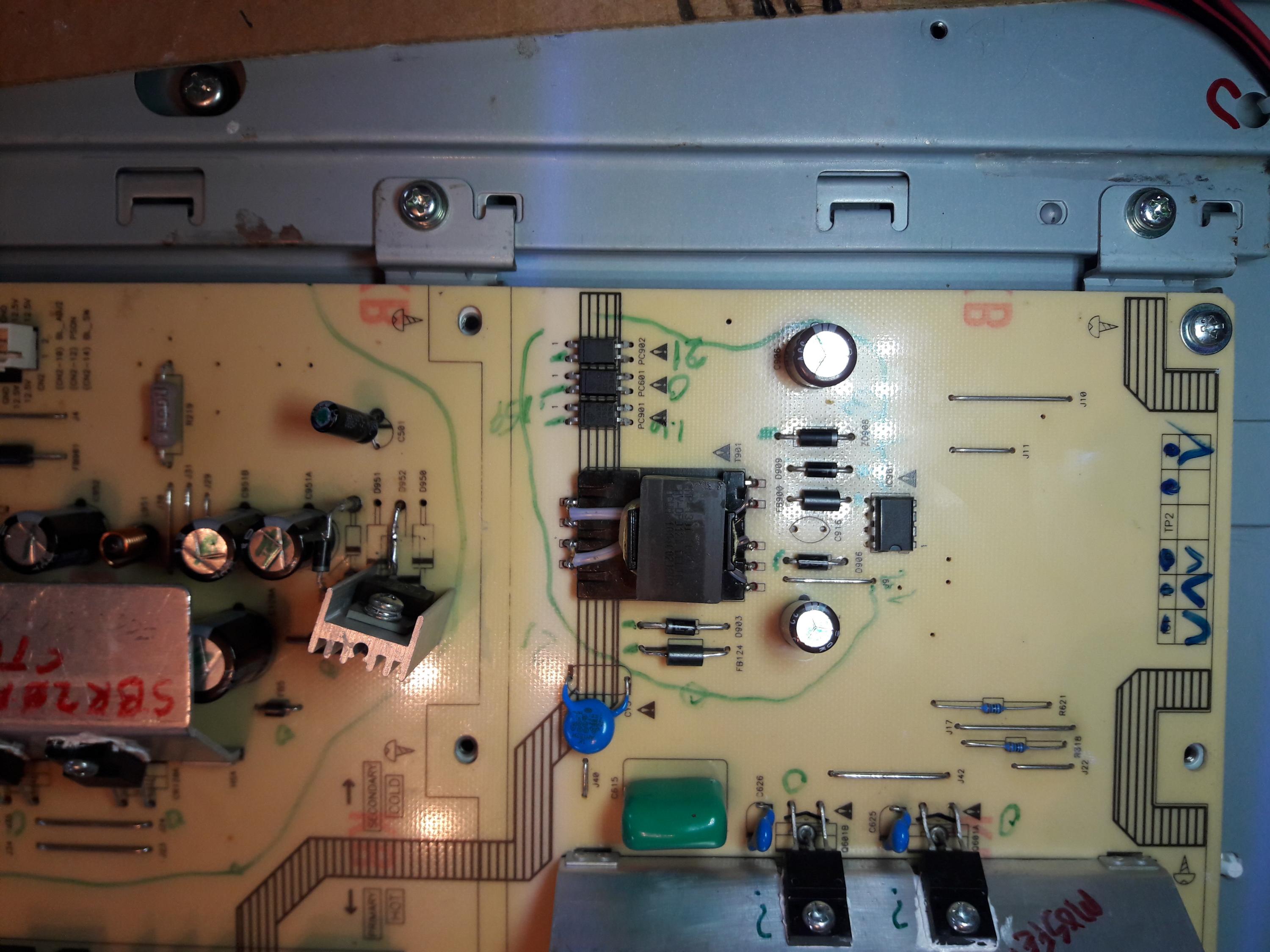

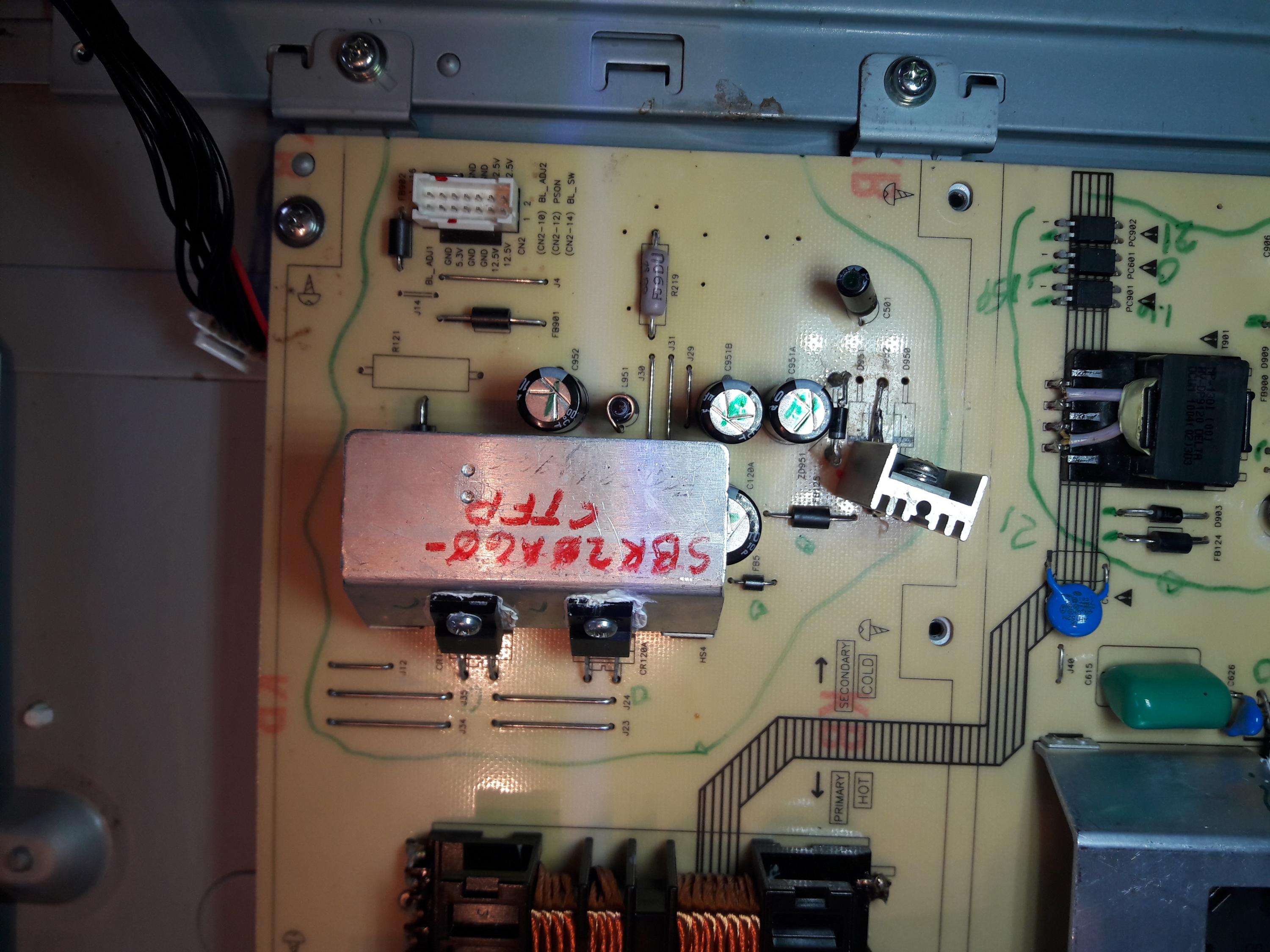

        check diode in the pic
        • What?
          • Aug 2010
          • 82
          Re: Philips 46PFL5505D/F7 blinking power light no pic no sound
          Yup, I performed that fix on my TV. I used a T220 diode and a heatsink.

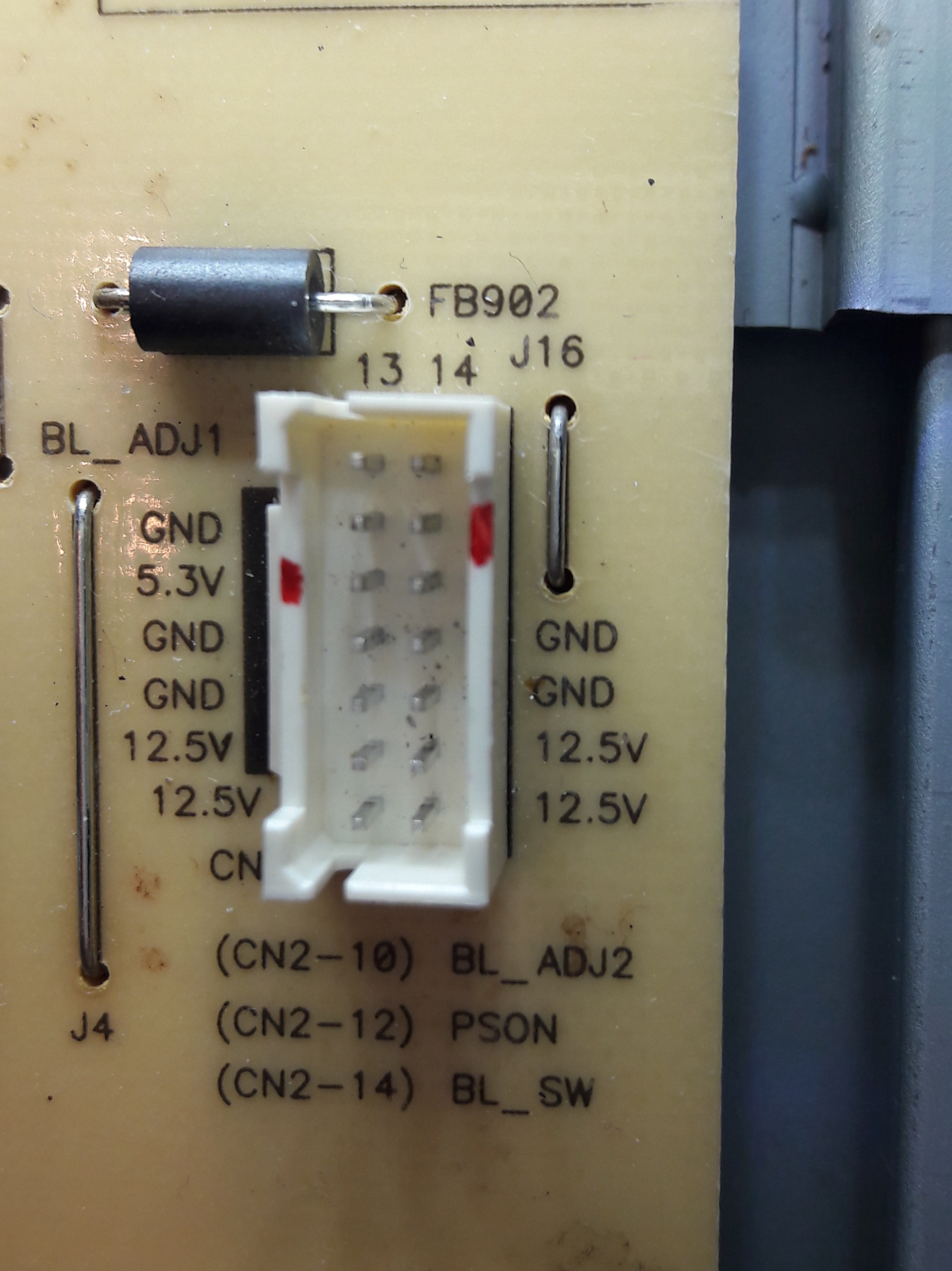

            does the backlight come on at all?
            • What?
              • Aug 2010
              • 82
              No backlight at all.
              • CapLeaker
                Leaking Member
                • Dec 2014
                • 8325
                Are PSon and BLon present?
                • What?
                  • Aug 2010
                  • 82
                  Capleaker,
                  PSON = 3.117
                  BL-SW=0.007
                  I don't have a BL-ON I think BL_SW is the same thing. The only other BL is BL-Adj.
                  • CapLeaker
                    Leaking Member
                    • Dec 2014
                    • 8325
                    your main board isn't sending BLon to the PSU to turn on the back lights.
                    • What?
                      • Aug 2010
                      • 82
                      Thanks CapLeaker, I was leaning that direction. Now the problem is fixing the Main Board. I have not been able to find a replacement anywhere so I have to fix this board or maybe I should send it out to have it fixed.

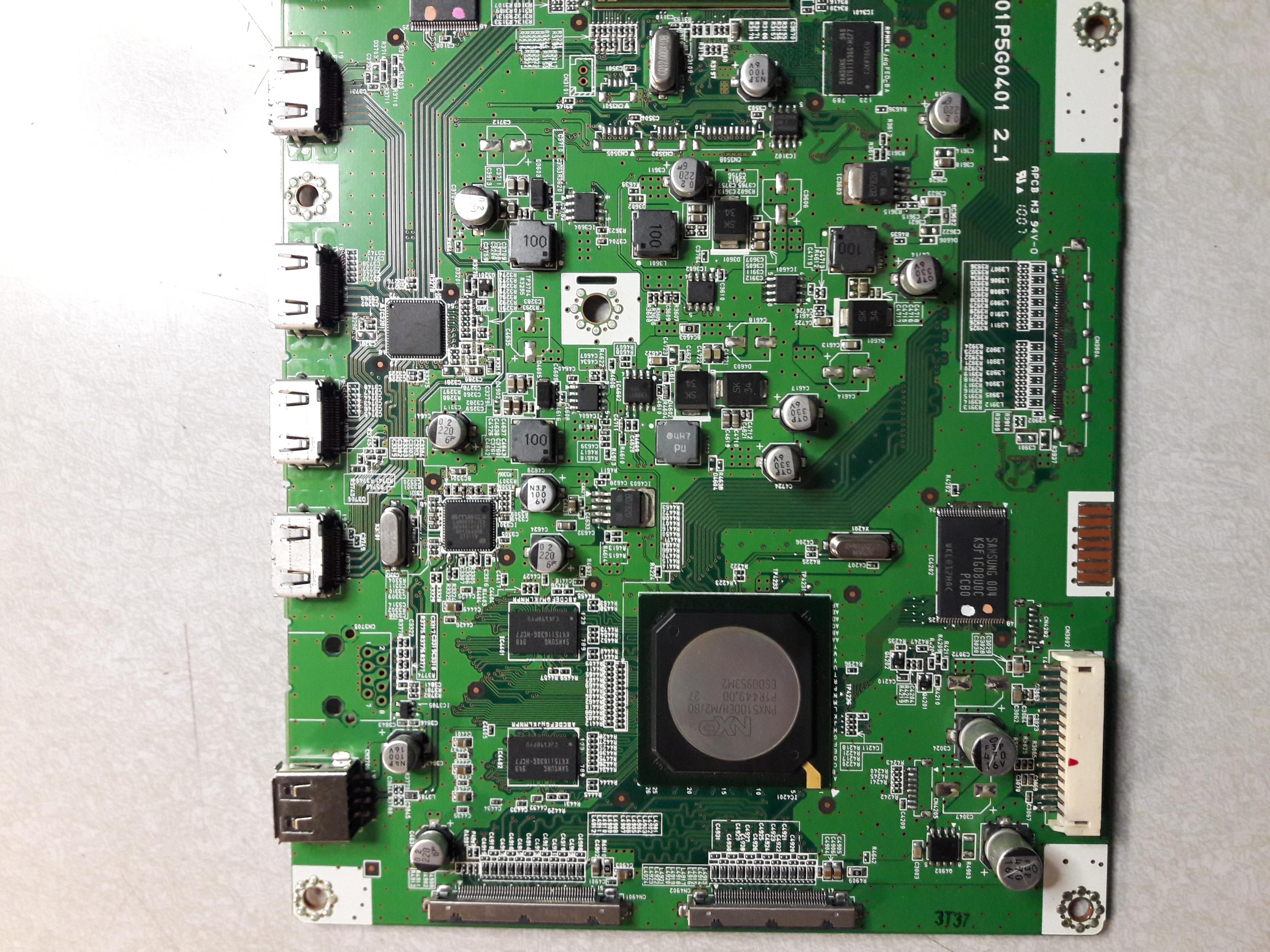

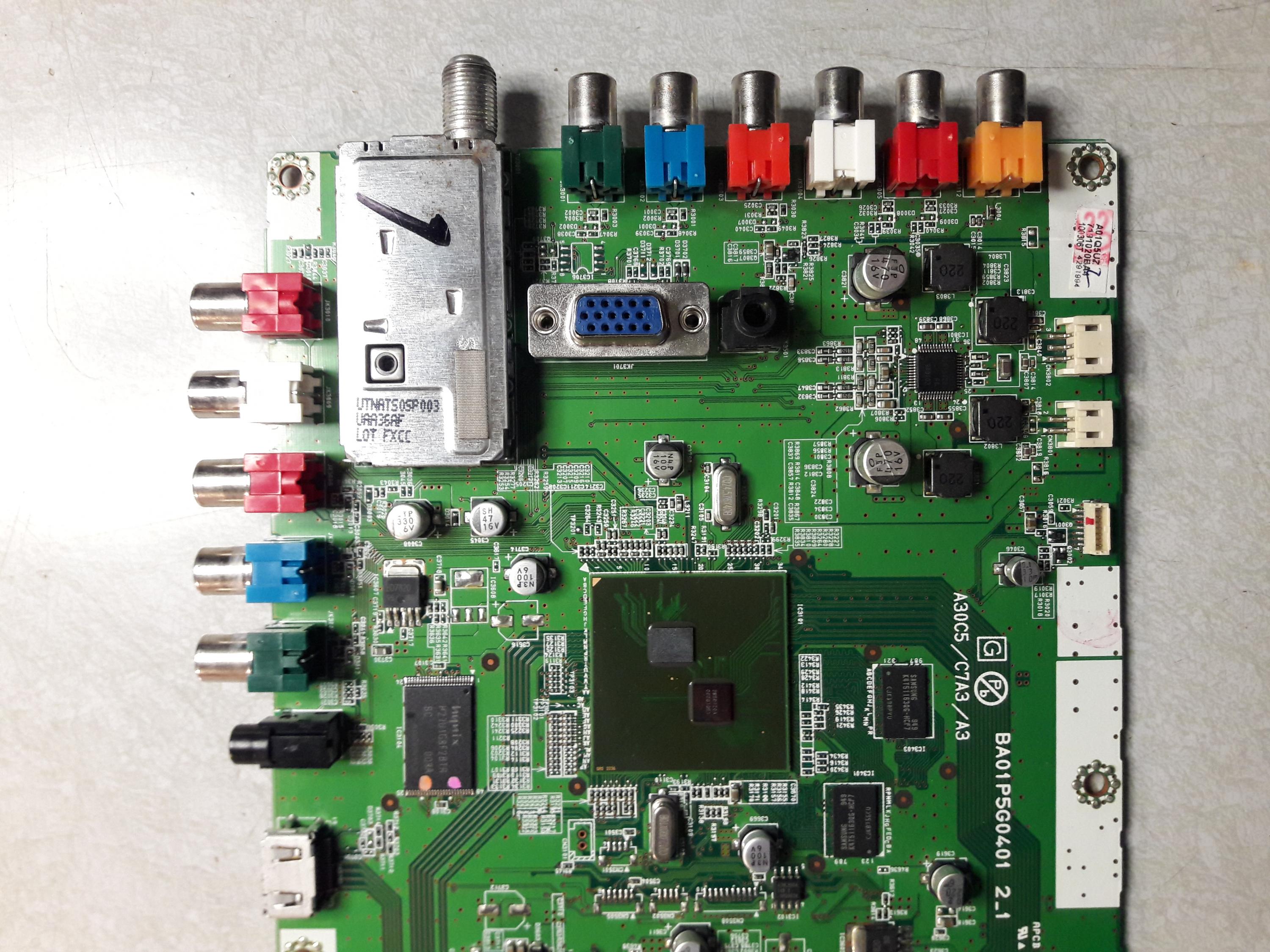

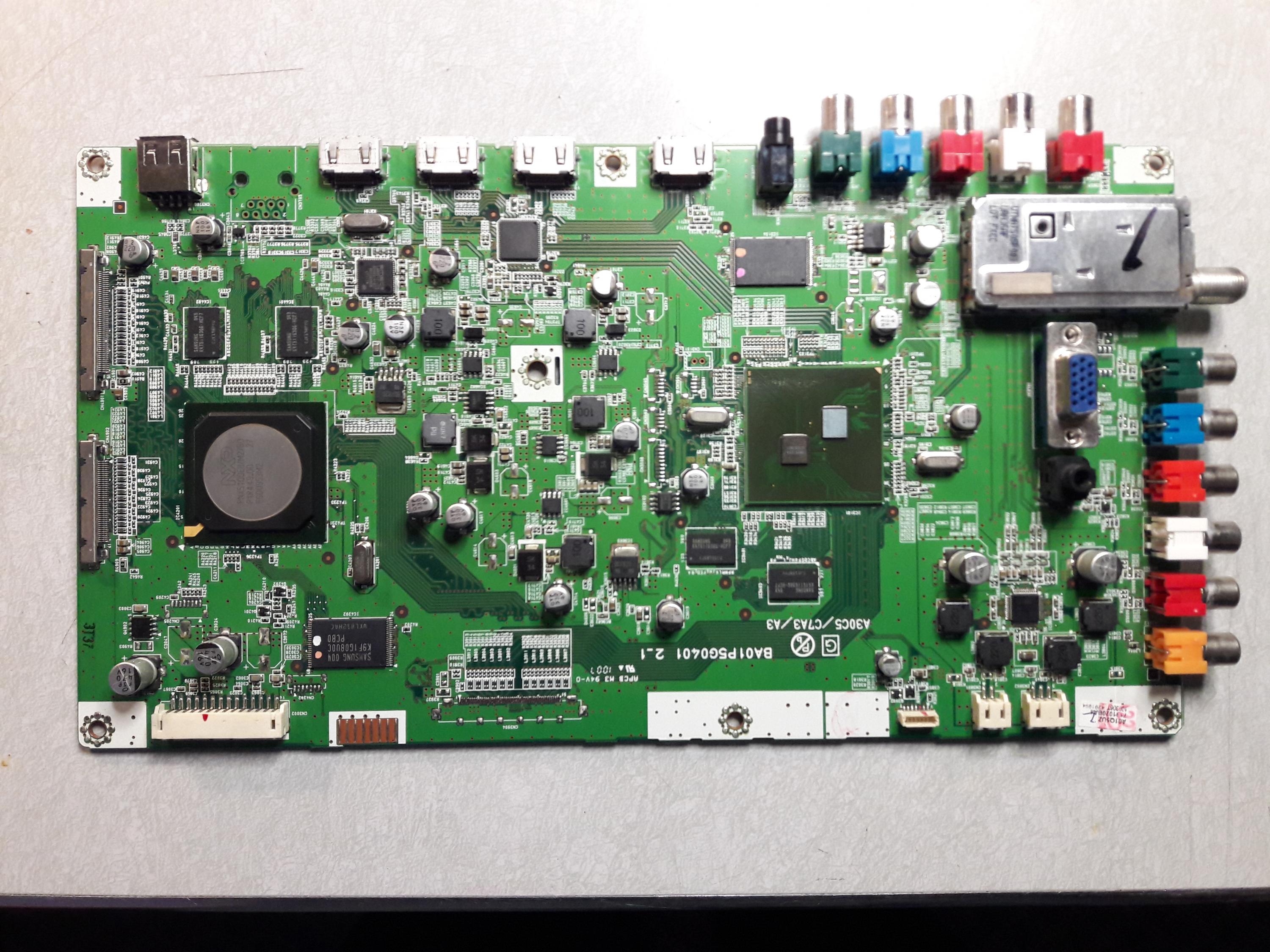

                        Nuts, BL-SW goes right to the big processing chip IC3101. According to the schematic there is only 1 resistor R3022 between CN3002 and IC3101 and it checks ok. There is 1 other resistor R3323 that goes to ground and it checks ok. There are no other components between CN3002 and IC3101 for BL-SW.

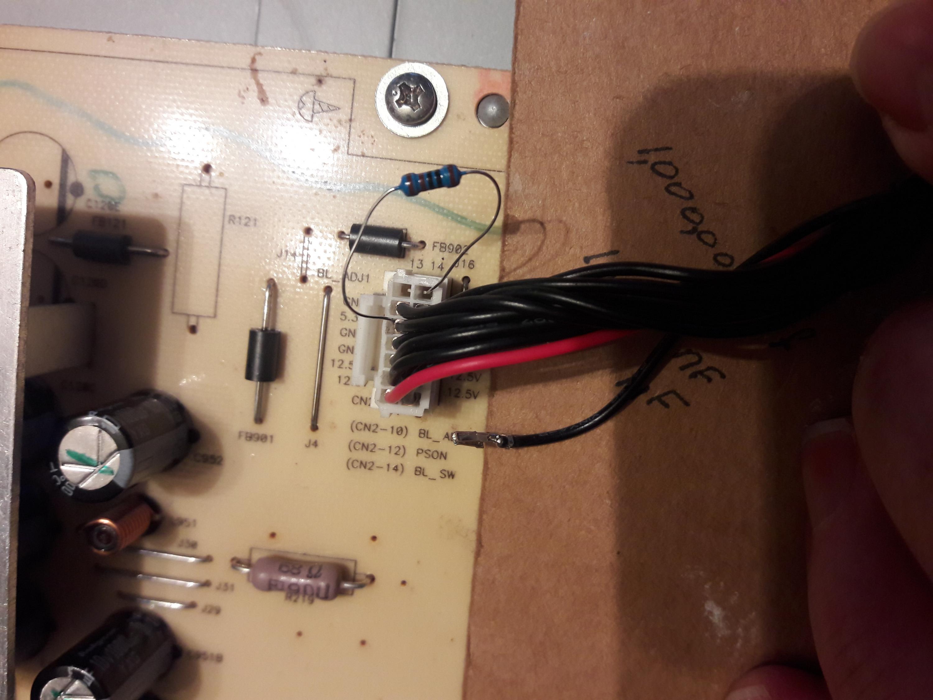

                          You can/must disconnect the BL-ON wire going back to the main board first and then use 1K pull-up resistor between STBY power suppli pin and the BL-ON pin of the power supply board to see if the backlights will come on when you turn on the TV, if everything on the main board still good then you should get sound and pictures and all the function if there is no other problem with the main board and the T-CON board, if not then you have more than one problem beside the bad BL-ON signal.
                          BTW, what do you have for the BL-ADJUST (DIMMING CONTROL)? If you have 0V then that is another problem too.
                          • What?
                            • Aug 2010
                            • 82
                            budm
                            I did as you suggested, shorted STBY(5.4V) to BL-SW after removing the connection to the Main Board. The backlights came on but nothing else, no picture, no sound and the power led is still blinking. I measured the BL-ADJ to chassis ground and got -0.007v.
                              That means you have more than just bad BL-ON, BL-ADJ problem.
                              Start checking Voltages on the regulator ICs if the main board has them, may be some fuses too if it also has them.

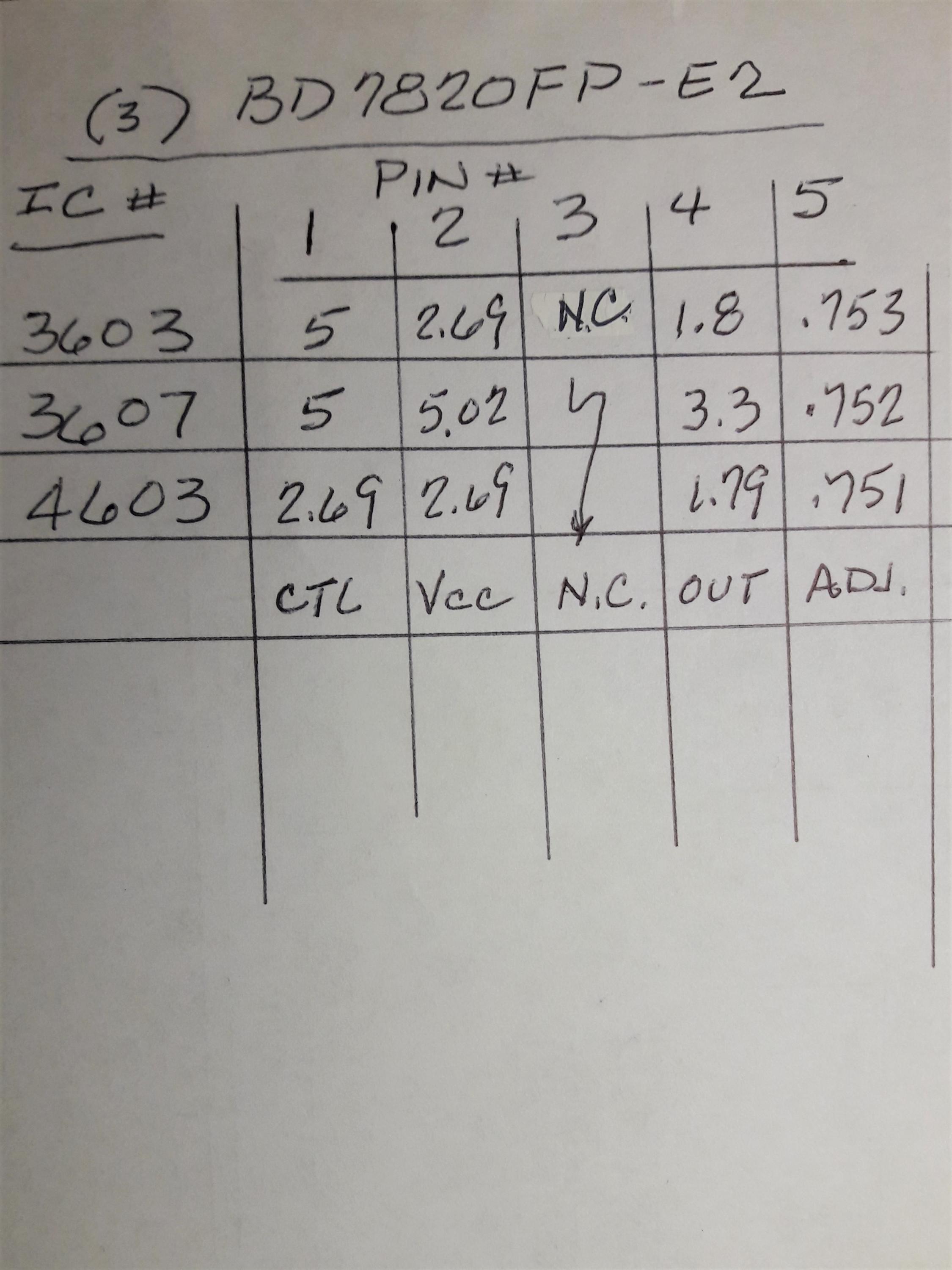

                              • What?
                                • Aug 2010
                                • 82
                                budm,
                                I found 3 voltage regulators, i attached a photo of the results.
                                • What?
                                  • Aug 2010
                                  • 82
                                  budm,
                                  I have not been able to locate any fuses on this Main Board. I have also looked over both sides of the board for any component that looked burnt, broken, cracked, loose, melted or that looks like the magic smoke got out.
                                  • CapLeaker
                                    Leaking Member
                                    • Dec 2014
                                    • 8325
                                    Yep, BLon is generated on the main IC. I think that this main board is done for. Only thing you could try is swapping the main IC, EEPROM etc.
                                    When you turn on the TV, does one of the IC's get really hot?
                                      Originally posted by What?
                                      budm,
                                      They look OK for 1.8V and 3.3V outputs.
                                      It is not going to be easy job figuring out the main board.
