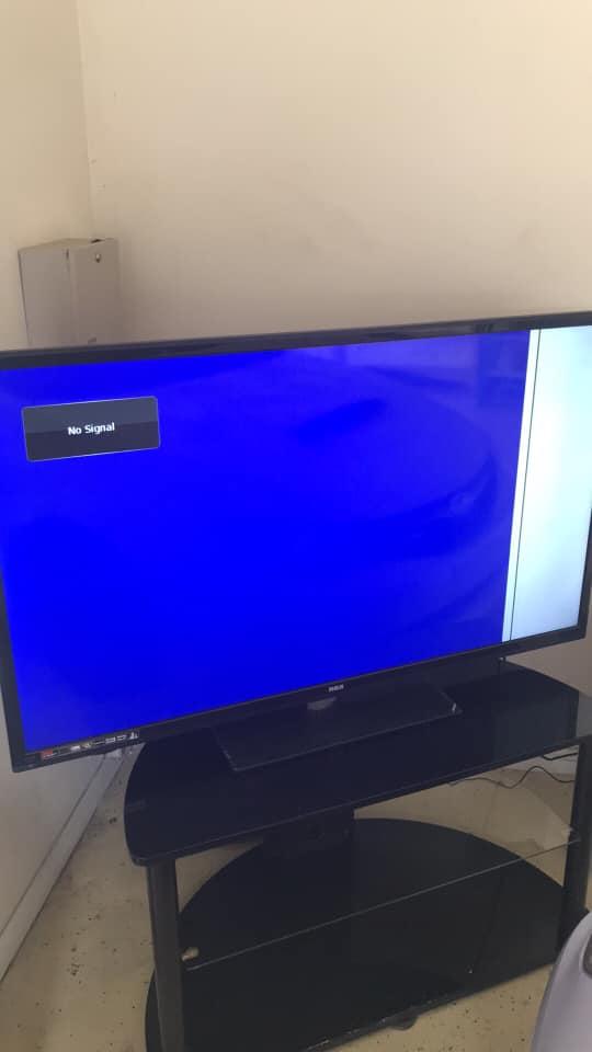

    Hi everyone
    I came across a 55 inch rca with part of the right screen white when it should be blue. price $50 T-con?
    any advice would be appreciated

    Re: 55' rca local sale need advice
    For me $20 with remote $10 without. Could easily be screen bond problem ?
      Bad panel. There is a black vertical line as well as the vertical band. Not fixable with a new tcon.
        I think I will pass on this one. thanks everyone
          It may have some good boards in there that you could sell on e-bay, etc.
