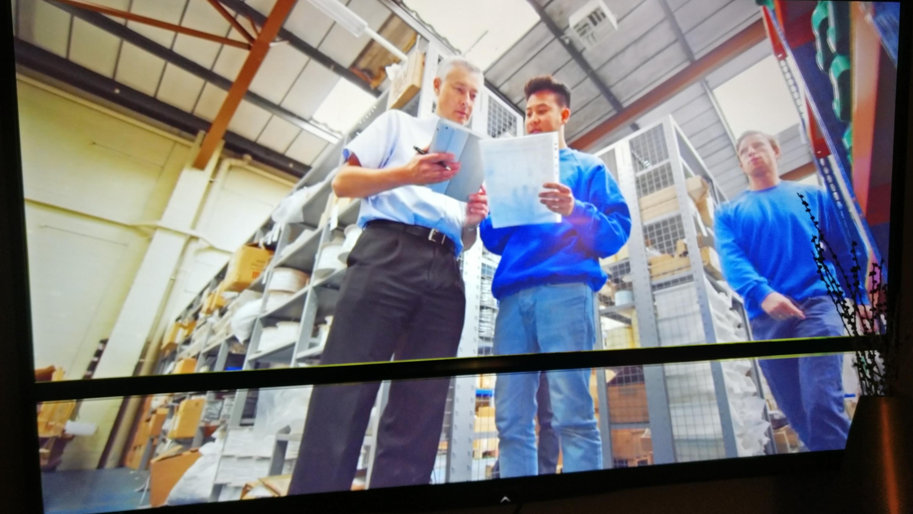

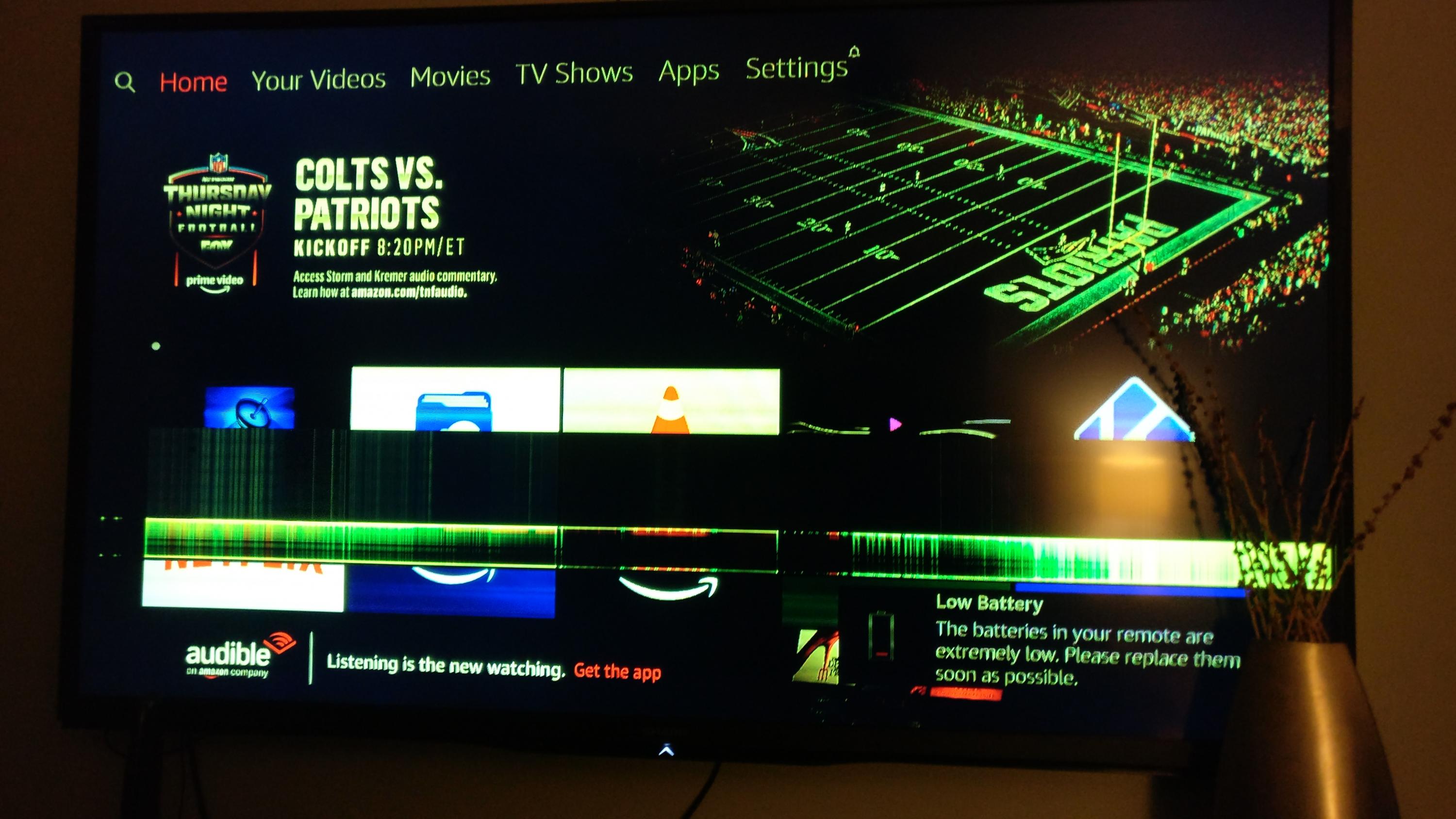

    My LC-70LE650U has developed an issue which looks to me like panel failure. Has not been taken down from the wall yet.
    Until it is, what do you think ?
    Re: Sharp 70" First Failure Post Side-Tab Removal ?
    Other times it looks normal except for the dark band across the bottom of the screen. The band goes edge to edge.
      that is quite significant... it looks like the last remaining tab failed.... :-(

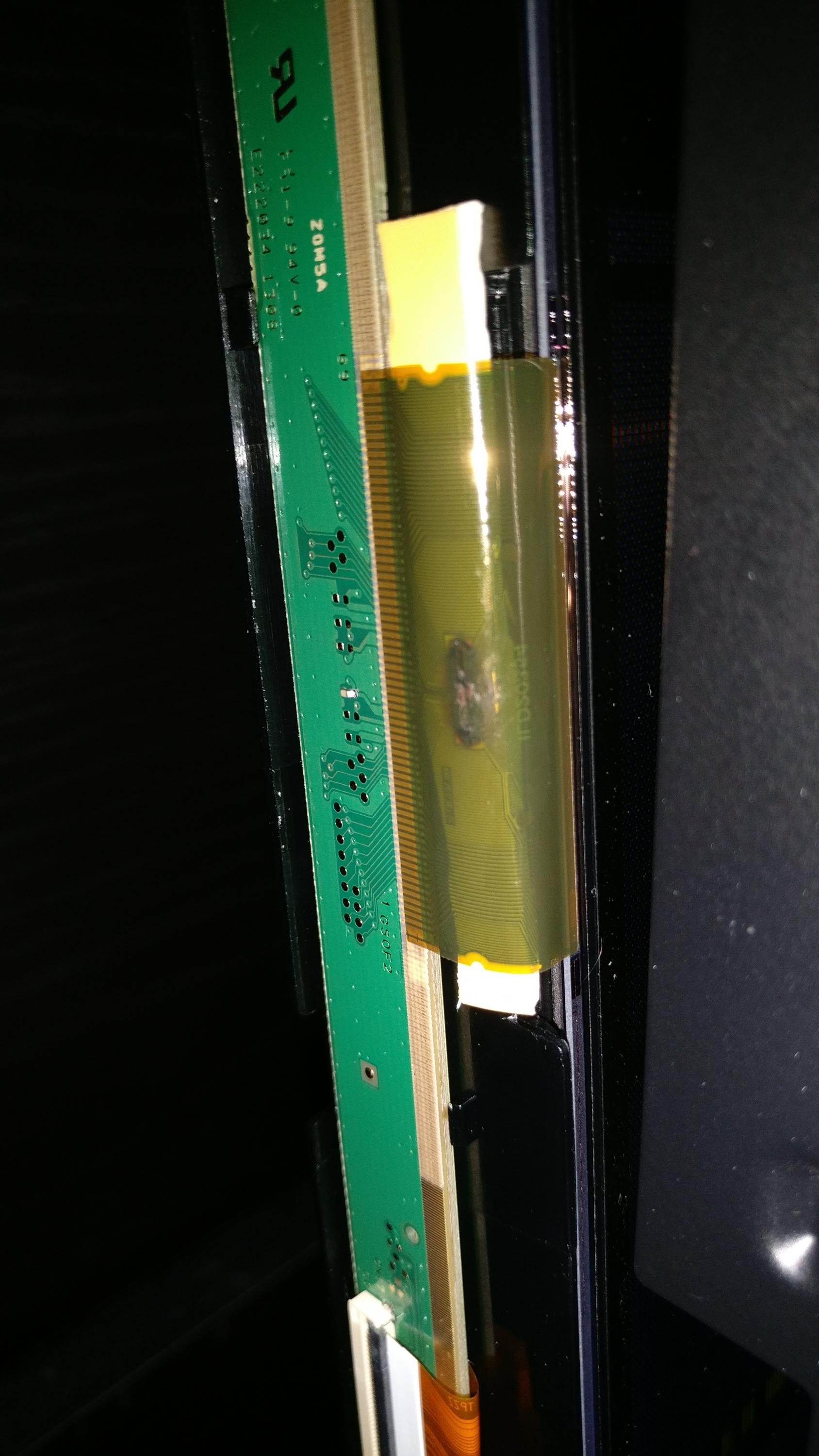

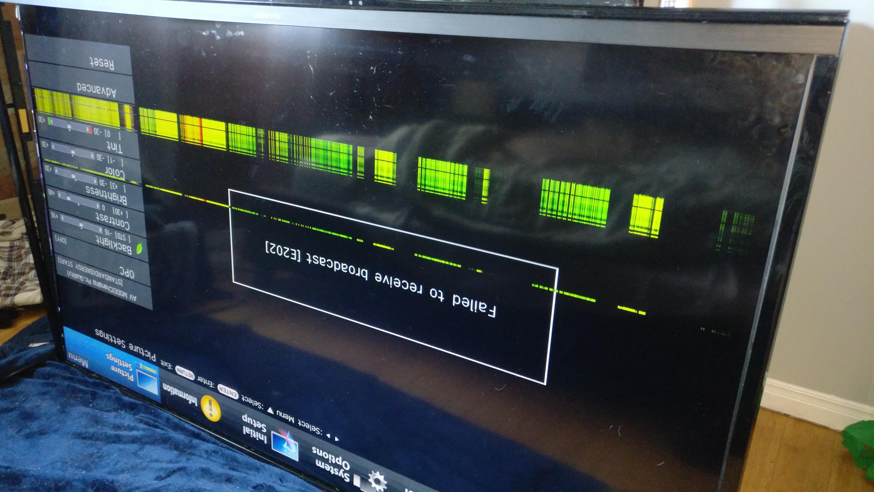

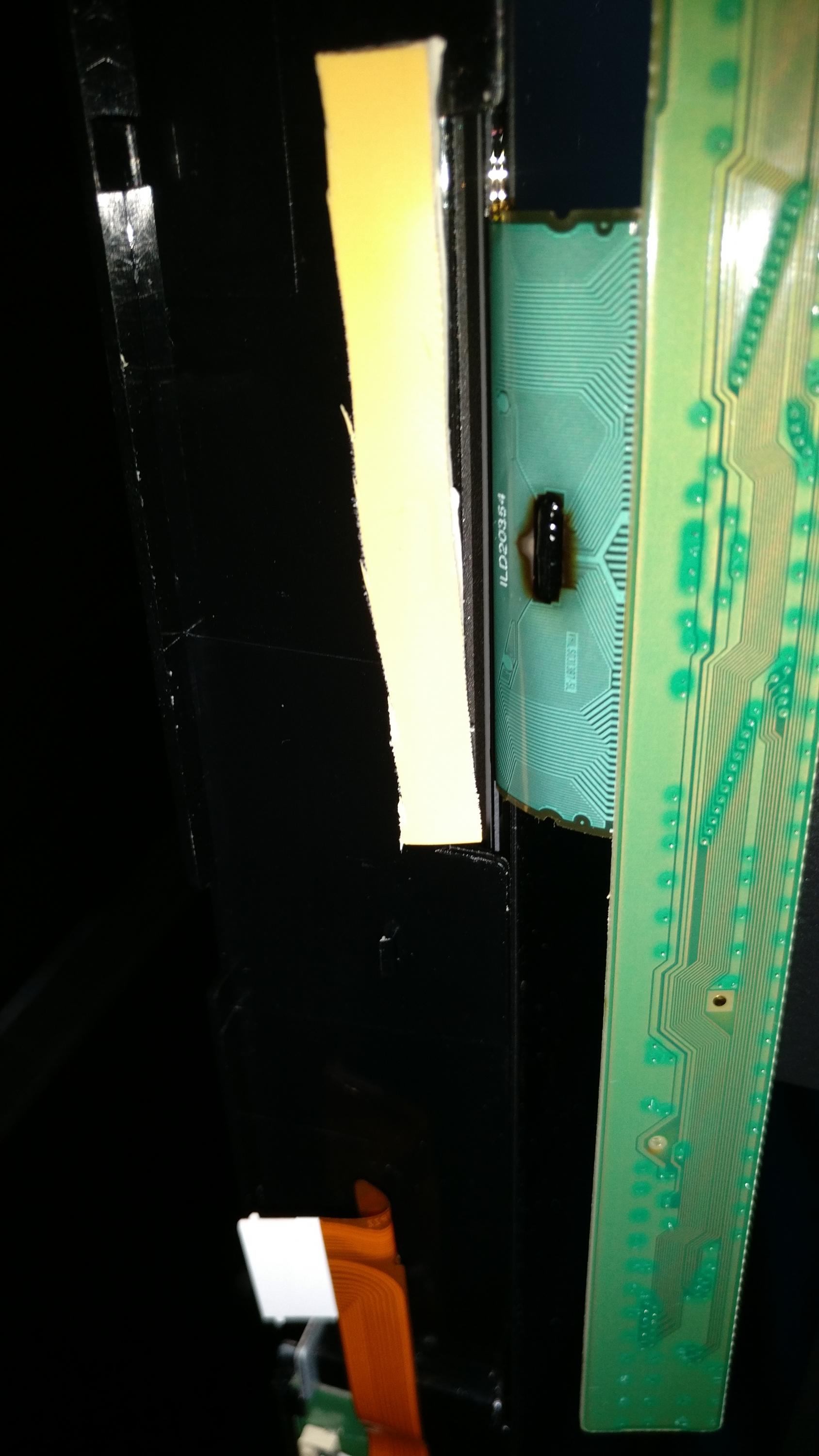

                Here's the diagnosis... COF failure second from bottom. Already pulled them from the other side so this one is toast.
                Lasted a few months short of three years.
                (pics in next post)
                  I tried making a thermal pad sandwich and reinstalling the metal bar but it did not make a difference as the chip appears roasted. You can see the pad in one of the pics, the other was on the underside of the bar.
                    No doubt it's dead...wonder why Sharp's larger panels are so prone to this failure. It seems like a design defect.
                    Maybe the lesson here is to peel off ONLY the failed tab so you have more chances if the issue occurs again.
