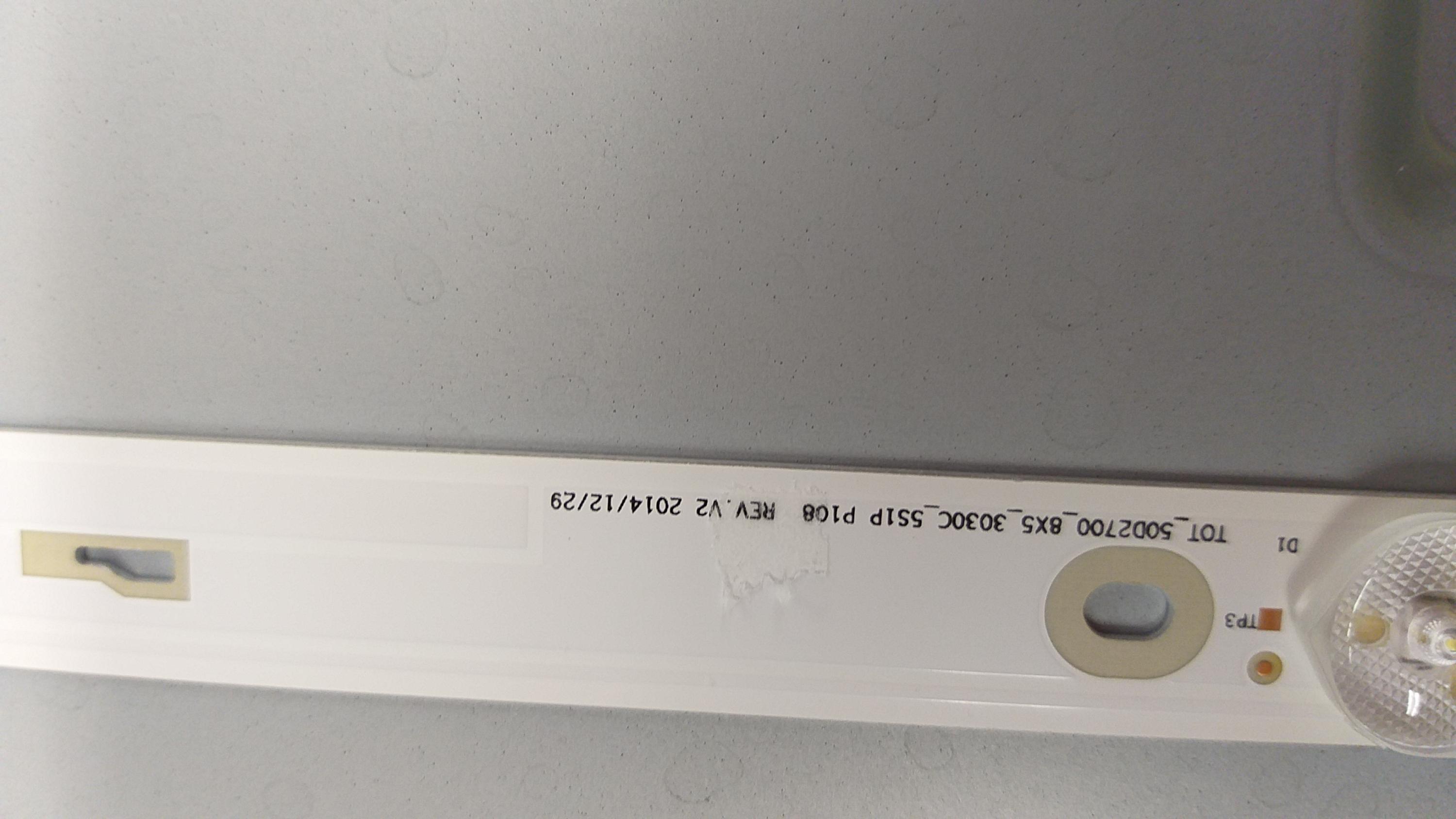

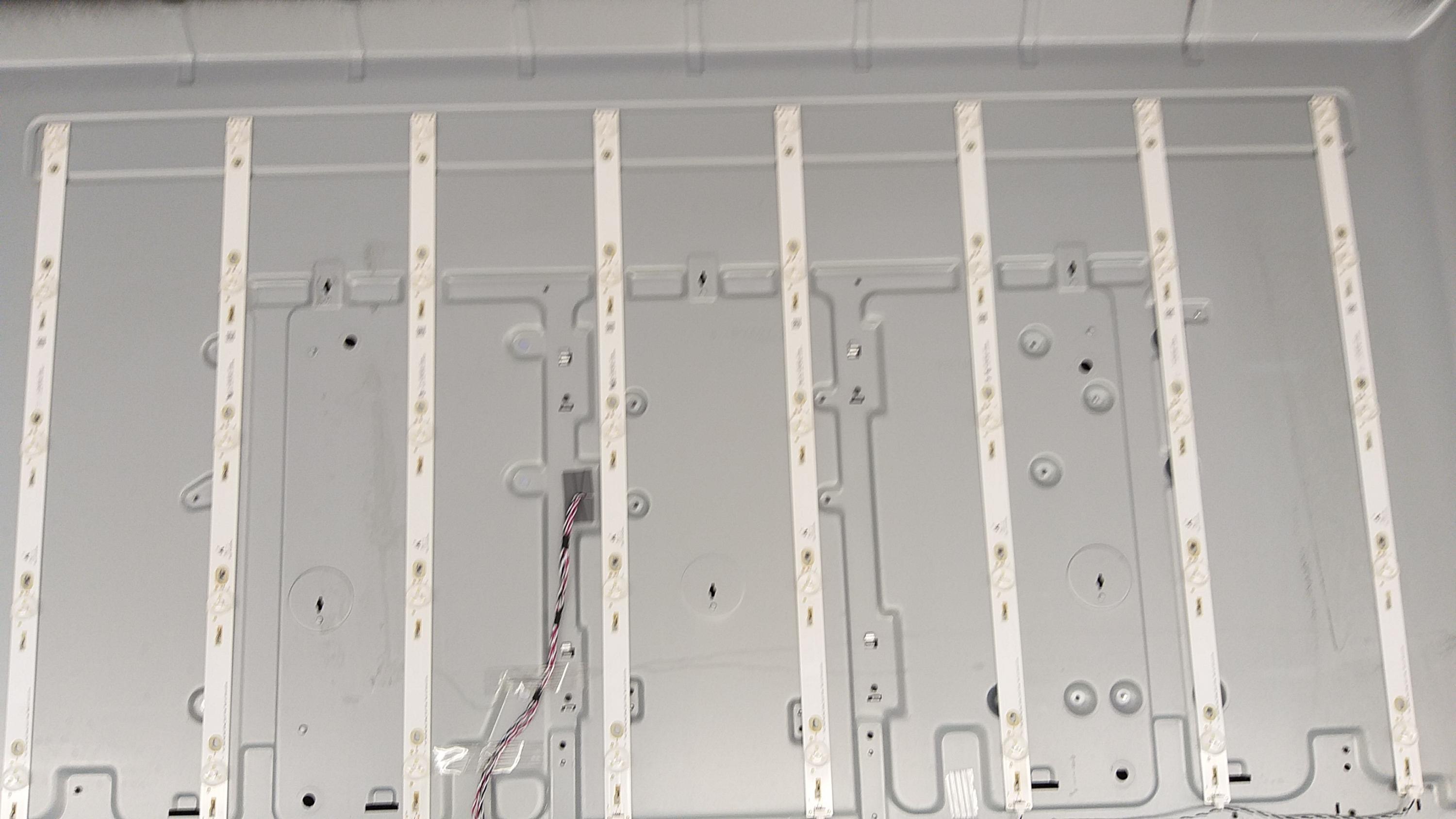

    Hi everybody,
    Just a quick reply here. If you get a LCD TV in whose back lights switch off and you open the TV up to check and count a total of 40 LED's of which 36 are dead short with only 4 surviving. Is it not feasible to say that the back light constant current PSU failed and killed all the led's thus we need to replace all strips as well as the PSU.
    Replacing 36 LEDs would be a total waste of time?
    Any other solution?
    Regards
    Angelos

    Most likely the LEDs failed on their own and the Drivers are still working on the PSU. So no need for a PSU. Yes, replace ALL the strips as replacing 36 LEDs would be a total waste of time.

        The LEDs die on their own. Hardly likely the LED Driver killed them. Replace the strips and your TV will work again.

              Re: Panasonic 50" LCD TV Model TH-50C315Q - No picture but sound
              What is the LCD panel model number? You need to match the LED strips with the LCD panel model.
              Any pictures of the LED strips?

                Hi Budm. I added photos of the leds. I have closed the tv so i dont have the panel number but if you want i can open ot up again
                  The LCD panel model number sticker should be right on the back of the LCD panel.
