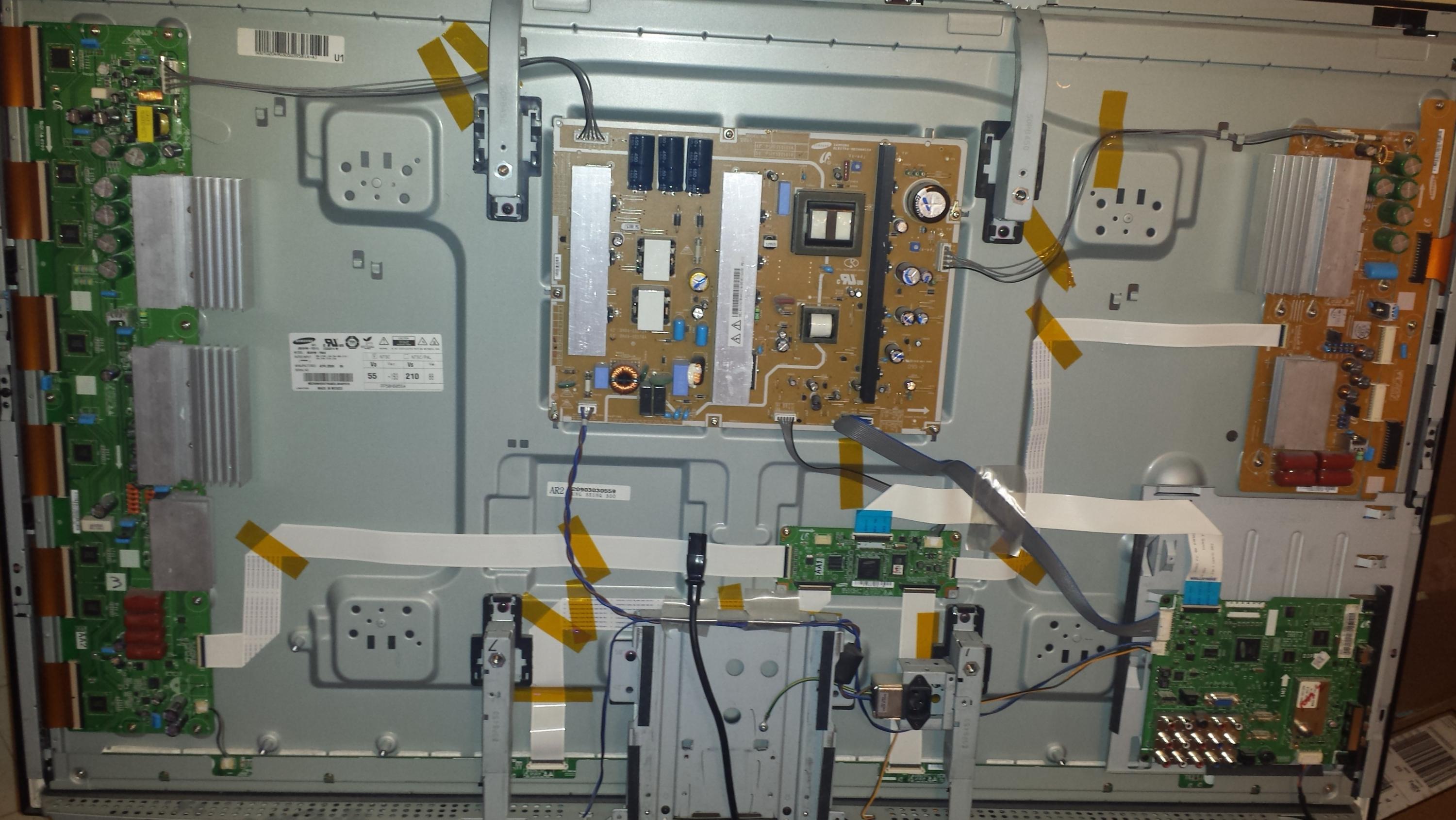

TV literally just popped and picture stopped working. Sound was good.
On TV Turn on and Turn off, there is colored static that flickers on for a split second.
As odd as it sounds, I am unsure about the Backlighting. I don't see a significant Backlight after the initial Flicker. ADDITIONALLY, I do not see a picture when I shine a light on the screen.
No obvious Caps are blown. No fuses seem to be blown.
I tried the VS_On --> +5VDC, PS_On --> Ground, LVDS disconnected, Main Board Disconnected and I did not get any test patterns on the screen.
Harumph
Thoughts, ideas?
