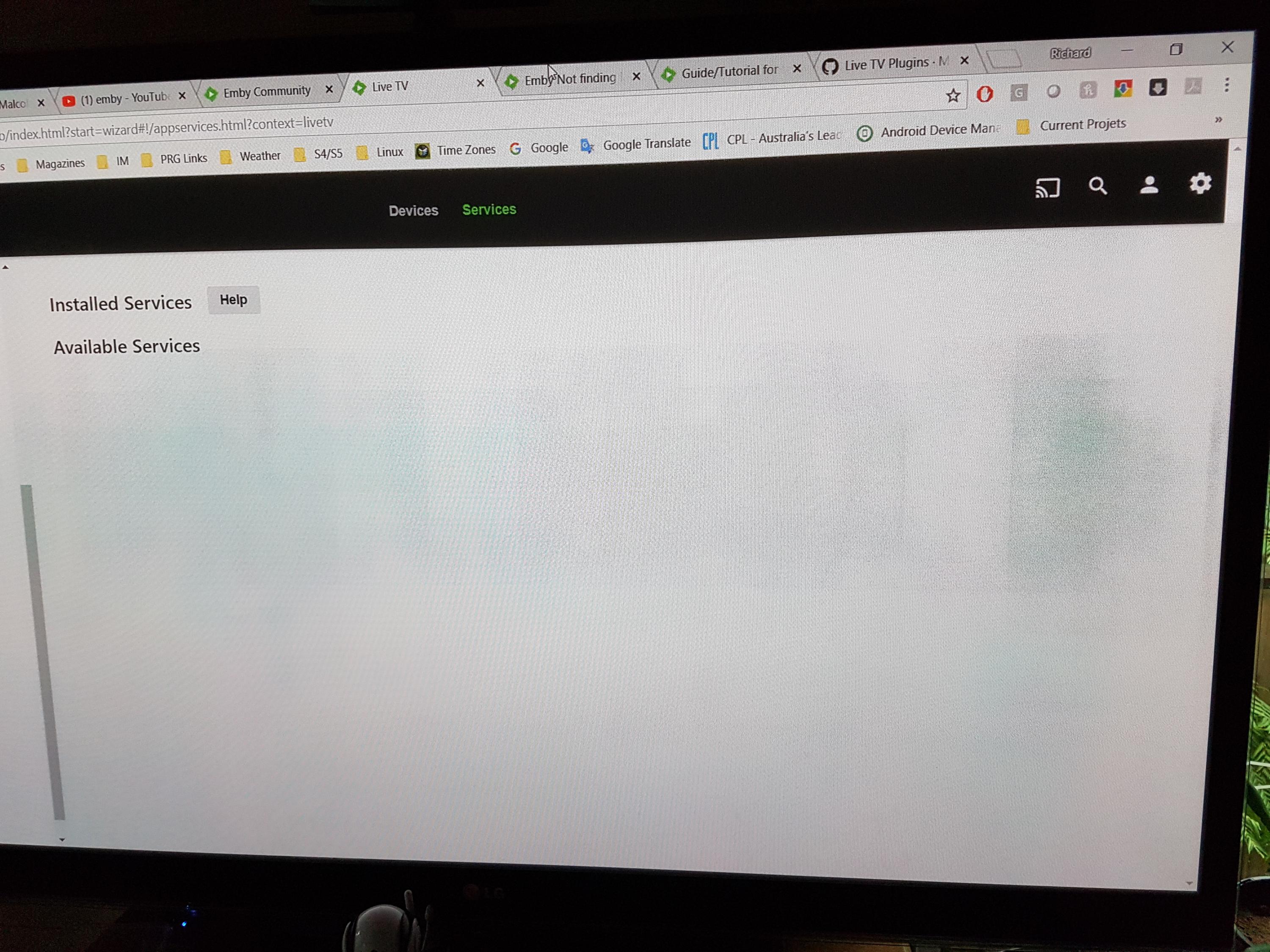

    Hi guru's,
    My 60pz950 died this morning, please could you help me diagnose which board I need to replace. I have not opened the TV yet, I plan to do that tonight, but here is the run down.
    A week or so ago, the TV started going blank after a few seconds or minutes of use, the "off" LED did not light up, just the screen went blank. If I turned the TV off (so the "off" LED is lit up), and then back on again, the TV continues to work for another random time period. If I continue the off/on/off/on cycle for a while, the TV would stay on, and work fine all day. Then the next morning, when I turn it on, I have to repeat the on/off/on/off cycle until it stays.
    Then this morning, I noticed the TV displaying a shadow of previous images in certain area of the screen (see attached pic). It did this for about 30 minutes, and then went "click" and the screen went blank. on/off/on/off doesnt work anymore, the TV is just dark. There was the smell of electrical unhappiness in the air....
    I've no idea if sound works, as this is just a video display from a media server, audio comes via other speakers, not the TV.
    Where should I start? Please help, its only a matter of time before the children gang up and attack me!
    Rich

    Look at the bottom side of the x and z sus boards for cracked solder joints on the big copper coils.

      I've opened the TV and found that the YSUS has a bad fuse. Changing the fuse is fine, but shouldnt I worry about why the fuse blew in the first place?
      with the YSUS out, should the screen do anything if I power on the TV? at least with the YSUS out, the bzzzzzz noise is gone! lol

        Yes the fuse popped because the coils went open circuit which eventually lead to the SUS IGBTs going bad. So the Y-sustain will need to be rebuilt because the TV has run too long in a fault condition.
        You can attempt a repair the board or replace it. Note you must source the 60" version of this board, if you find a 50PZ950 board it will not work. LG may have used the board in a number of other televisions using the same panel number. Refer to the panel sticker, marked LG PDP60xxxxxx, to locate your panel number. Use EAX number to buy a new board or source repair kit.

          thanks both, I took the board to work and gave it to an electrical engineer, most of the gates on the board are blown! I'll have to get a new board.
