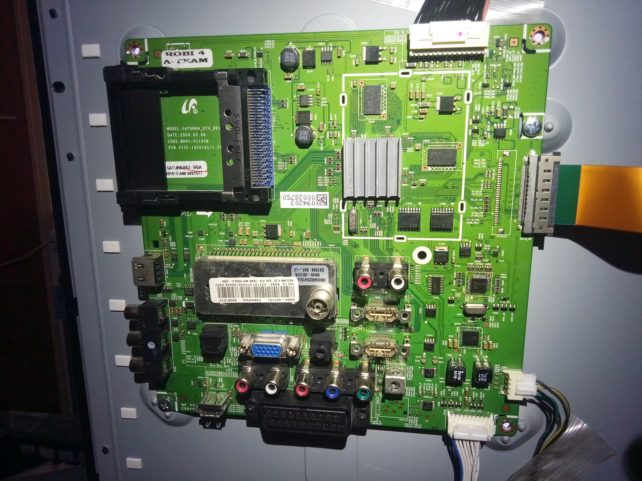

    Long story short: I got a LE40B530 that had a mainboard issue. Power supply checked out fine, so I decided to buy a replacement main.

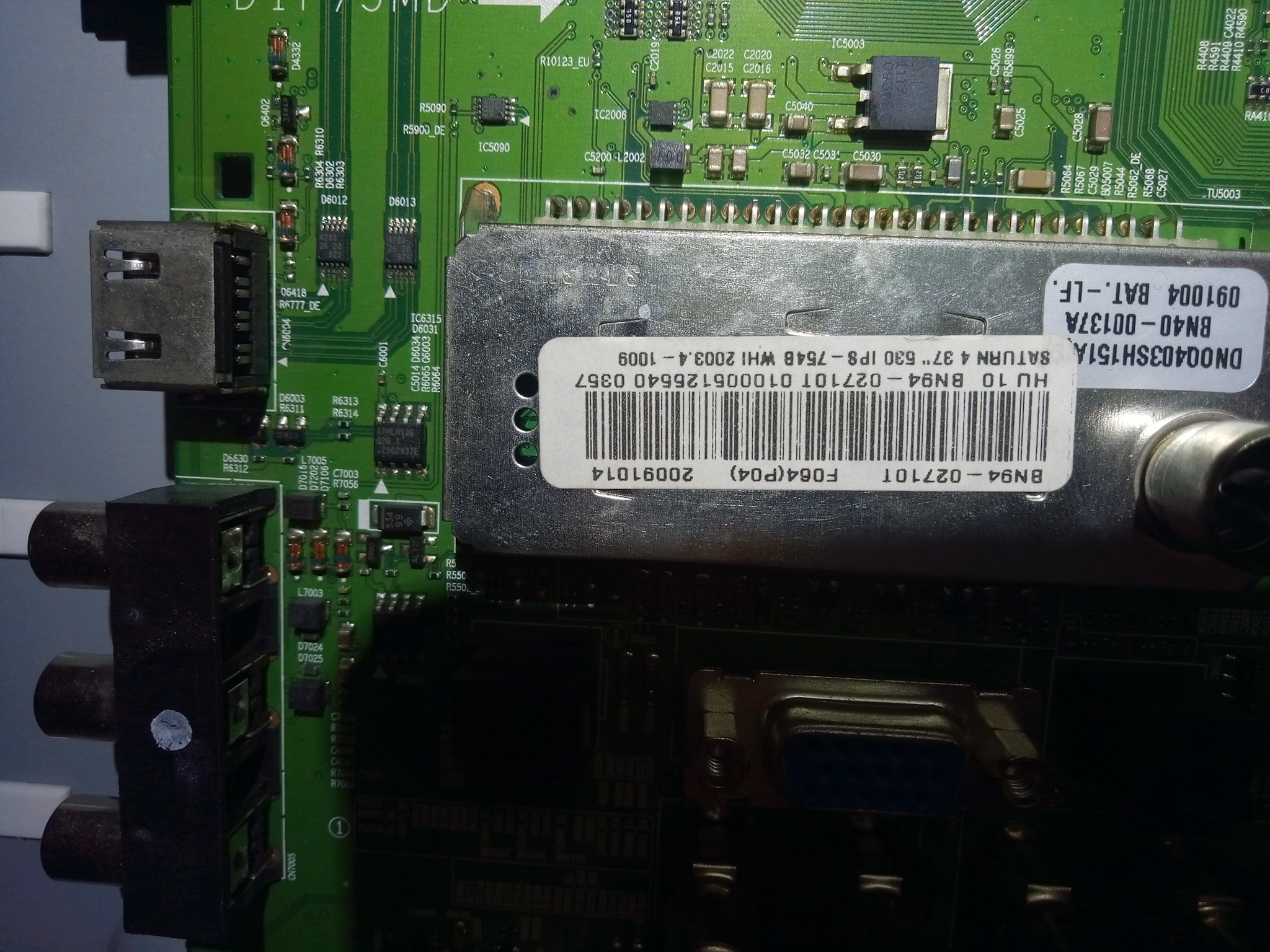

    I bought a mainboard from a local guy, but he told me that this board may not function properly. He is no expert, he removed it from his broken screen set, sold it to someone, who sent him back because it "froze". His tv was also a LE40B530. Only difference is that his mainboard is BN94-02710T, my original was BN94-02710M. For me they look identical, and googling what the difference is between the "T" and "M" did not gave me any results.
    Anyway, I gave it a try. My set turns on, works perfectly fine, until a few minutes pass by, then it doesn't react to the remote controller.
    It receives the signal, the standby led blinks but nothing happens.

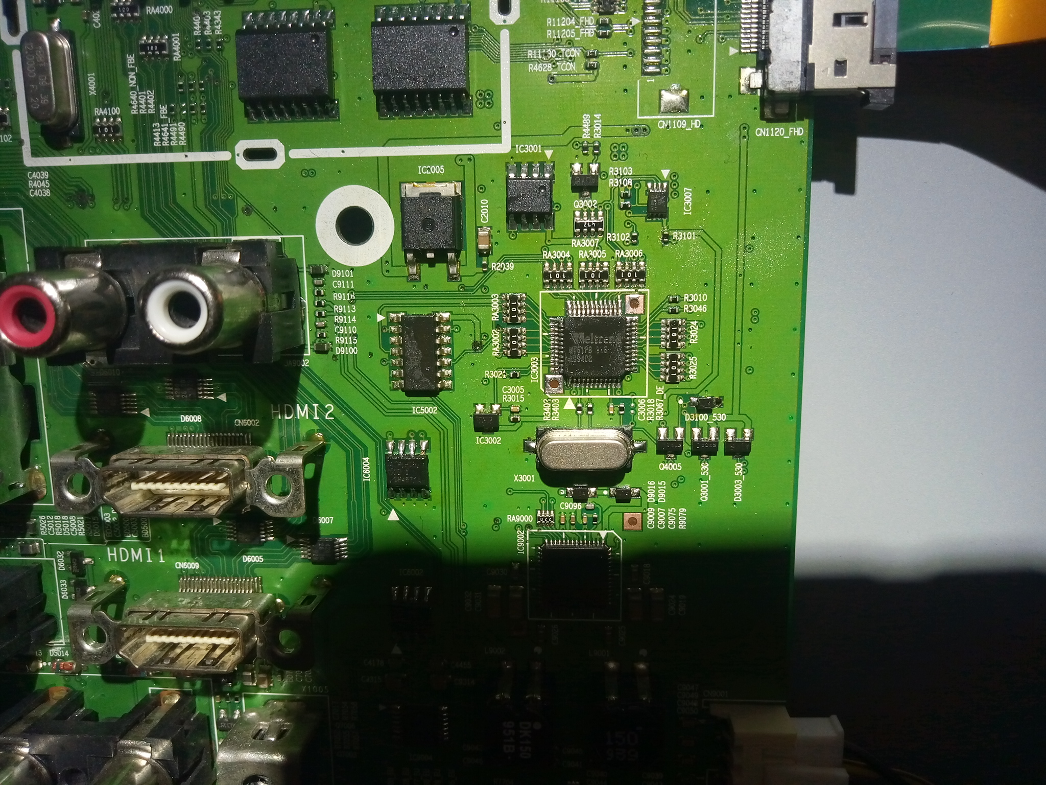

    I followed the path of the signal, it goes into a chip named IC3003 (WT61P8) and I believe that the problem is related to this IC. When the tv is on for about 5 minutes, this IC gets warm (it doesn't get hot no matter how long the set is on) and the set no longer responds to the remote. BUT if I cool down this IC, it works again! More strange things are coming: in this state, the power button still works, but not as intended. If I push it, the standby led blinks, that it received the code, then I wait about 2 seconds, and it turns off. But not as it should, because on a normal shutdown it plays a melody. In this case it just turns off. I attached photos of the main and the suspected IC.

    If you suspect that the IC failed when it is worm up then you should try usiing freeze spray or canned duster upside down to cool the IC and see what happen.
    You can repeat the problem, correct?
      Re: Samsung LE40B530 - iR doesn't work
      Hello budm, thanks for coming by.
      Yes, I may forgot to mention, that I used freeze spray to cool the Ic down, and the remote started to work again. I can repeat it as many times as I want to. This chip has programmable memory, and my fear is that even if I buy one from eBay, I can't get the code written into it.
      Cheers, Janos

                  Yes, you can set the melody. BUT this happens, when it is set to play it. I am not missing or anything, I was just thinking this gets us to locate the problem. I have a feeling, this is some kind of weird issue related to the IC's internals. As I wrote, I have already ordered a working mainboard, but being curious about this problem, also ordered an IC. Will look into it when they arrive. One more addition: having absolutely no other idea, I refreshed the solder joints around this IC. Resistors, capacitors, everything. When I got to the 24MHz crystal, the working time of the set significantly increased. I have never seen a crystal go bad, but at this point, I can imagine everything
