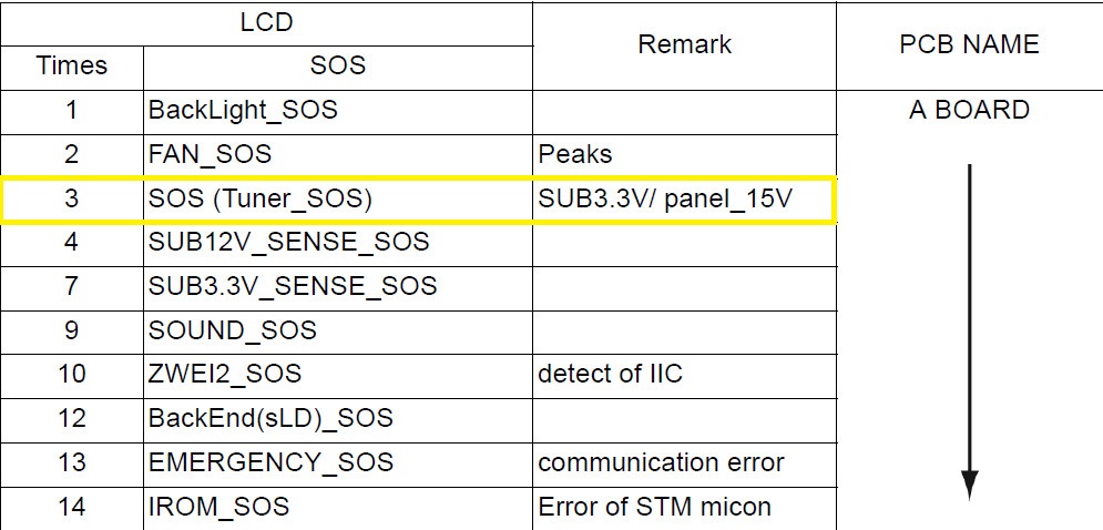

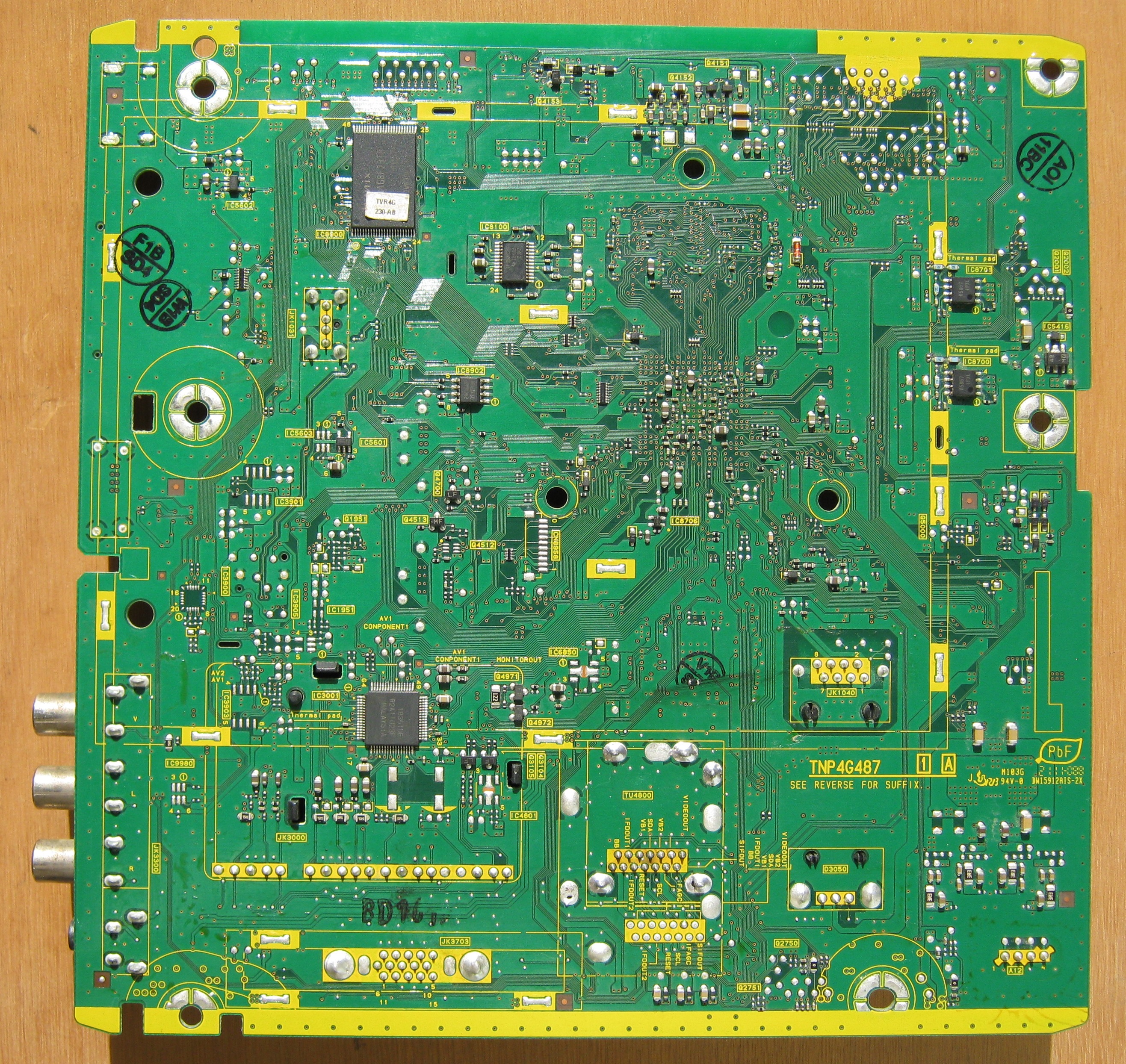

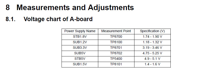

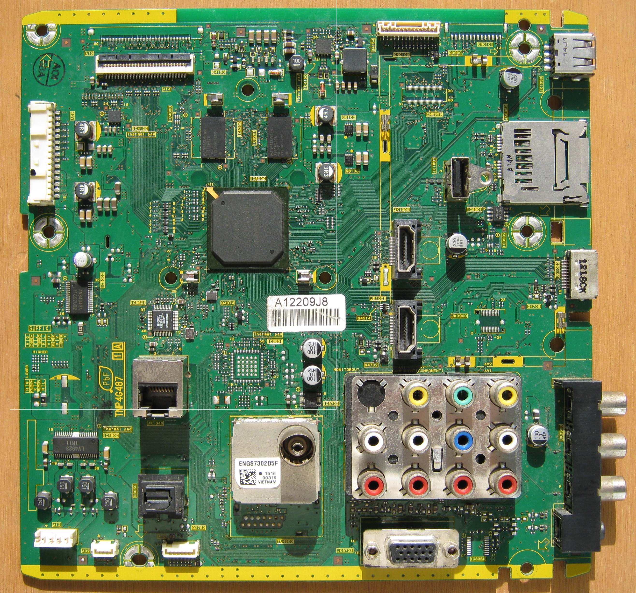

    Hello Friends,My Panasonic LCD TH-L32C30D went on 3 Blinks This Morning, i have Two Sets Of Same model, one has Audio Problem in the card, so i have kept Aside as could not revive it back, now the other one also went bad today,
    Can some friend guide me, where to Diagnose this fault, i am attaching the Service Manual, and Pics of the A-Board.
    3 BLINKS-SOS (Tuner_SOS), REMARKS Sub 3.3v/panel_15V
    I would also Like to know whether is it possible to modify its panel and Install any Chinese Card in it,as its getting very difficult day by day to obtain its original A-Board due to the Model Being Fade Out.
    Thanks and Waiting Eagerly for the Help.
    Note:I have also Checked the 3 Blinks A-Board in, the other set which has Audio Problem,but the result is same 3 Blinks.

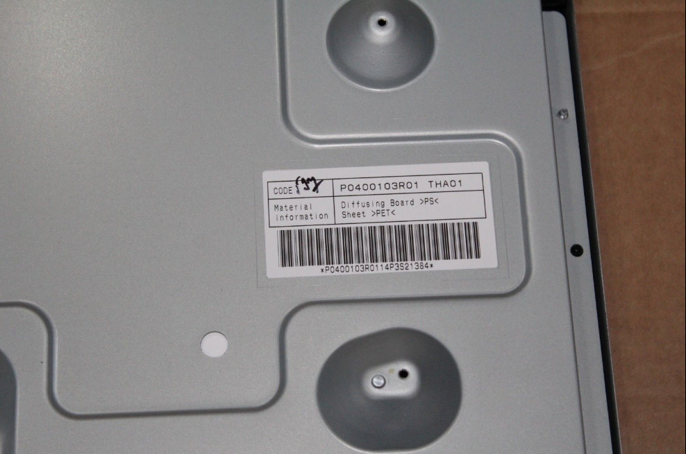

      Hi Tiku, check the panel number on the internet and the lvds connection is what type. Most chinese boards will not drive anything 4k panels. Attached is example panel label.

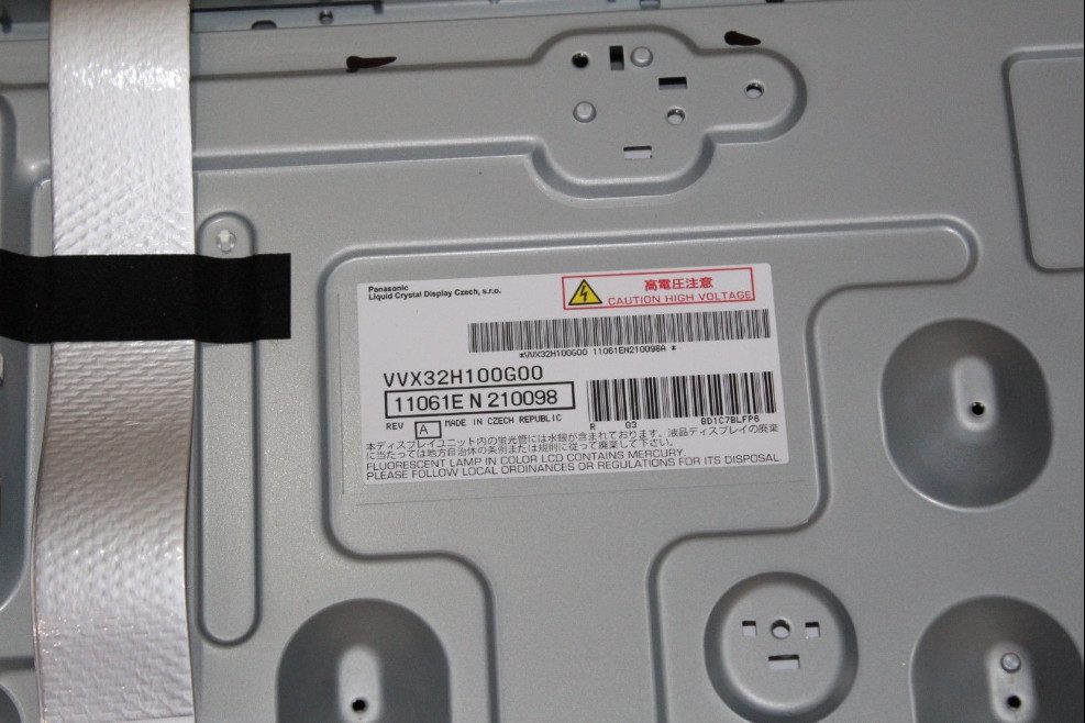

        Thanks Sidds, the panel Number Is VVX32H100GOO
        this is written in the second line 11063M N J90267
        Rev A Made In Malaysia
        i Have exactly written whats on the panel, its a LCD Model may be released way back in 2008-2009, Resolution
        Type of Television: LCD
        Resolution: 1366 x 768
        The A-Board has a built in T-con Board i Guess i am not sure.

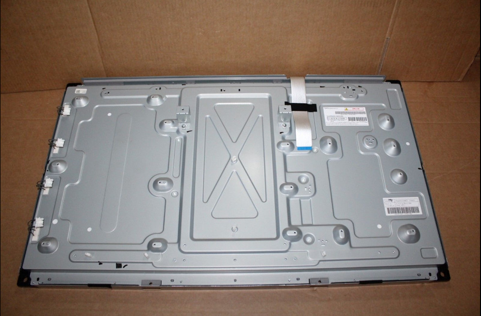

          here are the pics of the panel

            Panel data:
            http://www.panelook.com/VVX32H100G00...ter_22398.html
            A quick google search gave this, a driver board needed before it can be connected to a universal TV board.
            https://www.aliexpress.com/item/TECH...864834051.html

                    I know about blink codes as they are mention in the manual. I have one board with 9 blinks which was irepairable after trying everything including removing speakers cable, also tried to take forum friends help over here
                    https://www.badcaps.net/forum/showthread.php?t=65744
                    Now this is the second one gone bad, i have two panels and three supples with me, but only one working A Board which now went bad, so i need exact part to look for in the A-Board, panel and supply is 100% OK.
                    as you said
                    "Three Blinks:*Three blinks of the power LED indicates an over-current or over-voltage condition in one of the DC supplies of the AP board. The AP board is repairable. Therefore the use of an ohmmeter and peak-hold-voltmeter is required to determine the cause of the shutdown. An over-voltage condition is definitely a defect of the AP board. An over-current condition may be due to a short circuit located in the AP board, A board, or the LCD panel"
                    We have Voltage Fluctuations Isuue in our Country. so their might be a voltage surge, i have ohmmeter but i dont have peak-hold-voltmeter with me.

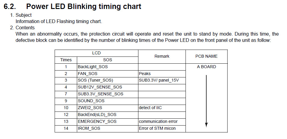

                      Ok this fault is Repairable, But i dont know where to look into, can somebody please guide me which part or parts (IC) I should check, i am attaching the Blink Chart.
                      I have checked this board in another working TV Set, so the fault is in the Board not the panel.
                      Thanks.
