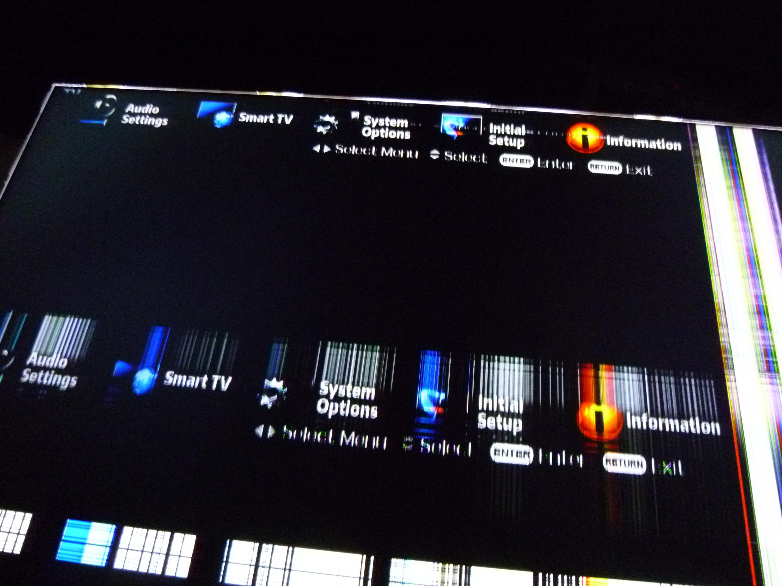

            Hey, did some more testing and I finally got an image not very nice and shaky but I can see the menu in the top half, bottom half is rainbow colored.
            I changed the 2 ribbon cables that connect the 2 small boards together on each side the left one to the right and vice versa.
            This is with everything connected...but that left tab that was becoming hot, is still very hot and I think that is what is causing the remaining problem. What should I do, do I remove the other 5 tabs?

                  OK... am I right that the side that has the vertical multi color lines is the side with the tabs removed? IF so, is you go back to your "disconnect the interconnect ribbon" on those bottom edge boards, what happens... you should get back to a good 3/4 picture like before. Please confirm.

                    Hello, sorry for getting back so late, I was away yesterday. Last night I continued my tests, but bad news, after reconnecting everything and wanting to do the test i.e. disconnect the interconnect ribbon, couldn't get the tv to behave as before.
                    This time with anything connected, it powers up with the white led, but nothing, absolutely nothing on the screen, no flash of the backlights, nothing. Then I noticed the led is giving an error message one long blink at 2-3 seconds interval. From the service manual, it appears that there is now a lamp/inverter fault. When I totally disconnect the Tcon board, backlights don't come on as before. Gotta get back to diagnosing why I get no backllights........
