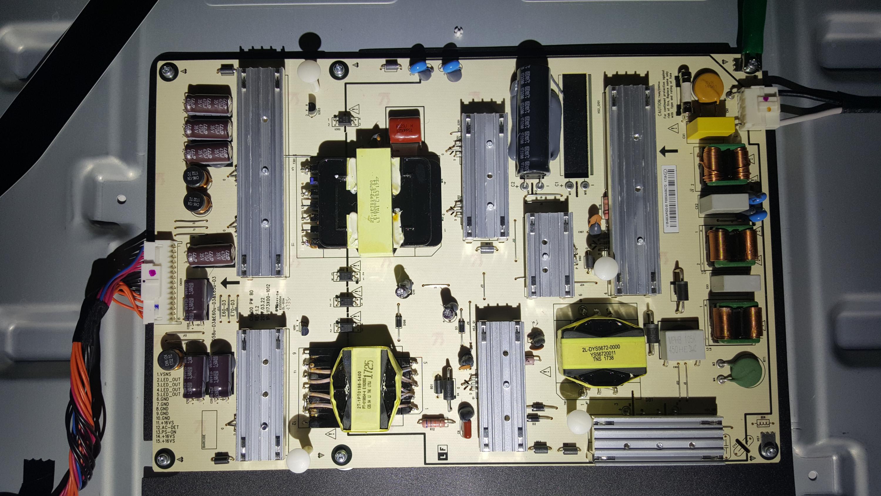

    Hello all, i have a vizio that will not power on at all.
    PS board part number is 09-60CAP0D0-00.
    PS output pins read
    1. VSNS __0V
    2-5. LED-OUT__0V
    6-10. GND__ohmed 0.2 or less
    11. +16V__16.3VDC
    12. AC-DET__1.8VDC
    13. PS-ON 0V
    14.+16VS__16.4VDC
    15.+16VS__16.3VDC
    I was told that it was struck by lightening. Here's a pic of the power supply.

    Re: Vizio E60-E3 No power, No standby light
    probably a bad main main IC on the main board.
        The ac detect is not the StdBy voltage. With the ac applied, what voltage do you have across e-cap C2?
        • CapLeaker
          Leaking Member
          • Dec 2014
          • 8146
          PSon is generated on the main board. So if you don’t get any PSon, the PSU won’t power up fully either.
            That means your Man Bd. is shot.
              163.4 V on c2.
