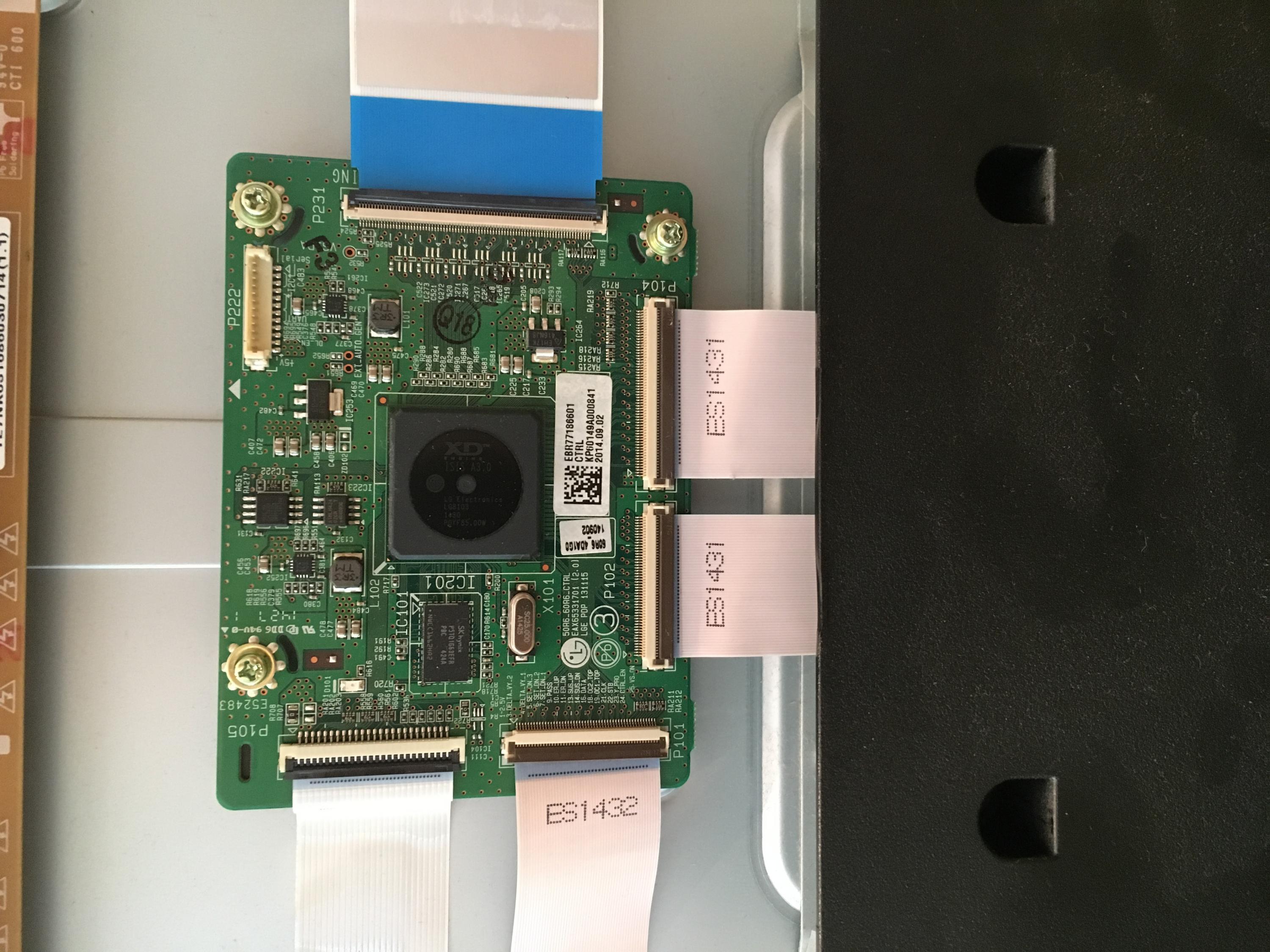

    Hi all - have something that I havent read about on this site.
    Have this LG thast has no video, bad Y-upper buffer (at least).
    However, when turned on - the green light on the Logic board (EBR77186601) never illuminates, no blinking either. I know the light works as when I probe it in diode mode it come on.
    Would a bad Y buffer and/or Ysus keep prevent the Logic board from coming up? This even happens when I disconnect the logic board to try and jumper EXT_AUTO_GEN (also no test patterns) - never does the light come on.
    Where to begin?

    Re: LG Plasma 60PB5600 Logic Board no light
    Is the Logic Bd. getting 5V from the Y-SUS Bd?
      ES1432 flat cable seems to not be connected properly
        P231 does'nt look like it is connected properly either.
