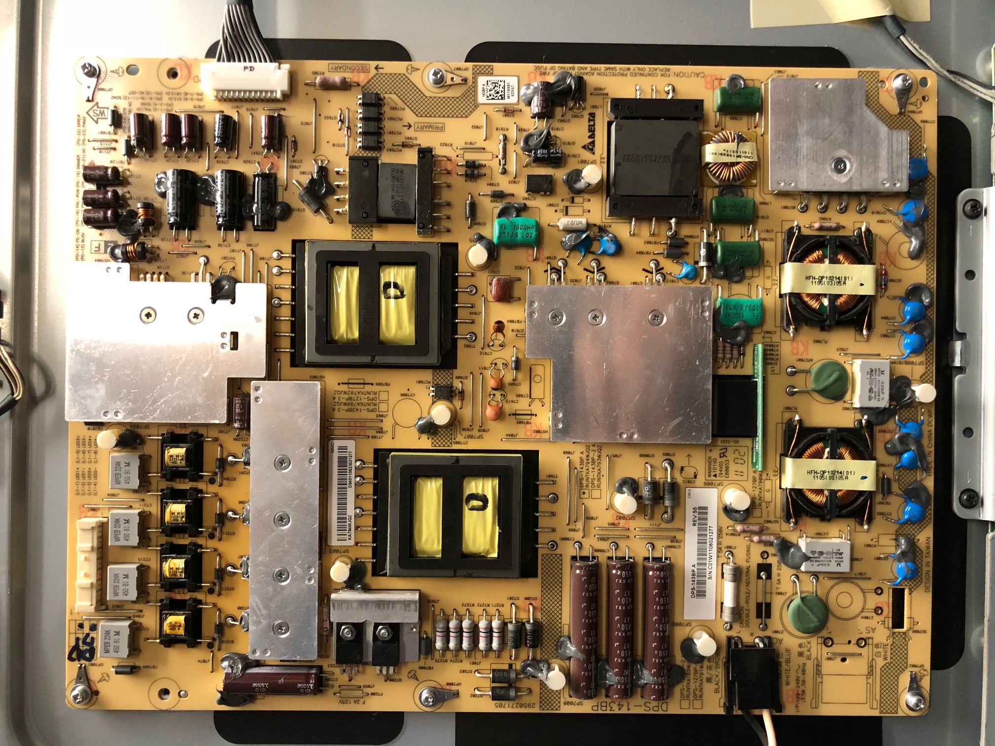

      How about the Voltage readings on the LED- (Cathode return) for each LED -? You will have to leave the probe on the pins while turning the TV ON.
      Pictures of the boards an what we are dealing with?

        Re: Sharp LC-52LE830U no backlight
        Here is the board in question. Just did this test. Plugged in, lamp error flash. Meter on LED1+, 0VDC. Leaving probe on LED1+, did a force start. Meter stayed at 0VDC. Tried on LED2+ as well, same thing.

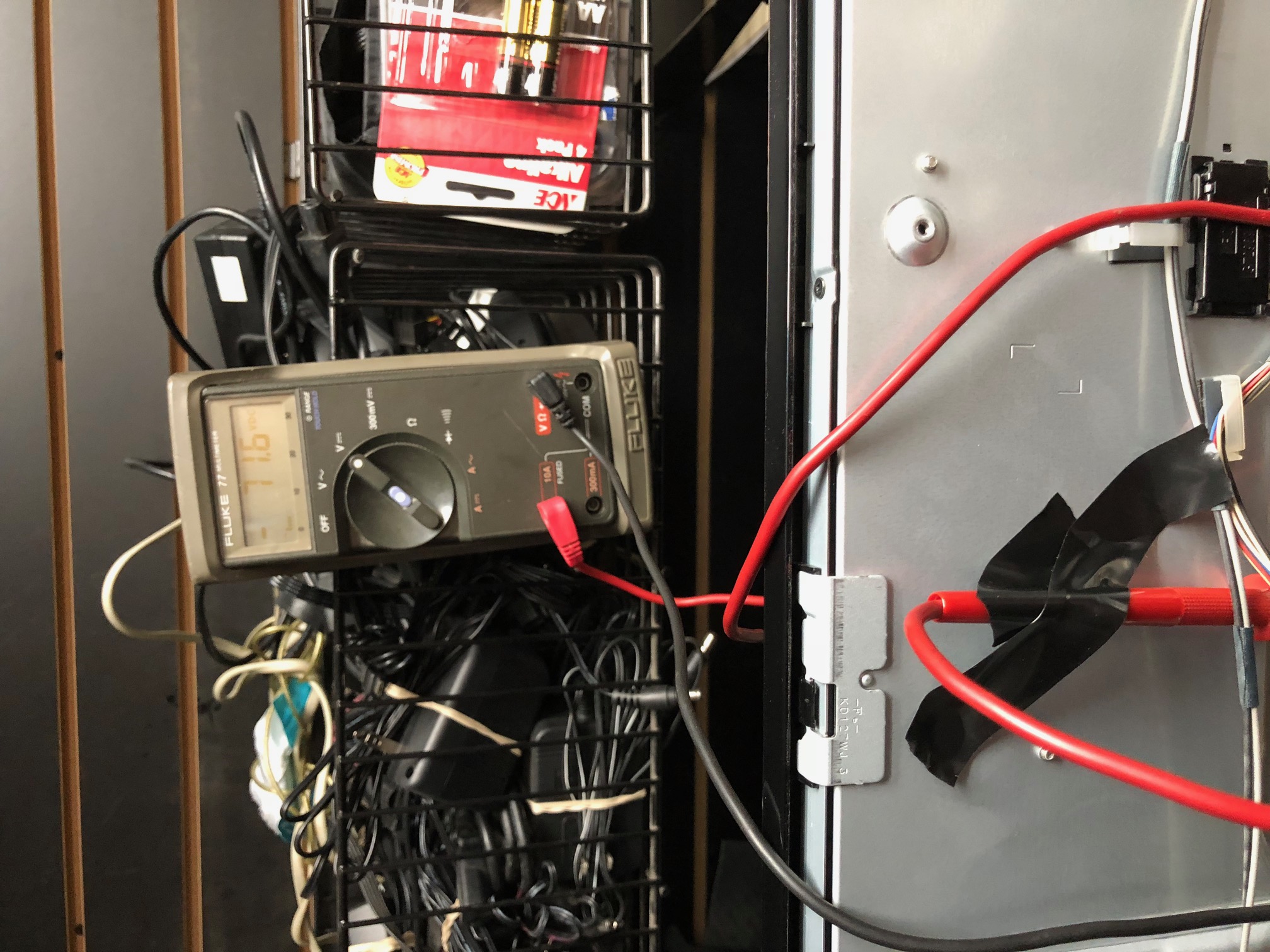

              You need to leave the probes in place before tuning on the TV, then you will watch the meter to see how high the Voltage jumps up to when the TV is turned on and how low it goes down to after 10 seconds.
                Okay, did it again. These readings are going from lamp error state to forced start up state. Probes are set on pins from the get go.
                LED1+: Takes 3-5 sec from the relay click to jump to 140VDC for a second, then starts dropping. After about 10 sec, its around 20-40 VDC and still dropping.
