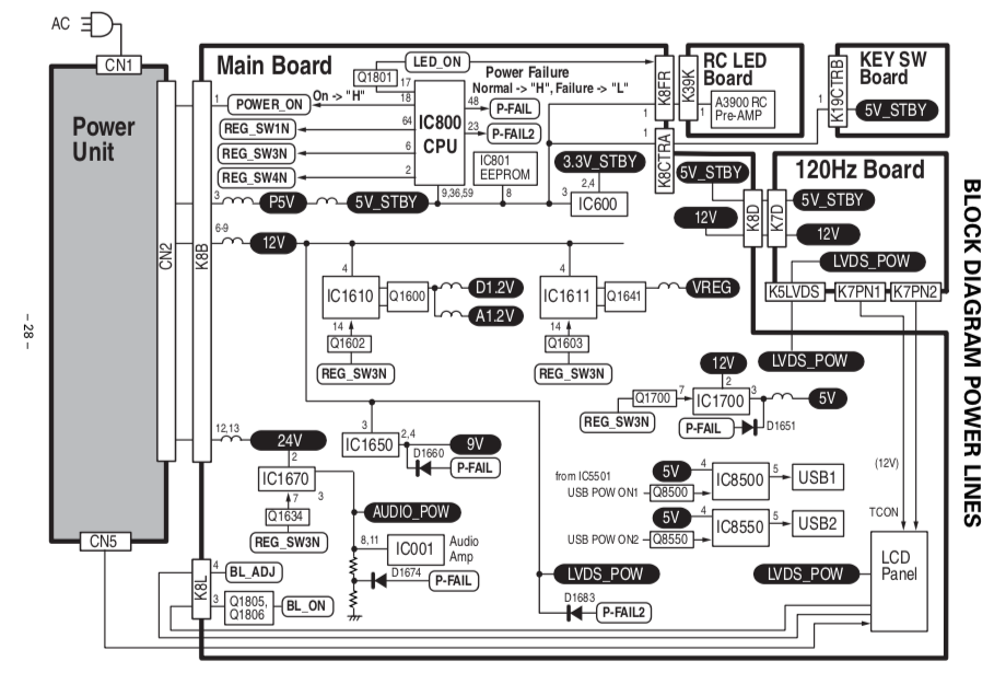

      Re: Sanyo DP55360 shuts off
      Would that be the IC001 in the lower left of this scan?
      Is there a way to test the amp or a direction you could point me in to find out how?
      ...or should i just look for a new/used board
      • R_J
        • Jun 2012
        • 9588
        Have you checked the voltages from the power supply? are they within spec and do they drop when the fault occurs?

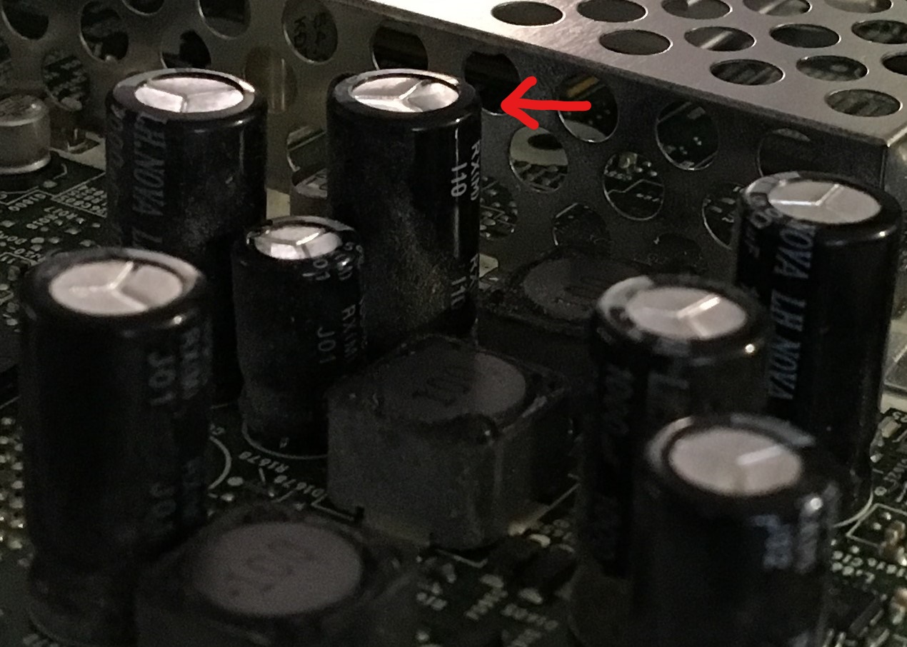

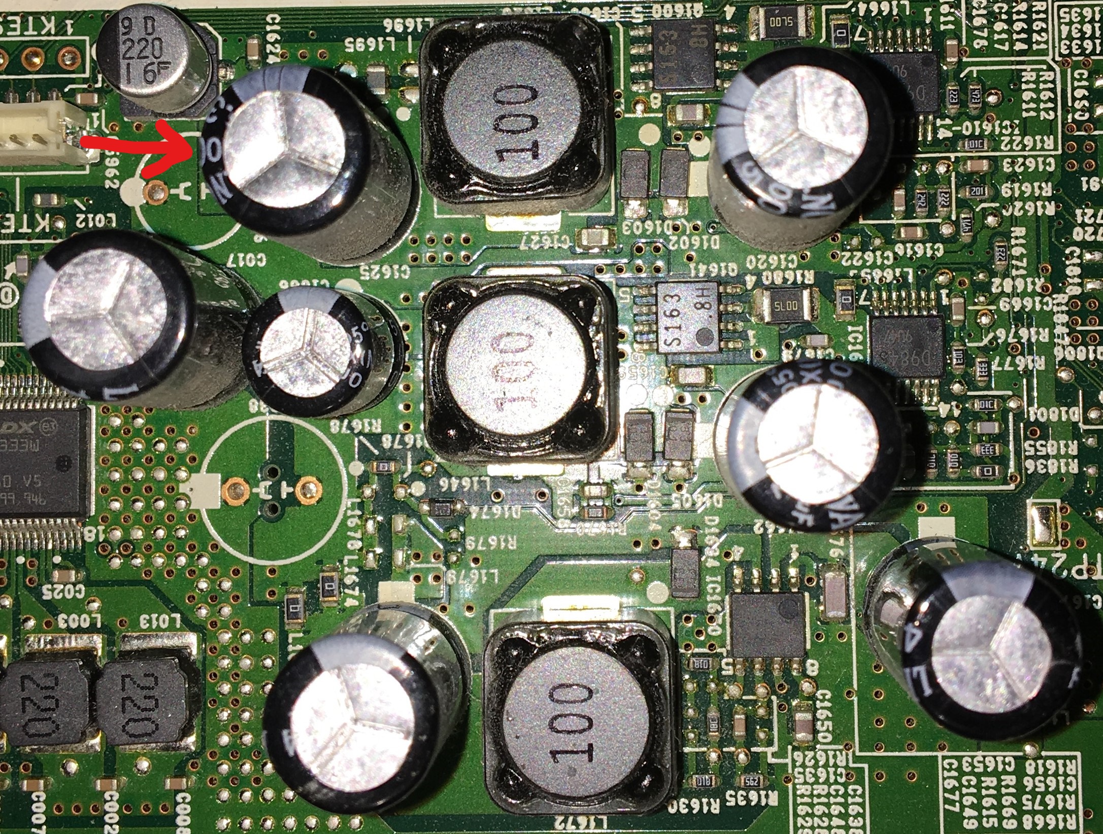

          At this point it turns off within 3 seconds of powering on. So I can't test the voltage.
          After a visual inspection of the boards, this cap is the only one that looks a little bloated. Hard to get a good photo, thoughts?
