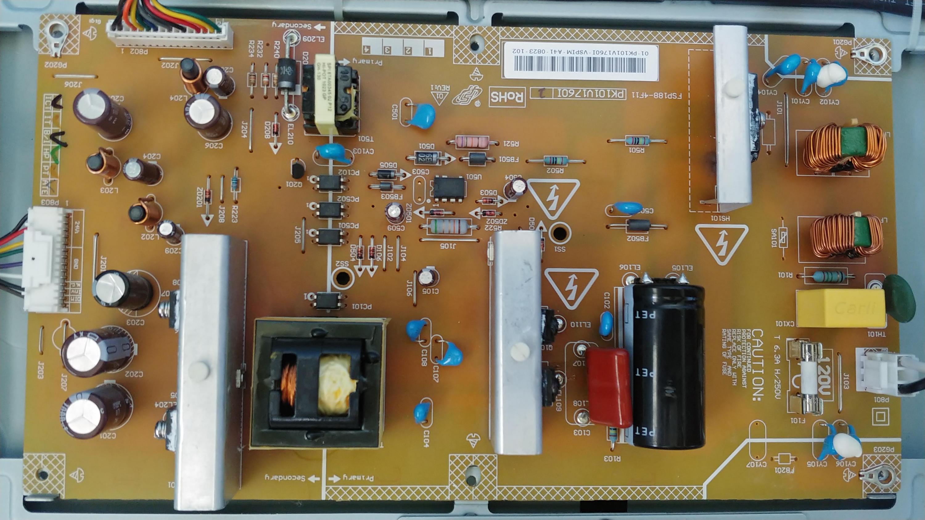

    The power supply board is labelled as a PK101V1760I(2?). Also, FSP188-4f11. The board appears in good shape. The caps aren't bulging, so no easy solution there. Any help is appreciated!
    Re: Toshiba 40FT1U

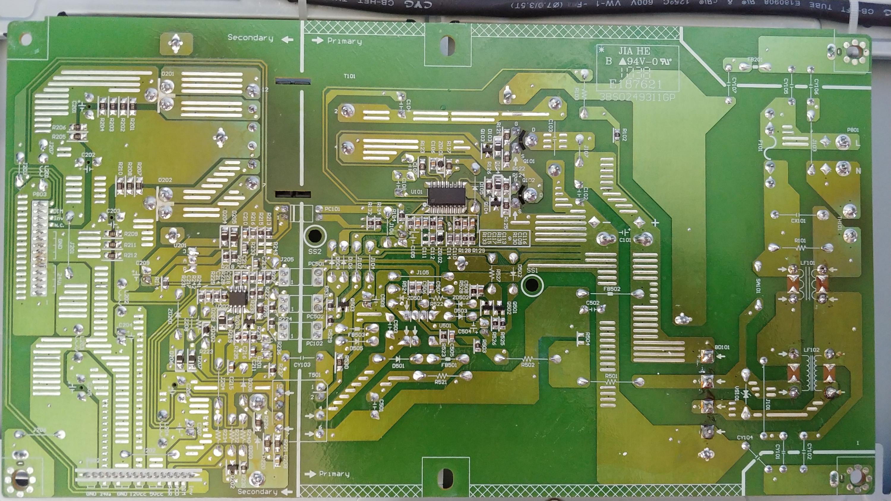

    For us to help we will need good clear pictures of the whole backside of the TV showing all the boards, and the straight shot pictures of the whole top and bottom side of the power supply board so we can read the printed texts on the board.

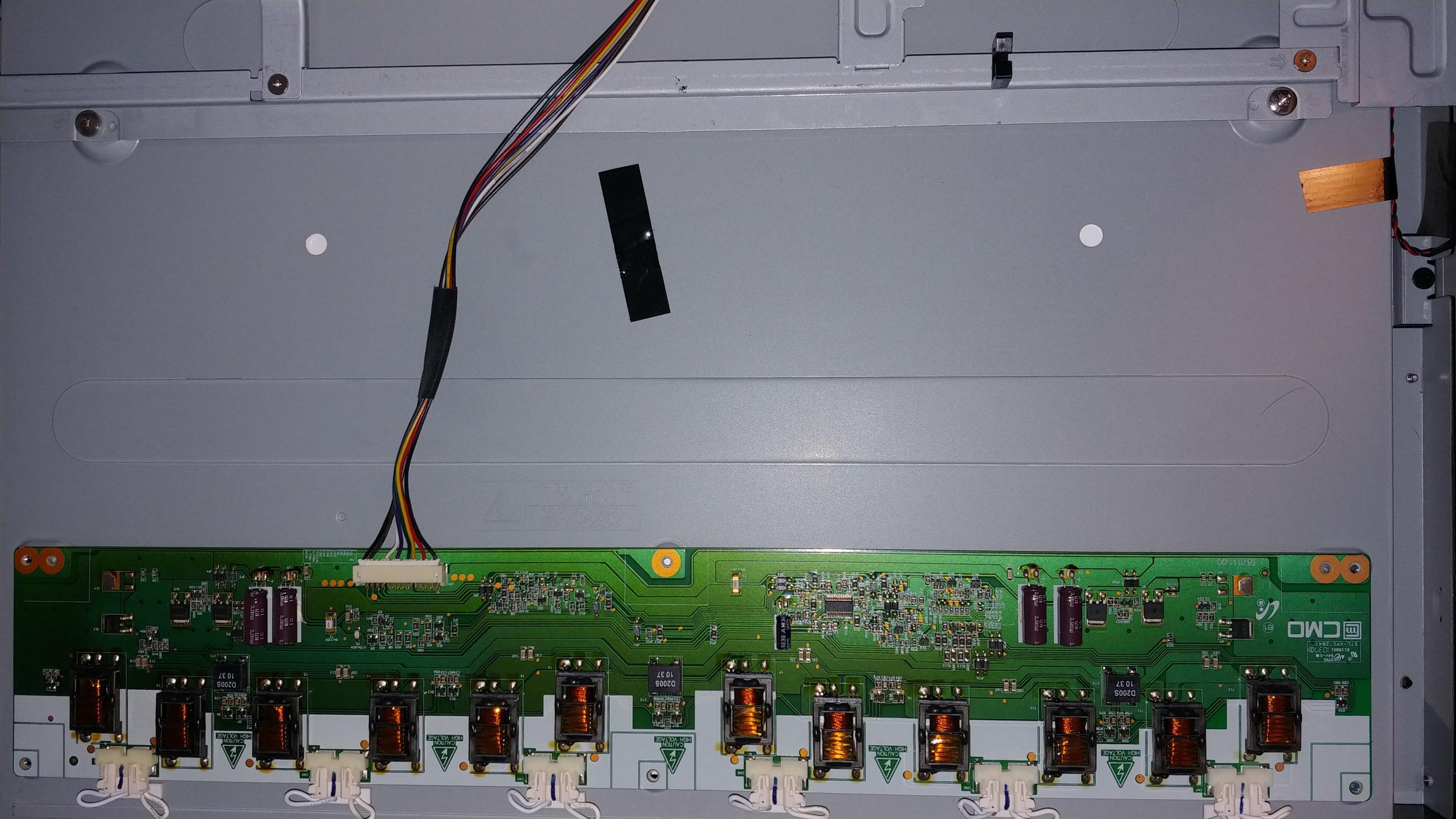

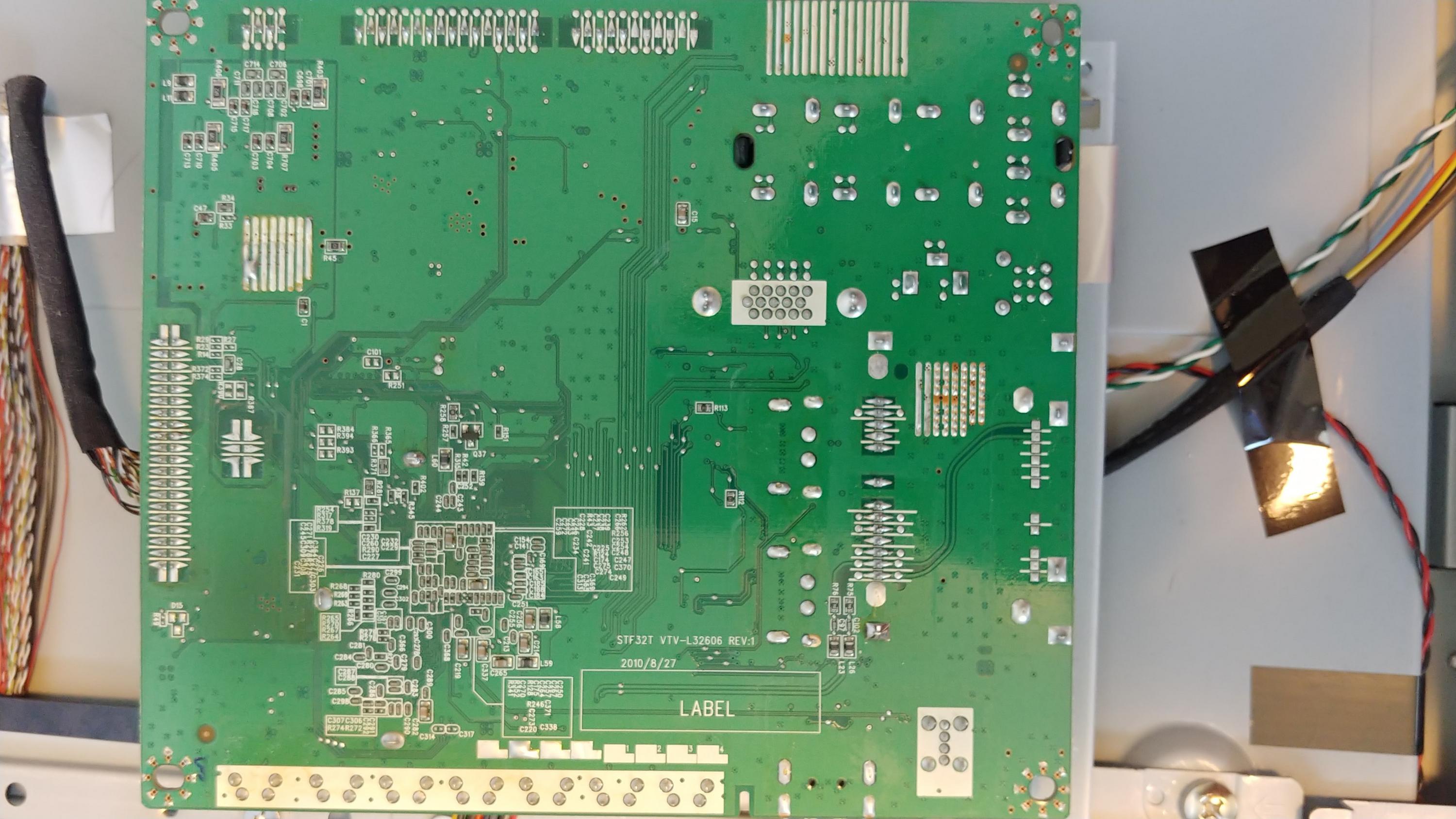

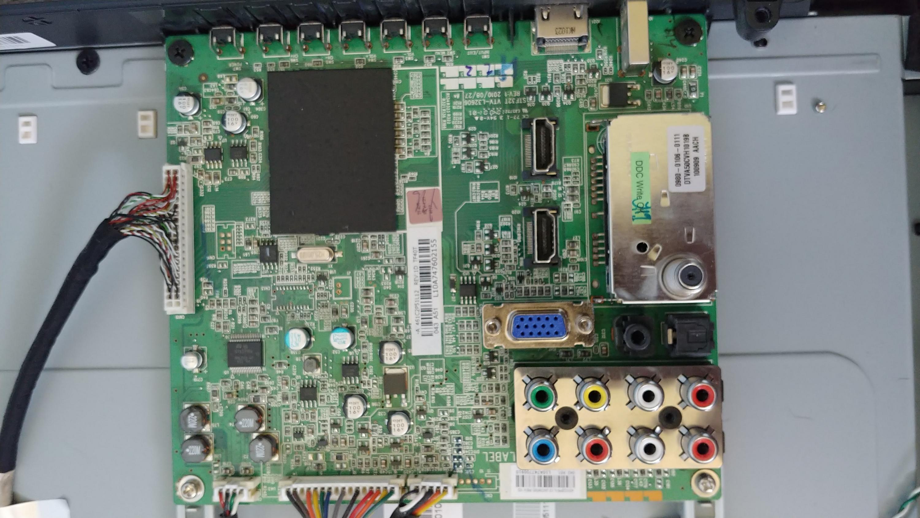

        Re: Toshiba 40FT1U
        I have attached pictures of all boards. The set has basically been a PC monitor that has been on since purchase in 2010. It was used as a server monitoring station, running chrome on an auto-refreshing page showing the status of various servers. I came in last Monday, and the set had a standby light on but had no display. I pressed the power button and nothing happened, then I unplugged the set and plugged it back in, and the standby never came back. There has not been any attempt to repair this set outside of my tinkering, which includes disassembly and probing.

          If the power supply is giving a good standby, the main should output a power on voltage back to the power supply.
          I see an eeprom U17 on the main board between the lvds cable & crystal, if you have freeze spray or use inverted canned air, try this:
          Unplug the tv, freeze the ic, plug in the tv and press the power button.
          This sometimes will work to turn the tv on, indicating a fault with the eeprom ic.

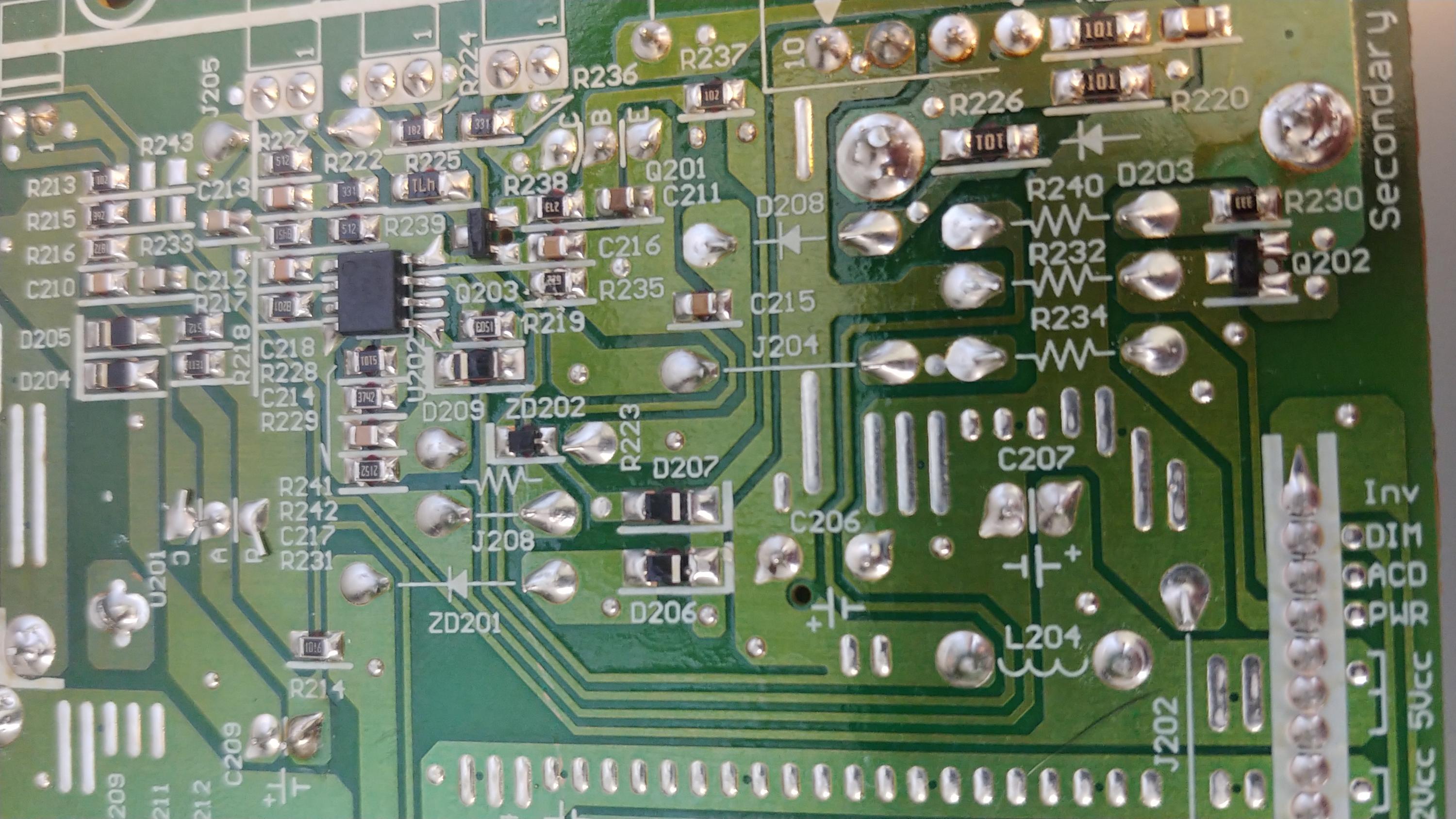

                        What's the resistance of the PWR pin to Gnd pin at the main board with the power supply disconnected from it.
                        Can't really see the tracks to clearly from the photo but does the PWR pin connect back on the main board via resistor R234 and jumper J204 to Q203 which in turn is connected to the opto-isolator PC502?

                          Re: Toshiba 40FT1U
                          4.95kv is resistance from gnd to pwn on main board
                          That is indeed the path. I've attached an isolated image of that area.

                            It would be 4.95K ohms not K volts.
                            Can you measure the dc voltage on the 3 pins of the transistor Q203 and at pins 1 & 2 of the opto PC502 at switch on and when bringing it out of standby
                                My bad... I just got excited :-D
                                For transistor Q203 top pin, I get 5V, left pin is .2mV, right pin is -.2mV
                                For PC502, 5V on both pins.
