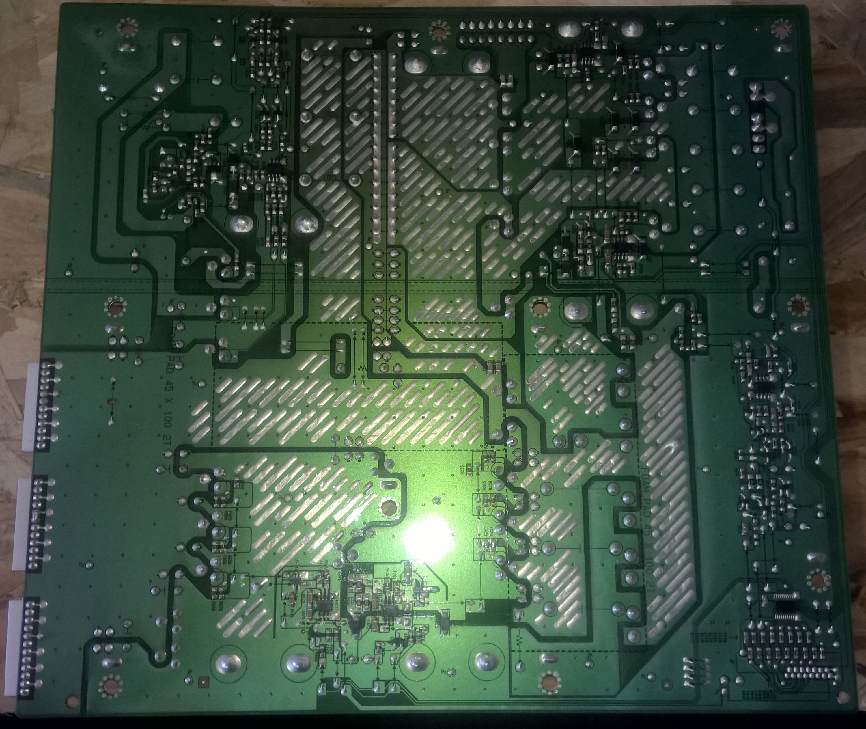

                                  No bad caps found. Guess i'll be recapping it next year maybe... I still noted down all the values and dimensions.

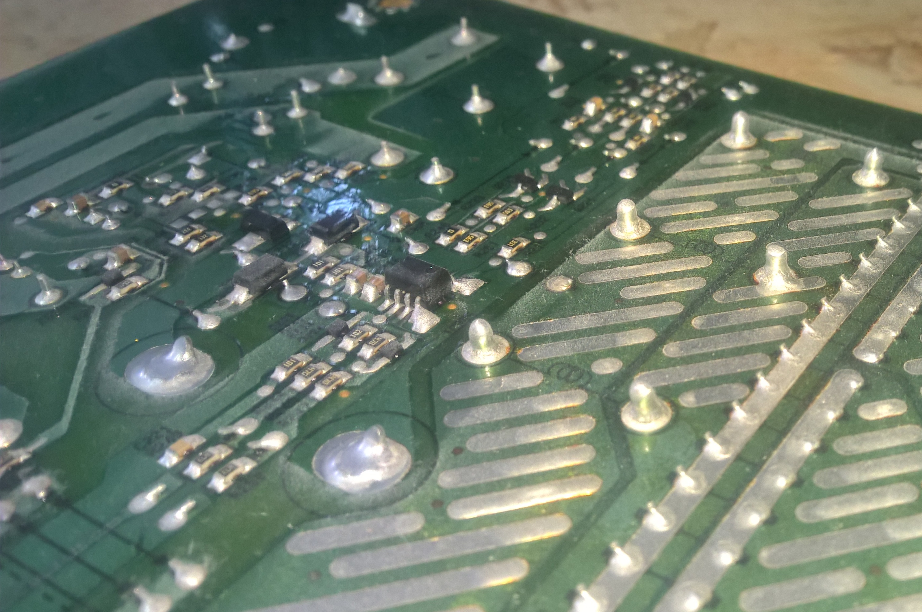

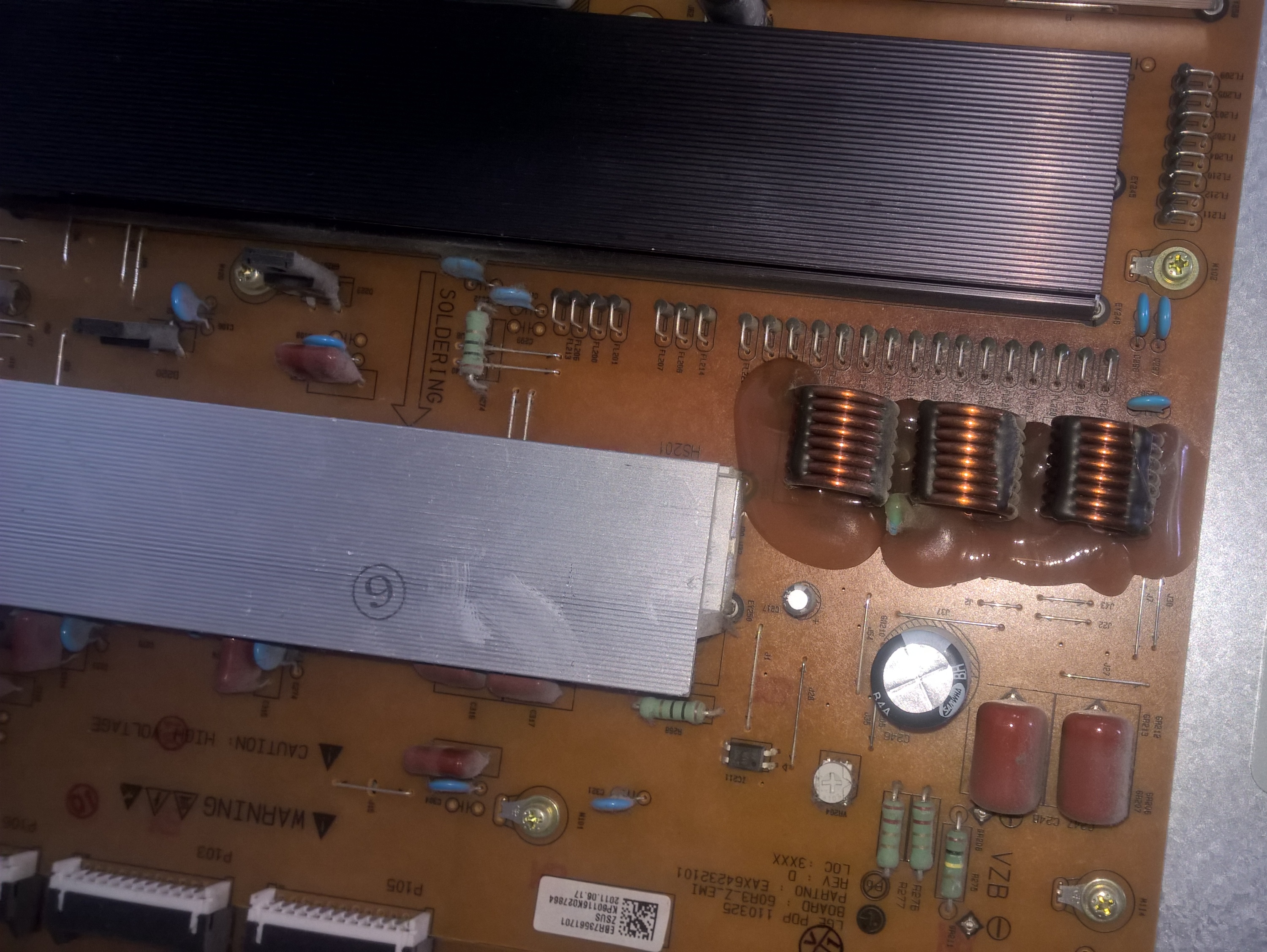

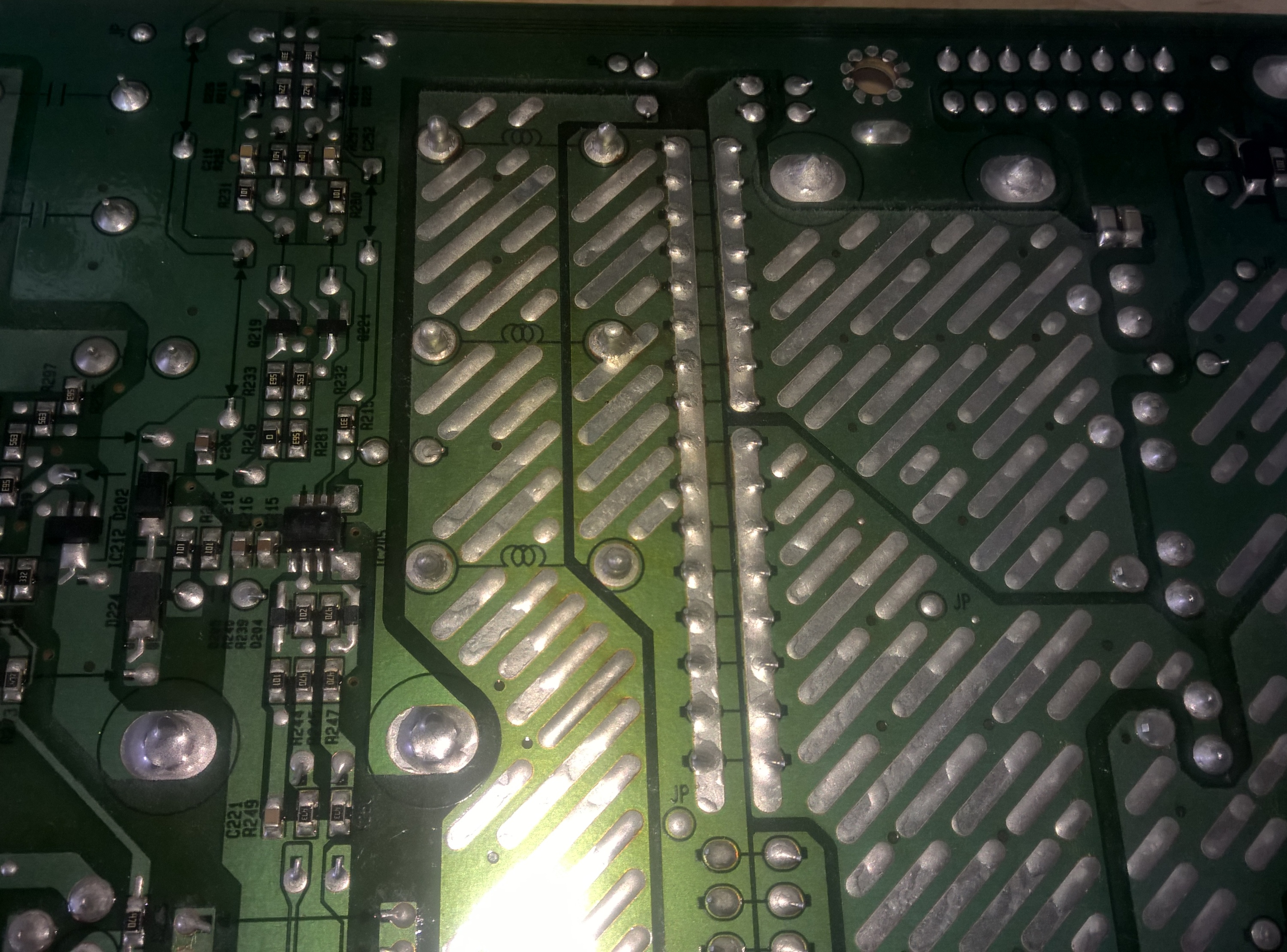

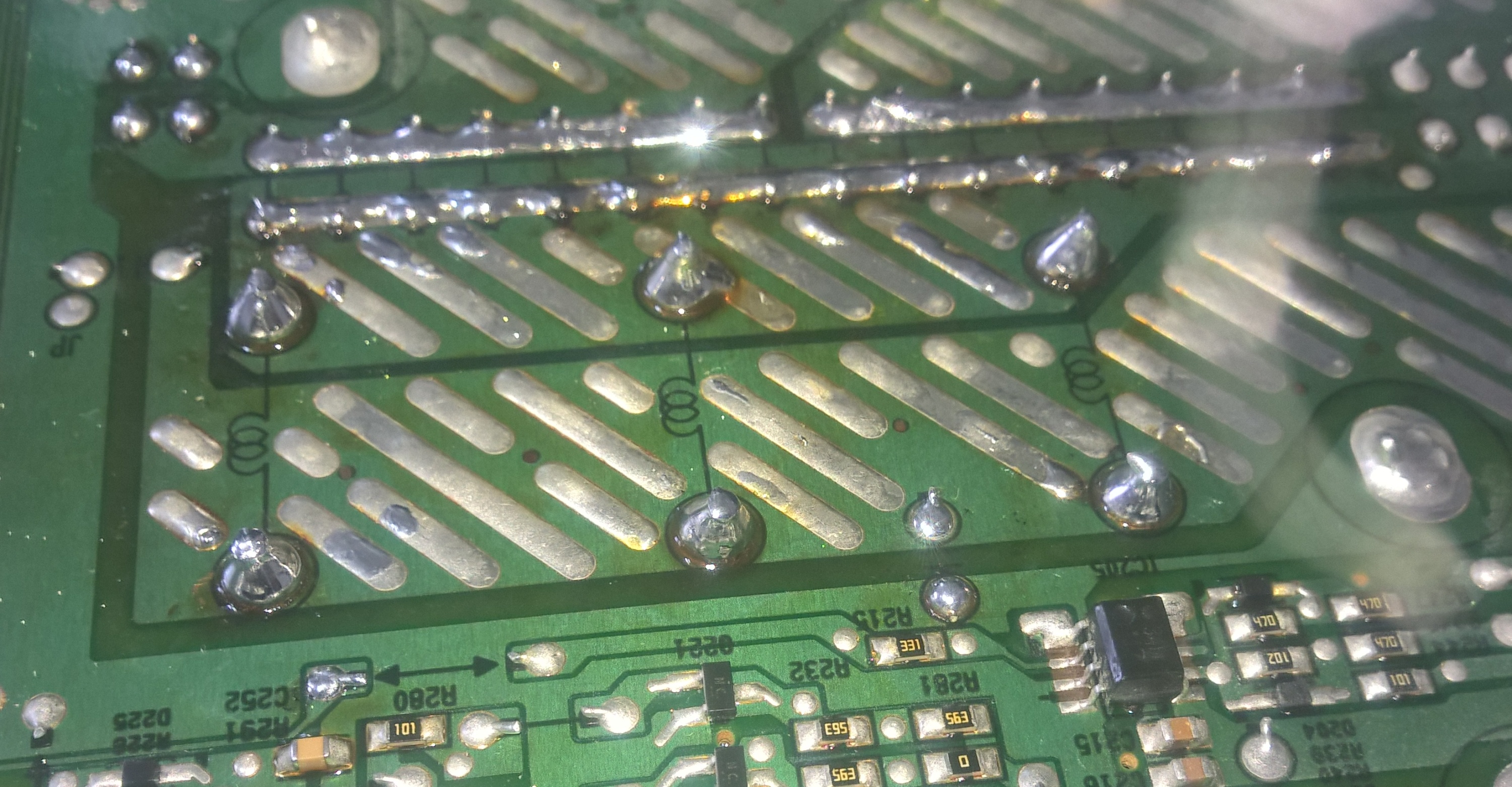

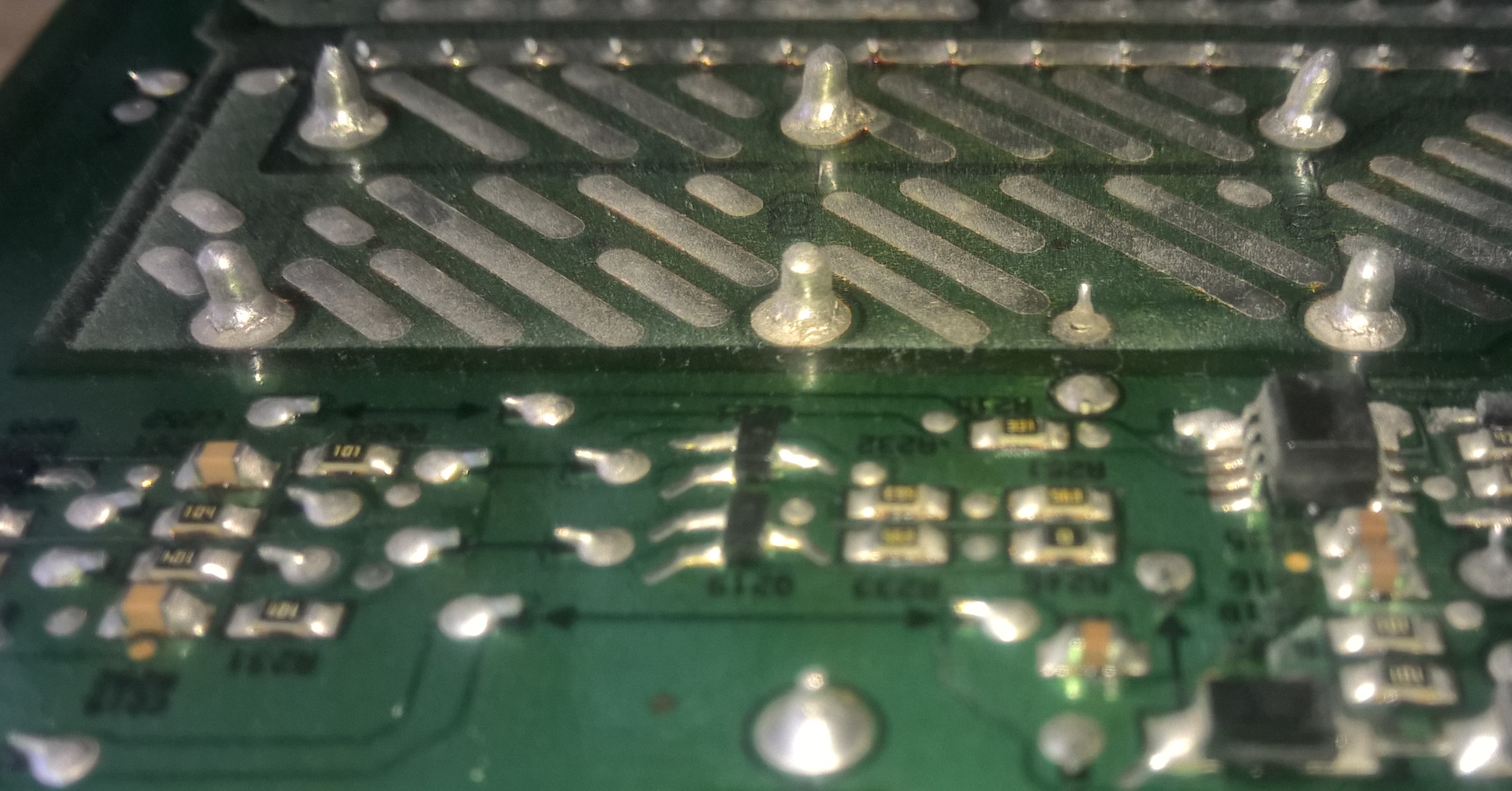

                                  However, you guys were right - the soldering on the Z-Sus board, especially those large inductors, was HORRIBLE. I have redone a lot of soldering on both the Y-Sus and Z-Sus. A few interesting things have happened however, not all of them good.
                                  The voltages measured on the power supply and the Y-Sus were close enough to the panel sticker but a little low. VZB was almost spot-on at 109.8V (should have been 110). Well, after resoldering the inductors, VZB came up as 120 volts! I had to turn the trimpot down quite a bit to get it back to 110. It looks like the solder cracks on those inductors have not developed over time, they were bad since it was new, and the board got calibrated like that!
                                  Did all other voltages too as per the panel sticker, will tweak for black level later, because now i've got another issue on my hands...
                                  The picture doesn't start bouncing anymore (which is good), however, after a while of running, I start getting a lot of green and magenta snow in near-whites and the colors get washed out. Have reseated cables and resoldered more connections to no avail. It is definitely heat related so i'll go and get myself a can of freeze spray to troubleshoot this further.
                                  It does so a lot later if the back panel's on, guess it helps spread the heat somehow.

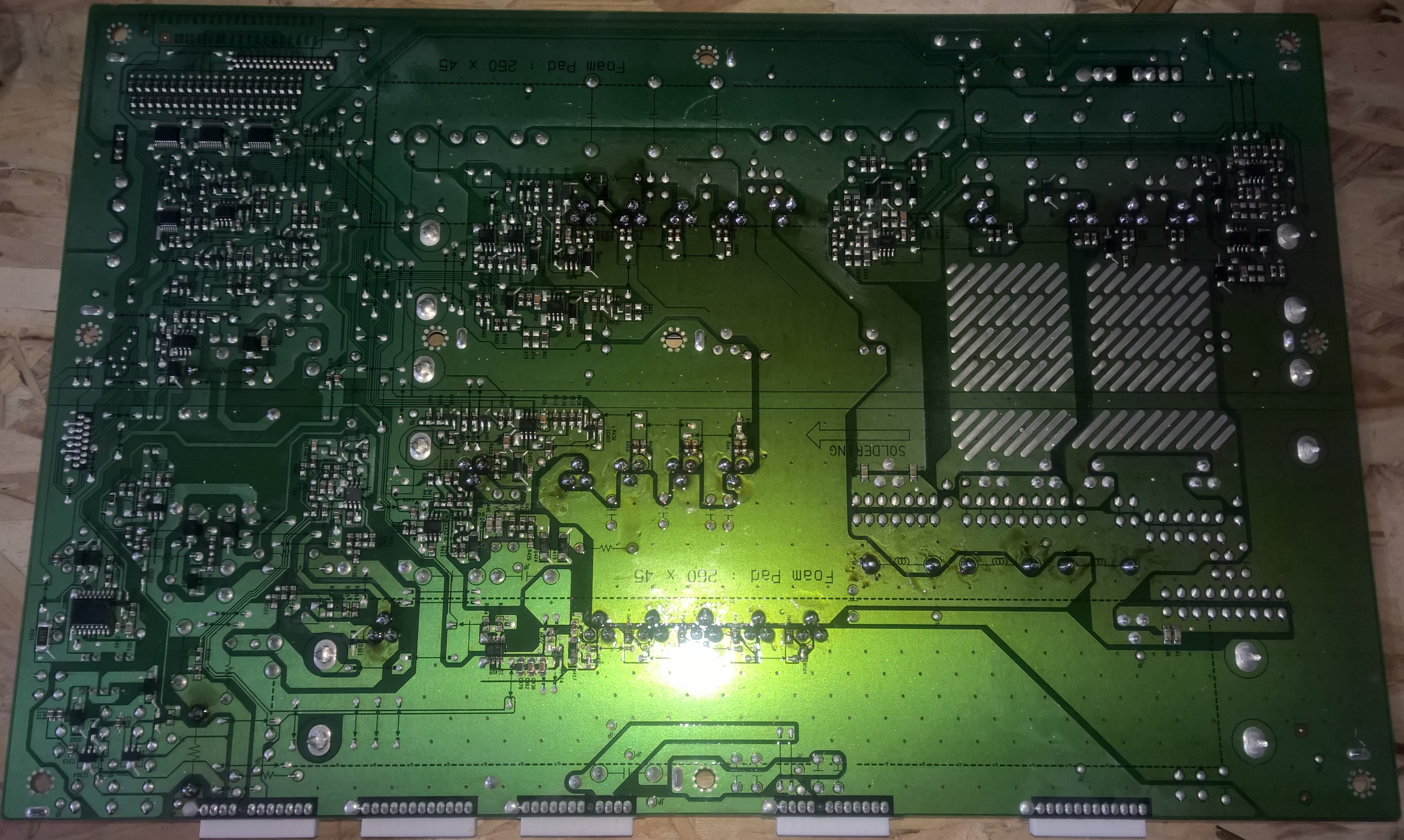

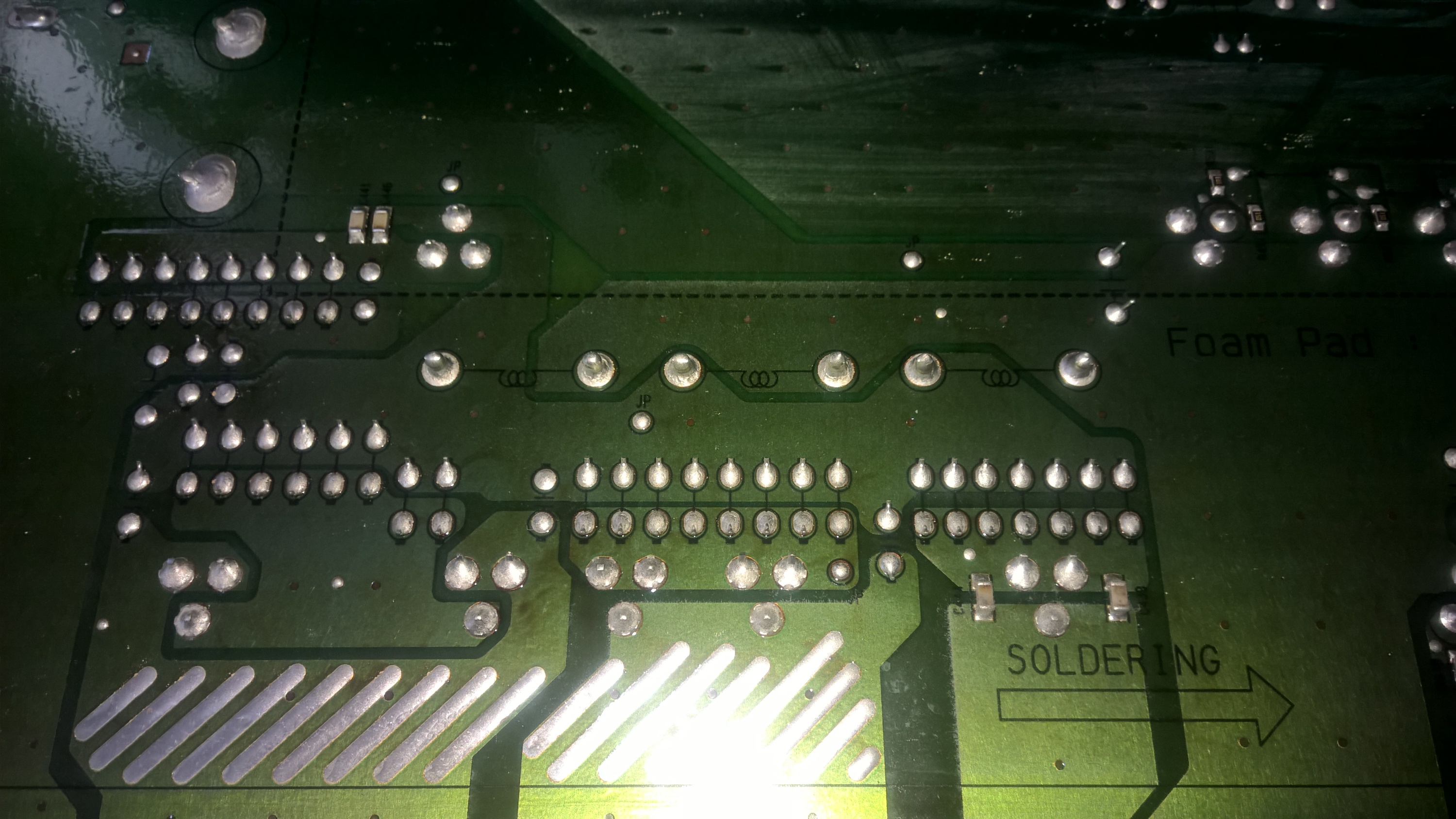

                                      Here's some photos of the boards and the resoldering work i've done on them. Especially on the Z-Sus, that's some horrible wave soldering there, LG. Shame on you.
