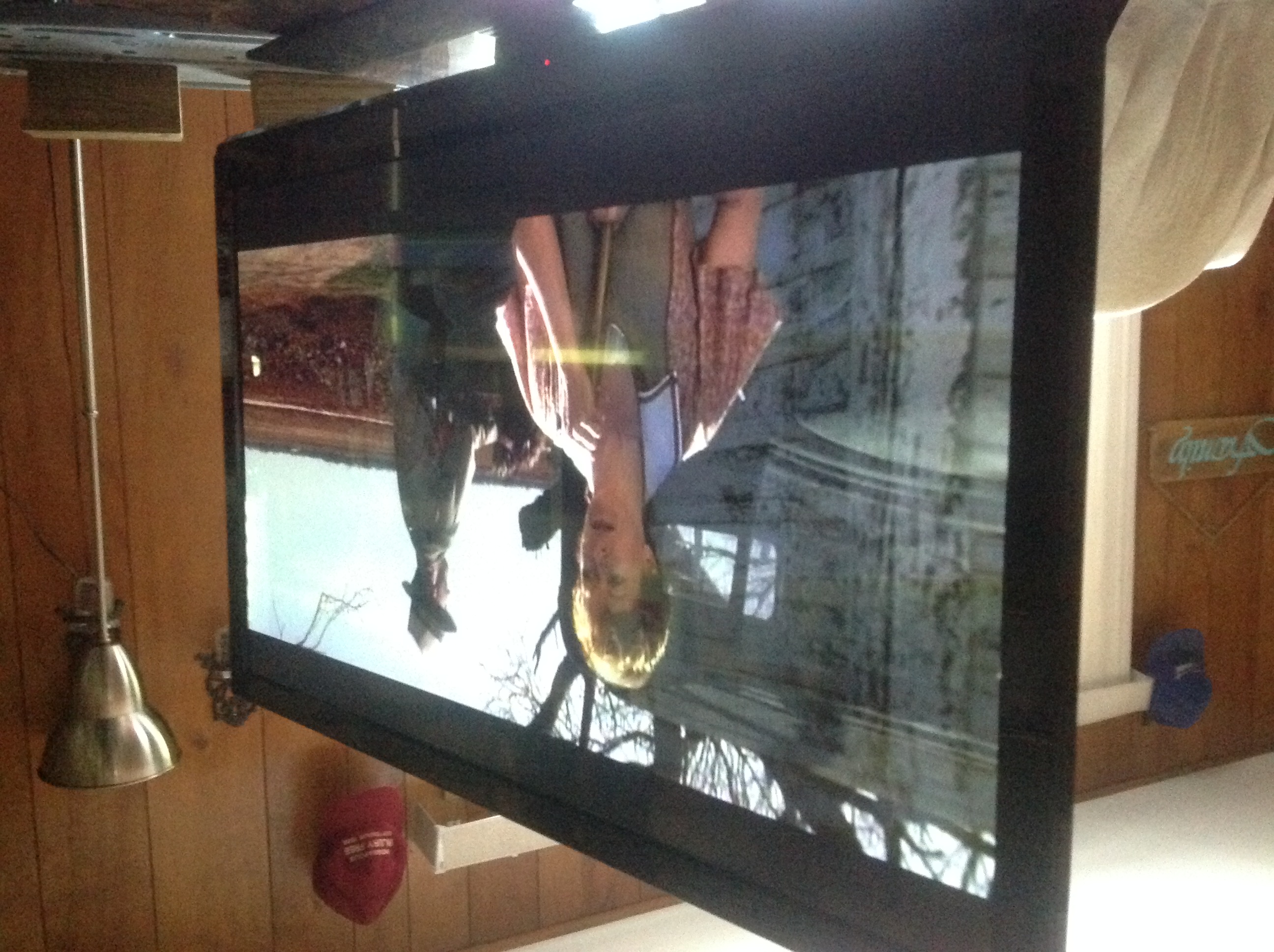

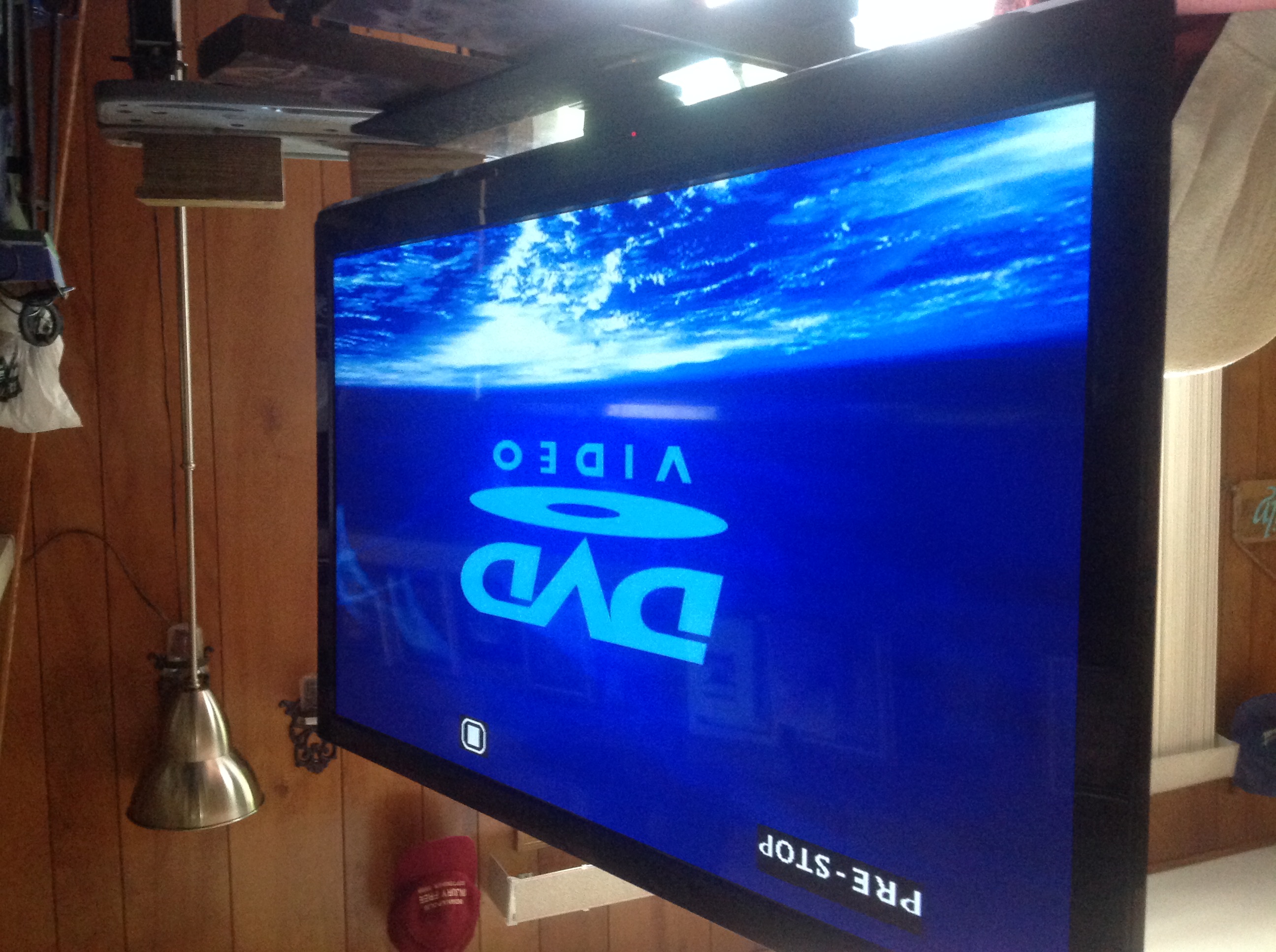

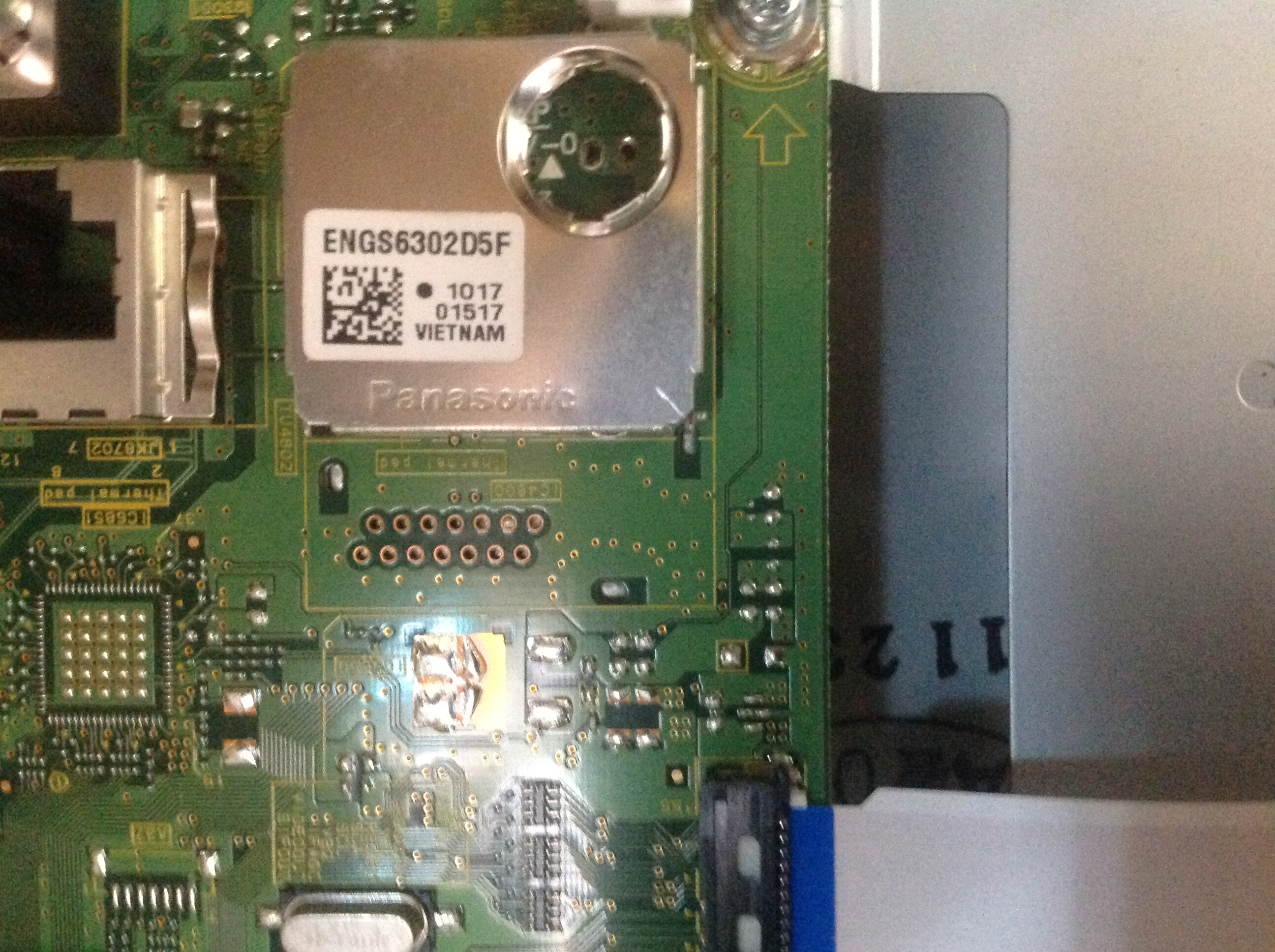

                        Re: 2011 Panasonic TC-P50S30 IS DEAD
                        Good news, bad news. The board arrived today with the threaded cable end torn out of the tuner. The end was not in the box either. I installed the card to see if it fixed the tv...tv plays perfect! Whoopie!
                        Bought through eBay from TVPARTSTODAY for $54 and change. No shipping through eBay.
                        Question: do I go through the hassle of sending it back through eBay for a replacement and hope it works (if it doesn't they'll make it good, just like this time) or should I do a little soldering and put the tuner from my old board on the new one? Opinions please
                        • budwich
                          • Jul 2015
                          • 3097
                          #72
                          glad you got the "basic tv" working... too bad about the board. IF you aren't using the coax section, I would forego doing anything on it and just ask for a refund of $15-20 perhaps. I guess it depends.... is shipping returns free? Having said, are planning to sell ultimately sell off the set... then you might want to get a fully functional board.... regardless of the time, you know that the set is operational at this point... so you are playing with "panasonic money"... :-)
                          • Andrew F. Ali
                            • Jan 2014
                            • 2450
                            • Trinidad & Tobago
                            #73
                            Great news. We suspected the Main Bd. from inception. If the return is free I'd send it back and ask for another board. If the TV is for your personal use and you will not be using that input, check the other inputs especially the input you'd be using and see if it works You did pay for a whole working board so ask for a partial refund then Send pictures of the damage to the Supplier,as well.
                            • notch8
                              • Jul 2018
                              • 63

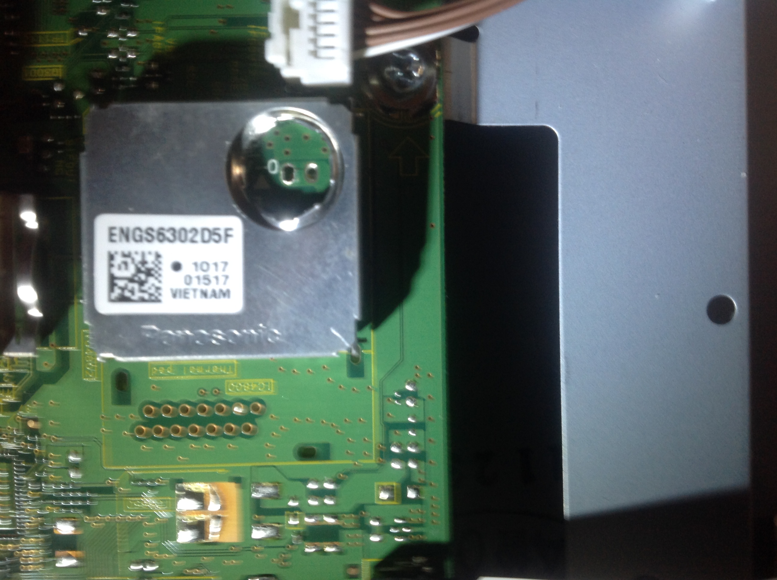

                              #74
                              I don't have cable, I cut the cord a year ago , I have an outside antenna and I need the coax jack to watch local programs. I've checked the composite jack on the new board with a DVD player and it works, don't know about any others.
                              So the basic question remains, exchange tuners off of boards myself or exchange the board for another and hope I get a good one. I doubt I'll get a discount if I keep the damaged one.
                              I guess what I'm really wanting to know is, should I go to all the trouble of changing the tuners myself or send it back? I definitely need one that works.
                              The tuners have the same part number , I'll attach pics of both.

                                #75
                                Just swap the tuner , cant get any worse.

                                    #77
                                    Why not swap the tuner? It would have worked....
