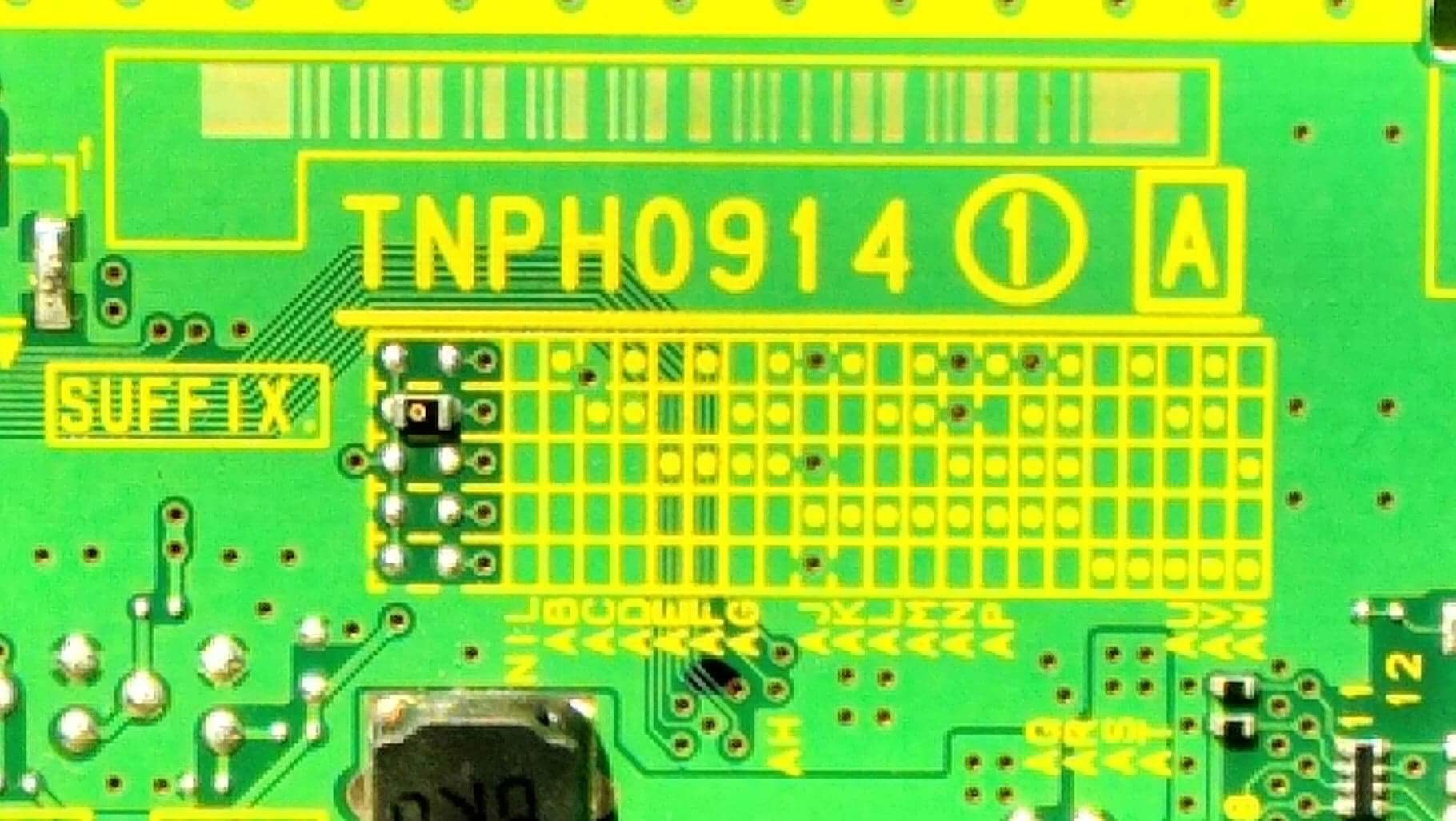

      the "no front panel led" is still rather "funny" in that based on the standby chart 24, it would appear that there is very little to get in the way for the led to light assuming the standby voltage makes it all the way.
      I hope you find a replacement card that is correct.... i think my set has the same card. My guess would be you have an "AN" card based on where the "resistor" is on the "chart"... but I that is just a guess.
      IF I understand this link correctly http://www.usefulparts.com/images/gf...nic-suffix.jpg
      then my guess would be AL .... :-)
      fun with dots... :-) after looking some more... I think it AC.... the first single dot in the row with the resistor pack.

        Can you elaborate on your deduction of AN. I just can't see how to deduce that. Also ic5000, pin 29 is shorted to ground.

            The led is supplied with standby 5v but it looks like it is driven directly by the peaks ic on the A board.
            I would suggest the suffix is AC. With only one resistor in place in position (2)
            to be a AN would require no resistor in position (2). and resistors in positions (3) and (4)
            I think shopjimmy suggests TNPH0914AC, TNPH0914AS, TNPH0914AK would work?

              fun with dots... :-) after looking some more... I think it AC.... the first single dot in the row with the resistor pack. This aligns with shopjimmy which shows an AQ card which has three resistor and then the corresponding first "set of three" that aligns with that configuration is AQ.
              ooops... I see RJ has already "corrected" me.... good.

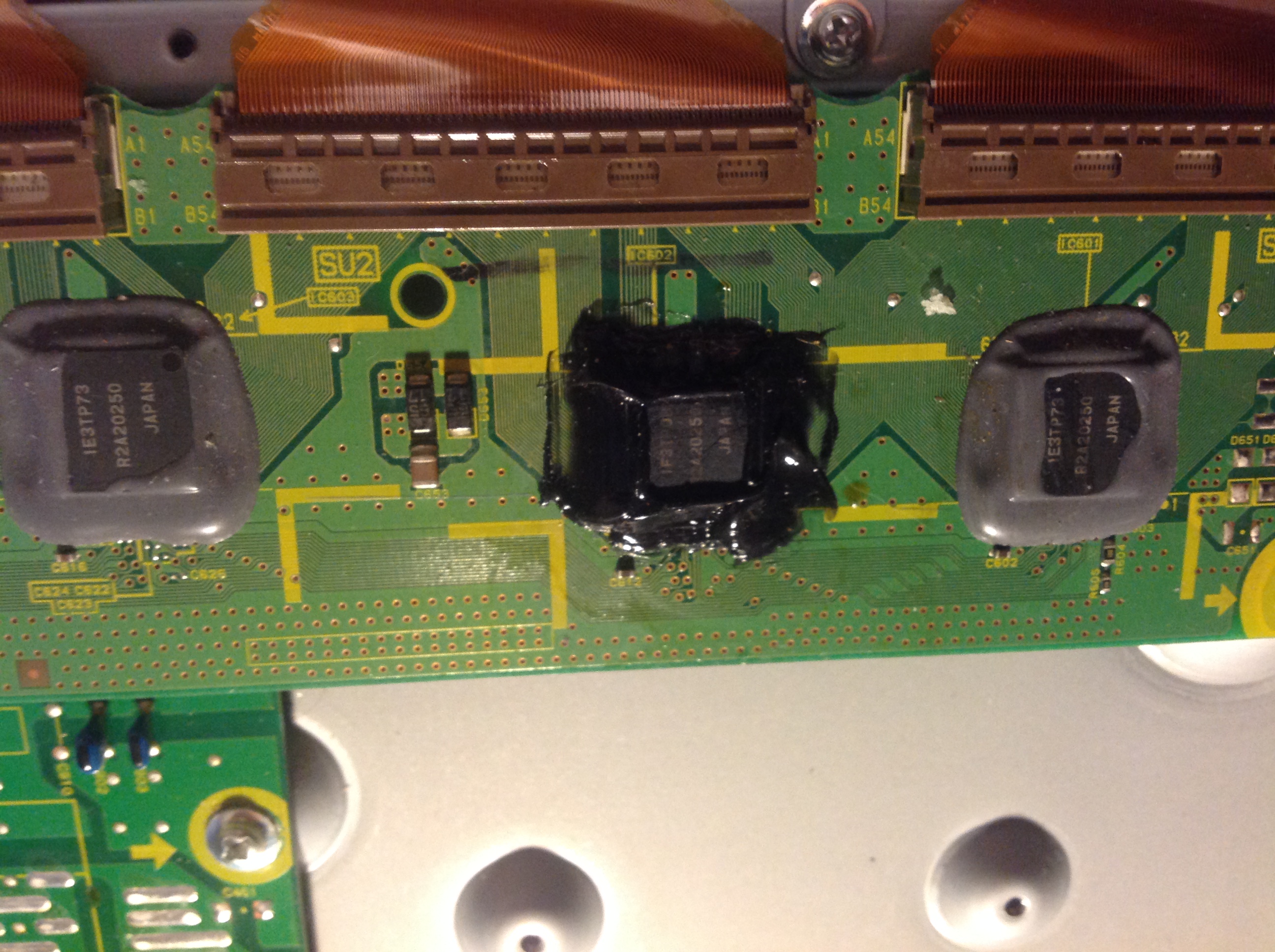

                    Yes the best bet is to get a replacement Main Bd. if you can. Did you measure the Vs to GND resistance on the SC and SS Bds as I suggested?
                    • notch8
                      • Jul 2018
                      • 63
                      #50
                      Re: 2011 Panasonic TC-P50S30 IS DEAD
                      Yes I did with my cheap digital VOM and the readings on both boards went to infinity 1 (with meter set on 20K or 200K) so I figured they were ok. Just for the heck of it I pulled out my old RS analog meter, set on rx1, and tested again. SC VSUS=18.1 ohms and SS VSUS=45.0 ohms. Both tests were done with the connectors unplugged at their respective boards.
                      So, IDK, do I also have SC/SS board problems?

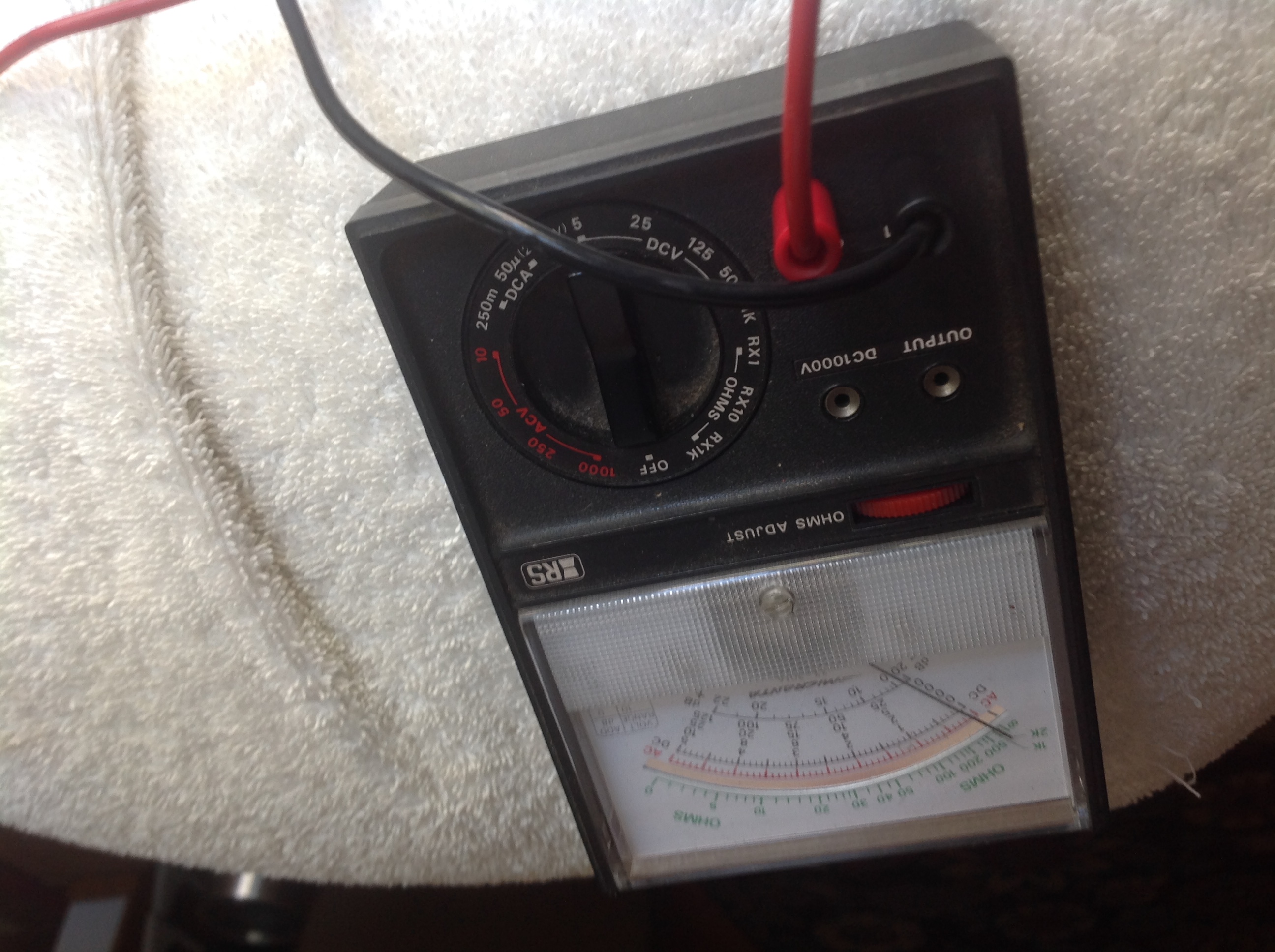

                        I think you want to "toss" the RS meter out... :-)... or at least check its fuses and batteries.
                        I checked my resistance on both sc and ss cards (Vsus inputs).... SS was around 1M and reducing (ie. some form of capacitance) and the SC was 5M and reducing... this was on auto ranging. Note: my SC had shorted components which have been mostly replaced / checked (ie. fets, diodes) but still has some components removed and not replaced yet as I am waiting on the "boat".
                        Its too bad you aren't a bit closer... we could probably "frankenstein" one set together... :-)
                        PS. I would like to add that my RS analog on RX1 doesn't deflect taking the readings... meaning "over".... :-)

                          If the battery and fuses are OK with the RS meter try switching the RED and BLACK leads on the pins and yes RX1 is the setting to use. I still depend on my Analogue Meter for diode and continuity checks even though the Digital Meter can do the same. I am very 'old' school...
                          • notch8
                            • Jul 2018
                            • 63
                            #53
                            Toss the analog....never! We've been together way too long for that. I crossed the leads on the analog and got infinity on both boards. I really don't think there's anything wrong with them. I pulled out my auto rangeing meter, it's still new, bought in '97, I don't like it, I'm old school too. I'll read the instructions again and see if I can get a reading with it. Hey...we're having fun ain't we!

                              yep same meter. I know that my RS has some problems especially in the voltage readings. Anyways, based on your "readings" (2nd ones, maybe...), it would appear that your boards are good. Having said that, the RX1 uses the least amount of power and of course only goes to something 200 which isn't very much when you are looking at K's or M's..... but its always good to work your way up. As for the digital, I have that one also but it only works on a couple of measurements as it was "abused" during its life and has been replaced by a new autoranging unit.
