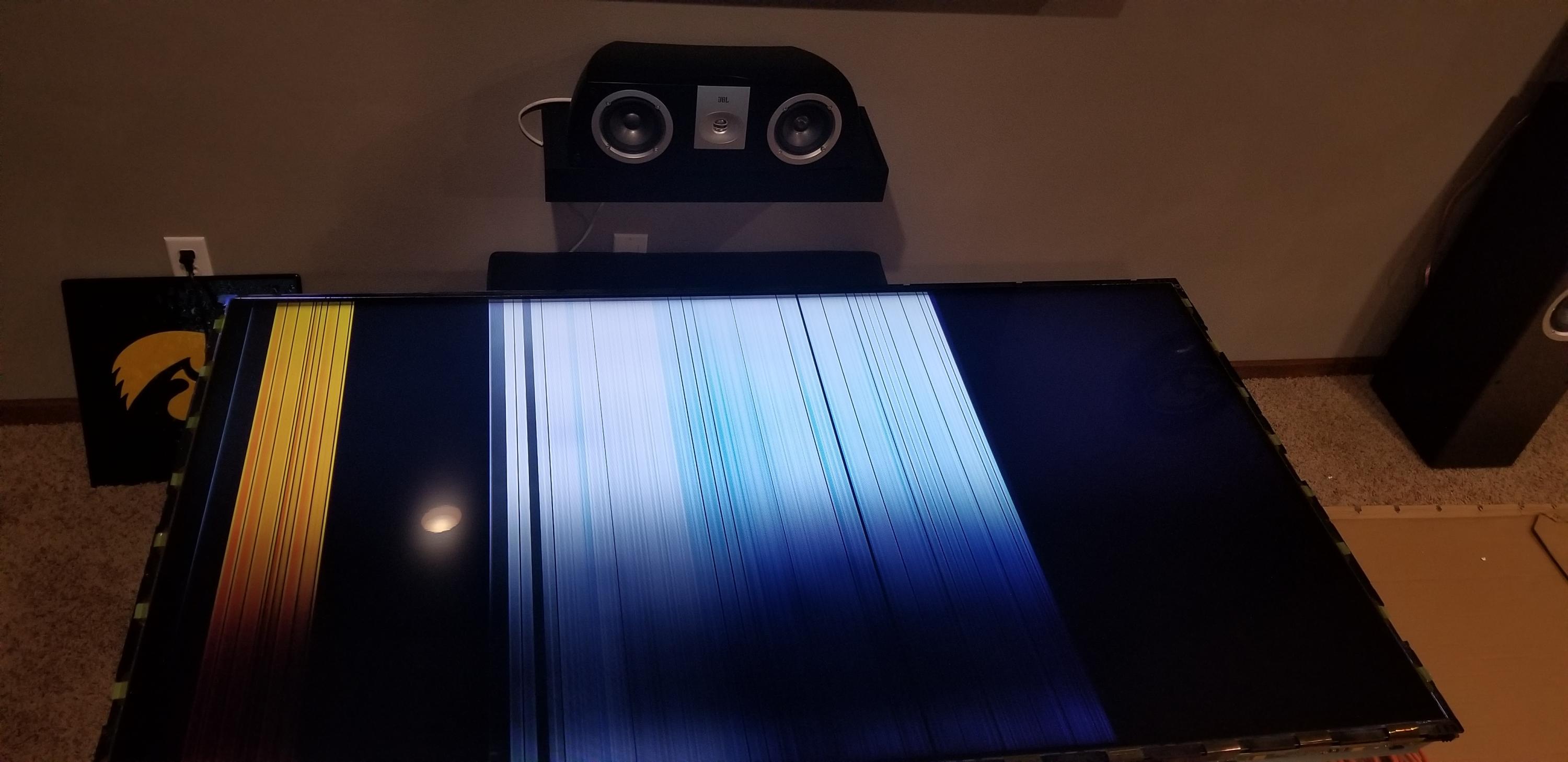

    Hi I received the TV and trouble shot it down to the back lights. I replaced the led back lights and everything was good. I turned it on it worked great. After I put the bezel and the case back on and turned it on again all I get is vertical colored lines. I checked all the ribbon cables and everything is fine. There is a picture attached of what I get now. Any ideas on what causing this? Thanks so much!

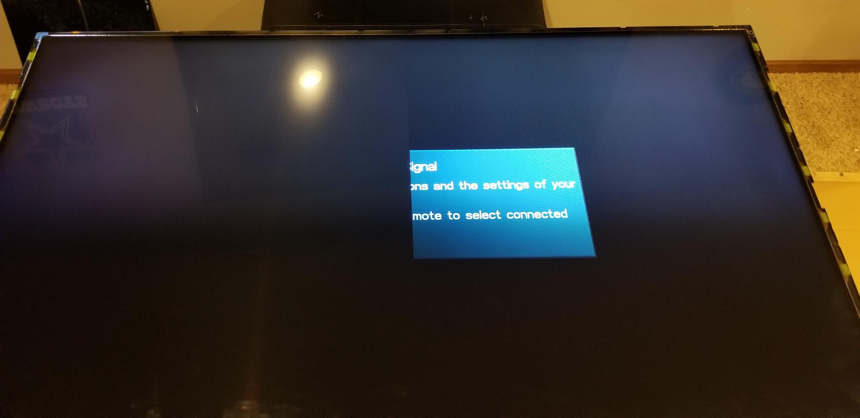

            If you pushed the ribbons back in then the gold connections on the end may be damaged.
            If you disconnect one ribbon from the Tcon and then power up what do you see on the screen.
            Power back down and reconnect the ribbon and disconnect the other ribbon from the Tcon to panel and again see what you get on the screen.

              actually, looking at the picture closer, you lost the leds again. somewhere in your "re-assembly", you caused an issue with the panel connections. since you are familiar with the leds (having replaced them), check the connection going there first to understand why some appear to be gone again. If you are lucky you might find some "localized" issue / connection there. Related to this is how were you manipulating the panel while the frame and bezel were off?

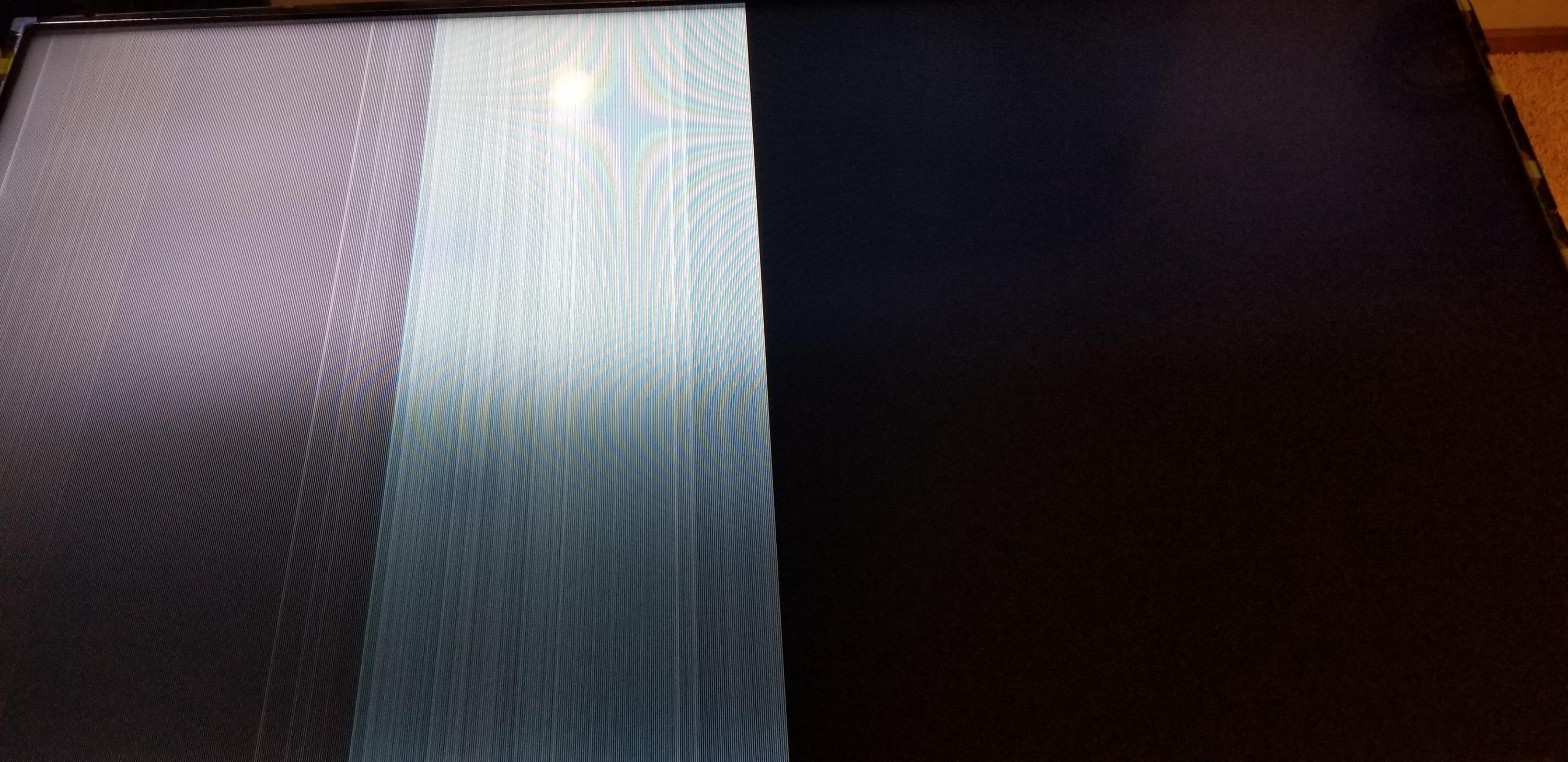

                    Here are the pictures from having one side of the tcom ribbon removed. It looks like that's the issue. But how do I fix it? Thanks.

                      so you need to really really look at the ribbon cable on the "bad side" (ie. vertical lines).... those are indication that no / little signal is getting to the panel through that cable OR thru the edge board that it is connected to. The other possibility is you caused an issue with the edge board... you need to check some of the SMD components in the edge board (capacitors / resistors) to see if they are OK. IF you are lucky, although the board itself can't be replaced, a careful soldering job can replace a given component while the board is still attached to the panel (because it can't be removed).
                      My guess is you do not have the cable set properly in the clamped connector, either the pins are misaligned or the cable traces are damaged.

                            but on a more serious note. it looks like the panel may of received some damage when you worked on it and i'm doubting that it will be repairable.

                              You've detached part of the leftmost tab bond, you miss now of the vertical informations, there is a very thin possibility of repair it, check youtube on "soldering lcd without bonding machine", something like this..
