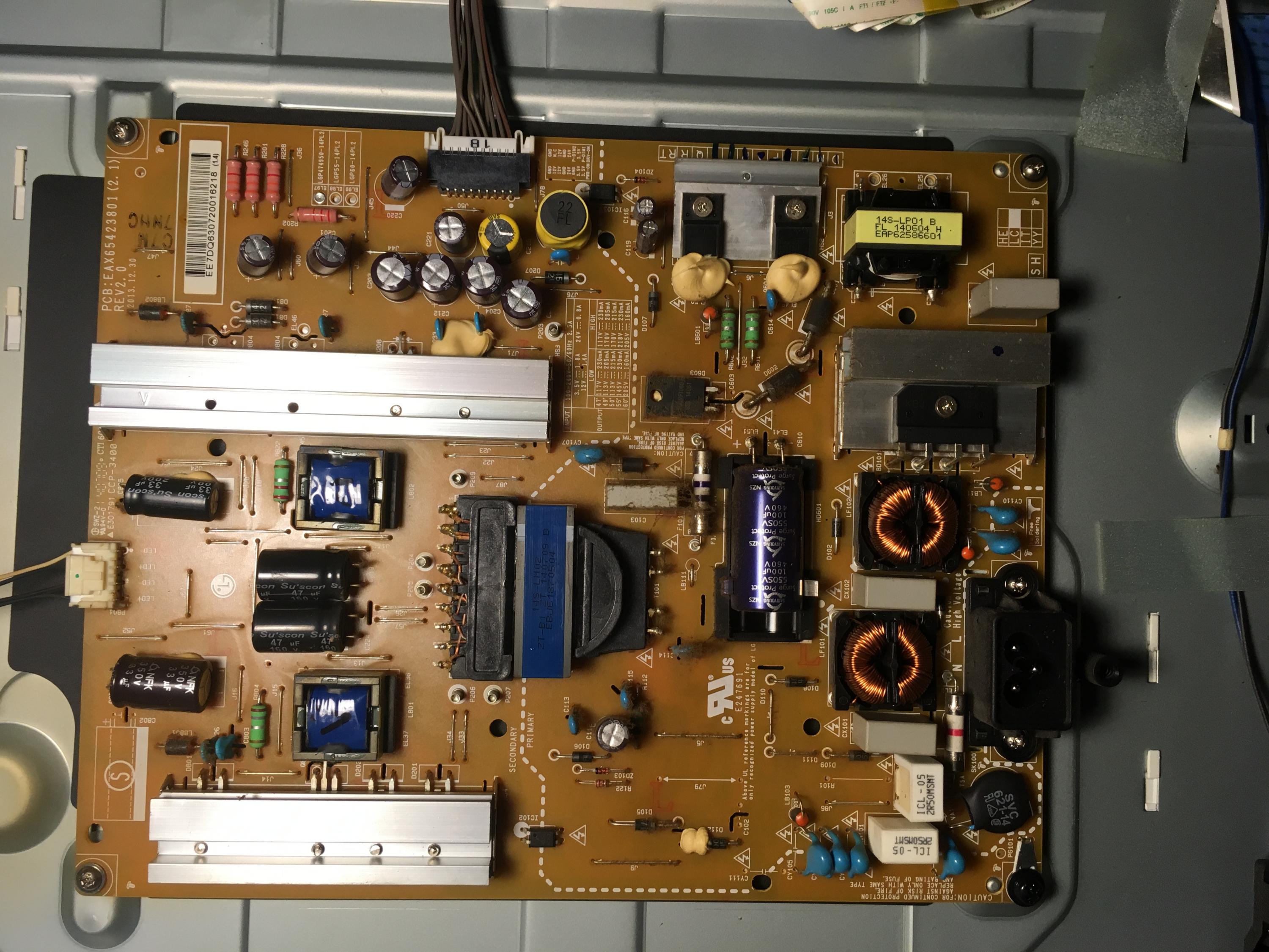

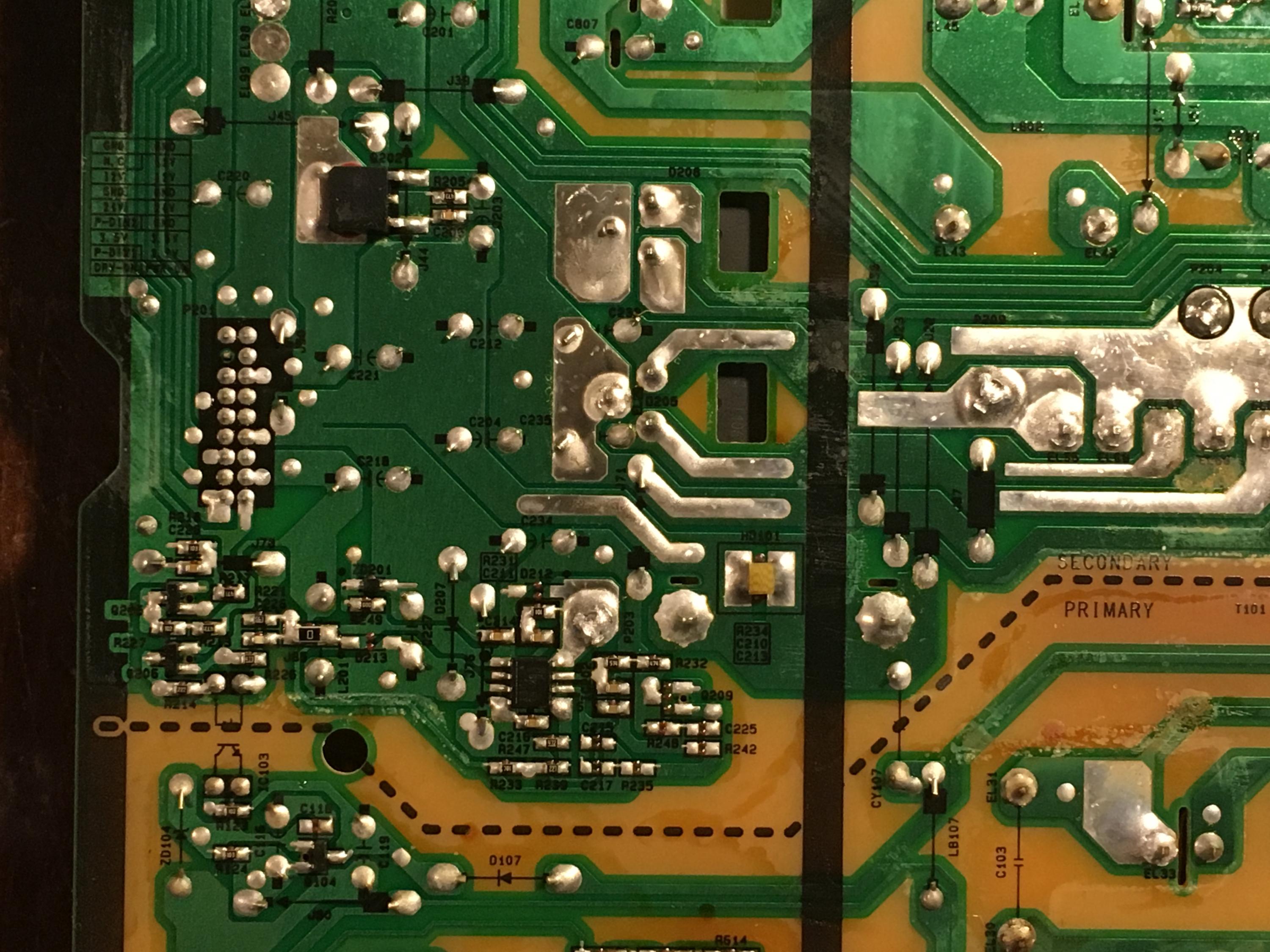

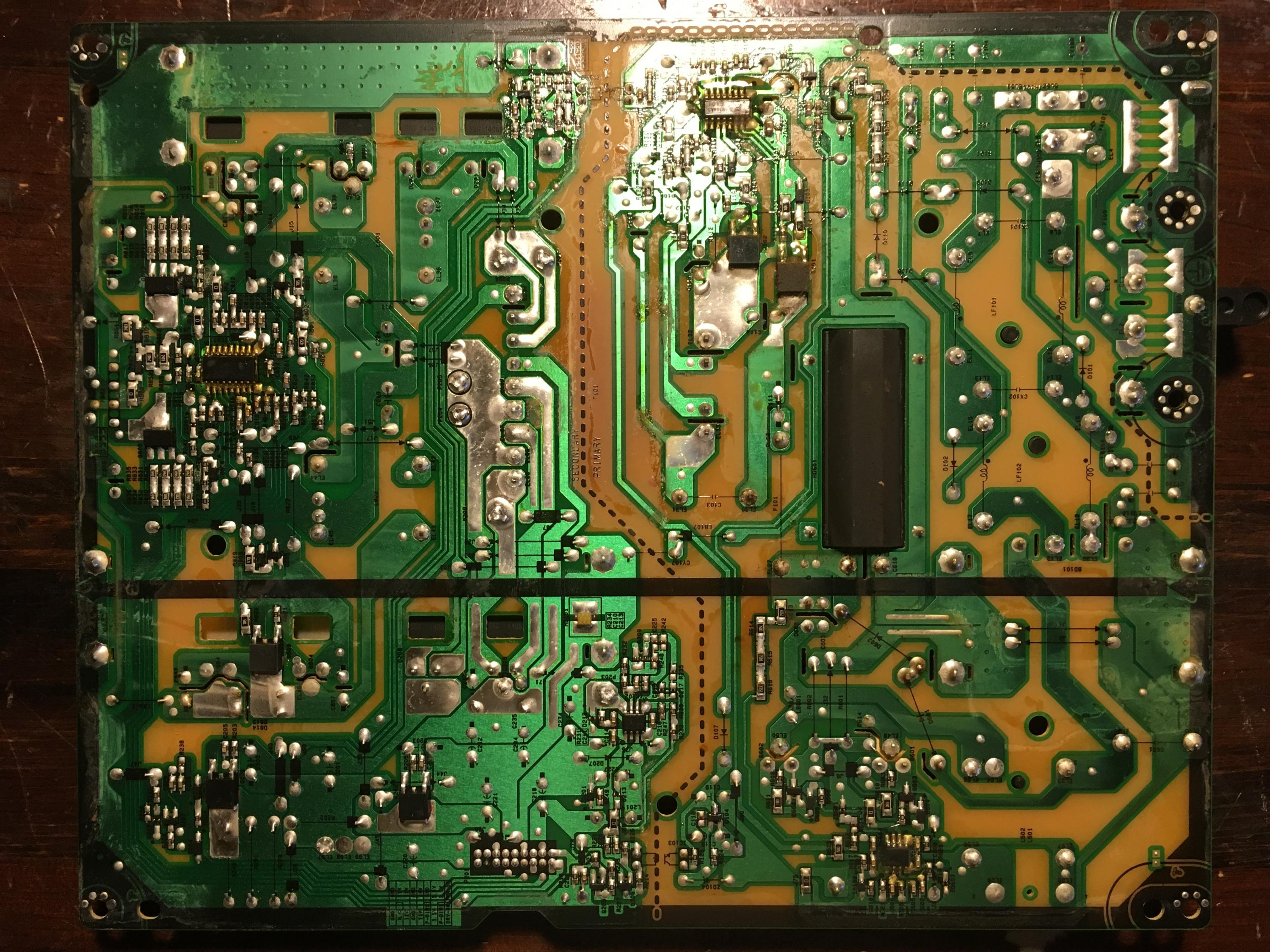

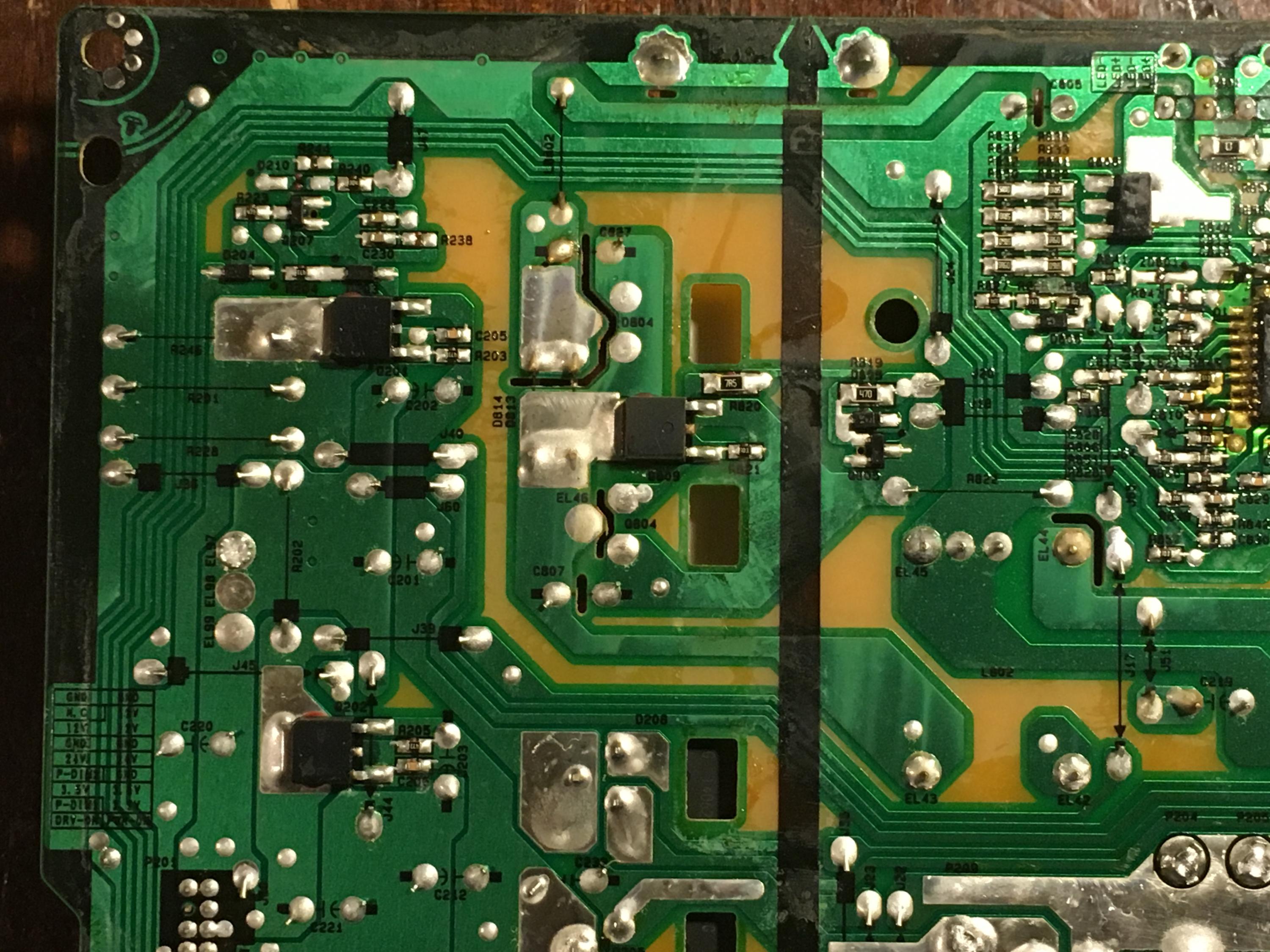

    I have an LG 49LB5550-UY with backlights that flicker on and off. Other than that everything works.
    I checked the voltages on P201 of the PSU (leading to mainboard) and all are as supposed to be.
    P801 (leading to the LED strips) has fluctuating voltages with LED strips connected and disconnected.
    LED+ on one side fluctuates from 123v to 126v when connected and from 174v to 194v when disconnected.
    LED+ on other side fluctuates from 128v to 145v when connected and from 135v to 148v when disconnected.
    Since the voltage fluctuate with the LED's disconnect I suspect a problem with the LED driver section.
    I do not see any visual signs of failing components. I was wondering if anyone has seen this behavior before or has the service manual.
    I am including an animated GIF of the flickering and image of the PSB/LED Driver.
    Thanks in advance for any help/support.

      are you measuring each pin in reference to chassis ground.
      led+ =....v
      led- =....v
      led+ =....v
      led- =....v
      each pin with all cables attached.
      on power up, measure spike and then what the voltage settles to?

        Re: LG 49LB5550-UY with backlights that flicker on and off
        (I used underscores _ to help with alignment of the text below)
        I do not have the remote to lower the backlight level.
        I measured from chassis ground
        ____________________LED+________LED-________LED+________LED-
        Power up high voltage__:155v ________31v_________145v_________83v
        Fluctuating low _______:123v-126v____19v-21v _____128v-145v____70v-80v
        I then measured the fluctuating volts on each while the TV ran with flickering.
        _______LED+______LED-_____LED+______LED-
        HIGH__136.9v_____34.6v_____146.2v_____81.5v
        LOW __121v_______18.9v_____130.8v_____65.5v
        I reversed the LED strings and still get the same flickering. I disconnected only one string and still got flickering. I disconnected the other and still got flickering. I put reversed the strings, with only one string at a time connected, and still got flickering.

          your led- voltages look way too high. i believe that you have shorted led's in the panel.
          this is where an led tester comes in handy.
          let's see if others come to the same conclusion.

              Is the DC voltage across the two legs of C610 holding steady or is this fluctuating and causing your backlight problem.
              • SdlewisSr
                • Oct 2015
                • 146
                C610 is holding steady at 400 V.

                  I would have expected the voltage at the led connector to be steady at some value when the led's are disconnected. I see there are 4 electrolytic capacitors around the connector. Have you checked them for value and ESR readings.

                    This is atypical case of bad LED backlights. Perform the checks dick barton recommends. Be prepared to tear down the Panel to get to the LEDs. Being a 49 incher be careful when handling as the break very easy. If you want along tem fix, change all the strips even those that appear to be OK. They will fail in the short term and you will have to rip her open again.
                      https://www.badcaps.net/forum/attach...4&d=1530592637
                      If you look at the Voltage chart as printed on the board, you will see the TWO output Voltages for the two LED strings which are not the same, one LED string has more LED than the other string. The loaded Voltage for the smaller string is 113V 205mA, the larger LED string is 170V 205mA.
                      How steady are the Dimming control Voltages?
                      The two 47uF 160vdc caps (C223?, 224) are for the filter caps power supply that feeds the two Boost converter circuits, so you need to check the Voltage between the two legs of those two caps to see if they are steady or not.

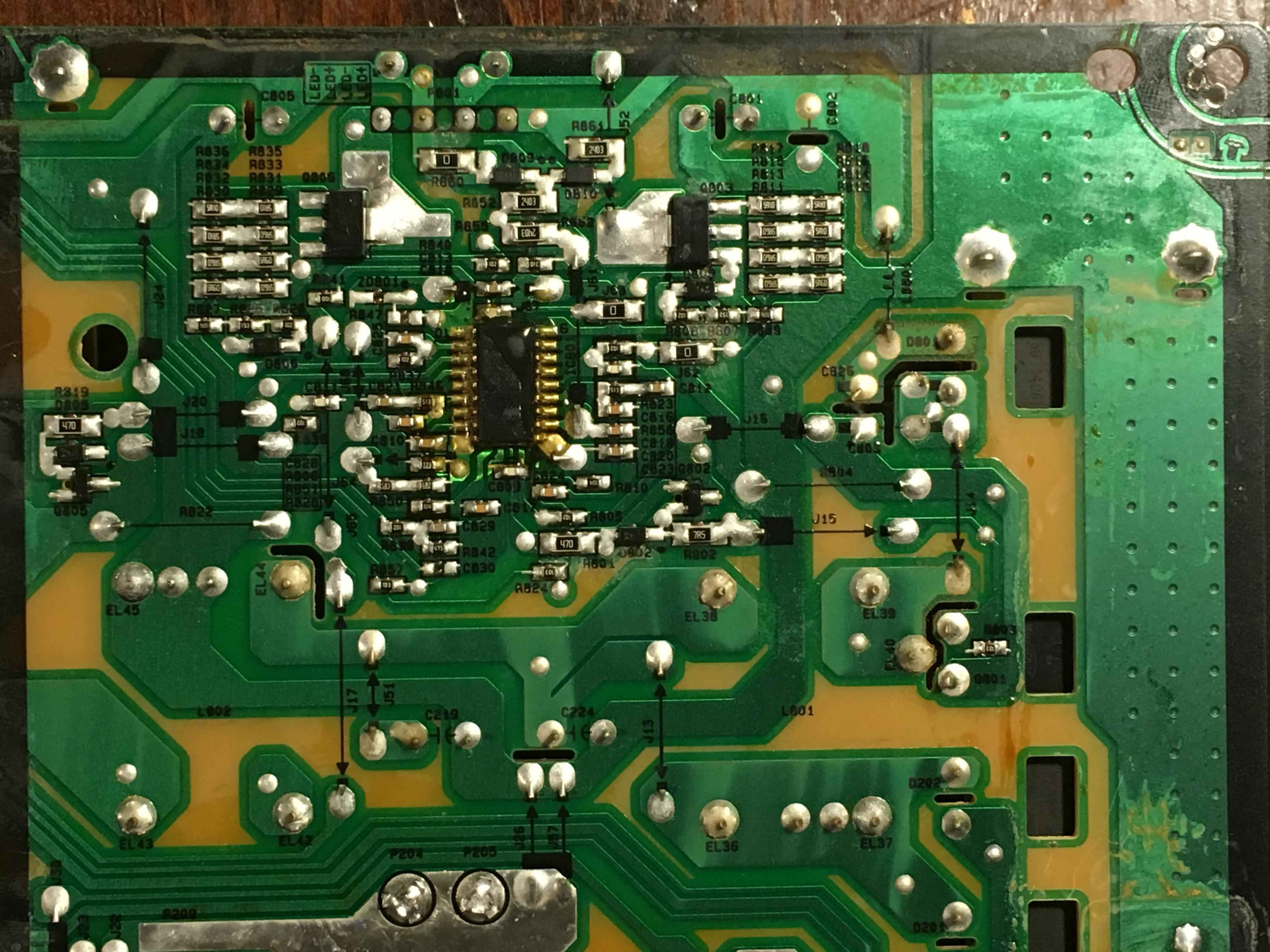

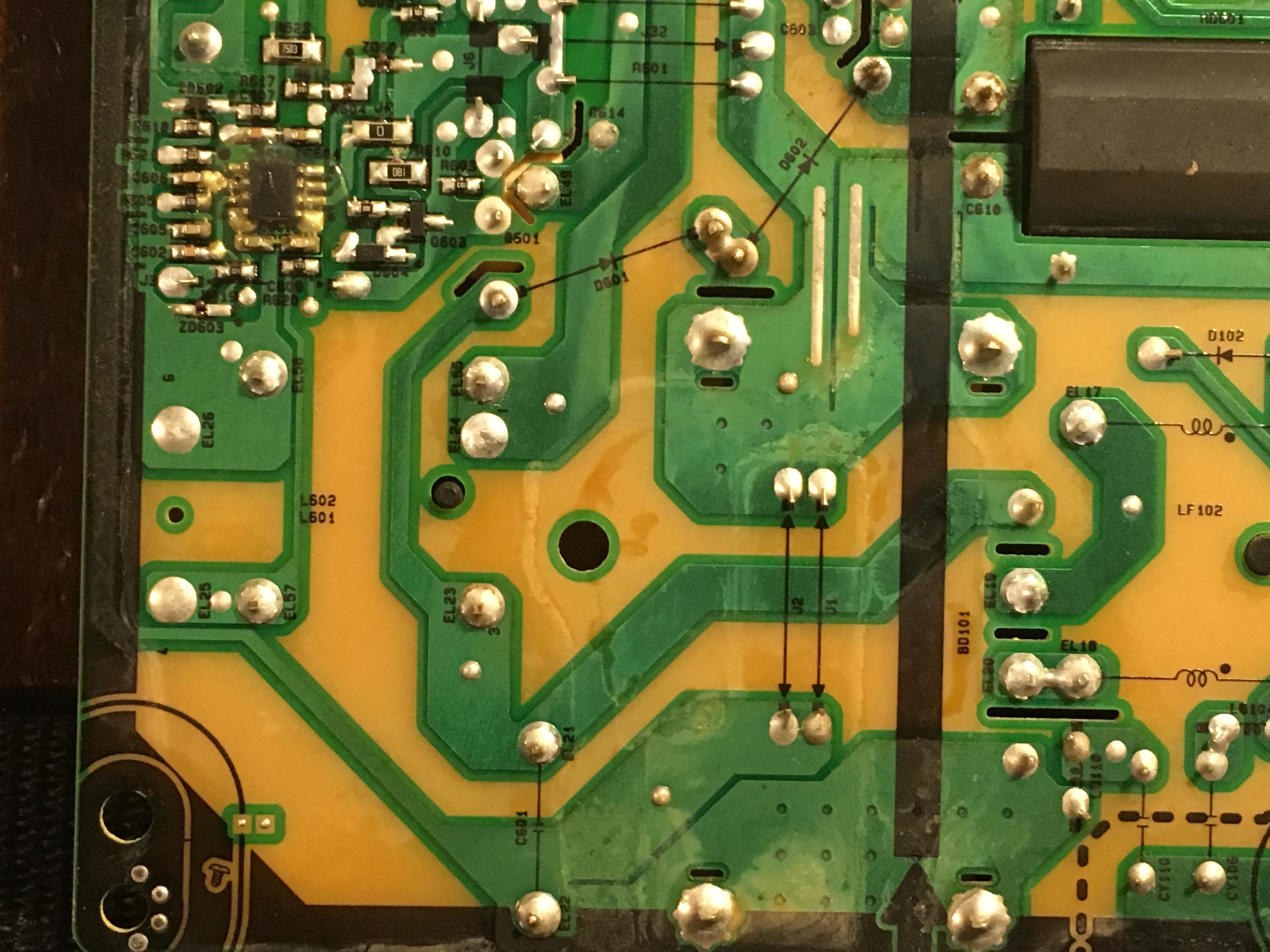

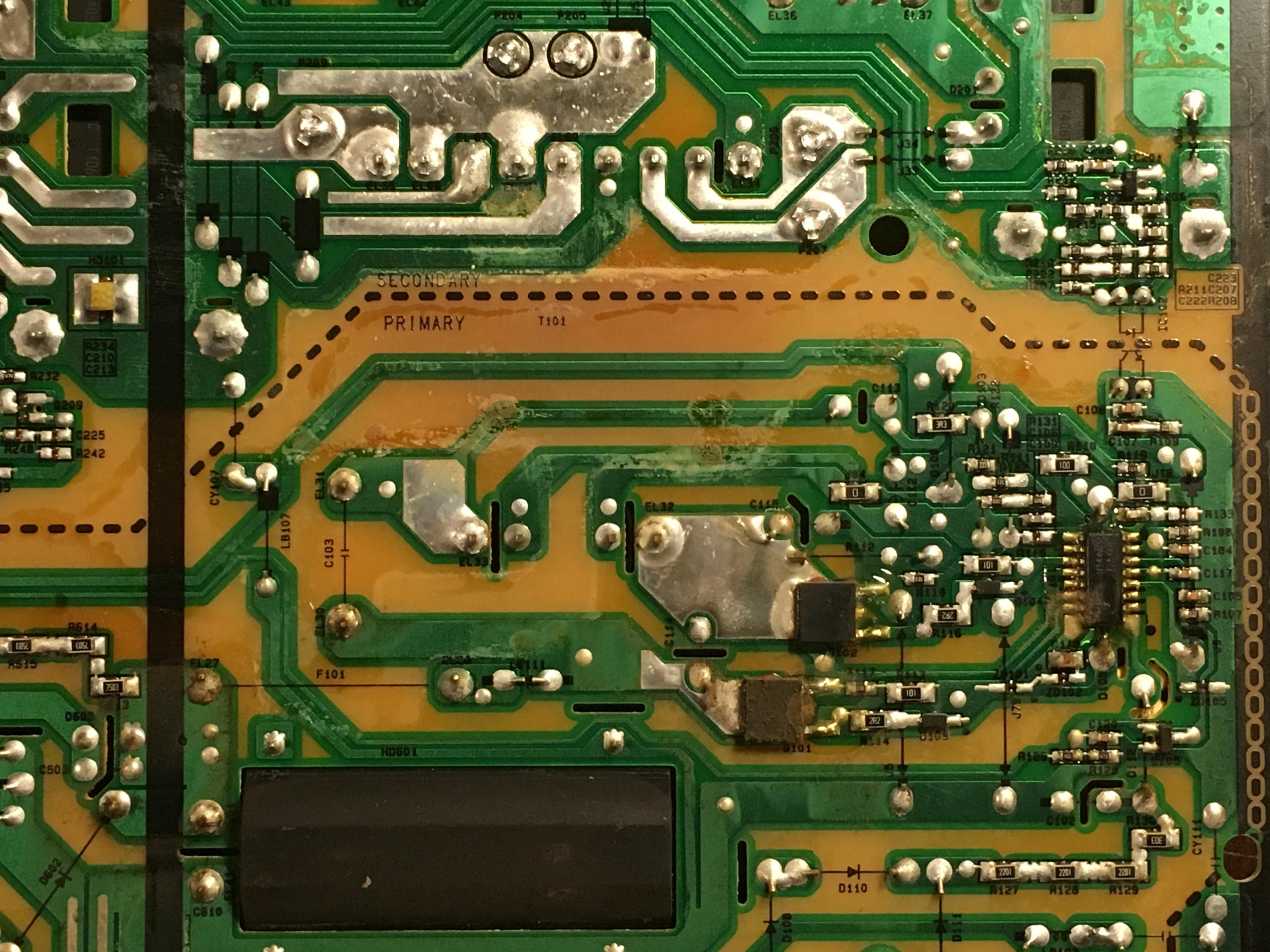

                        I appreciate all the input. I have a new development in this mystery. When I removed the PSB to check the caps, I discovered corrosion (see pics). Also the screws that secure the PSB in place were not tight. I am going to attempt to clean the corrosion and determine if any of the traces, solder joints, or components are damaged before proceeding. Probably will half to just replace the PSB.
                        Thanks again for all the support
                          All the through holes solder rivets should be inspected closely for cracked/poor solder joints.

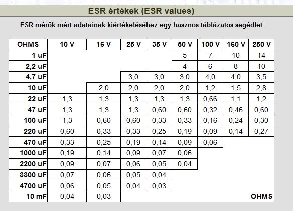

                              ESR values (out of circuit)
                              C801 2.1ohm
                              C805 1.9ohm
                              C224 1.8ohm
                              c219 1.6ohm

                                  You don's give the value of the capacitors and I can't make out from the photo which one is which. Find attached a chart which is a guide for expected ESR
                                  • SdlewisSr
                                    • Oct 2015
                                    • 146
                                    ESR values
                                    C801 2.1ohm (Top Left) 33uf 350v
                                    C805 1.9ohm (Top Right) 33uf 200v
                                    C224 1.8ohm (Bottom Left) 47uf 160v
                                    C219 1.6ohm (Bottom Right) 47uf 160v
                                    • dick_barton
                                      • Aug 2015
                                      • 6643
                                      • Wales
                                      The 47uF, 160V should have a maximum ESR of around 0.46 ohms. Your readings are considerably higher.
                                      The 33uF, 200V approximately 1 ohm max
                                      Not certain of what the 33uF 350V would be but I suspect around 2 ohms.
                                      Have you also checked their capacitance and do they match what is on them.
