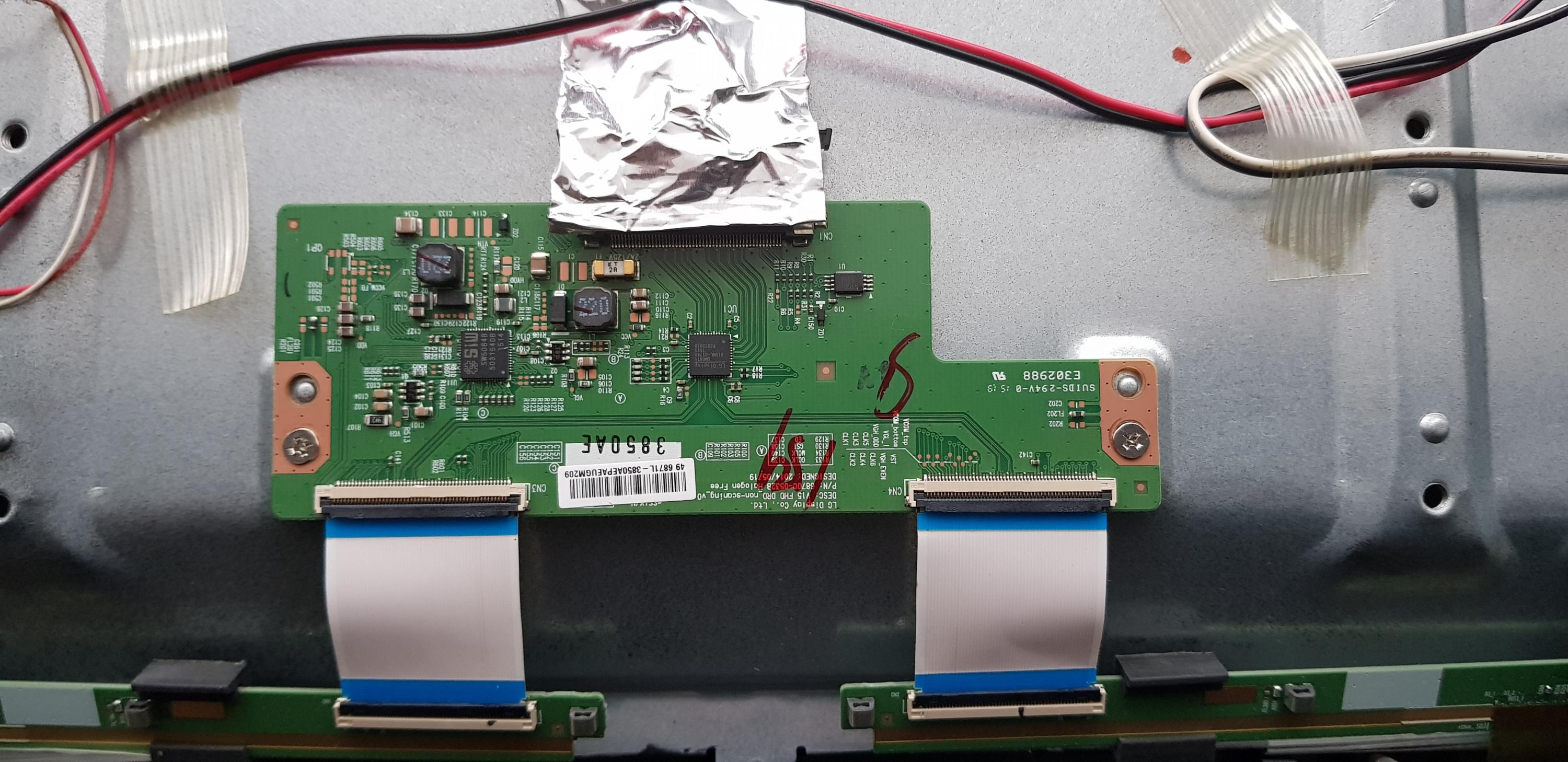

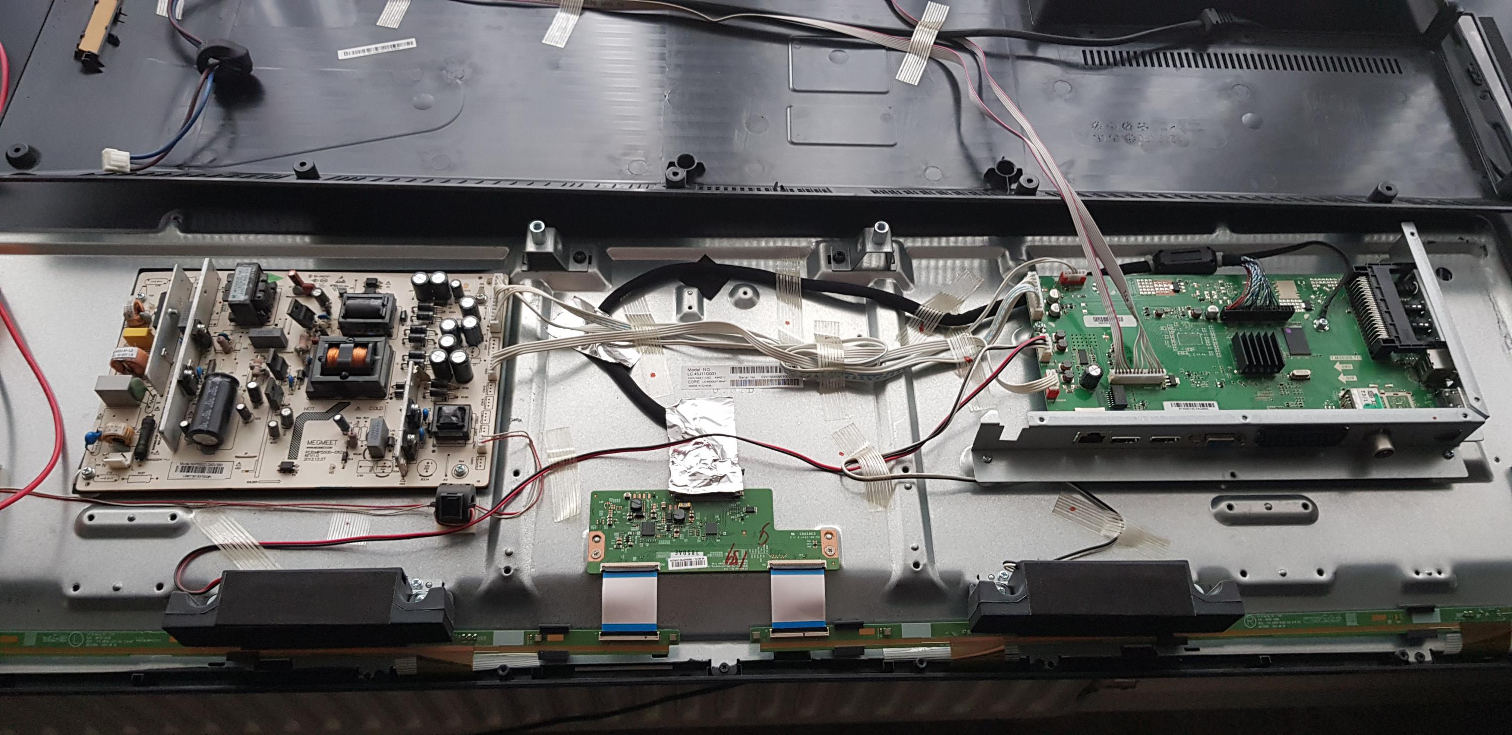

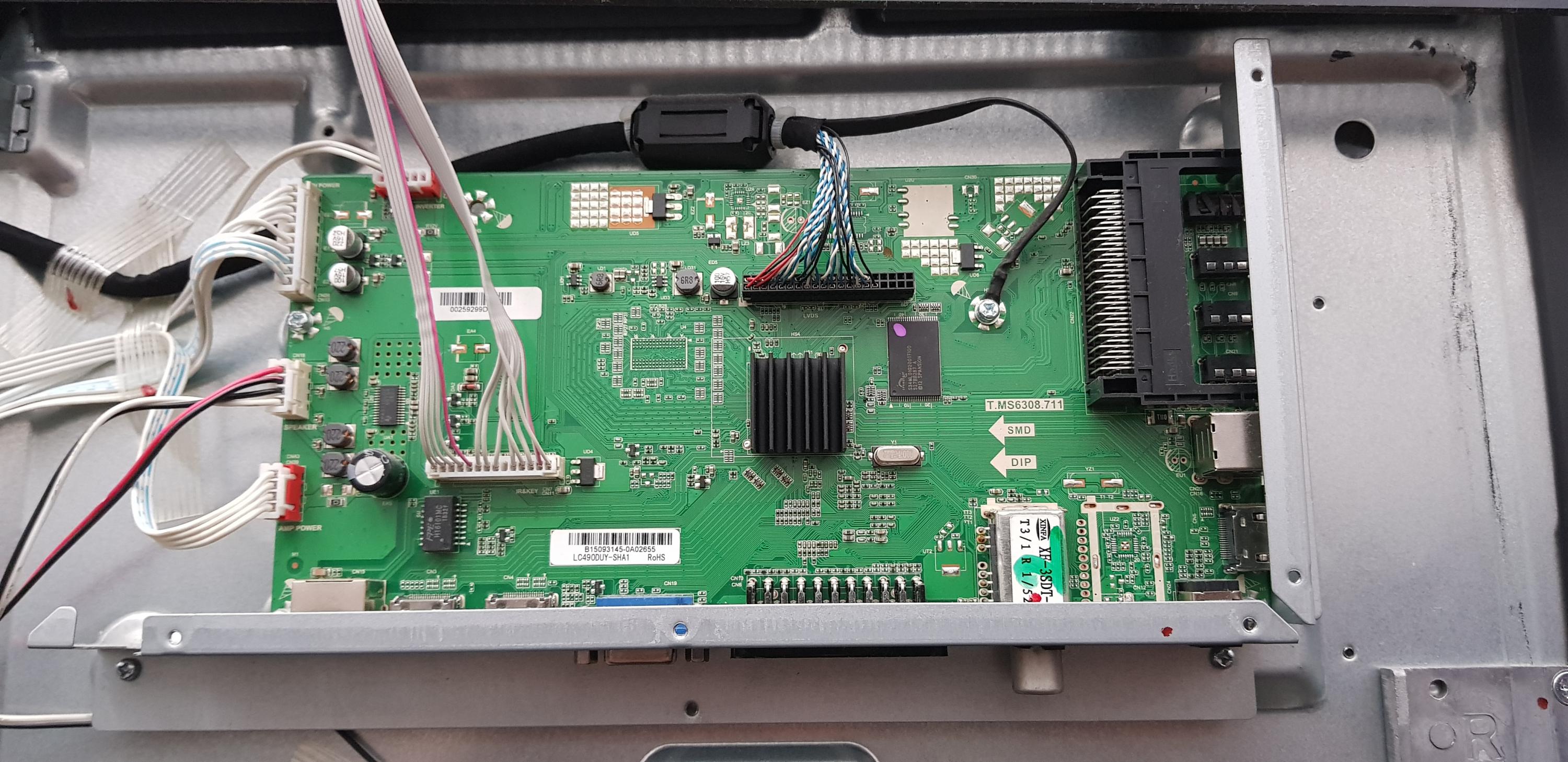

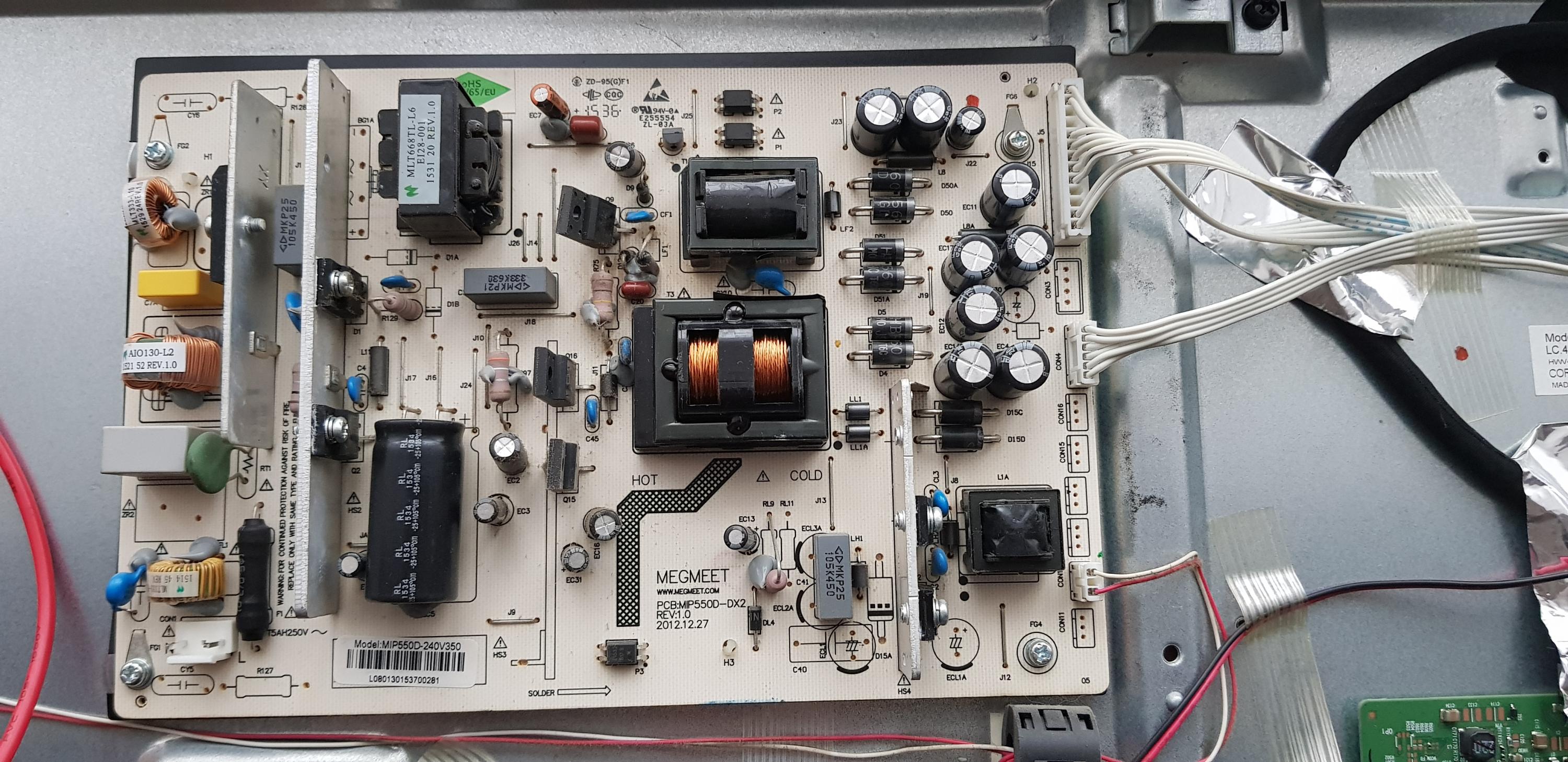

    Trying to repair this t.v.
    Stuck in standby blue led but no backlights
    384v across main cap
    LED voltage 130volts when first turned on and stays steady
    12 volt going across main tcon fuse also tried a replacement tcon I had as a spare
    Power supply megmeet mp550d-dx2
    main board t.ms6308.71
    pictures uploaded

          Re: Blaupunkt 49/235Z-GB-11B-FGU-UK blue standby light
          Legend pins PSU
          12v = 12v
          12v =12v
          Sgnd
          Sgnd
          Sgnd
          +5v =5v
          +5v =5v
          +5vsb=4.9v
          Pson=4.1v
          +5v =5.0v
          +5v= 5.0v
          Sgnd
          Sgnd
          12v=12v
          Bk=4.9v
          Adj=4.4v
          Sgnd
          Sgnd
          Led+=130v
          Led-=0.00
            Led+=130v
            Led-=0.00
            That indicate open circuit some where in the LED string/wiring.

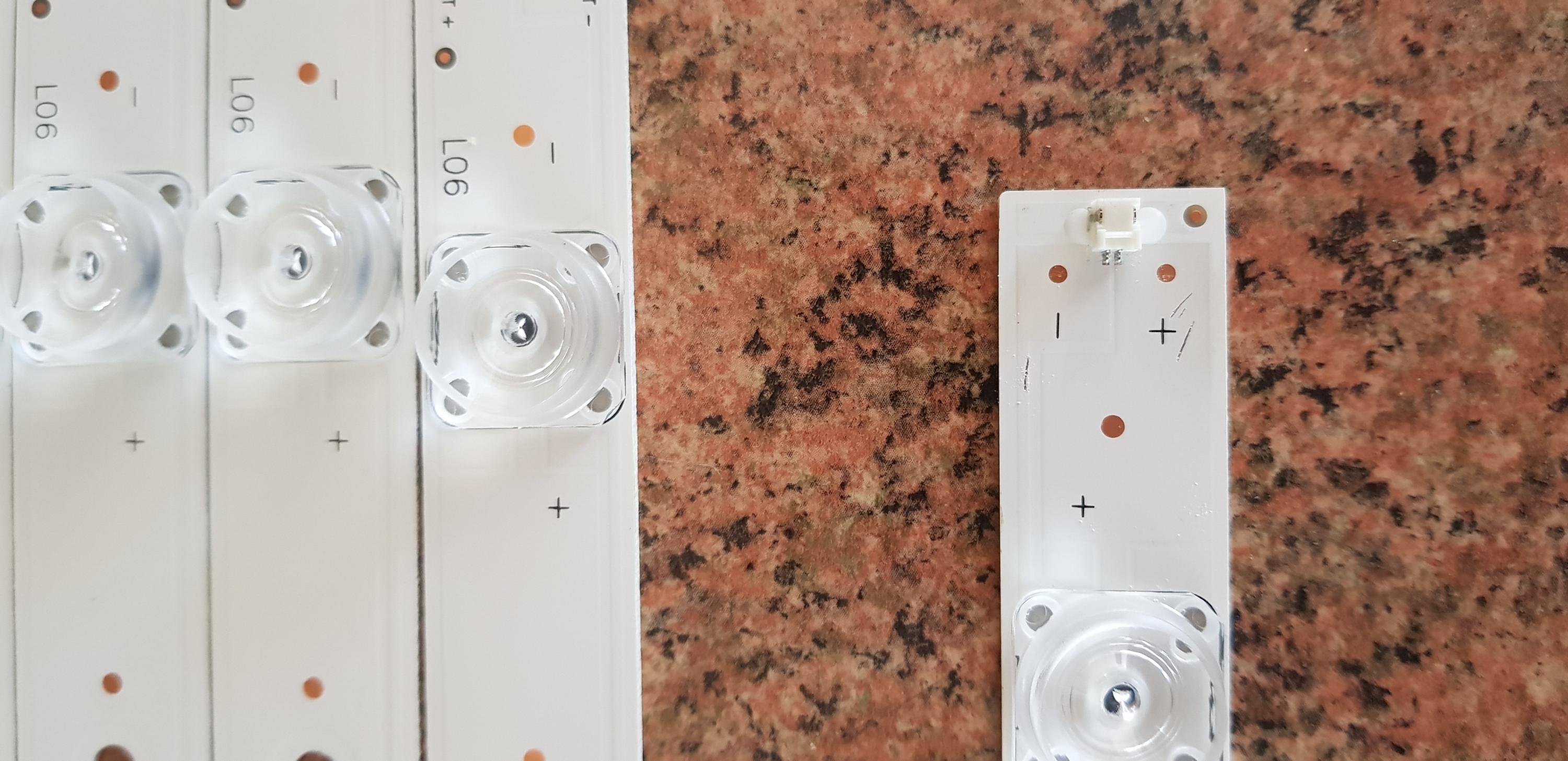

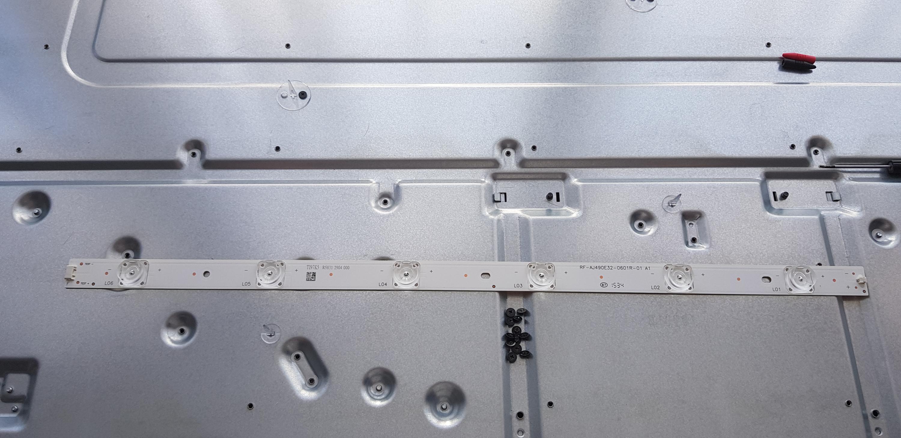

                          • sordids999
                            • May 2013
                            • 2154
                            • uk
                            Right back light led tester arrived today
                            If I test the led strip at the end test points
                            6 out of the 12 work but the bit I'm confused is if I test every led individually there fine on the faulty strip
                            • Andrew F. Ali
                              • Jan 2014
                              • 2450
                              • Trinidad & Tobago
                              If the entire strip of left side and right side connected show only 6 out of 12 LEDs working bit tested good individually then it stands to reason that you have a connector issue Fix this by soldering jumpers to make a positive connection and re-test wiyh the backlights tester and all 12 LEDs will work.
                              • sordids999
                                • May 2013
                                • 2154
                                • uk
                                Yes it's the 6 to the right which is the side where the connectors go where do I jump from the main connectors ?

                                      • sordids999
                                        • May 2013
                                        • 2154
                                        • uk
                                        Right so I bridged the centre connector and tested with led tester but still nothing
                                        If I use the led tester on the positive side then move the negative lead to each led they light up in sequence but if I try the positive and negative tester points nothing
                                        Remember the left side all six strips work using the led tester but the 6 right side which where the current goes through does not work
