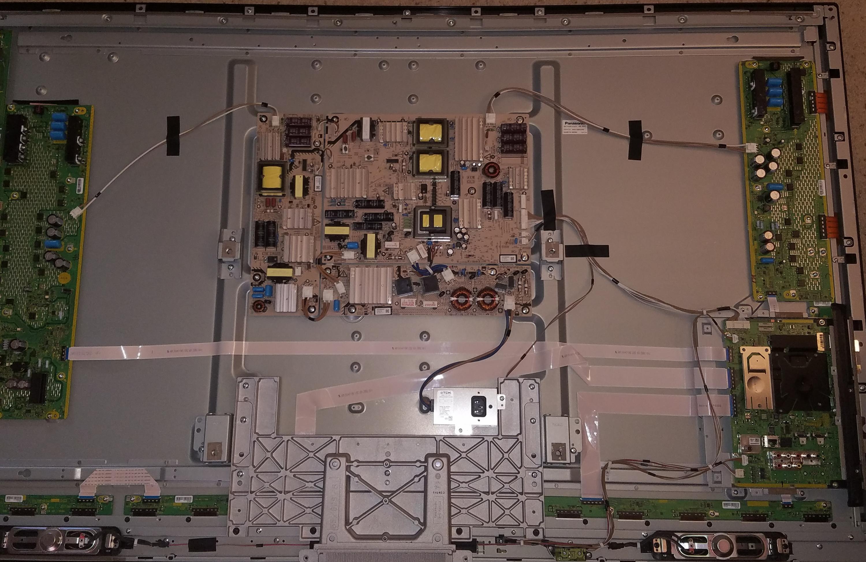

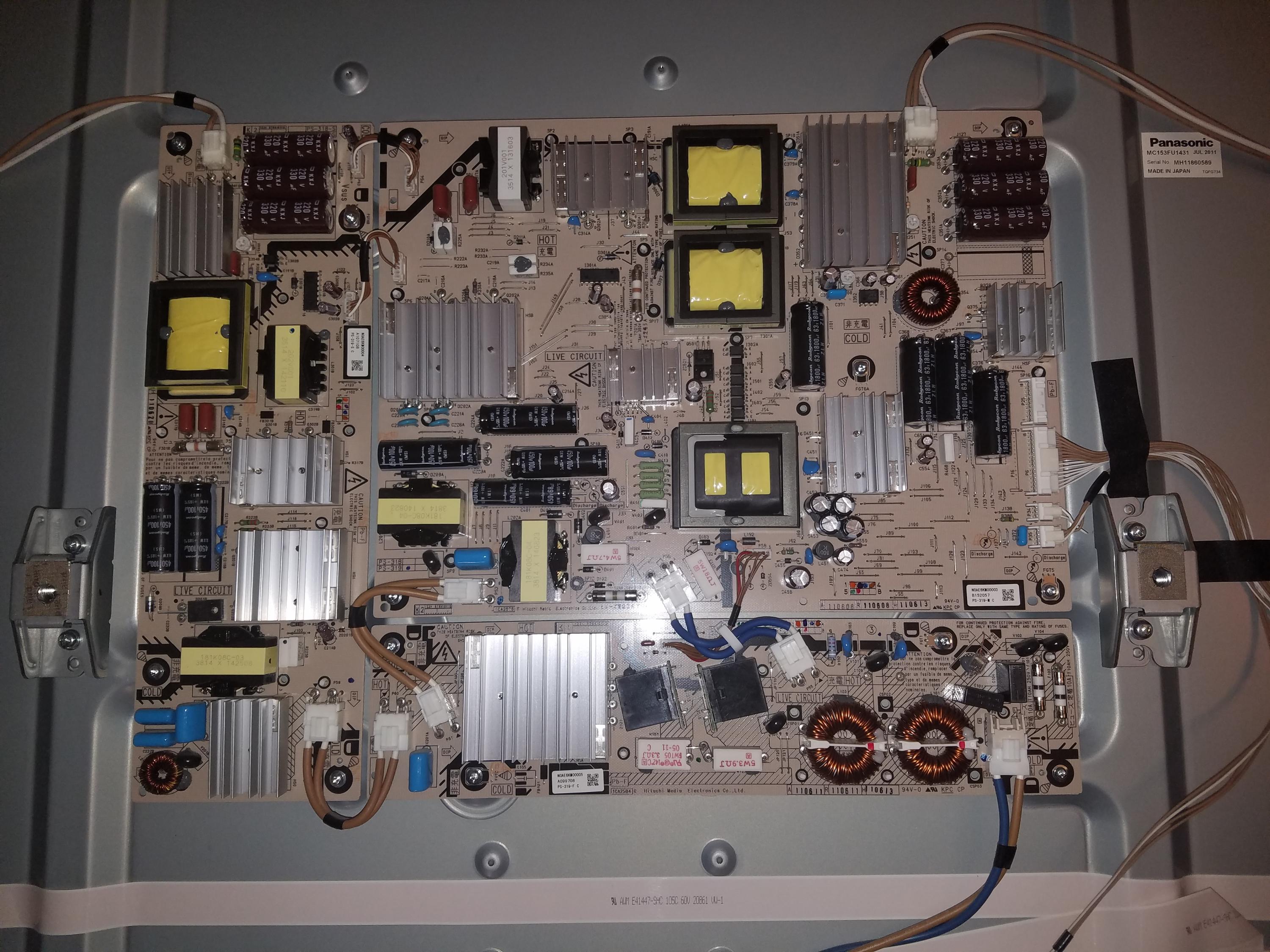

    I'd appreciate the help of someone with expertise on this TV. I downloaded the troubleshooting guide and I'm getting absolutely no power (No 5V Stby).. I'm actually not getting any activity on the TV at all (no blinking lights, no clicking, ...)
    On the troubleshooting guide, i see that my Power board is vastly different than the one shown. Does anyone have a troubleshooting guide for this specific TV? I'm concerned that when they say 5VSTBY is on P6 pin 6, that it's different on mine? No labels on the board (at least the visible side) to see what voltages are where.
    Assuming the guide is accurate, I have several power boards connected together. Which one would I replace? Any schematics out there?

    Does anyone know what this lamp like G101 on the lower card supposed to be? Is this a gas discharge tube? should it be shorted or open?

      Re: Panasonic TC-P60ST30
      Yes thats a gas discharge tube and yes it will measure open. With power of measure the resistance of the 2 white ceramic resistors 3.9Ω and 3.3Ω.
      Do you get any relay click when you apply power? You should have STB+5V on P6 pin6
      with your meter on a/c volts place one probe on neutral and the other on F103, you should have 120v ac if not it's likely thos resistors R103 or R123 are open, probably R103 and if it is open I would replace S102 relay also

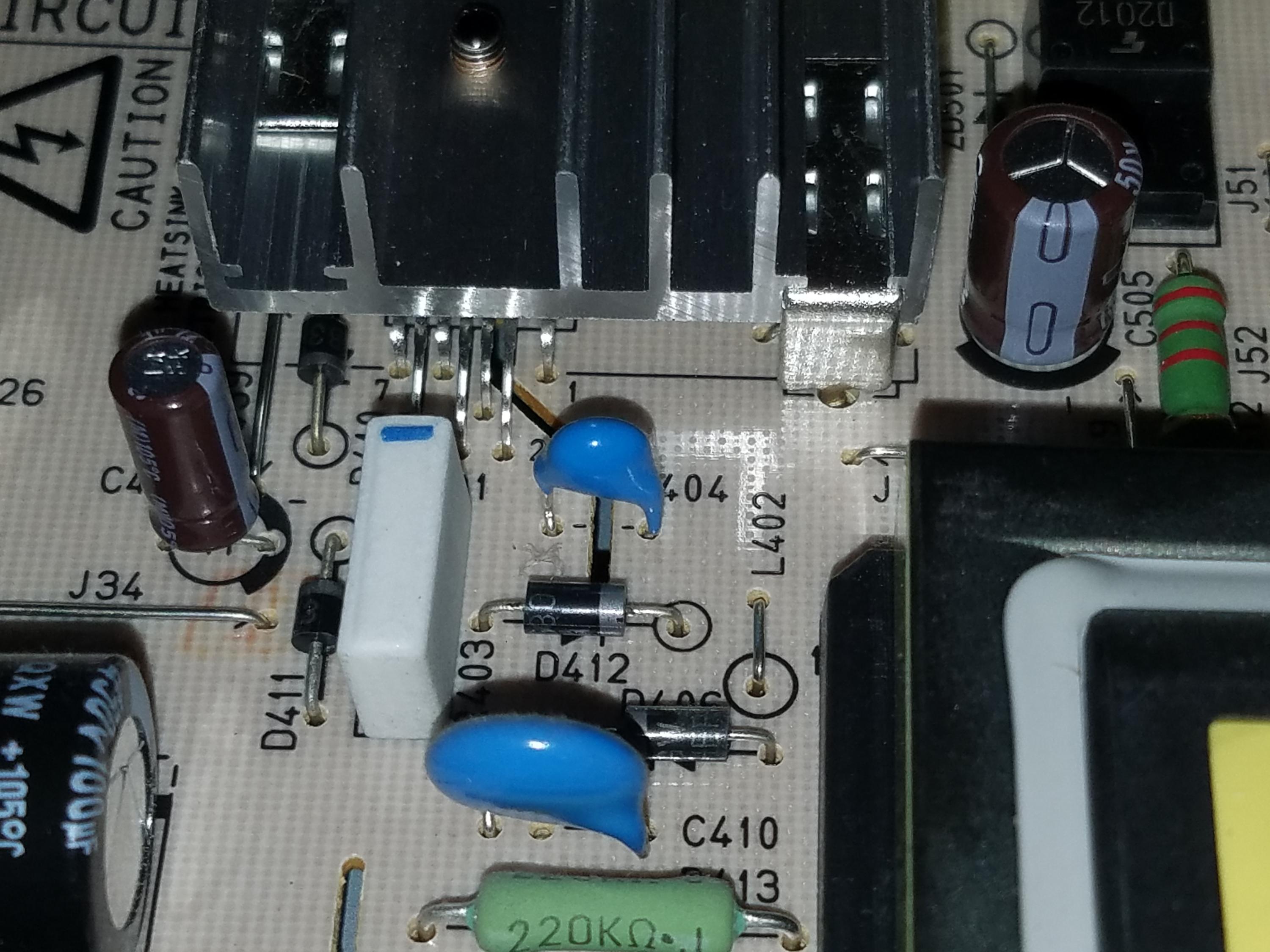

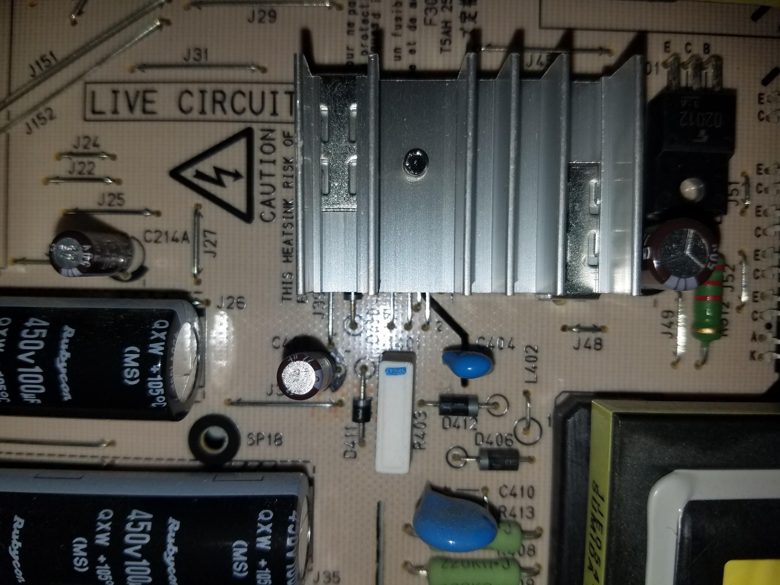

                    Do you have dc voltage across C362 1800uf/63v I believe the standby ic is under the silver heatsink next to [LIVE CIRCUT]
                    Also have a close look at the blue disc cap C404, check it for cracks or burn marks
                    It is likely the standby ic is bad.

                        What resistace do you get if you measure across pins 1 & 2 of the i401 ic and check the resistance of R414 it might be open, it supplies the B+ to the ic
                        You can check its resistance by checking between J33 jumper wire and any of the green resistors (using the lead next to the transformer)
                              I401 pin 1 to 2 is short. Resistance between j33 and green resistors leads is open
                              • R_J
                                • Jun 2012
                                • 9535
                                Thats why there is no standby, ic is shorted and opened fuse resistor.
