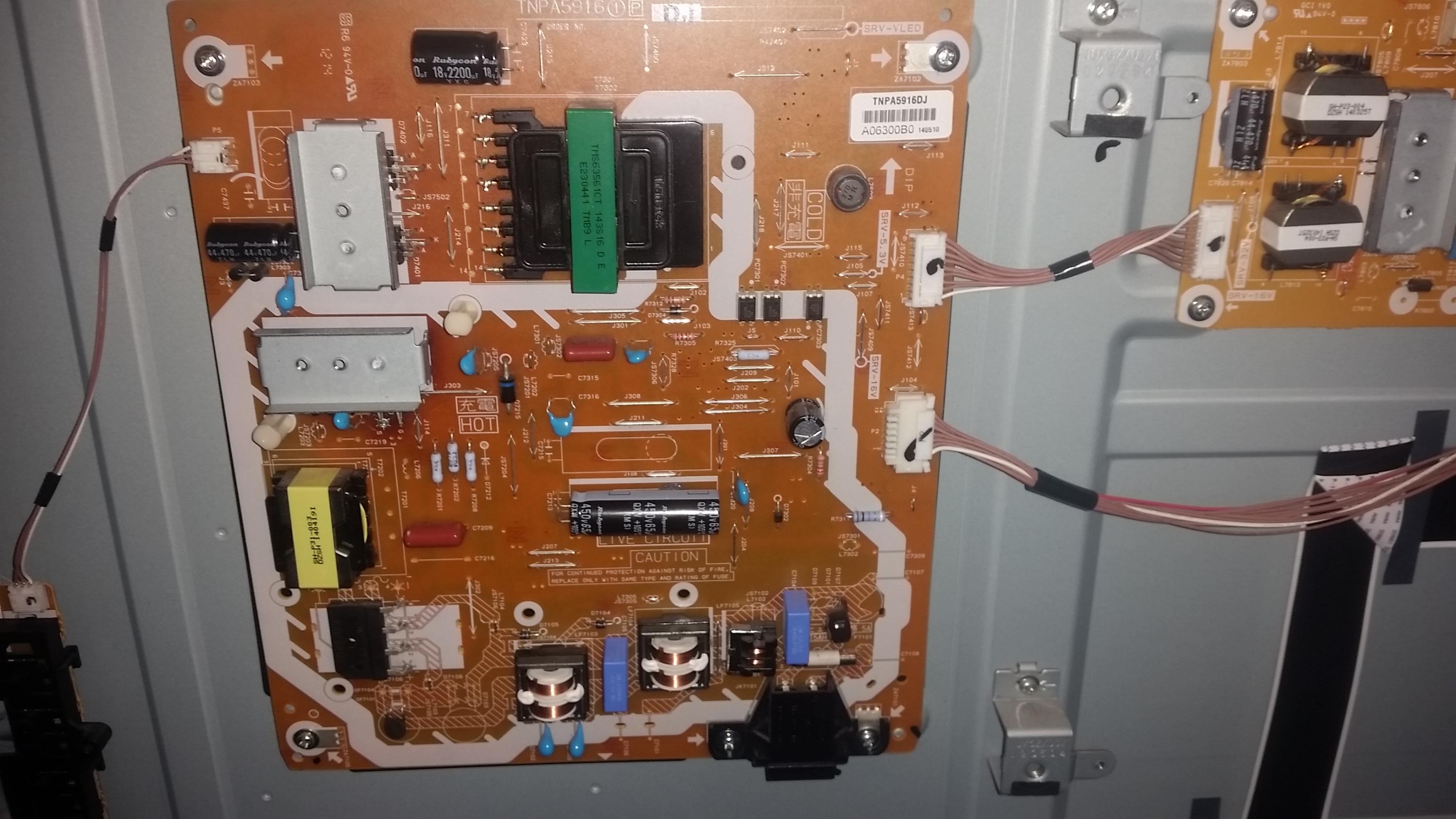

    Ok I was given this tv and all i knew was it dosent go.. so i plugged it in and the standby light goes from green then starts to flash once every second or so,not sure if this is the same as a plasma blink.
    Anyway i have found it very hard to find any info at all about this tv.
    I have tested the standby voltage on the power board which reads 5.2v so im guessing close enough to the 5.3v on label but the 16v test point reads 0v as does the 35v.

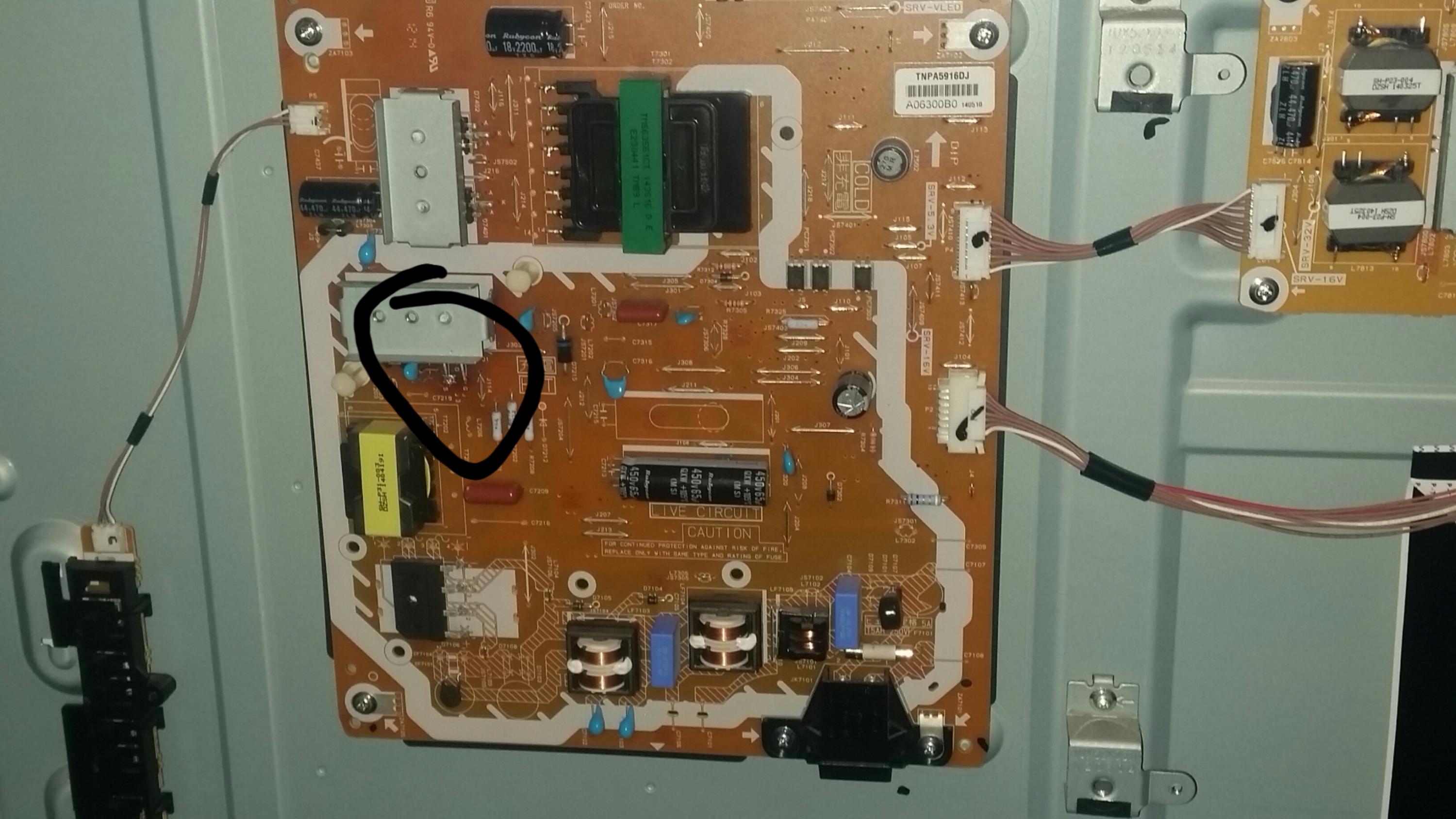

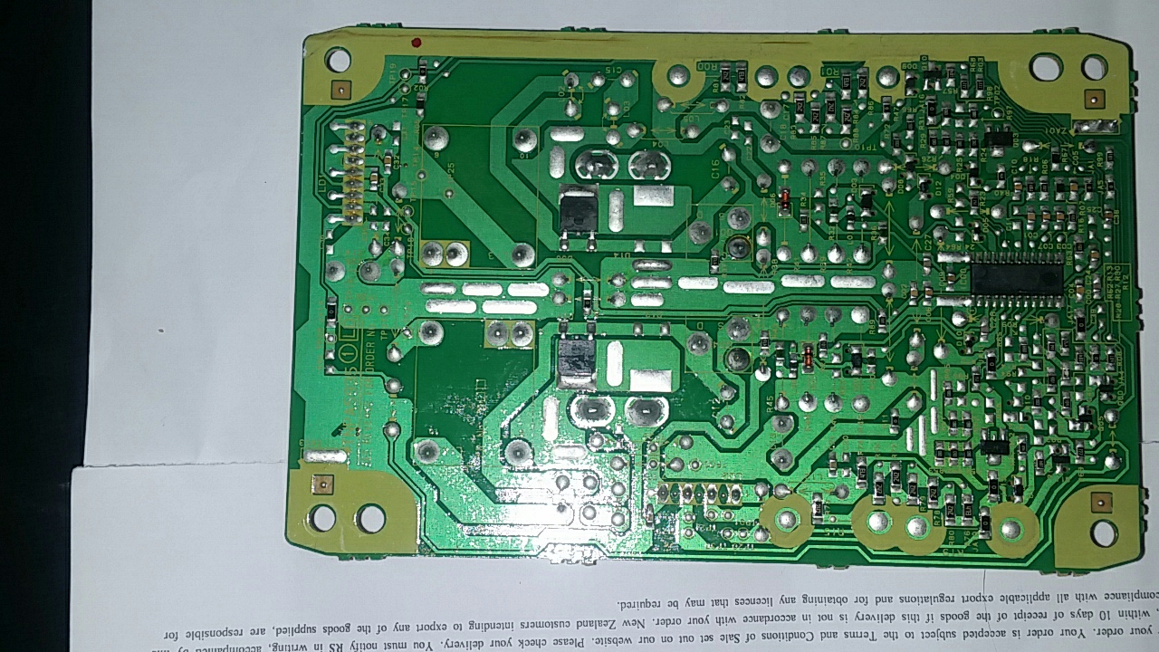

    I then removed the power board and discovered a heated patch on the board around one of the FETS which i have replaced but still have the same result...So would be grateful if anyone could give me a few pointers on what to check next..could it be a different board thats the problem?

    One blink= BL_SOS -- SOS from PANEL inverter
    check for +16 volts on TP7404 or cathode of D7409 or across C7423
    check for +32 volts on TP7401 or cathode of D7402 or across C7422
    If you have +5V5 you have +16v
    If the voltages are at these points then power supply is likely working but is being shut down.
    check the voltage on P2 pin 9 or TP7416 which is SUB_ON

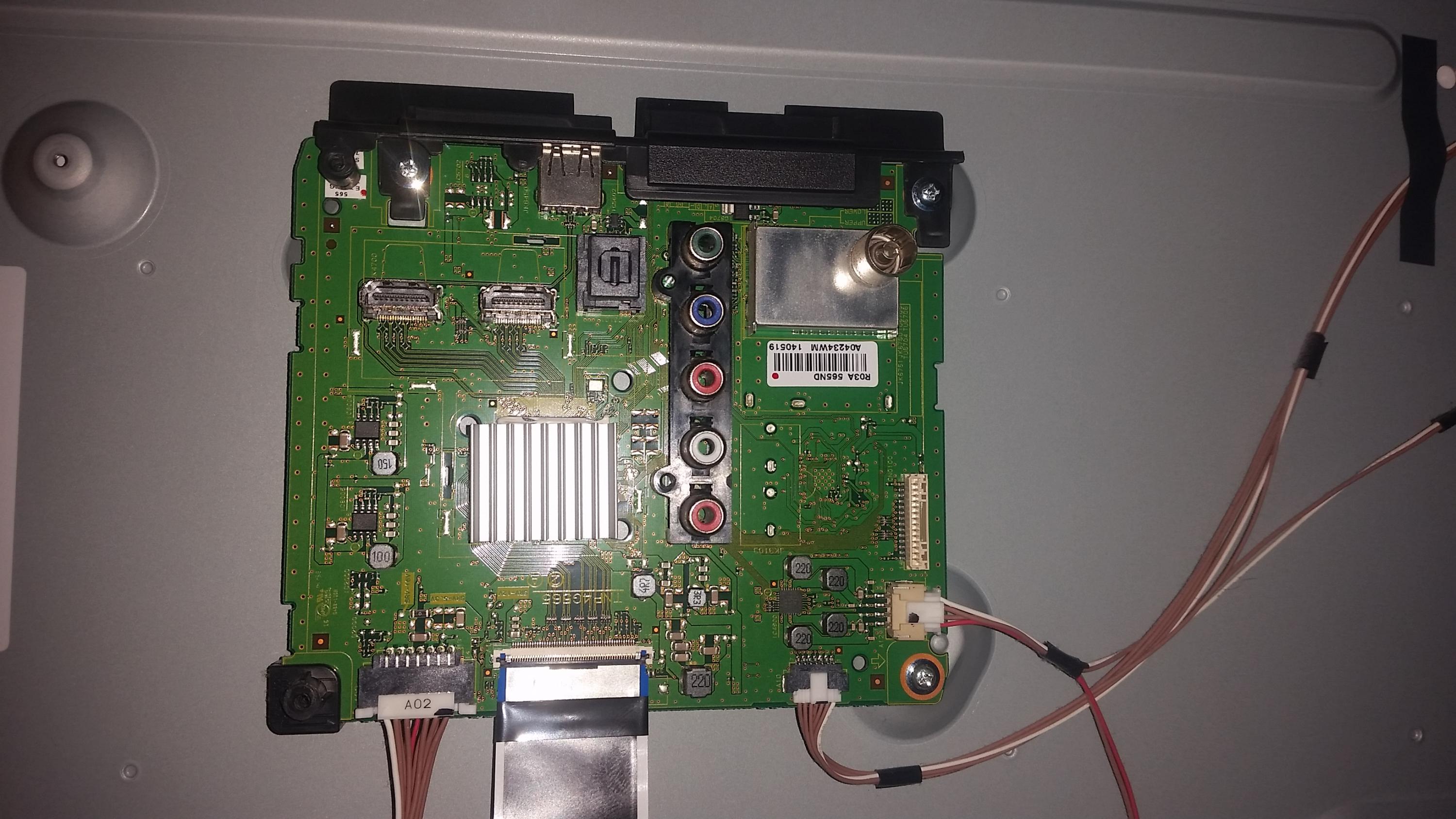

      Here's some pictures I will edit this post soon

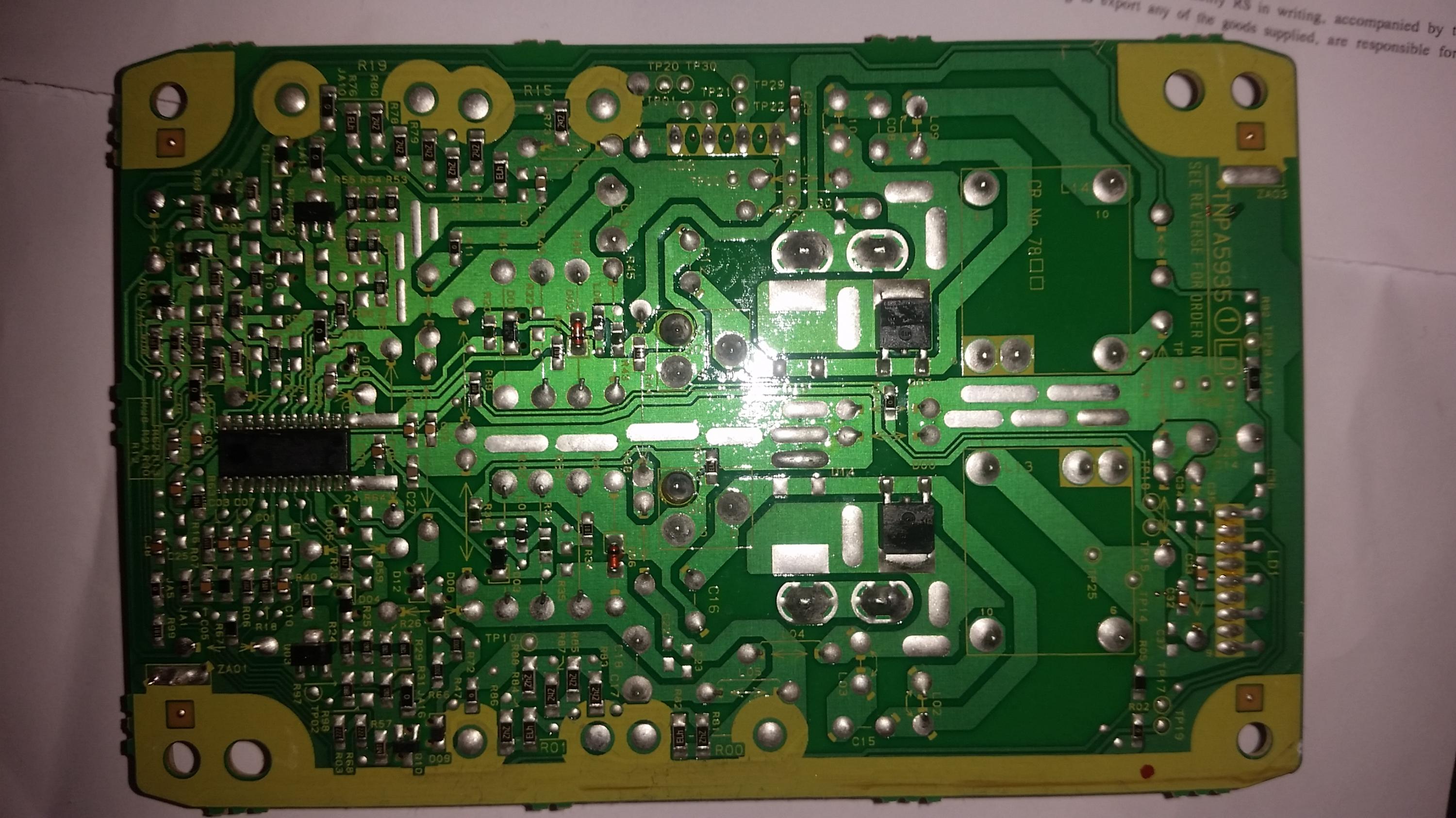

        Re: Panasonic Th-42A400z led tv
        OH Hell I give up on posting..
        Hi RJ,
        Thanks for your reply this is now my 3rd attempt at posting so its going to be short lol
        I tested all points shown on those boards in post above (i couldnt edit it) the voltages were correct until the led blink kicks in where they drop to 0v except the 5.3v which dosent change.
        The last picture just indicates the heated area on the board and FET I replaced (TK10A60W)

            The brown area around the fet is just discolorization from heat, the fet runs a bit hot, this is normal and occurs all the time.

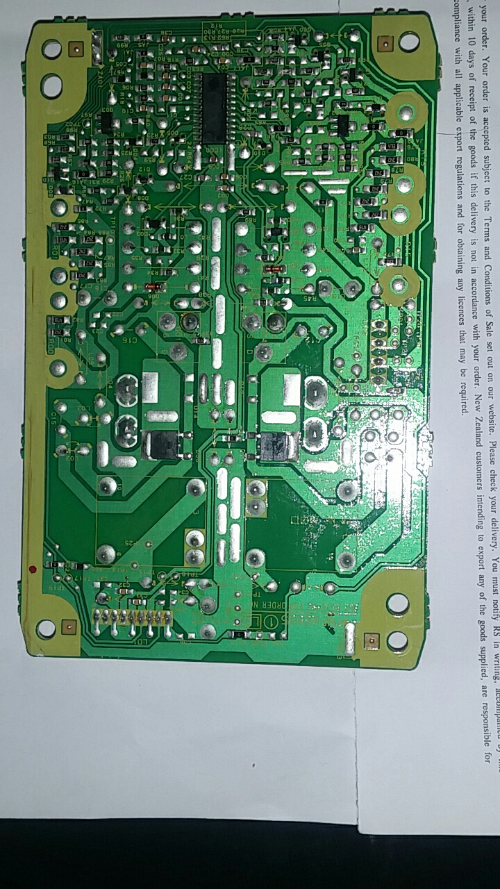

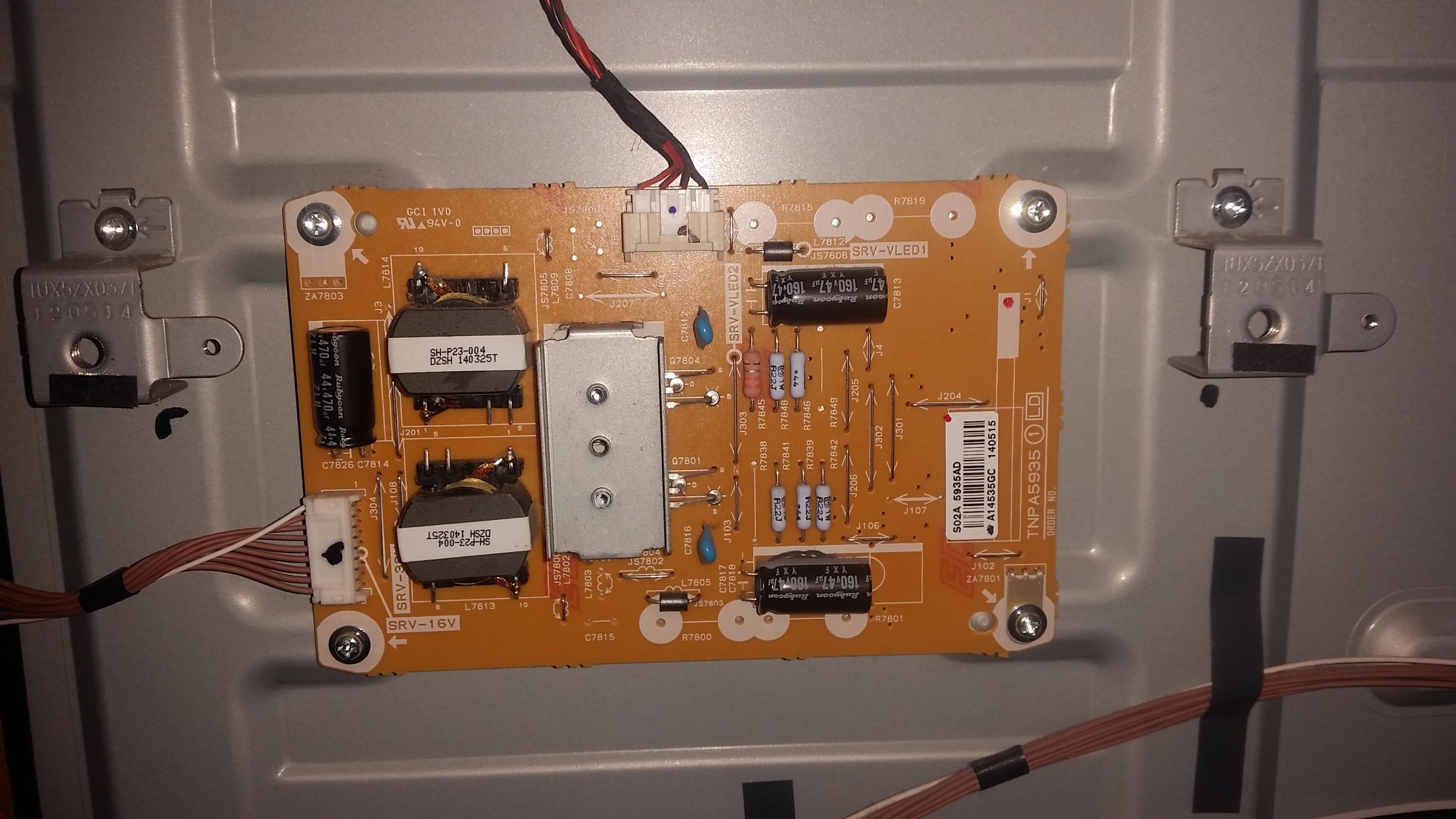

                          If you're pretty sure that the Voltage only jumps up to 37V on C7813 compared to the 101V on C7817, it means the boost converter where C7813 is not working.
                          We need to see good clear straight shot pictures of the whole bottom side of that LD board.
                            I tested the two caps again before I took the board off and yeah the top one got to about 39-42v while the bottom was about 87v so definitely a difference hopefully these pictures will help they are taken as though the top screws have been removed and the board hinged down on the bottom ones if you understand that lol
                            Cheers

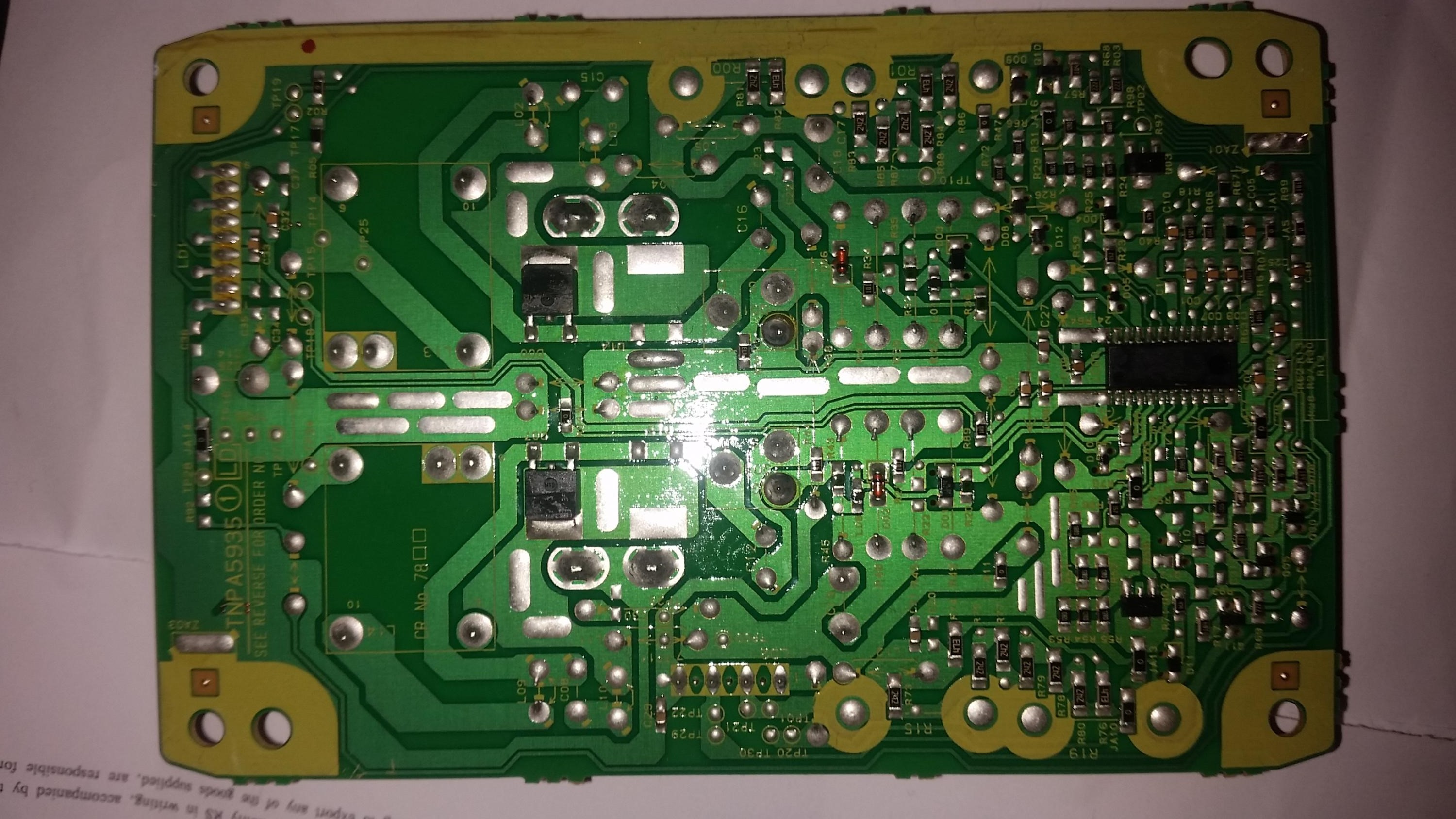

                              Ok it turns out you cant edit posts even though it says edit it wants to create a new reply so here are the pictures the way i first intended on uploading them i hope...
                                If you disconnect the LD2 plug going to the panel and check the voltage across C7813 is it still low, or does it come closer to C7817
                                Needs to be measured while turning on tv as it will error and drop down
