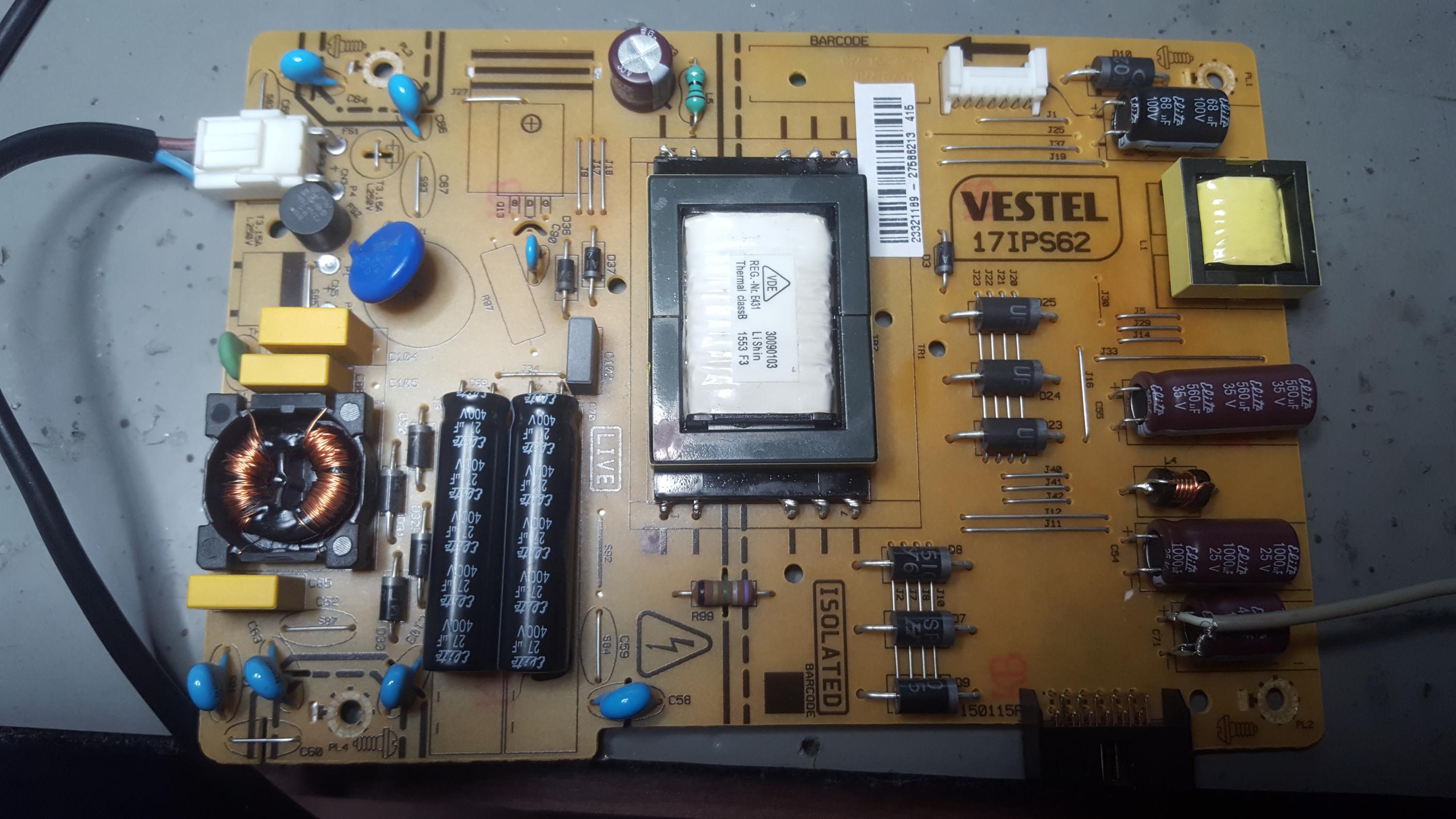

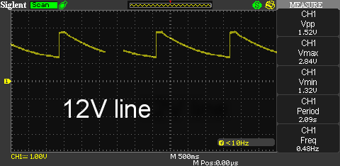

    Hi guys, i have a problem with this power supply, that did not survive lightning.
    Find out that transistor that regulates optocoupler on secondary side was faulty, replaced it and checked components around it, now it seems ok, but there were no sucess. So i look further, and on primary side fet that drives transformator and his controler were dead (smps). I have replaced them. Checked other components, everything seems ok, and I have a progres, but not in full. It is trying to start but no sucess. There are no shorts anywhere, but it does not work.
    I tried feeding 12v line with external 5v, and optocoupler switches on primary smps controller (U1 FAN6300), but his cappacitor charges and discharges, has no steady voltage...Look at the video, unimer is measuring smps cappacitor, and osciloscope is on secondary side 12v line that goes on optocoupler, without external voltage feed, as it should be.
    Where should i look now? This power supply is too simple, but it is making me problems...

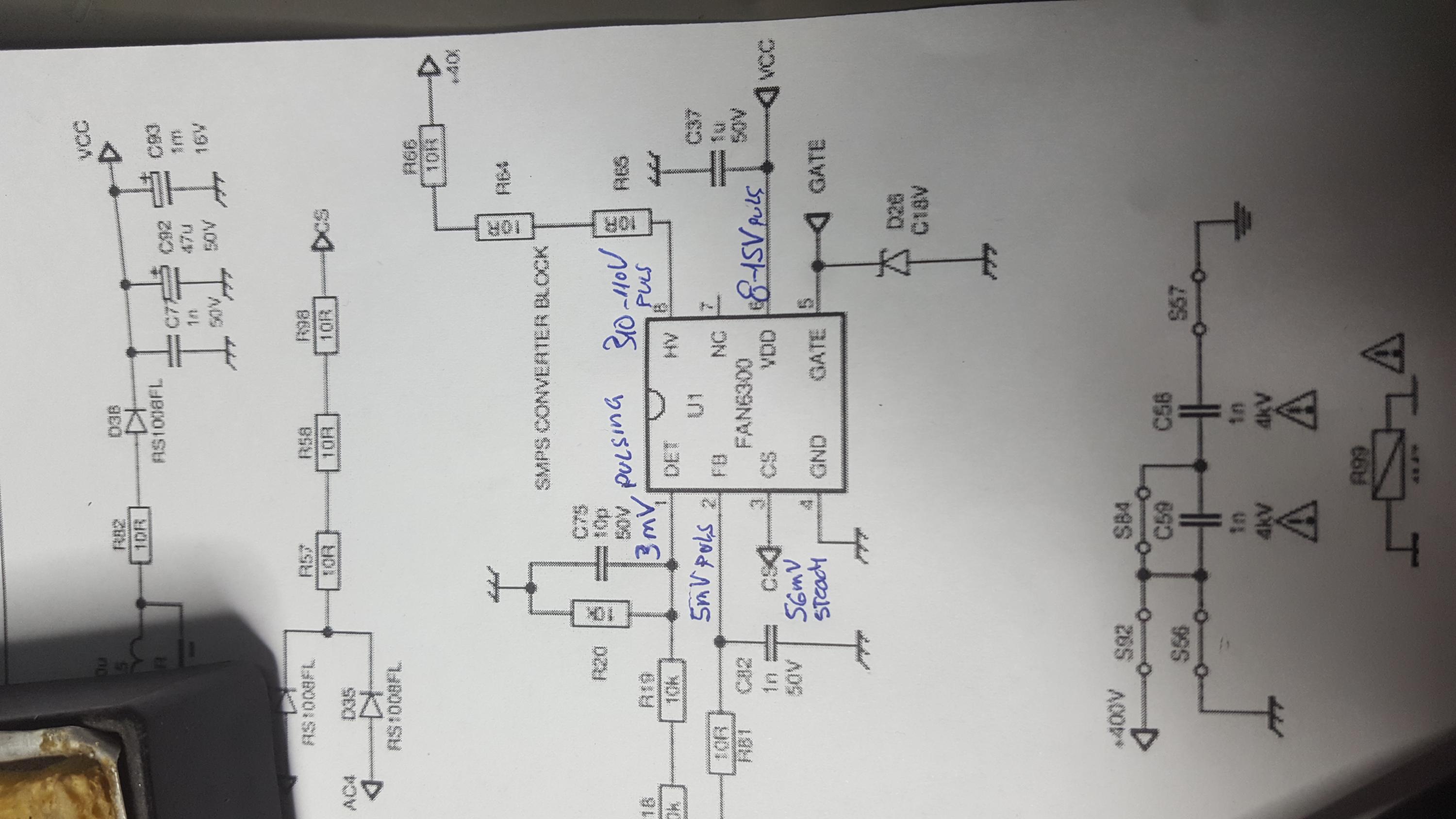

        Was the primary fet shorted? if it was, R60-R63 might be open. do you have voltage on pin8 of U1?
        • Trofazni
          • Dec 2016
          • 71
          • Serbia
          Re: Vestel 17IPS62 power supply dead by lighting
          Yes, i wrote that Primary fet and controller were shorted gate to drain. I have replaced them, then it came back to life, but only to trying to start, which is progress, no?
          No ressistors are open, i measured all of them...
          The difference between my pcb and schematics that 3 resistor series that are marked R64, 65, 66 in psu are 3x39K total in ~120kOhm, but in schematics are ~30R. On pin +400V in schematics there is standard ~310V, then three series resistors and to pin 8 of IC. Voltage drop is happening in those three resistors, steady voltage before resistors, fluctuating on pin 8, and I do not know why. And why is on pcb 120kohm, on pdf 30R?

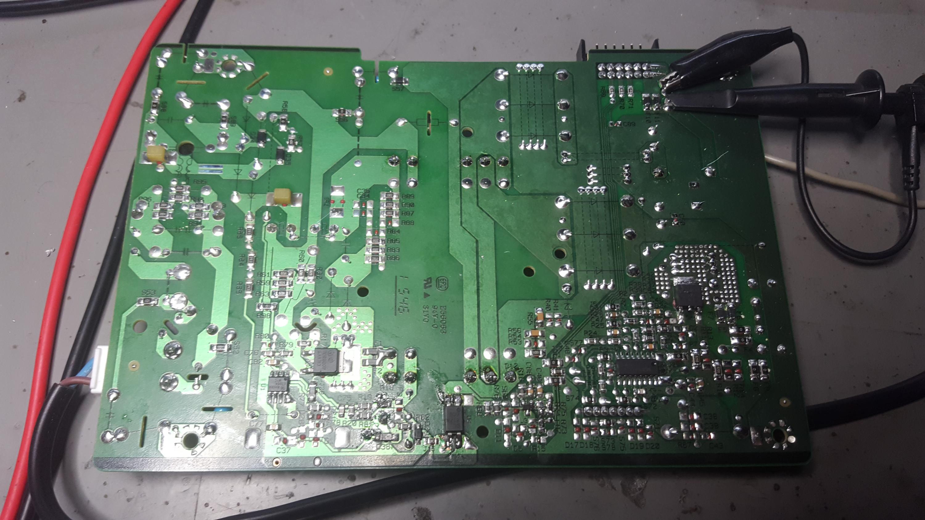

            https://www.youtube.com/watch?v=y_q_3oRd7Rk
            This is voltage across IC ground and HV pin 8.

                        I wouldn't worry about the resistors R64, R65 & R66 being marked 10 ohms on the schematic. Whatever value is given on them, check with your meter that they read what it says otherwise change them.
                        The FAN6300 requires a minimum voltage on C37 of 16V to run continuously and will stop if the the voltage falls to 10V or less.
                        In your post above it shows 15V so I suspect the FAN6300 is continuously attempting to power up.
                        So make certain that the 3 resistors match the value given on them and I would also consider changing C37
                        It is of course possible that you may have a fault on the secondary side of the power supply which would also shut the FAN6300 down.

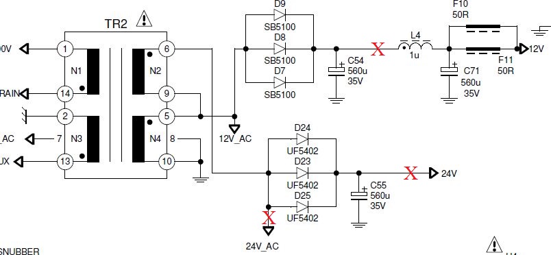

                          Well, as you mentioned that, there was fault on secondary side, but i solved it before aknowleging that the primary side if faulty, too.
                          Transistor Q5 that drives optocoupler was damaged, so i replaced it with another npn small signal transistor. Also checked resistors around him, one faulty, replaced. OC feed is ok, pulsing with primary between 0.8-1.2V, as its trying to power on. So i assume that fault on sec side is eliminated.
                          I also tried to unhook coil L4, to separate transformer from the rest of 12V line on secondary side, as I am feedeng it (seconday side components, but not transformer) with 5V from external power supply. In that external 5V feed conditions, i have steady 1.2V on optocoupler, and 0.13V voltage drop on pins 3 and 4 on primary side, so i assume that optocoupler circuit, and secondary 12V line are working correctly, as there are no shorts, heat, or anything.
                          When psu secondary is fed externally, and when i plug it in mains, primary side is doing the same thing... trying to start.
                          If fault is in secondary, this feedeng should turn on psu normally, since secondary side of transformer is dissconected from 12mains..
                          Am I getting it right, or am I totally off track? Is this the way I can test this, or am I getting sometnihg wrong?

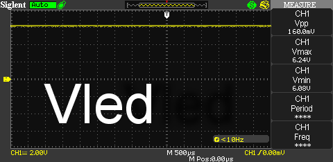

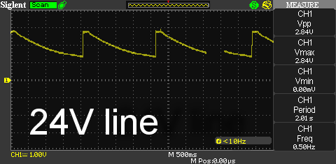

                              What voltage do you have even if briefly on the 12V, 24V and Vled when you switch on.
                              Screenshots of voltages are uploaded...

                                Check the diodes with your meter in diode mode and set switch off and also the resistance from each of the X points to chassis.
                                • Trofazni
                                  • Dec 2016
                                  • 71
                                  • Serbia
                                  What do you mean and set switch off? I don't understand.
                                  Diodes are measured when removed from the pcb.
                                  D9-0.231mV
                                  D7-0.236mV
                                  D8-0.224mV
                                  D23-0.419mV
                                  D24-0.433mV
                                  D25-0.405mV
                                  To chasis:
                                  X L4 - ~30k
                                  X 24V - 1.7M
                                  X 24V_AC - 1R
